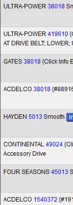

Brand loyalty aside, you don't need to replace the entire tensioner. You can replace just the wheel/bearing and keep the original tensioner body. I just replaced mine with a Gates wheel and the tension indicator is still showing 'I' with a new belt.
Hey, I appreciate this - you wouldn't happen to know that part # or source would you? I ask because last night after inspecting everything more closely and talking with a friend, I realized I probably don't need to replace the tensioner at this time, just the belt and idler. Cancelled the Gates unit and just went with ordering the other two. Someday I will have to go back in and do it though...
Even though I can't order from Rock Auto (they won't calculate my local taxes), I find their site the easiest way to locate part numbers.
