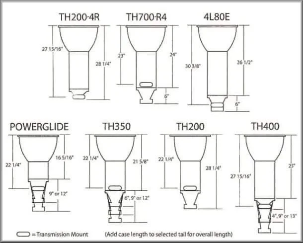

Here's some 2wd lengths.The 4l60 is a 700r4 as far as i know. You need to add 4x4 tailhousing and adapters on both ends. Or do a chevy/jeep hybrid np231 to skip the rear adapter.not a short combo.Getting a torque converter to match is difficult as well according to blaine

"The 700R4 transmission first gear, second gear, third gear, fourth gear, and reverse gear are 3.06, 1.63, 1, 0.7, and 2.9 respectively. Its lower first gear ratio provides excellent performance for low vehicle speeds."
It does have a better first gear ratio compared to the 2.7 first in the tj autos.but a similar tall overdrive gear
4l60 = 700r4. 4l60e = headaches when put under stress
