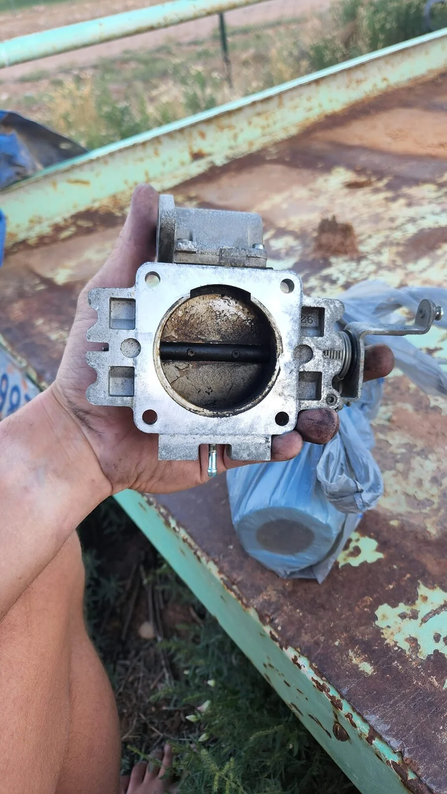

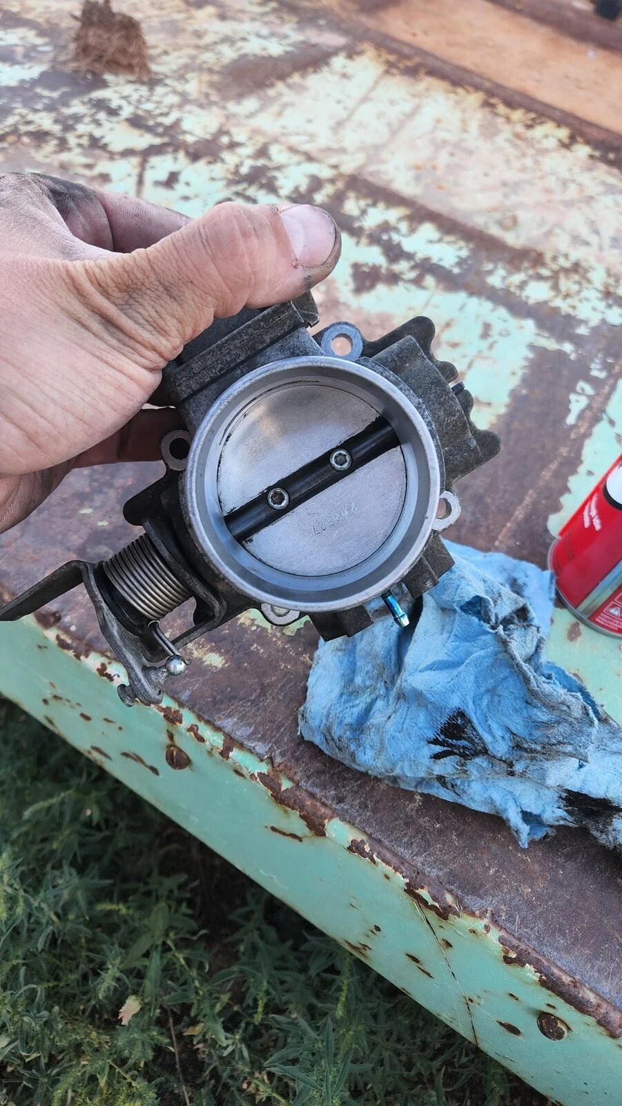

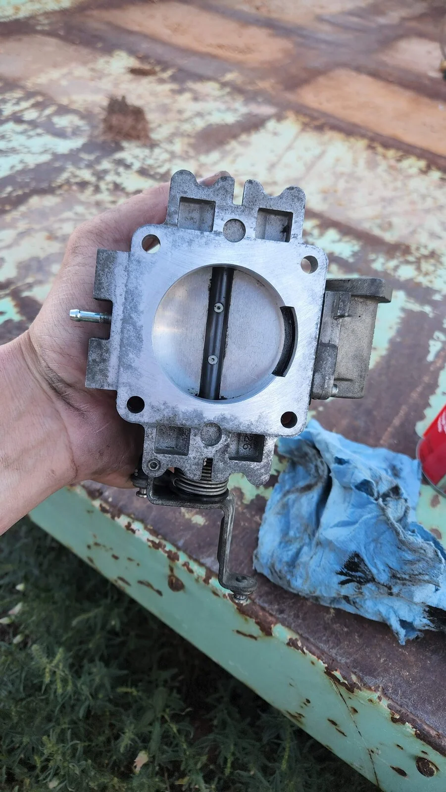

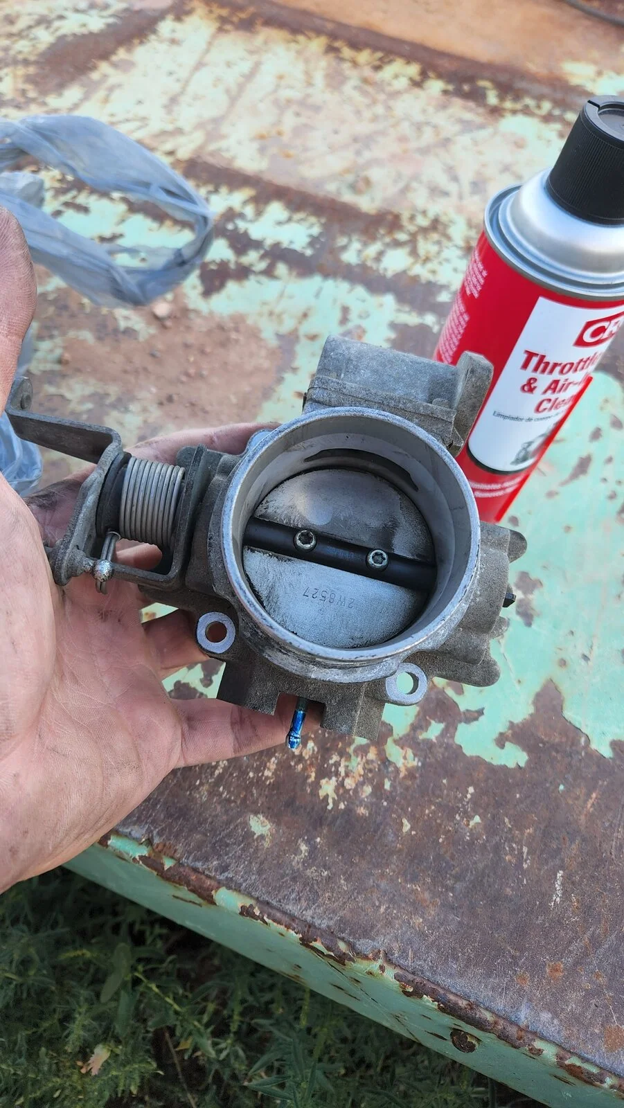

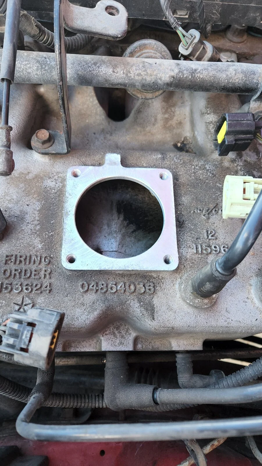

I replaced my NTK CPS with a Standard Ignition CPS while I waited for a Mopar one from a local dealership. I expected that to work, but I was getting the same misfiring issue as before. Feeling defeated, I checked all connections and moved on to a suggestion originally made in the cherokeeforum chat, clean the throttle body and IAC. Took that apart, cleaned, and reassembled and she's purring like a kitten. Feeling good. Now I've got a spare CPS! Thanks for the help!

That was one dirty throttle body. How many miles on it?

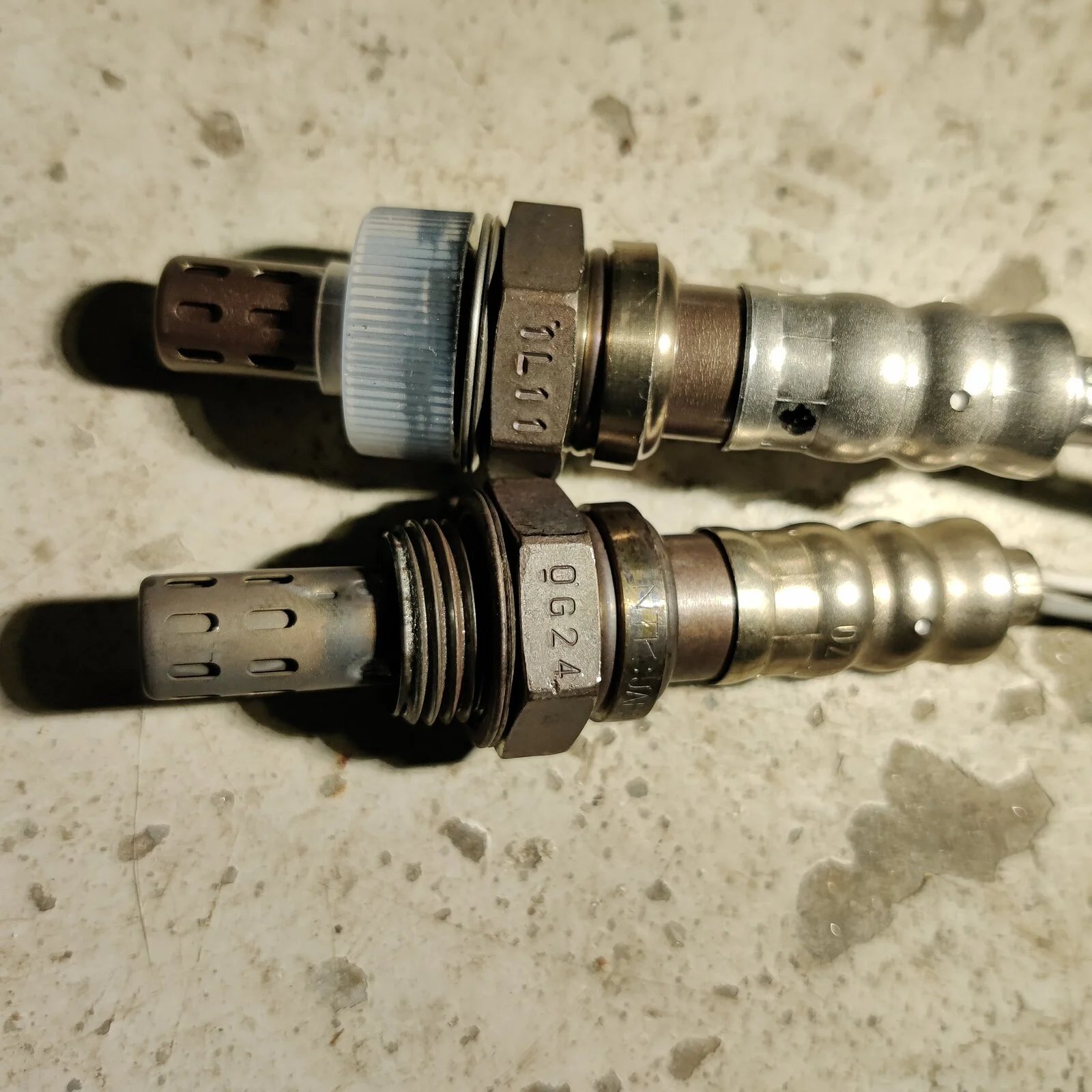

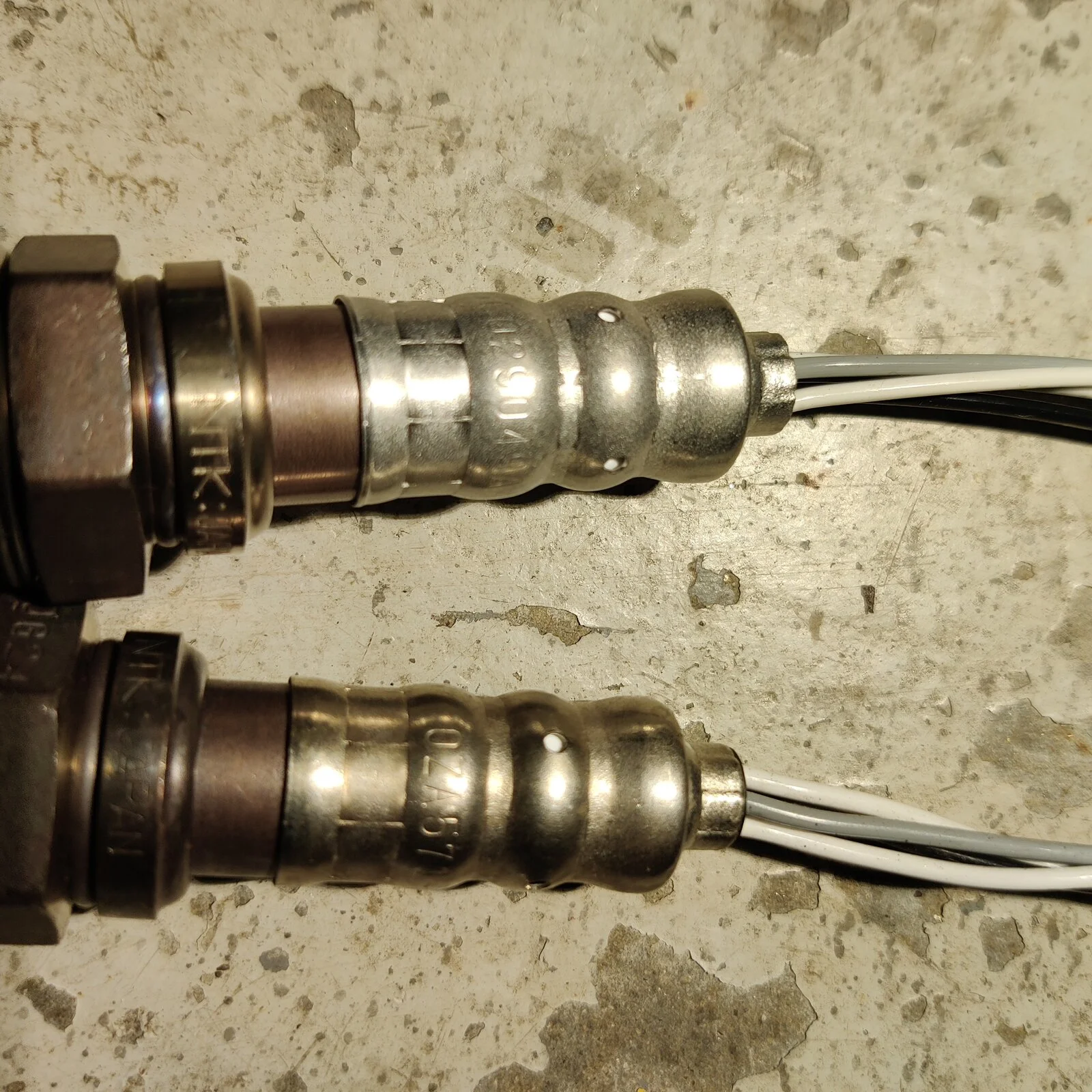

Reviving an old thread to share a couple pictures of the Mopar O2 sensor next to the NTK O2 Sensor.
While Mopar's O2 sensors are made by NTK, they do look the same with minor differences.
Mopar has three different colored wires (black, white and gray) whereas NTK has two (two white wires and one gray).
Mopar has their part number engraved.
There is a third number engraved and I have no idea what it is, but they differ between Mopar and NTK.
