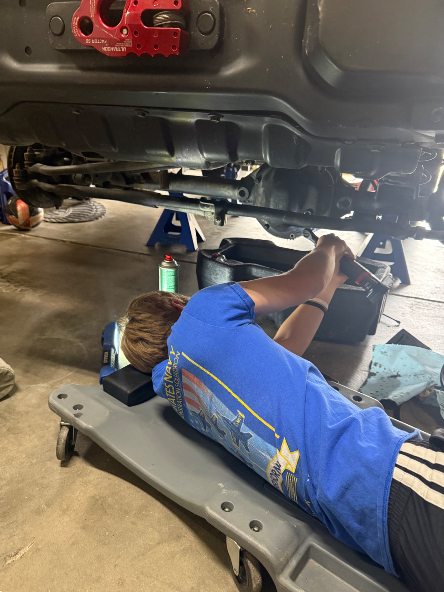

Much happier that I took the center console out and found that the shifter was loose. That should take care of the pool of oil.
Found that the crrectlync is loose and is been giving me the wandering steering. I've got some wrenches ordered to help get that tightened down.

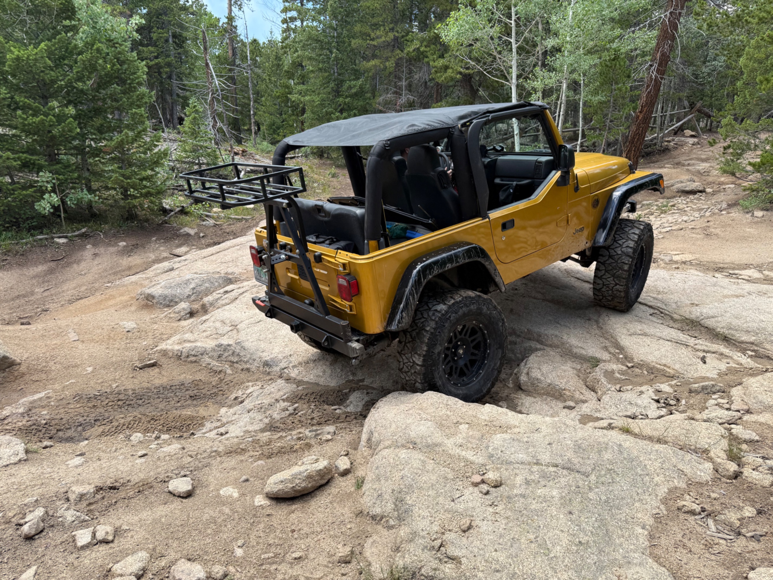

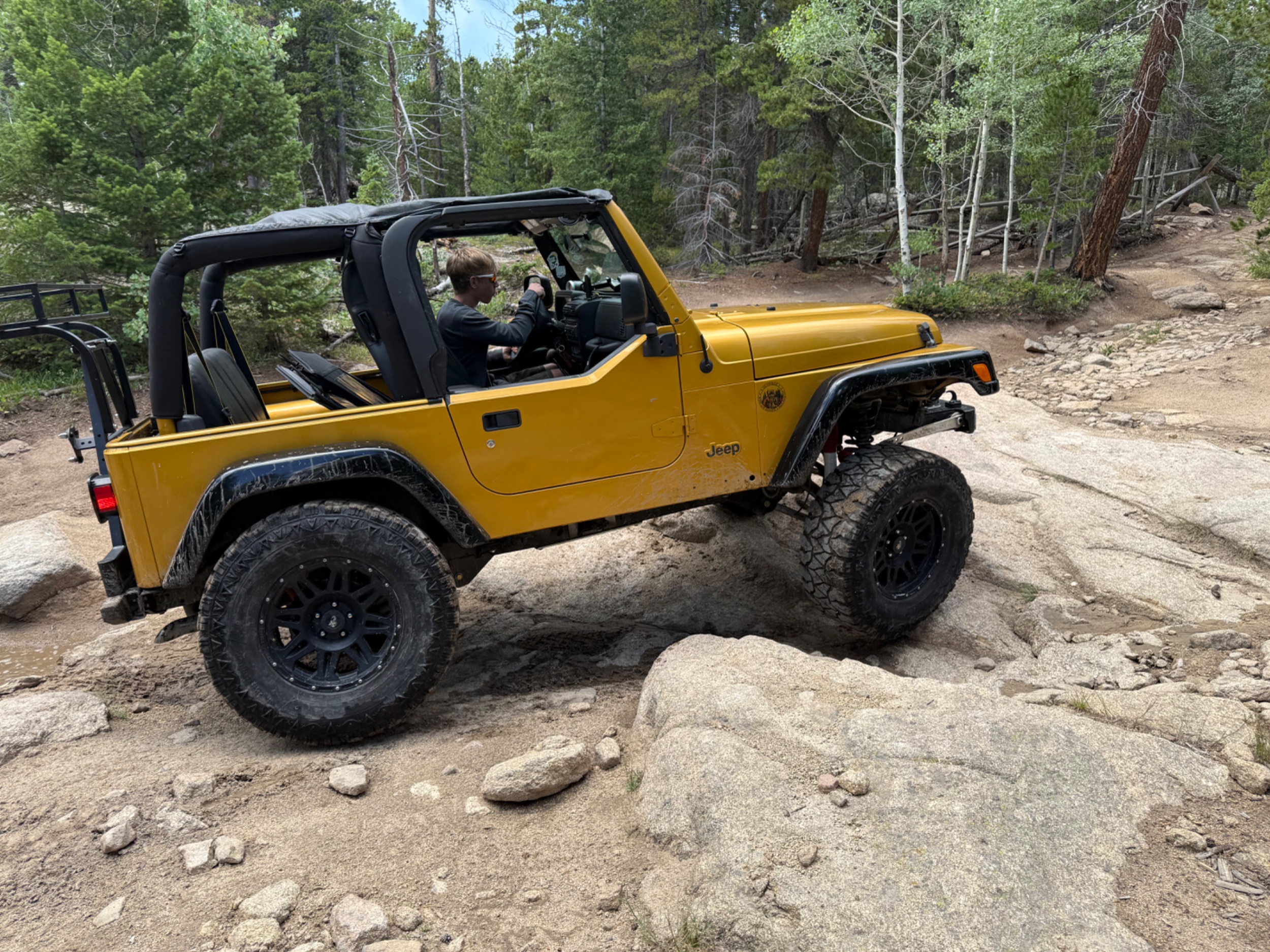

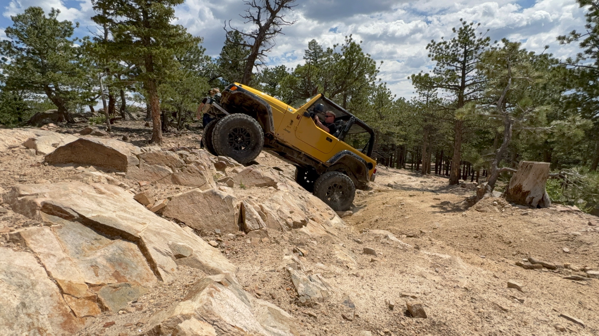

Older son and I had a day off at the same time. Went back to the same area as Saturday. Completed Bunce school road and Ironcalds.
It was his first time driving off road so it was cool watching him try and pick some lines. And then get spooked by some rock that was nowhere near a concern.
Lots of bouncing and then finding loose components because of it. Somewhere we lost the bolt and bushing to the upper rear DS sway bar link.

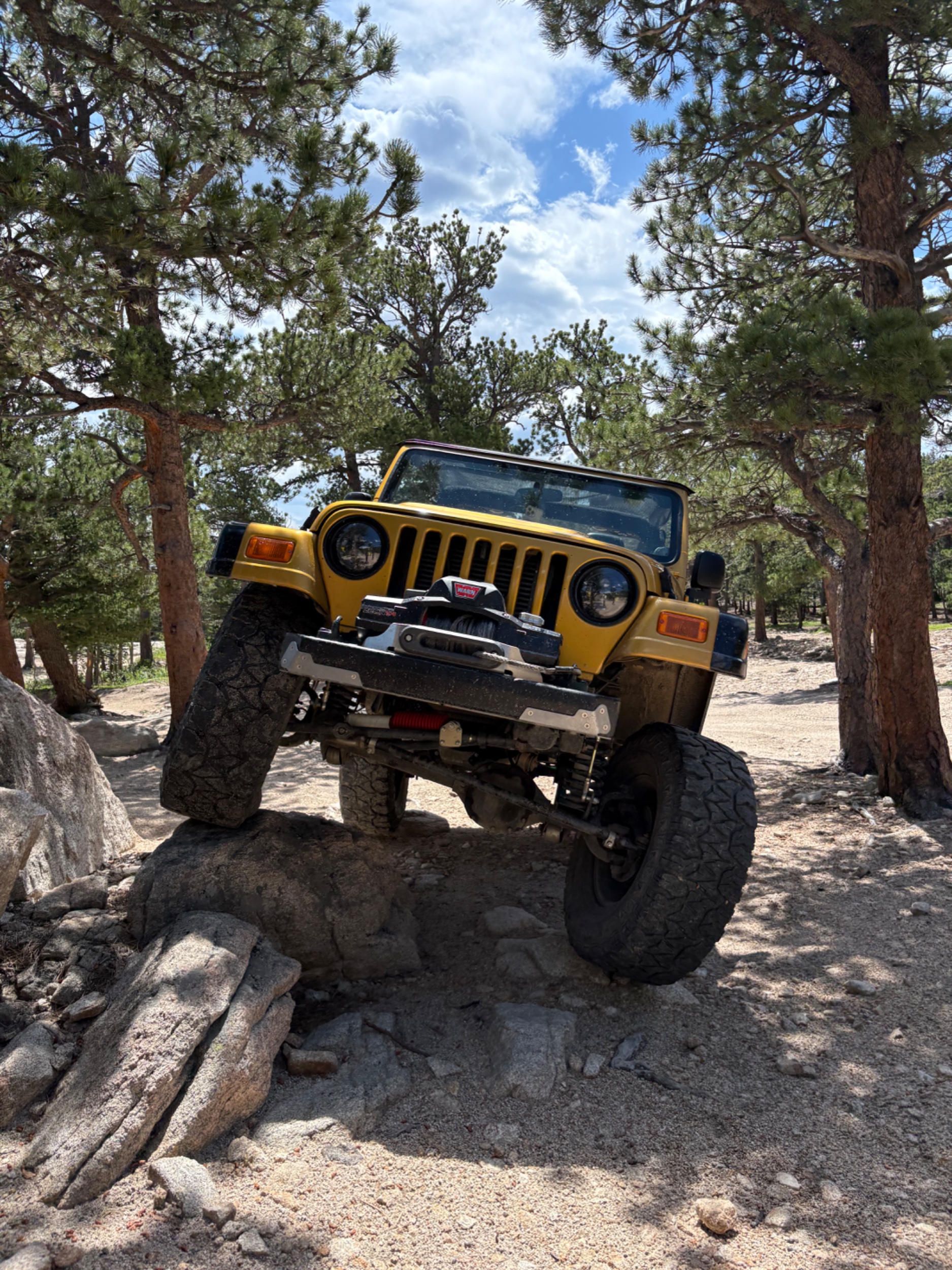

Twice on the drive home I forgot And let the clutch out with left turn.
That right rear corner sinks and next thing I know the front left tire is 18" I'm the air. 310lbft of torque 😳

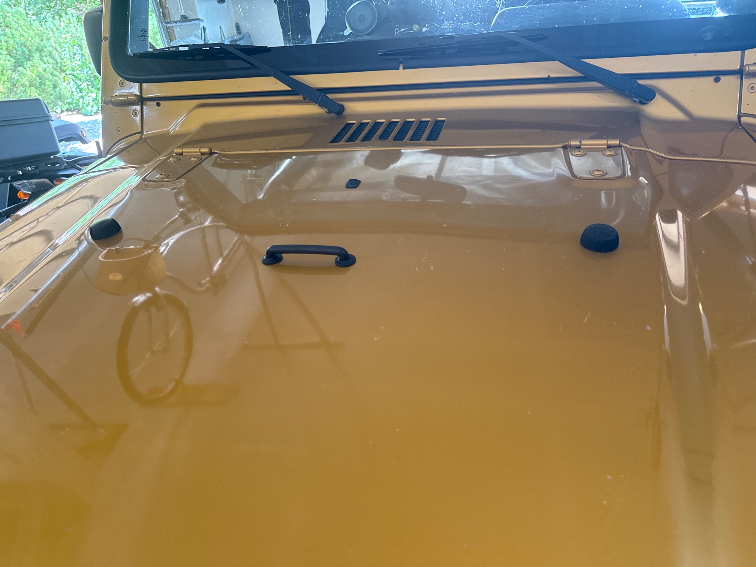

Finally, I know they're folks out there that wouldn't. This has been driving me crazy, last I looked they were $12. Got one for $6 prices have come down.
Now that I've got a new Footmans loop, the hood looks correct again.

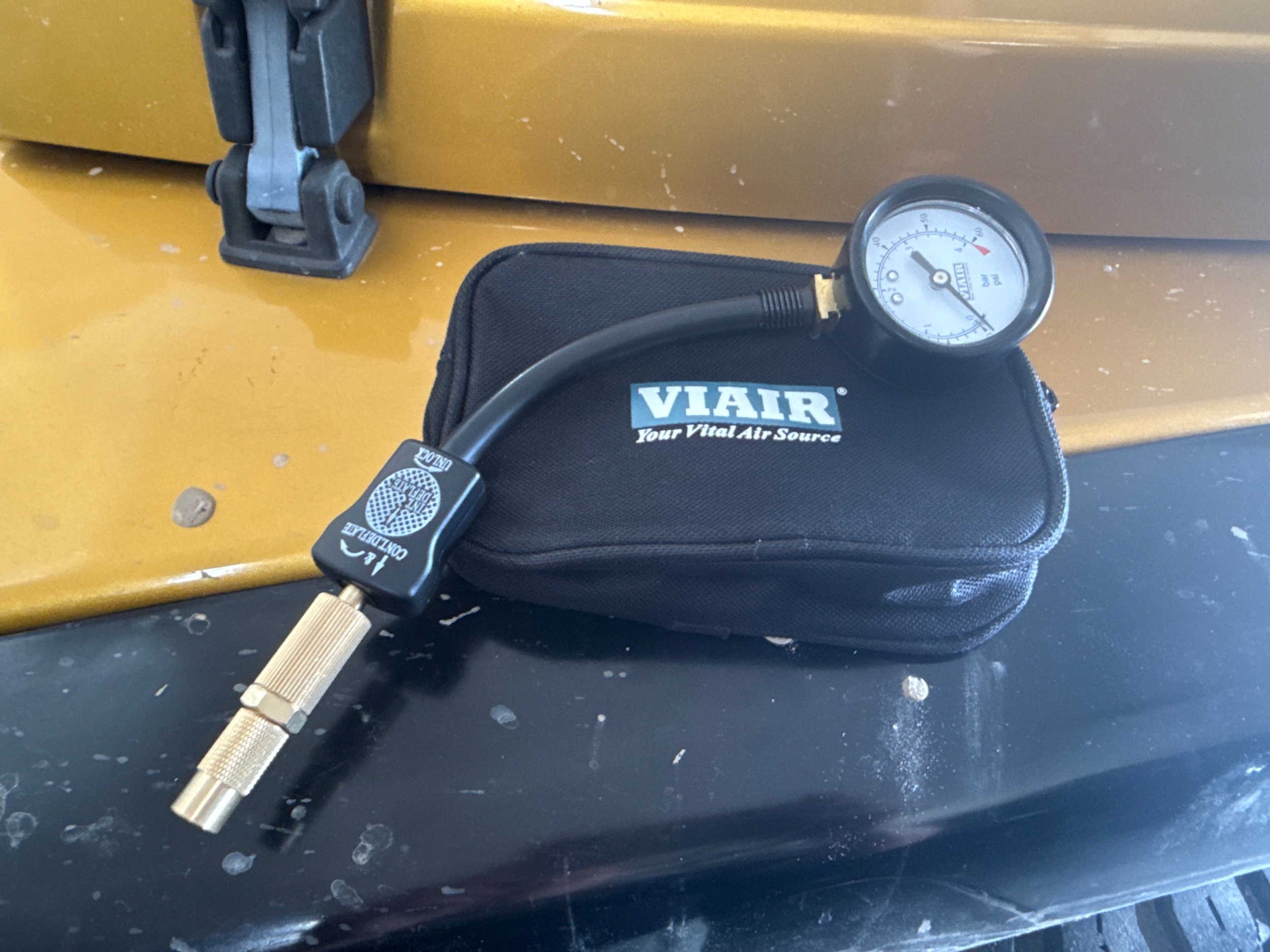

Had a $25 gift card sitting in my wallet for the last two years. Decided to use it after I had 4 different pressures on some air down valves. I'll see if I can get those closer together.
Picked this up from a 4wheel parts store for $28

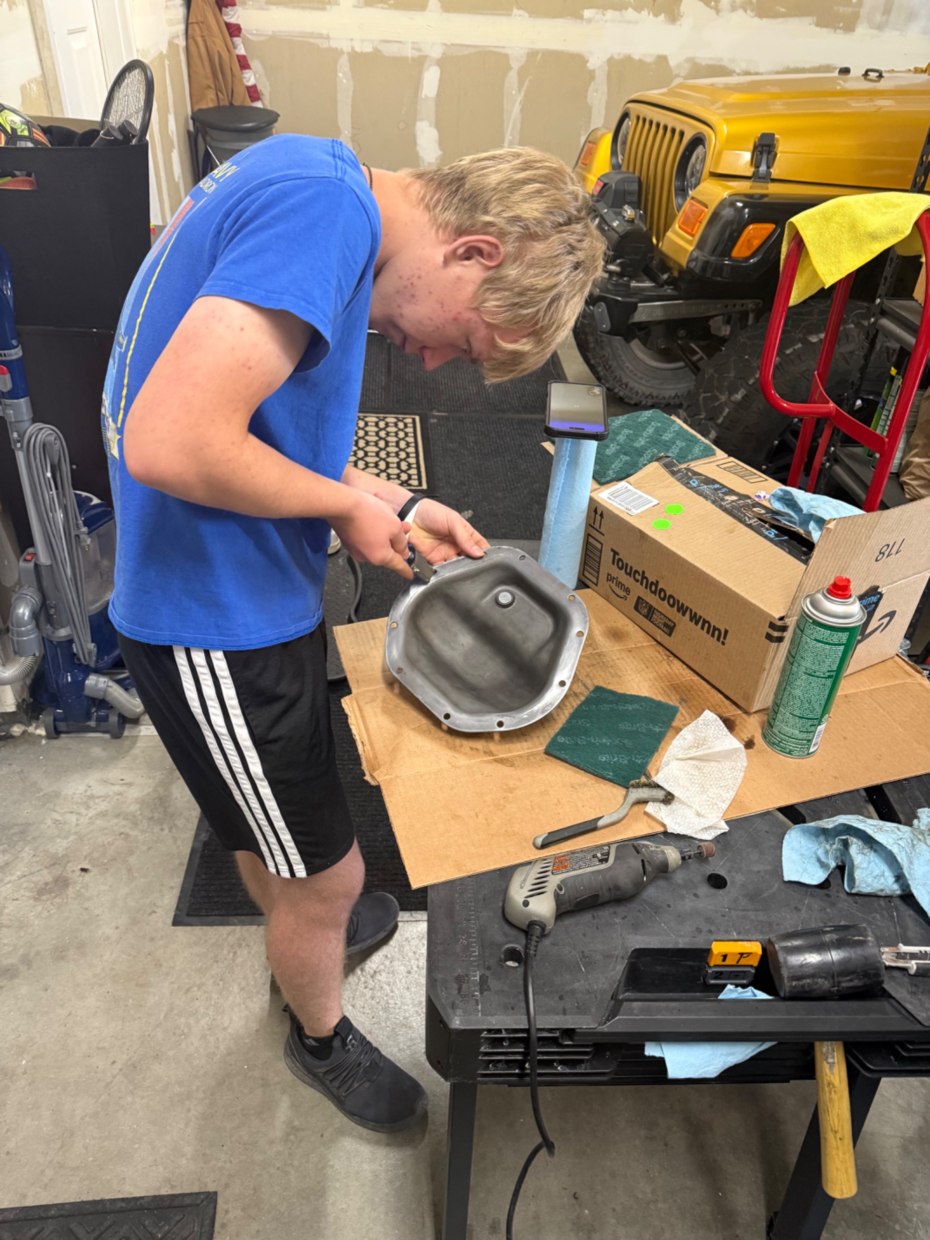

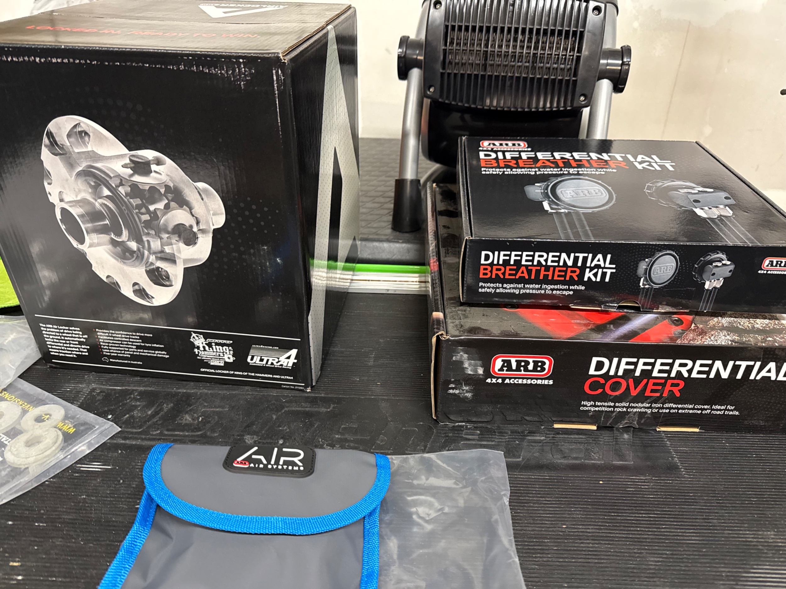

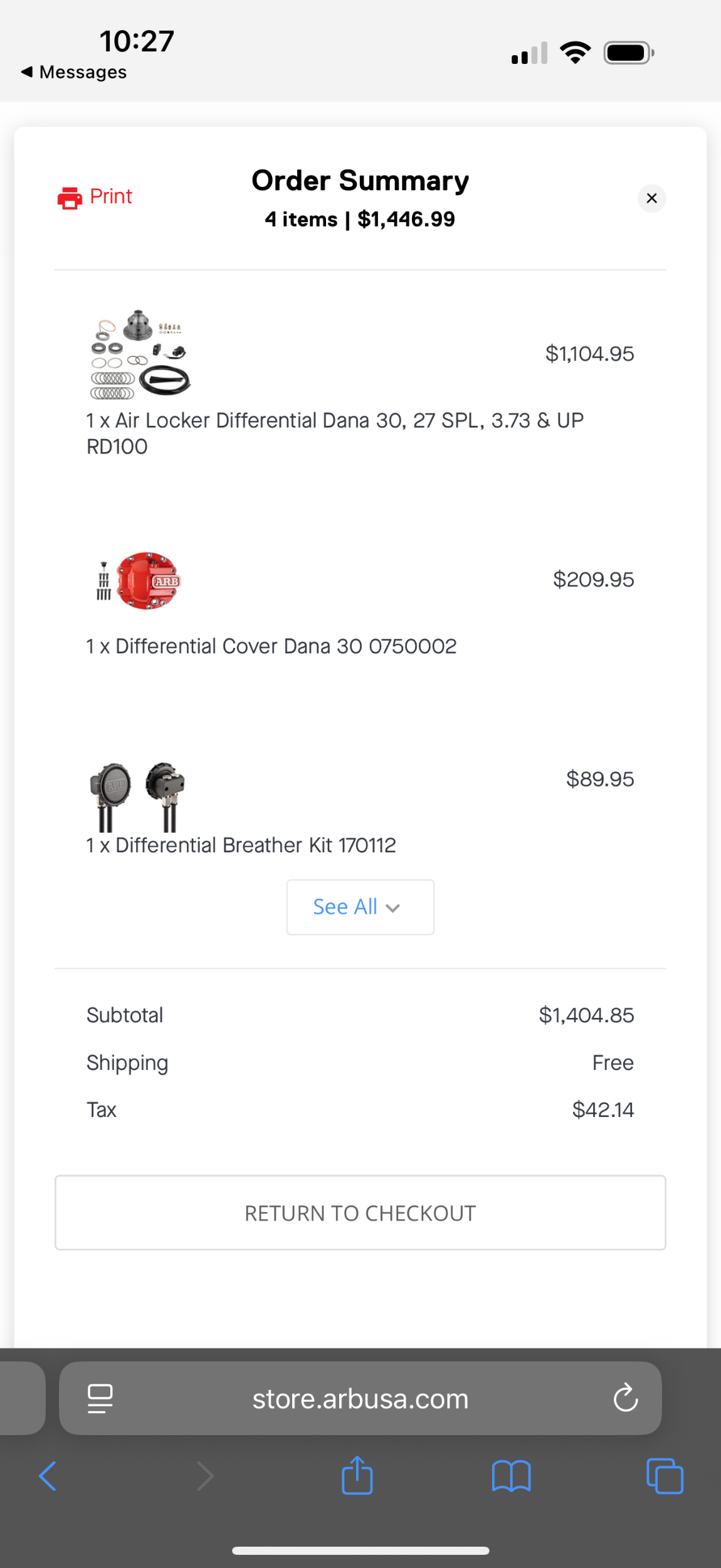

Front Axle parts have arrived. Should be able to order rear stuff come late Jan or Early Feb.
Have to find some time to pester @hosejockey61 in the early parts of next year
You might want to reconsider that diff cover and "breather" kit. ARB covers are really thick and create clearance issues... Search the forum and you'll see. The breather kit just isn't needed. The stock one is all you need. As far as a cover, see if you can source a Barnett style. Not sure if T&J has then in stock or not.
The only thing nice about the breather kit was that all my old stock lines were long gone and now I have all of both axles & t-case & transmission in one breather..
I use a piece of wire that I store on my tool chest - bent in a J form to 'dip stick' my Riddler covers...
Does exactly the same function of the ARB (with increased emboss) for less than $0.01.
