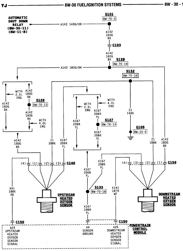

I guess the O2 sensor's heater wiring color codes changed according to the FSM, they're no longer both white as they were on my early '97.
Check that the O2 sensor's dark-green wire with the black tracer has +12v on it (from the ASD relay) when you first turn the key on. That 12 volts will shut off 1.8 seconds later if the engine isn't started. Then check to see the brown wire with the yellow tracer gets grounded to turn the heater on, that ground is provided by the PCM. The O2 sensors receive a constant +12v on the green/black wire when the engine is running, the heater activates when the brown-yellow wires are grounded by the PCM.
Sorry @Jerry Bransford one more question: the brown/yellow wire gets grounded after the 1.8sec, or only with the engine running, or some other combination?
The ASD relay shuts off after 1.8 seconds if the engine doesn't start. It shutting off kills the ground to the O2 sensors. If the engine is running the ASD relay remains energized (on) giving the O2 sensors a steady ground.
