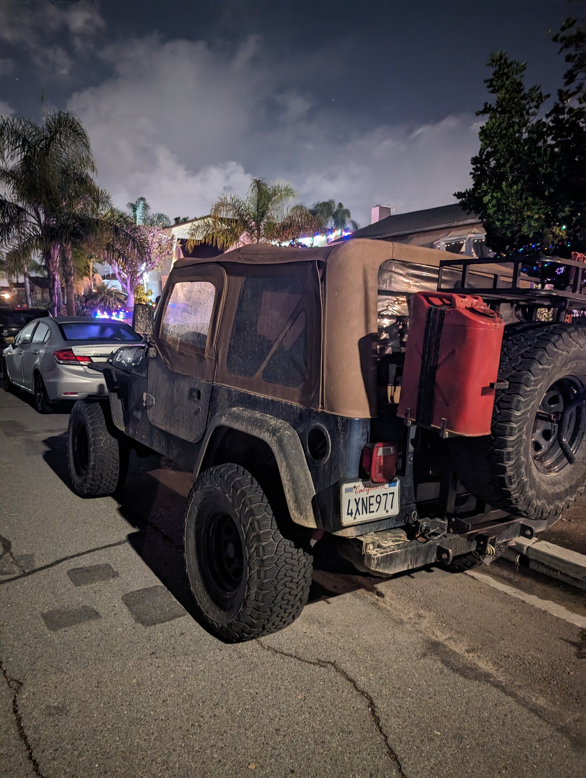

Well surprise surprise! I'm almost positive the rattle is the muffler itself, as the CAT monitor has magically flipped today! Prior to the flip, I decided to hit Fiesta Island in San Diego today because it's raining, and it's fun to hit some muddy puddles for a change in an otherwise temperate climate. After 3 or 4 failed flips after completing the CAT specific drive cycle, I tried the same ol' cycle today and she finally popped.
