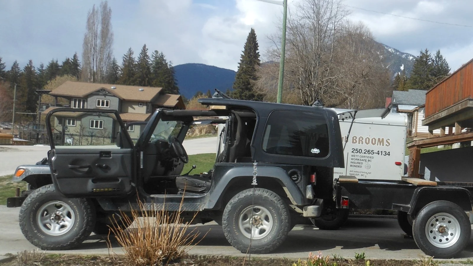

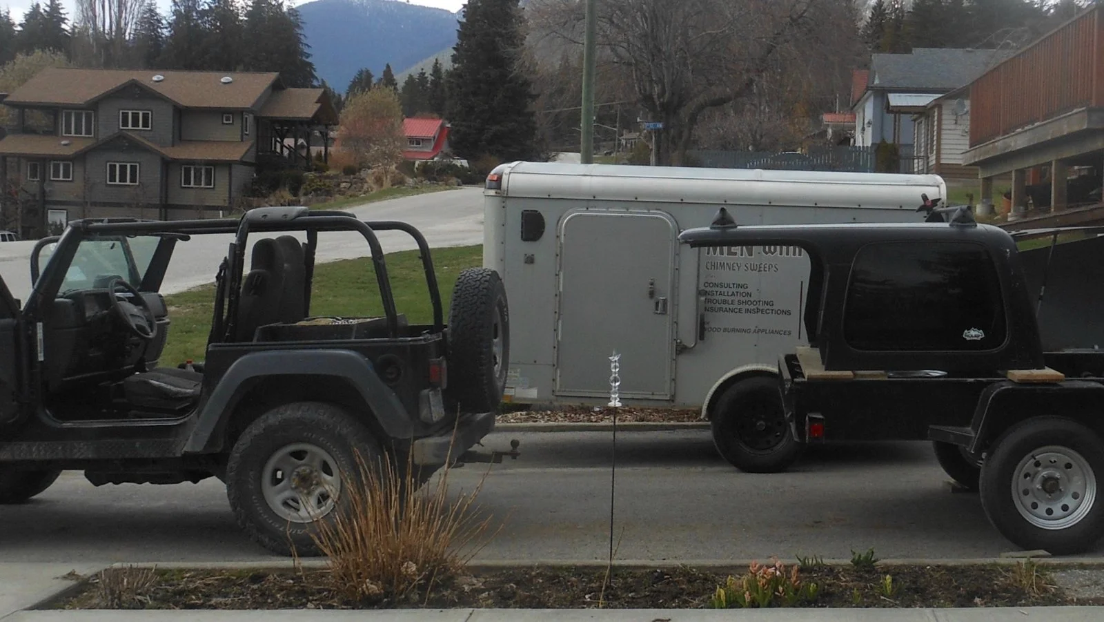

Todays the day.
By myself without a lift.
Have had a few guys asking for pictures so here they are.
I used to use a table/workbench built at the right height but space is at a premium so I use my trailer instead. It is a bit low but it still works, ideal height is about an inch higher than it sits on the Jeep.
Takes about 15 minutes. Undo the 6 bolts. Unclip the windshield. Check all is loose. Window up. Tailgate closed. Back up to touch the trailer. And inch the top off, about 6" at a time, alternate sides. Try to keep the top from sliding off the edge of the body. And roll the Jeep ahead once clear. Throw a ratchet strap over the top. Done.
Putting the top back on is where having the stand an inch higher is an advantage.

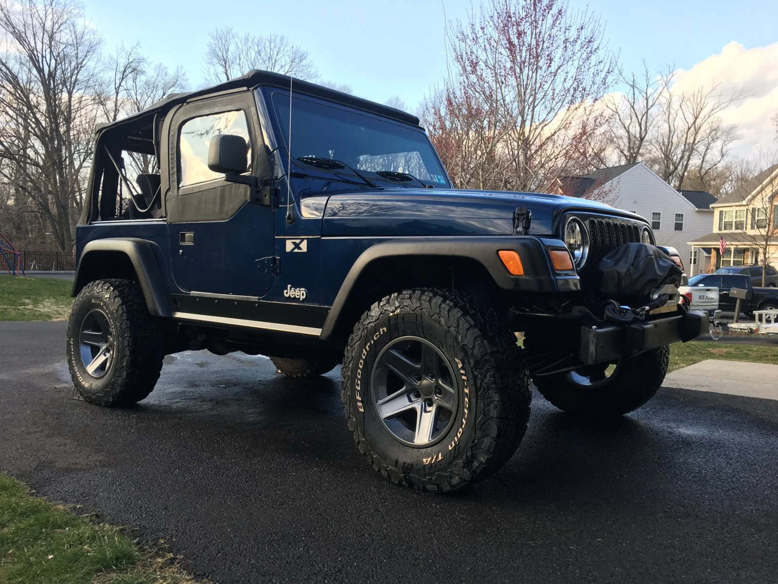

Ok that TJ is far tooo shiny... but I love the Bridger knock offs, whose wheels are those?
Actually that was a post wheeling trip. My first and last time running thru mud puddles. Such a pain to clean everything. The wheels are quadratec rubicon extremes in gunmetal
