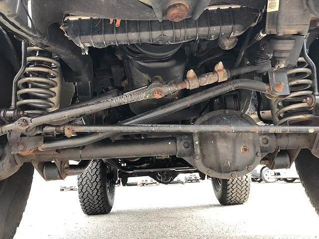

I don't know if it's just the way it's parked but it looks like it's leaning to the passenger side in pictures 2 & 5, could be one of the wheels is in a depression in the pavement but that's one thing I'd look at
Reactions: xXshutterflyXx
There's definitely something going on with the body on the front passenger side in the second photo...
I thought that too.
I also can see some rust on the frame that looks like it may have been painted over to make it look better. I think this is one of those vehicles I've had to see close up, because I want to say that it's "hiding" things.
I'm also weary of 3 accidents. One accident might be understandable if it was something small... but 3?
I know... I can see some surface rust spots, but based on photos it looked "clean" by wheel well frame that you could kinda see...and looking at the photos closer, as others mentioned, it does seem off or slightly tilted...
It starred in carfax that 1 accident was into a mailbox (which, I'm sorry, that's still funny to me that somehow damage from something like that had to be reported/fixed...how BAD could it have been from a mailbox!?!)
The other 2 were 1 from each of the owners, total of 3 owners. One had an accident in the front end, the 22nd was hit from behind....that's all I know
That's one of those vehicles that you'd have to see it in person to really know. You'd want to check body gaps to see if they line up (to see if the accidents were repaired correctly), check out the quality of the paint, frame, etc.
But just based on the accidents and what I see on the frame, I would pass on it personally.

This is picture #12. Look at the sway bar end links were they attach at the axle. The passenger side is down about were it should be. The driver side looks to be up higher than what I remember them to be. Or the end links are at different lengths. Either way I believe this is whats causing the passenger side to be lower than the driver side.
I wonder how it got that way, especially when those sway bar links don't appear to be adjustable.
Either the sway bar is bent, or someone homemade those sway bar end links and made one side longer than the other, haha!
I think the drive side sway bar mount has been altered in a way that it is higher then what it should be.
