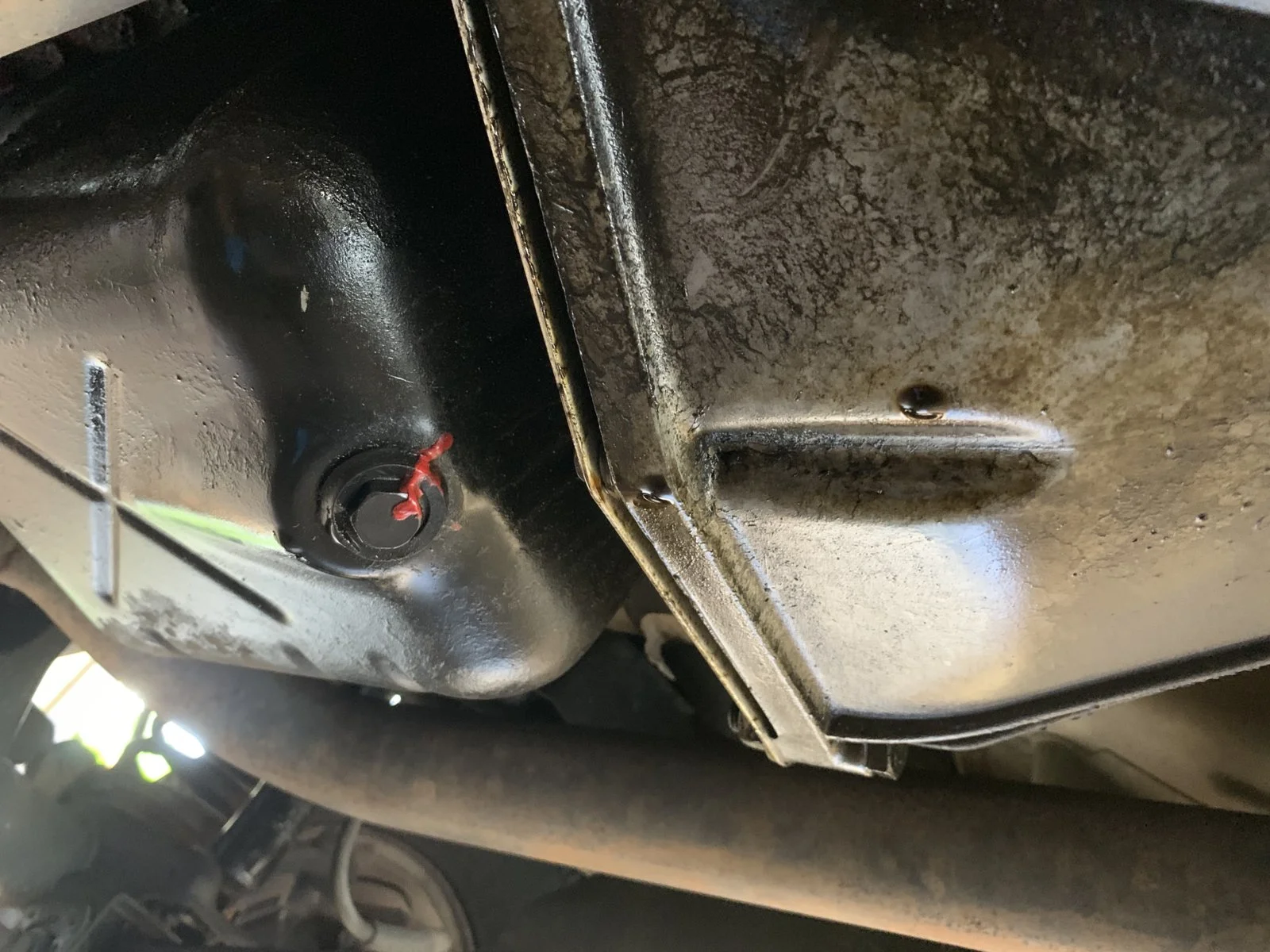

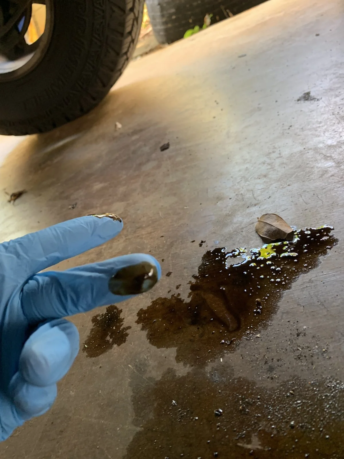

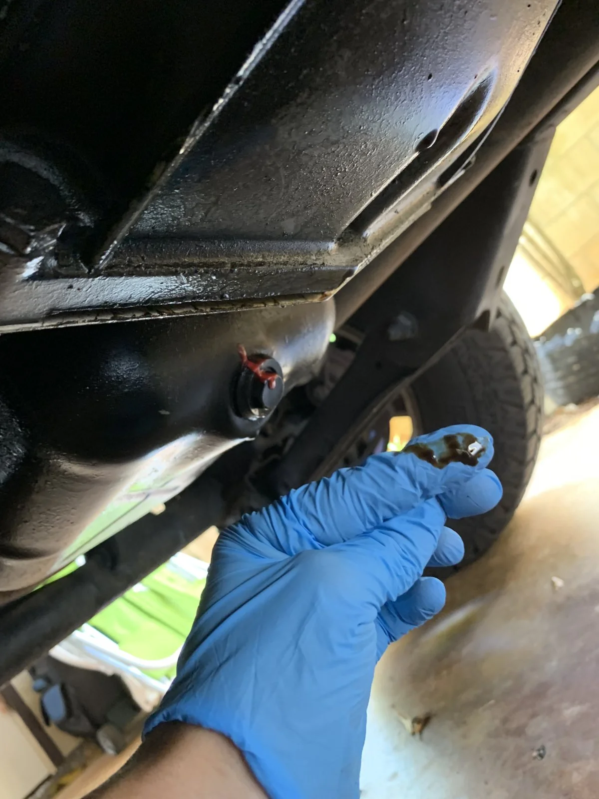

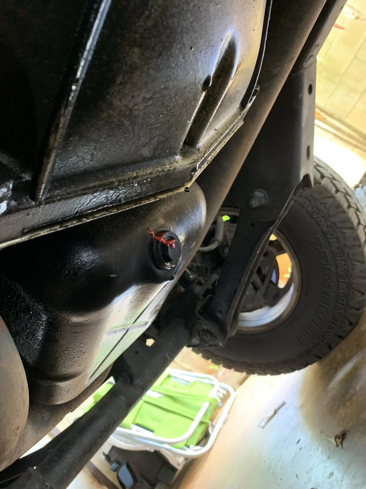

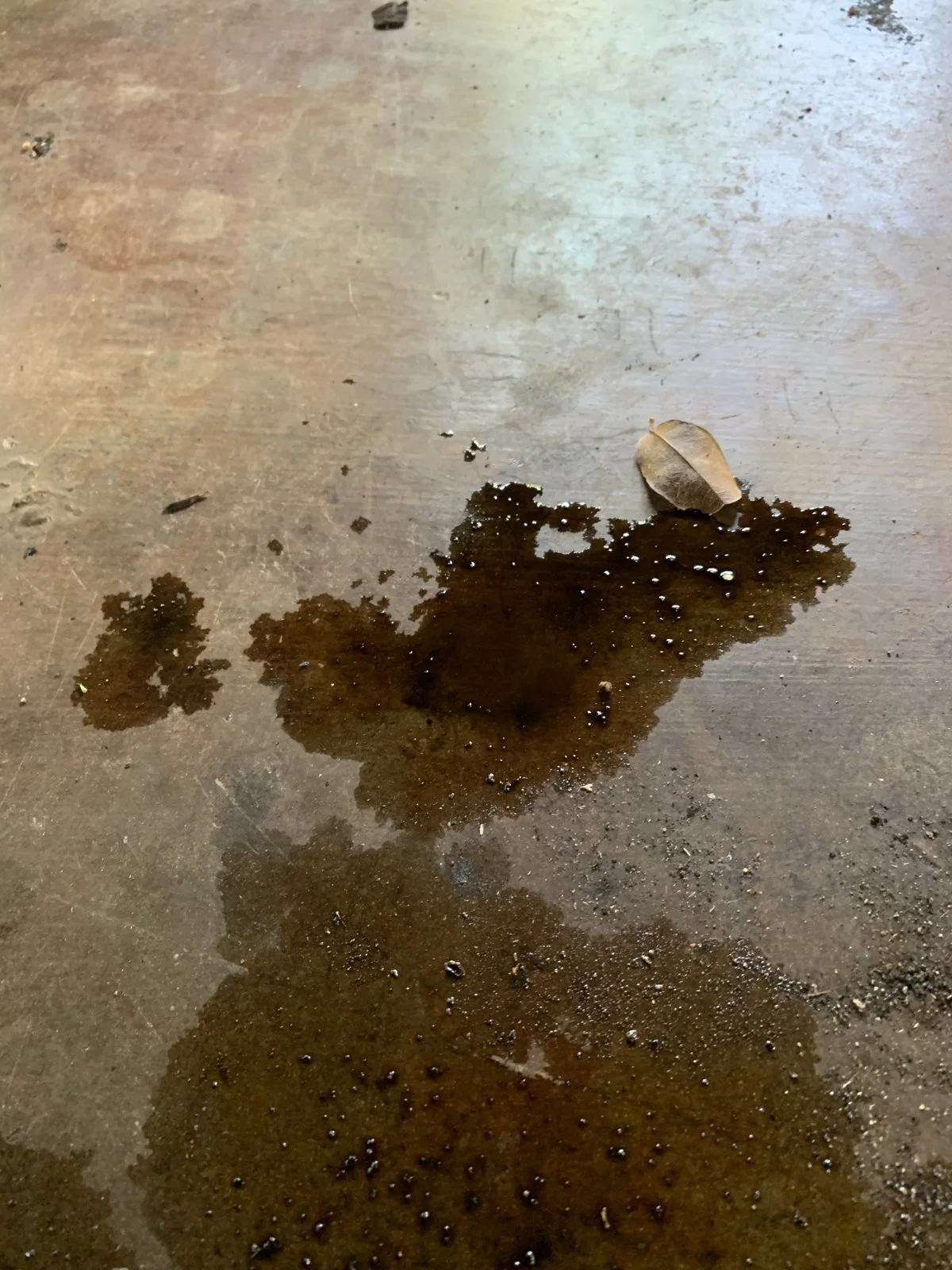

My 03 Jeep Wrangler has been leaking a bit of oil the past few days. (At least I think it is oil). But it seems that it is coming from the Manual Transmission Vent behind the Oil pan. I want to change my oil but am holding off until I can find out what this is coming from.
Would anyone be able to confirm if it is Oil & what may be the reason it is leaking? Thank you!
That could very well be engine oil leaking from the rear main seal. I doubt it's coming from the vent on top of the transmission since there's an extended vent hose attached to it.
