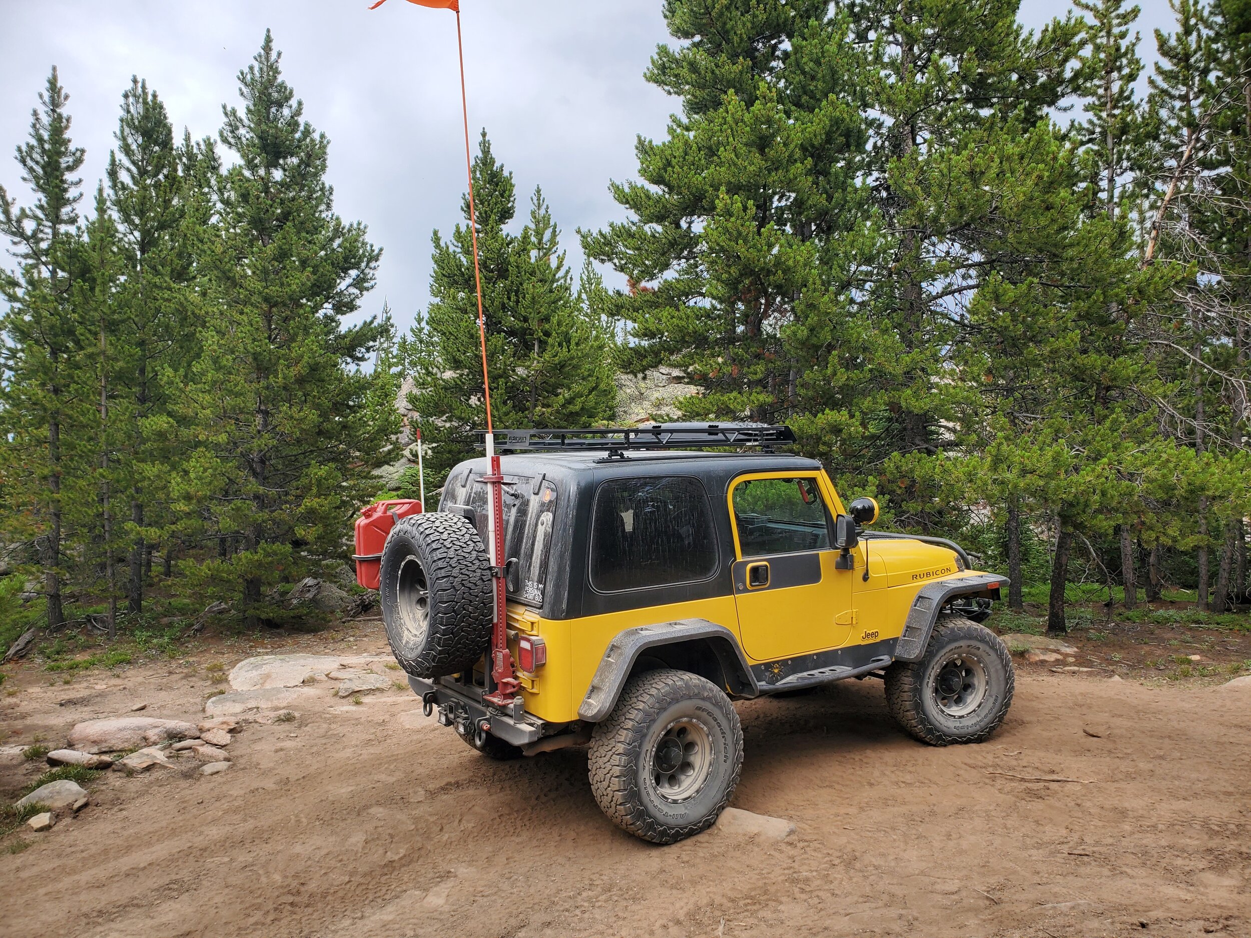

Took the TJ up to the BigHorns this weekend for some trailing with the family. Haven't received the new sender unit yet so it did pull the drop oil pressure to zero check gauges game a few times.
What's strange is that it would randomly, and frequently beep but no lights would come on the dash. Oil pressure still read normal. Would beep and beep until I slowed to about 15 mph then it would stop. Would stop for a while and randomly do it again.
I scanned and only had a few odd ball codes. Any ideas? Ran fine. No issues.
