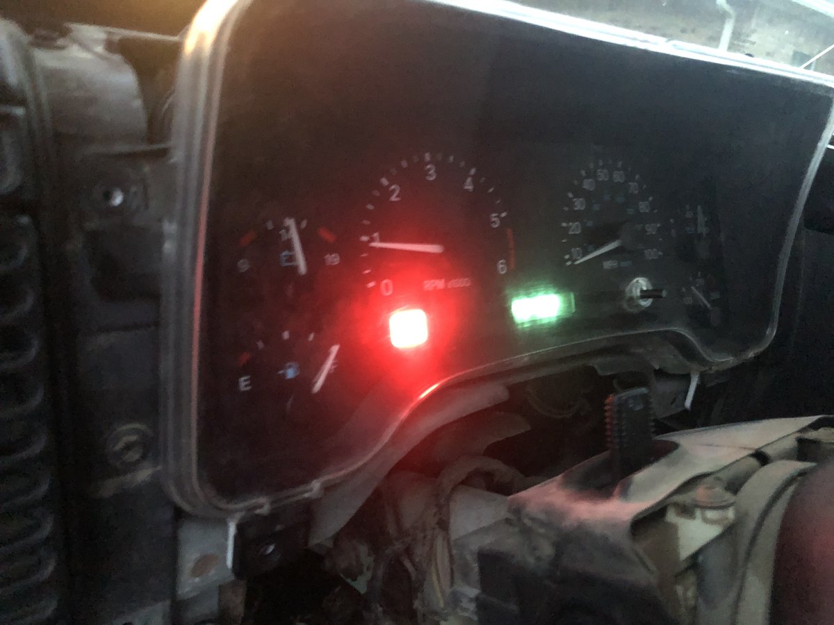

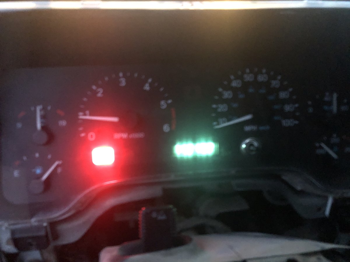

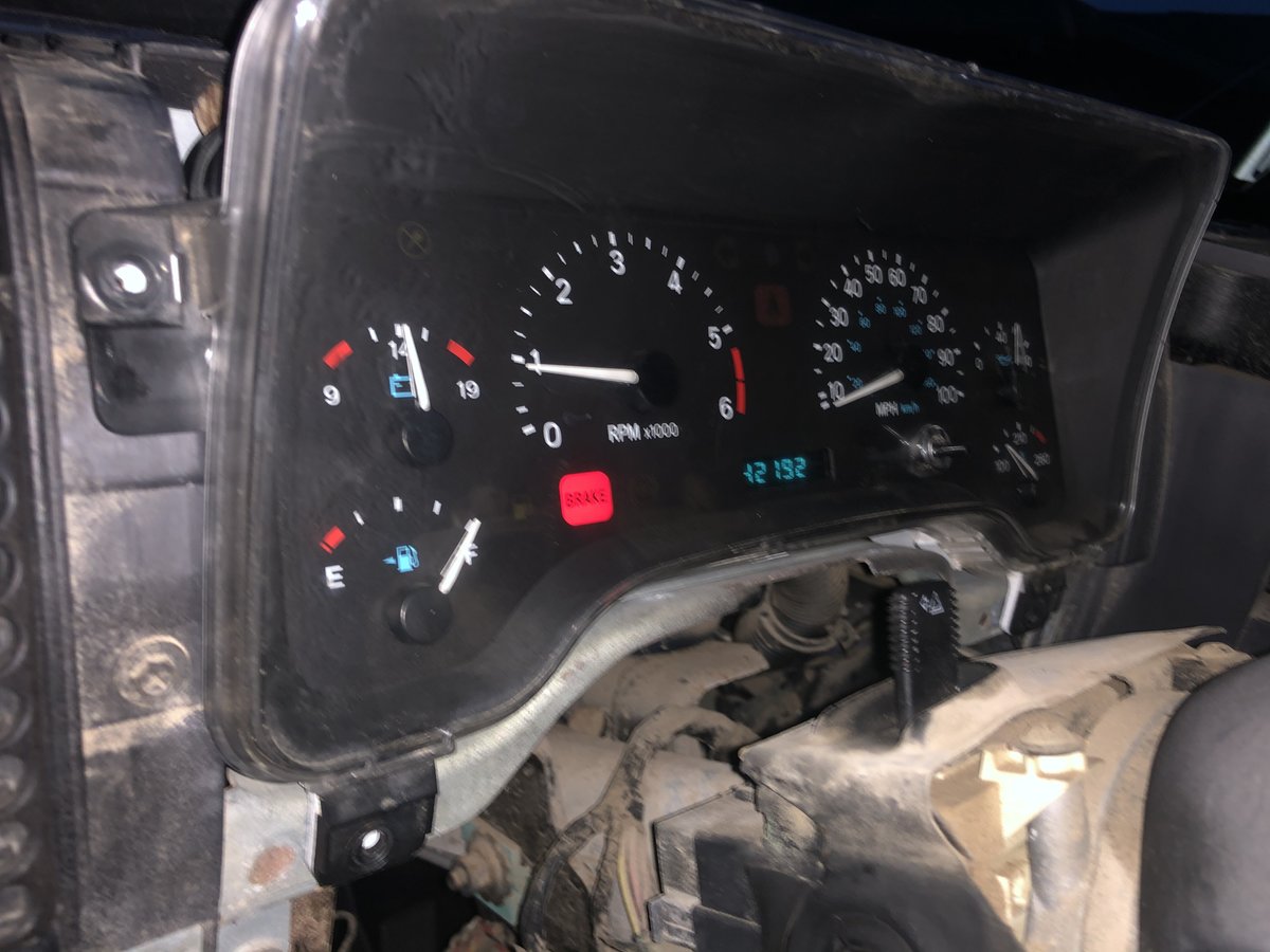

In my 2000 wrangler SE the lights for the speedometer and RPMS was out so I decided to make the change to LED’s. I pulled the instrument panel out and made the change. I made sure the LED’s are in correctly and working by lighting them up with a battery. Now put the panel back I’m fired up the Jeep and still no lights. I rotated the bulb housing 2x now and nothing. For giggles I checked the old bulbs and they all light up so not blown. I checked all my fuses and none are blown.
Lights that work on the panel
Blinker
Brake
Part time
Airbag
Check engine
Shift
Seems like my main bulbs are the ones not working. I’m going to look tomorrow for any grounding issues but wanted to see if anyone has any other ideas?
Thanks in advance everyone!

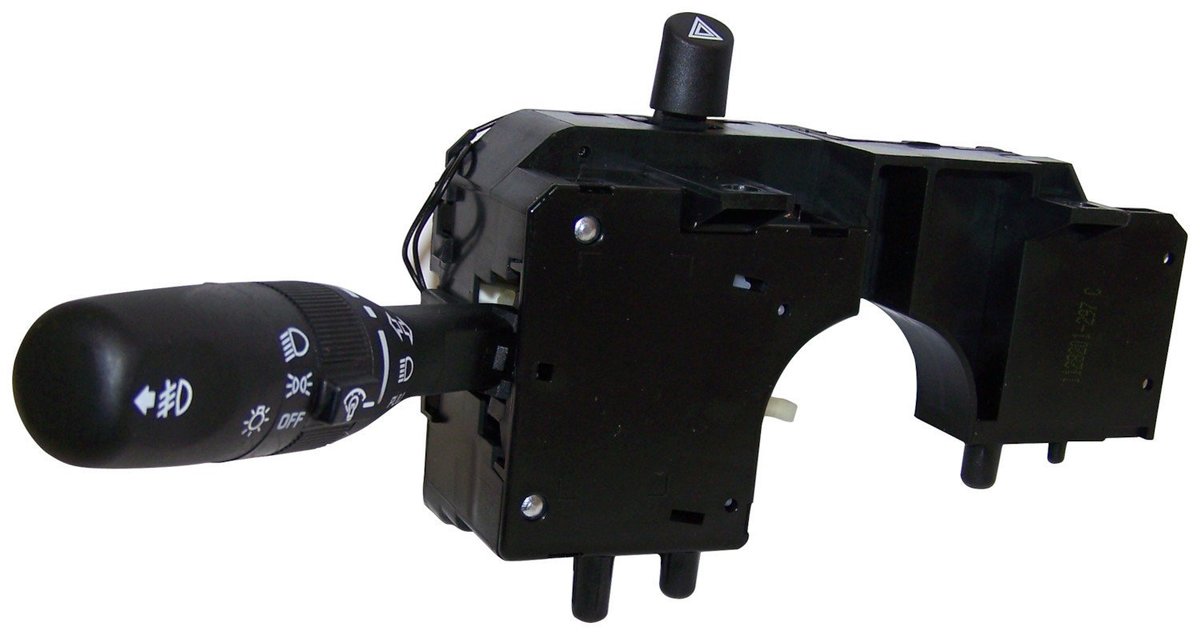

Multi Function Switch - MFS
MFS.... Multi Function Switch which is inside the clam shells on top of the steering column. This unit controls the low and high headlights, turn signals, emergency flashers, dimmer, windshield wipers, windshield washer, on some Jeeps it controls the fog lights.
If you were to remove 2 sometimes 3 screws from the bottom the clam shells that cover the steering column will come apart and the MFS will be screwed to the top of the column. There are two electrical harnesses, the larger is the one that I am referring to . You would need to disconnect the harness to test for voltage on the terminals of the MFS.
This is the type I was talking about..
