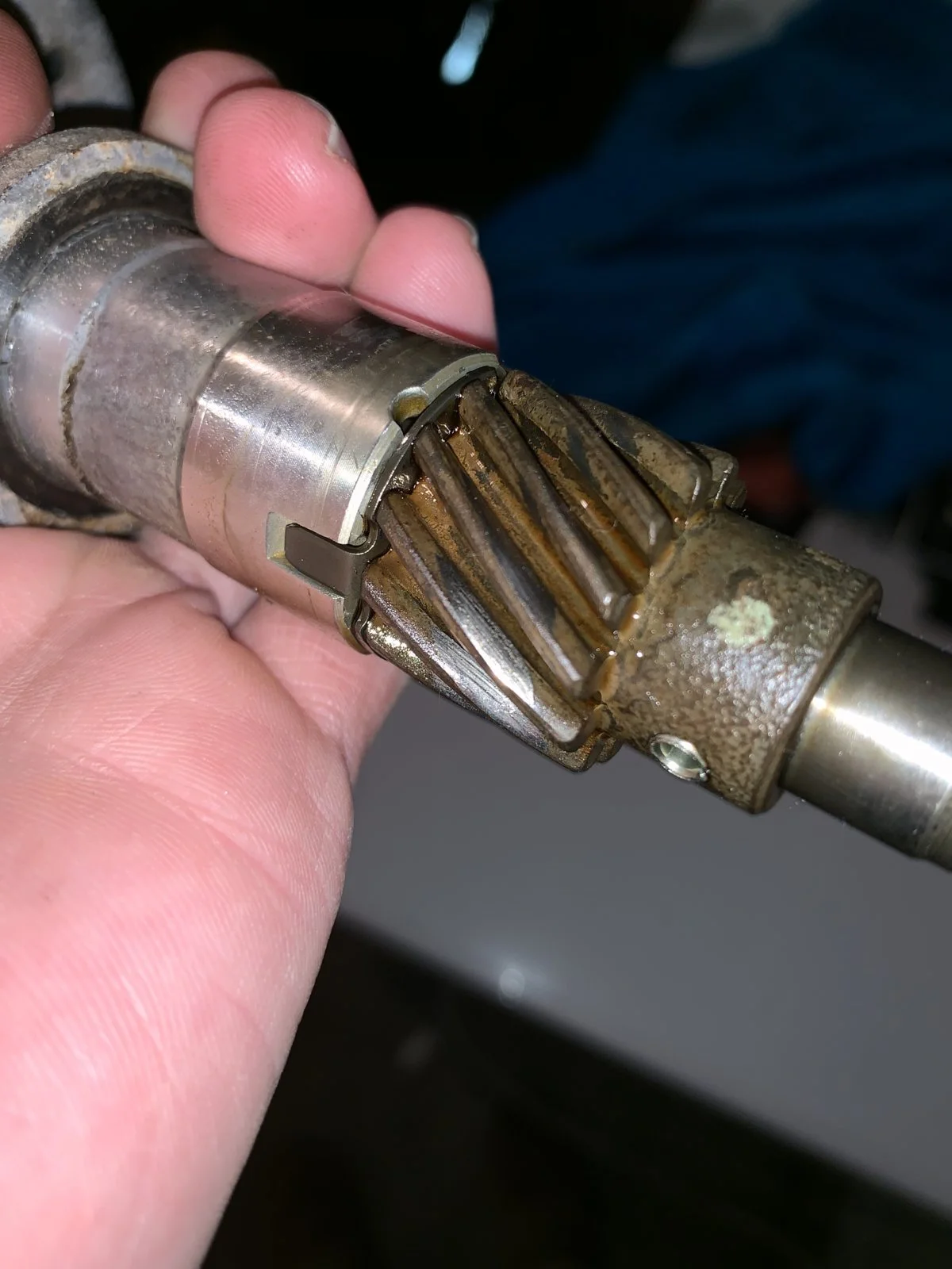

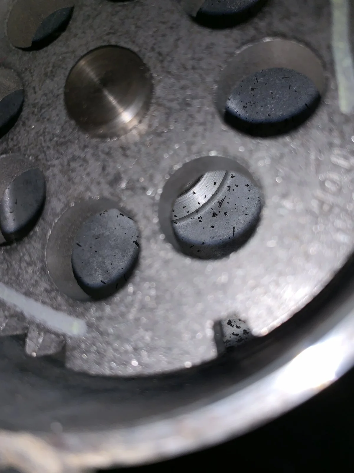

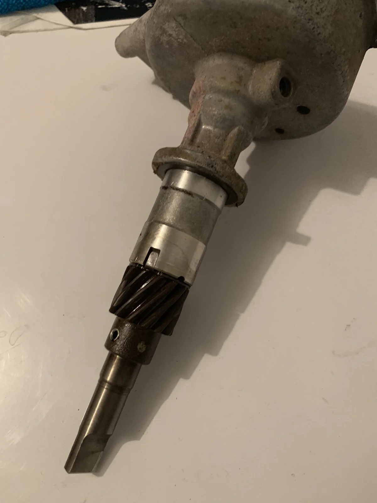

Okay everyone...it was the OPDA. Pulled the cover off the OPDA, here you can see shaving present from the upper bushing seizing up due to the oem terrible design....should be illegal for them not to recall all of them. After I then placed an Allen wrench in alignment hole to ensure the engine stays at top dead center - cranking the balancer until the holes lined up. I then removed the retaining bolt and the OPDA slid right out. THANK THE LORD the camshaft doesn’t show any wear while the gears on the opda are slightly worn. Camshaft seems to be doing okay. Hard to rotate the assembly by hand once it’s out because of the seized bushing and it makes the same exact screaming sound I had heard every time I started it up by rotating it in my hand.

You caught it just in time! You're lucky the camshaft doesn't show any signs of wear, as that involves taking the engine apart.
It's weird how this works. I've had two 2005s, and neither of them ever did this, yet some people get it. It's just hit and miss really. I always keep a spare around though just incase.
Probably a wise thing to do! Honestly a massive relief that the cam gear wasn’t worn...I’ve done cams, heads, lifters and all of that on my 1968 F250 camper special 5.7L V8 (my daily driver while this project is underway) and I would never wish the pain it was to replace a cam on anyone. 😕 crossing my fingers installing the new one tomorrow. I’ll keep y’all updated.
