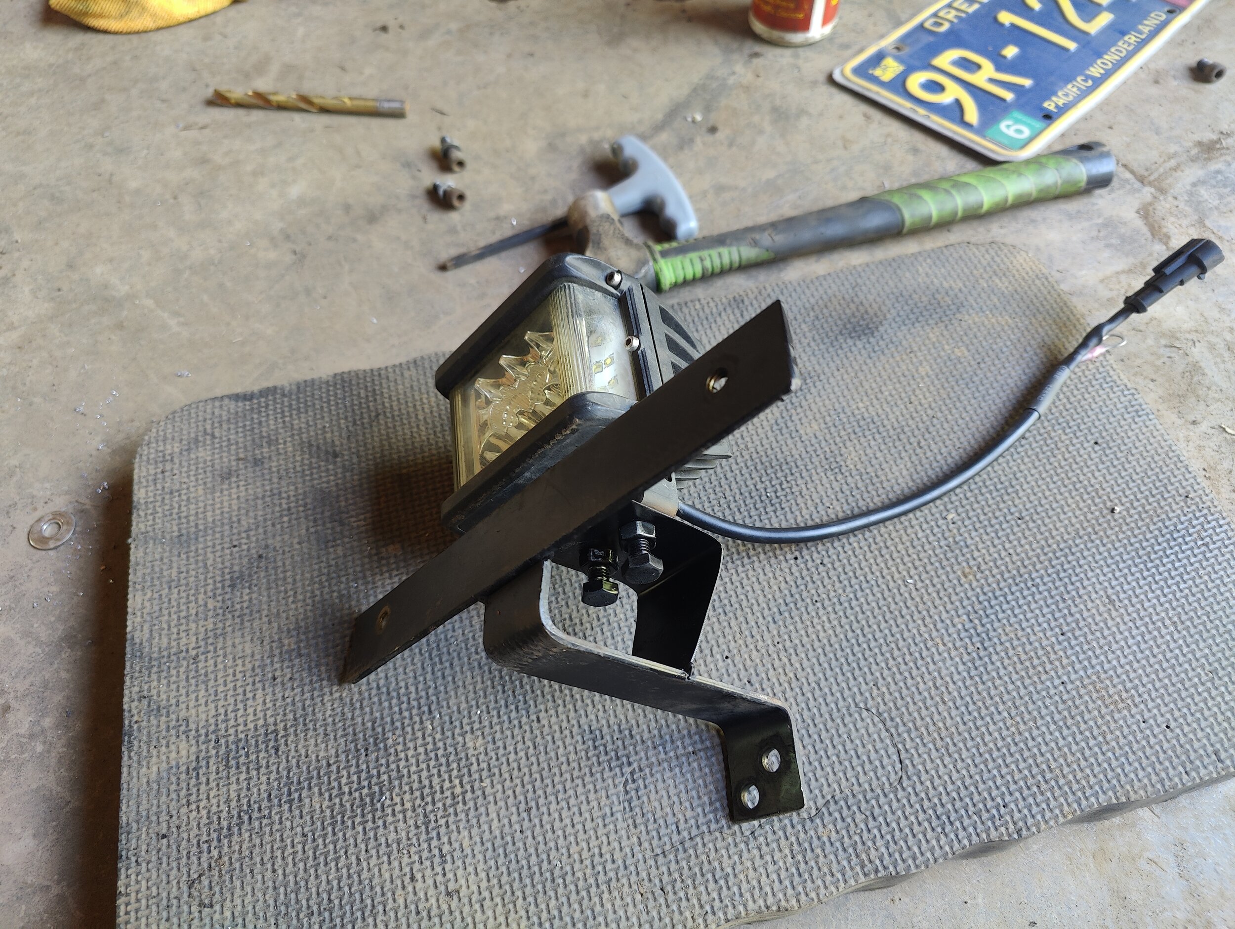

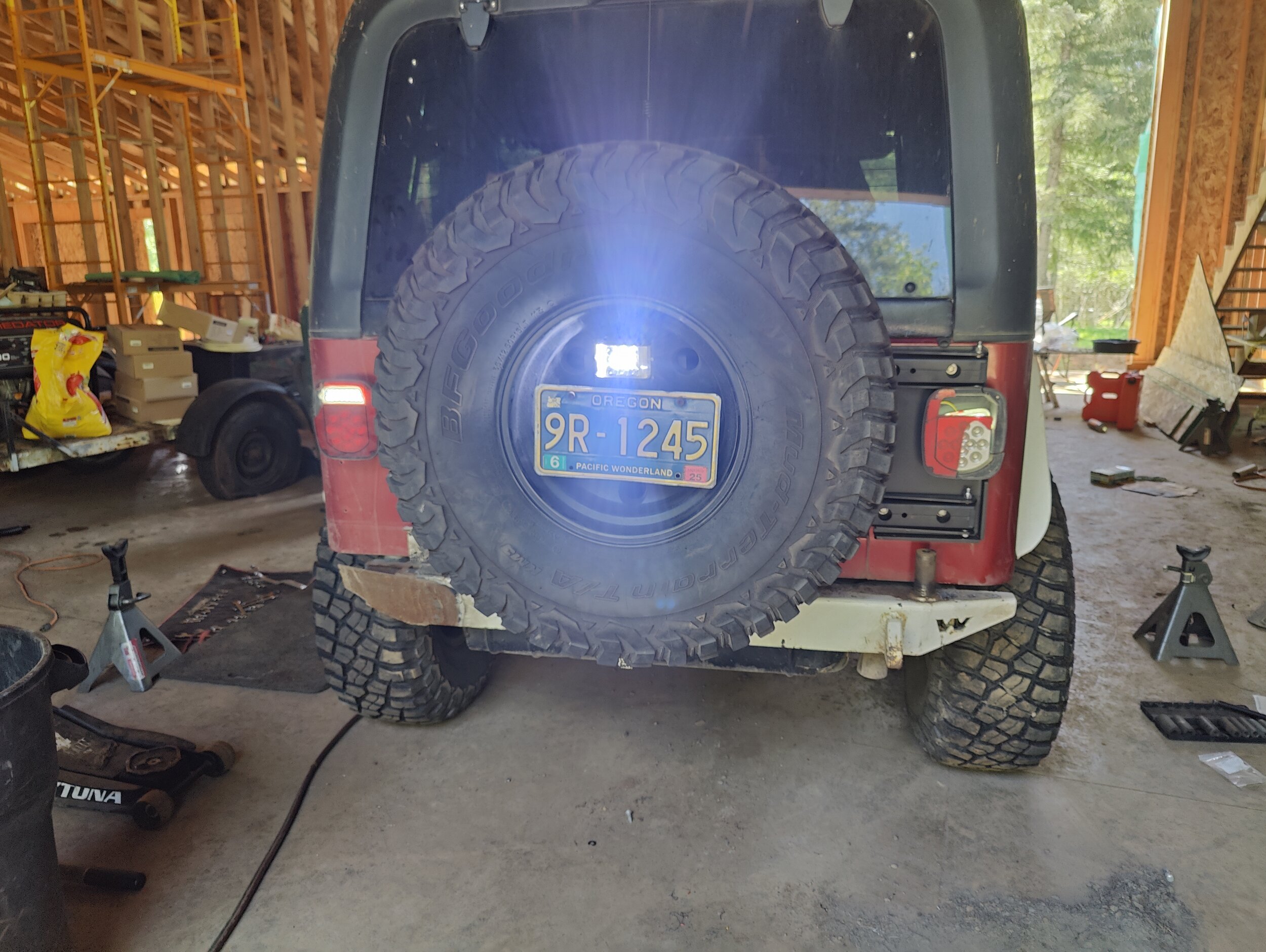

So I did a thing...removed the Warn swing out tire carrier. Replaced it with Morryde heavy duty hinges and a Rugged Ridge spare tire carrier. I modified my license plate bracket to hold my pod light ala brake and reverse...love this spot so much more because it doesn't glare through the rear window. Torched a hole in the carrier to route wiring.
Spare tire removal is basically the same as before...1/4 hex key...remove license plate bolts, then two bolts behind it...unplug the pod light and remove the spare. Easy. Might even mount a hex wrench somewhere.

Did your wife rear-end you again?!?!? (Broken taillight)
