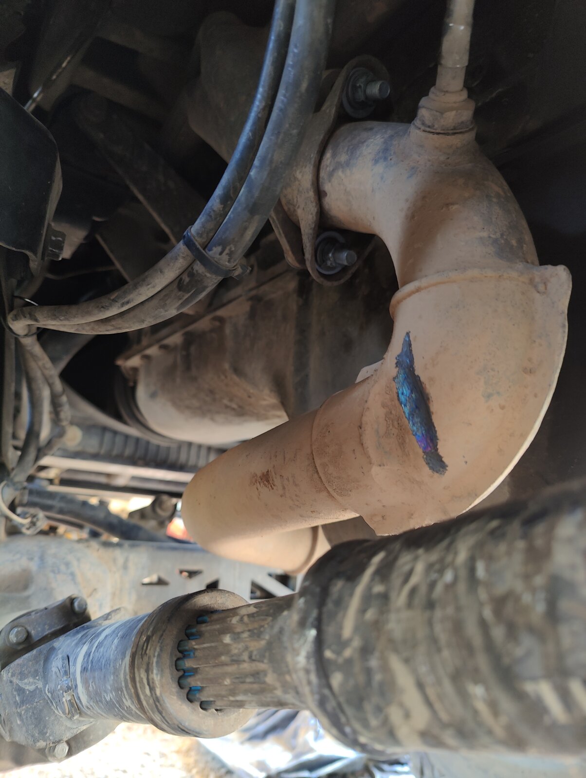

I also want to replace the pipe from my header to the cat. I have a new Walker one...going to paint it with high temp paint, wrap it in DEI exhaust wrap, and put a v band clamp just in front of the cat so I can pull that section without dropping the skid plate. I think keeping all that exhaust heat out of the oil might help.
My front axle shaft is rubbing the exhaust and I'd like to fix that... seems to contribute to the exhaust bolts loosing up and the donut seal blowing out frequently.

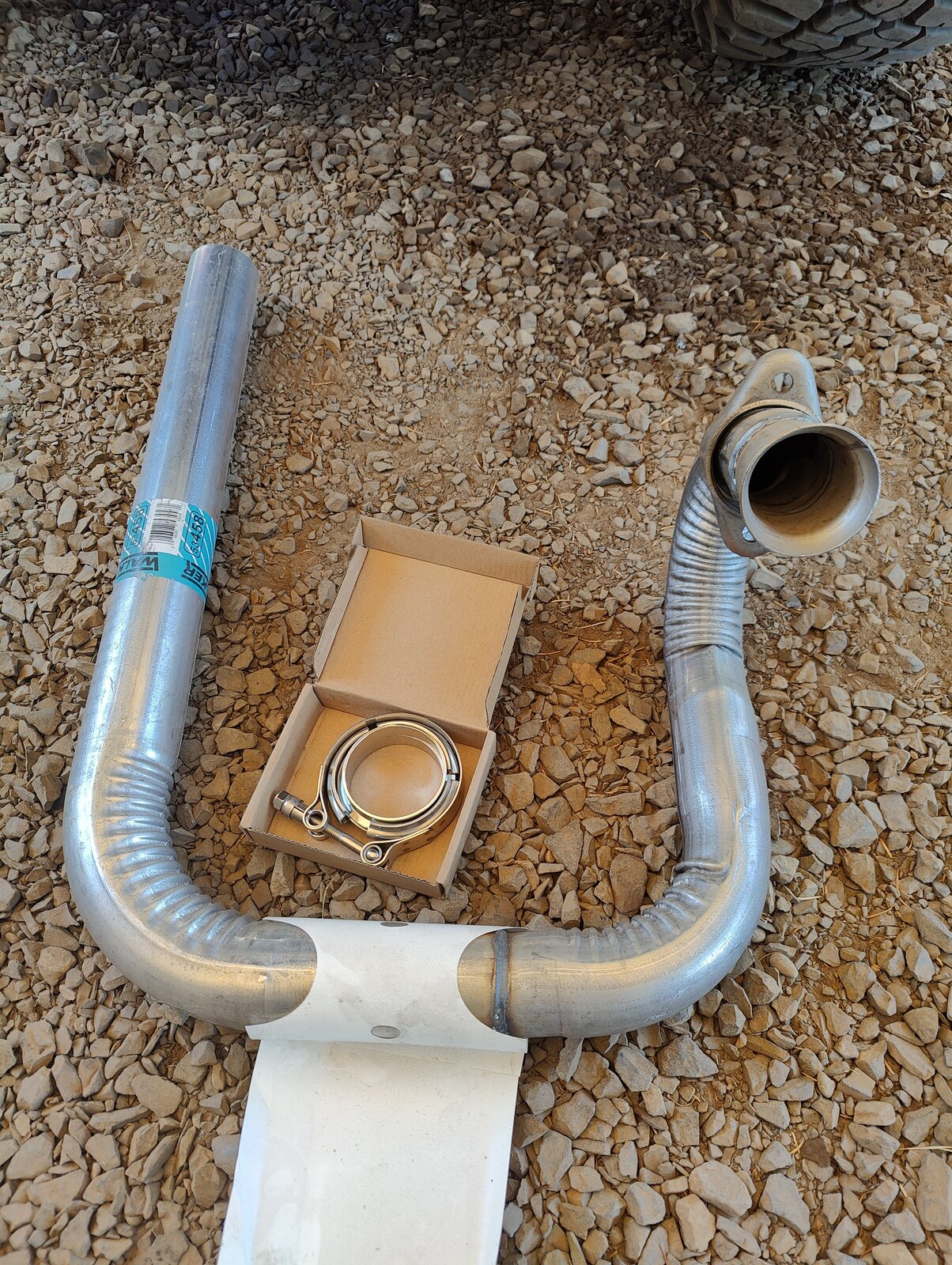

Got exhaust wrap in, a flex joint and a v band... wracking my head because the walker down pipe doesn't meet my expectations. I clocked the exhaust farther from the front driveshaft but I want 1/2" of clearance not an 1/8". Probably going to order some mandrel bent pieces and weld my own. Maybe this is the time to get that Rogue Fab bender and TIG welder I've always wanted.
-Mac
That would be a very easy part to make with mandrel bends. Fetch up one of the expanders, do short 1/2" slip fit joints with it, avoid anything heavier than 16 gauge because you can't expand it. When I reworked mine from scratch, I took the opportunity to correct the line from the front of the sump back and bump it up for the muffler and cat when used with a raised belly skid rather than just angle it upwards from the oil pan wrap-around.

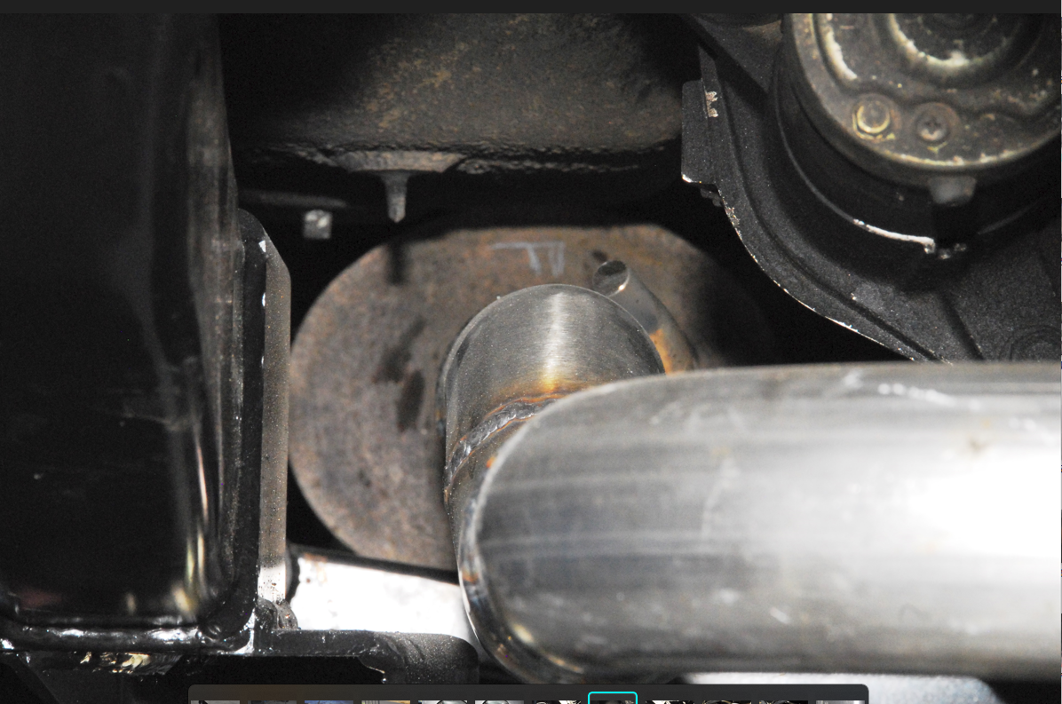

Oh these welds are terrible. Need a better hood. Need light. Need a fixture table. But it works and when I wrap it nobody but you and the entire internet will know! Used stainless .030 wire with 75/25 and it should have been tri but it was the bottle I had. One of these days I'll make a TIG version.
