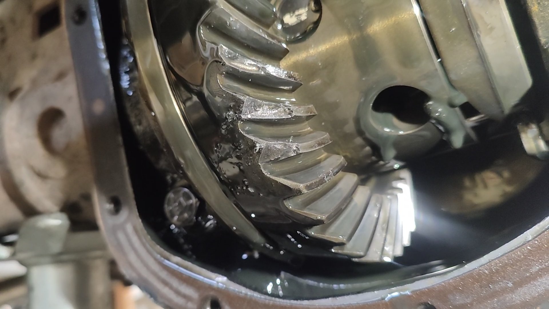

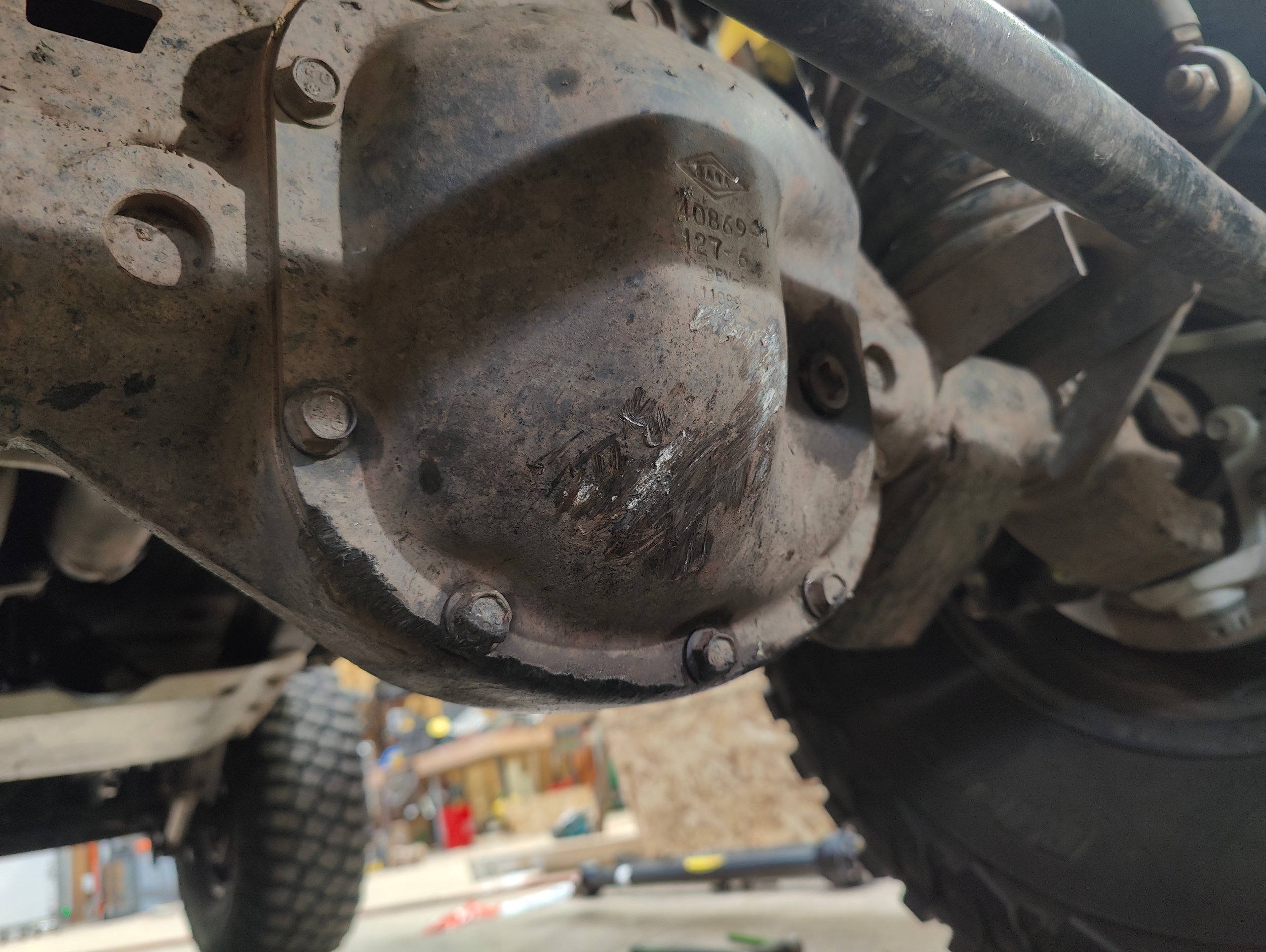

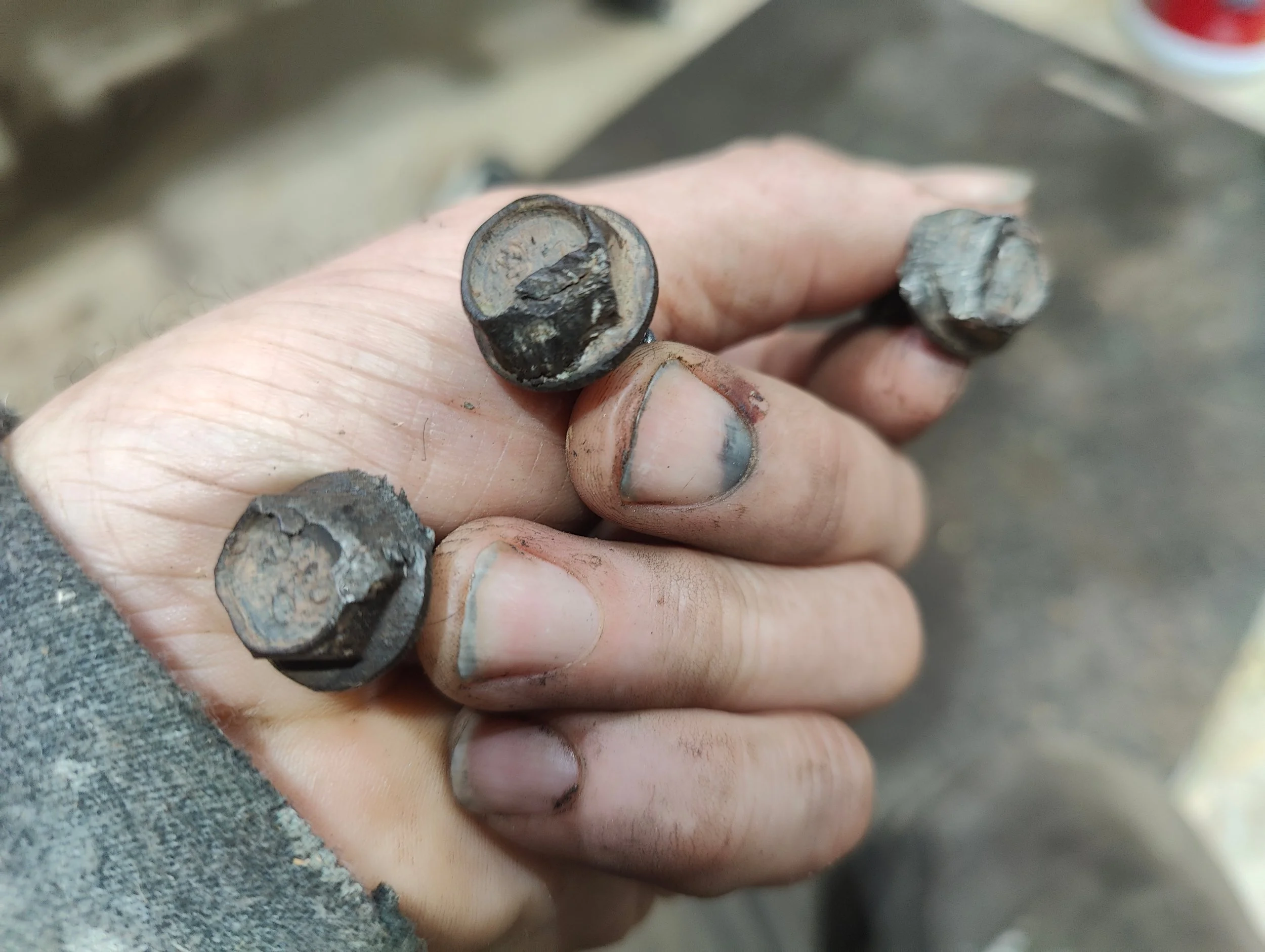

Pulled the diff cover to play with the e-locker. Found three teeth in the bottom of the housing. E-locker is kinda working... pulled more wire into the housing to let the stator assembly rotate more freely.

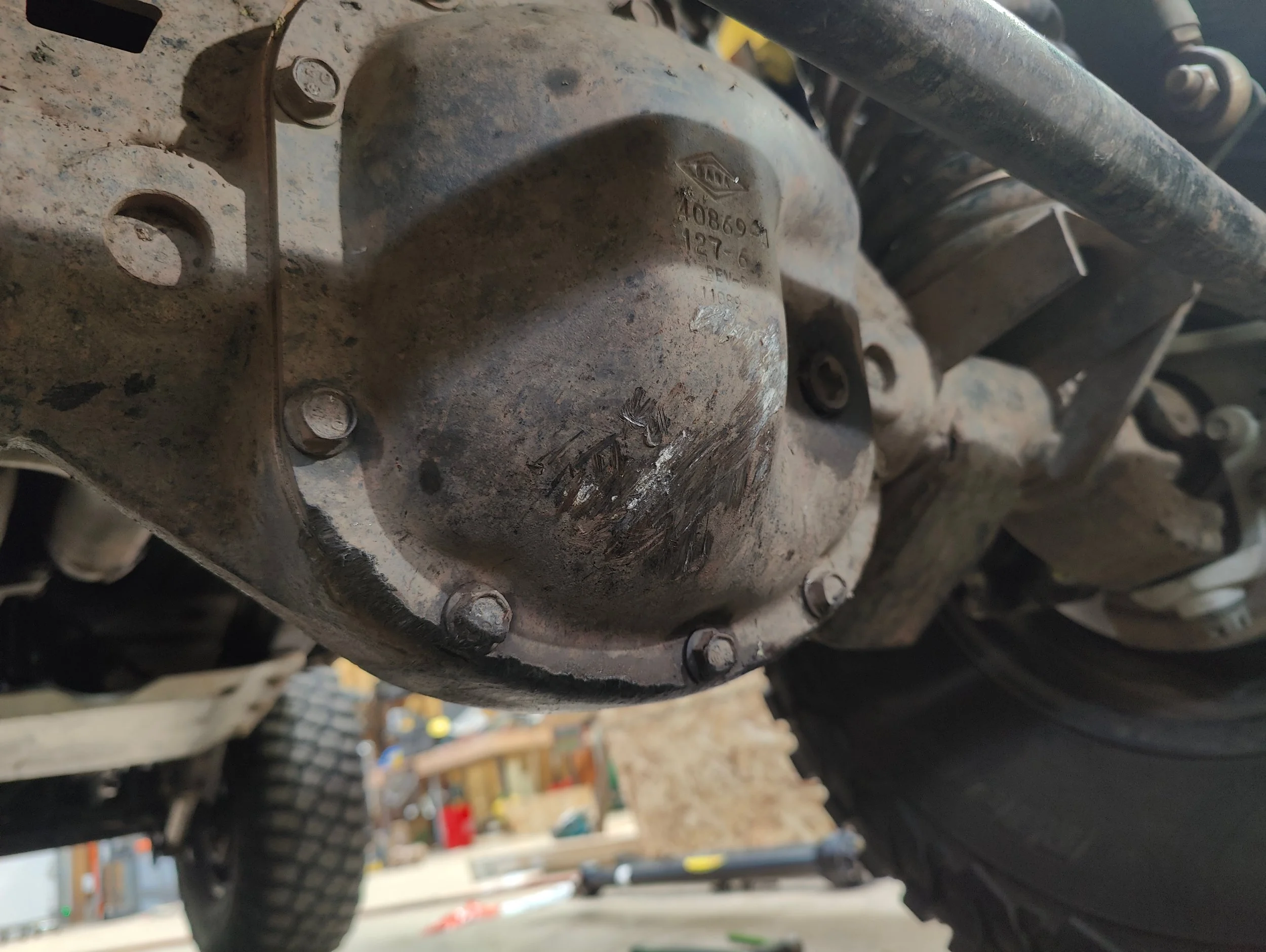

Pulled the Lube Locker off. All the bottom silicone traces fell off. Sealed it up with Right Stuff and pumped it full of Lucas 85w140 after replacing the pinion seal.

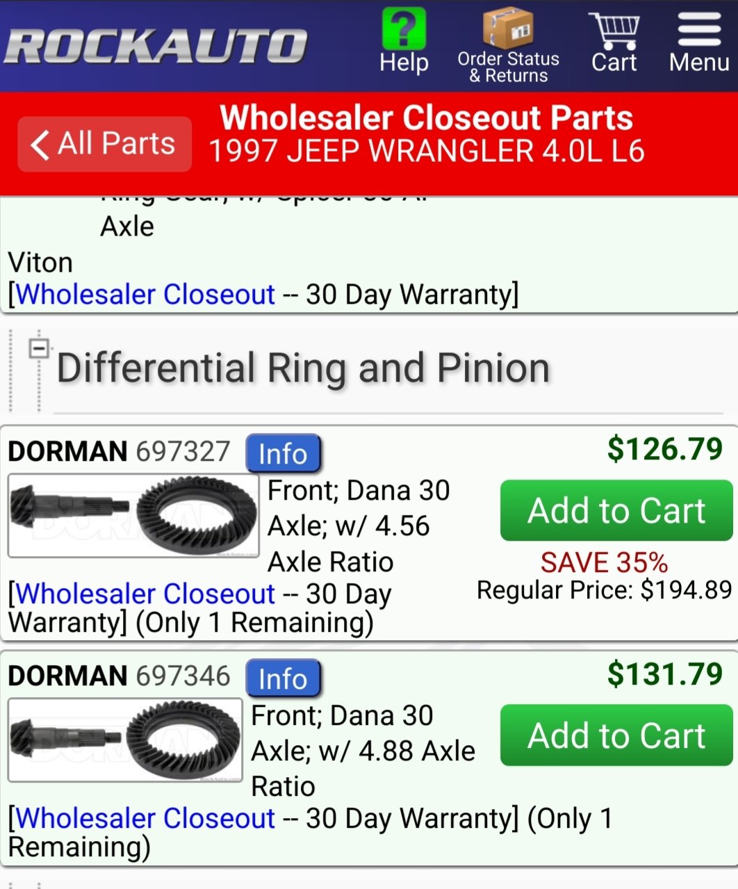

Those teeth have probably been off for a while. I don't think I've opened it up since I did the regear. It'll be fine until I get my credit card down from the giant crater I made doing an outboard.
Probably will order 5.13s for the front and back too...cause why the hell not.

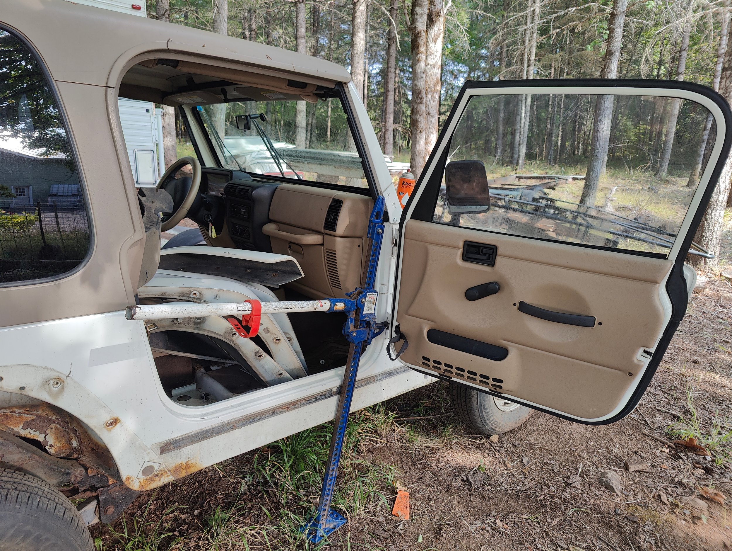

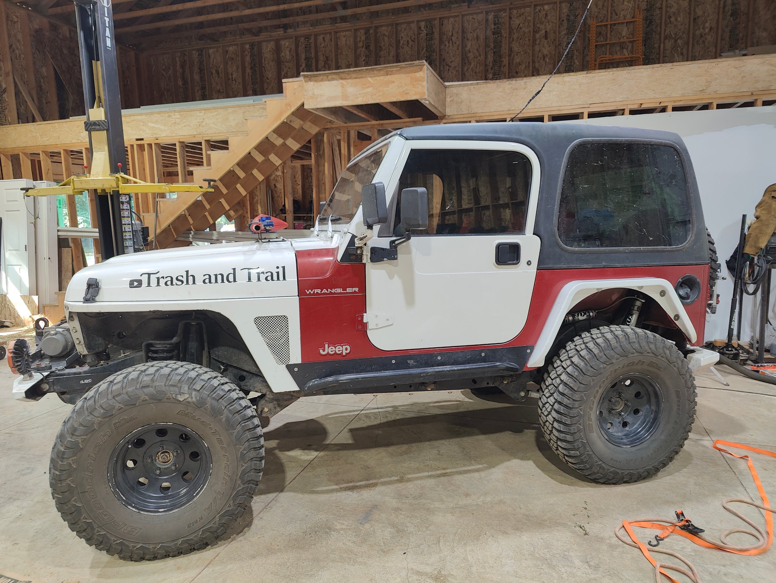

Was able to bolt up the new shaft without dropping the skid...body lift is convenient and years of contorting myself working on cars has taught me a few skills.

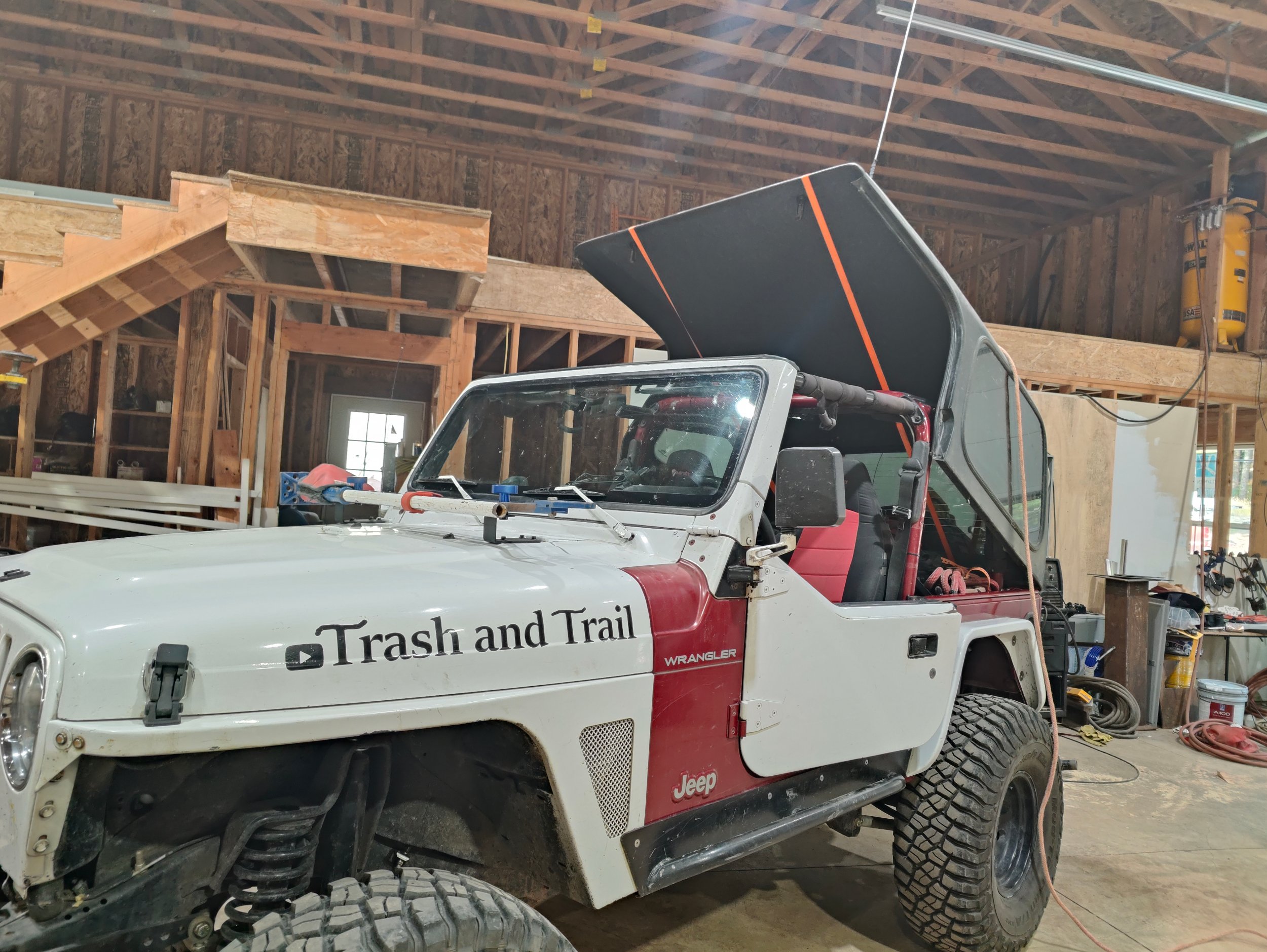

Hard top and door probably going on this afternoon. Raining steady outside.

Sorry to hear about the busted teeth.,,,,, Know how it feels BTW... You could always go to a bigger front axle? Any idea when or how you busted those teeth?
Is there a larger axle in your future?
I keep wondering if my HP44 is going to survive those 38's I've got... But a Dana 60 just isn't in my cards.. Unless I could sell my HP44 for enough to help offset the Dana 60.

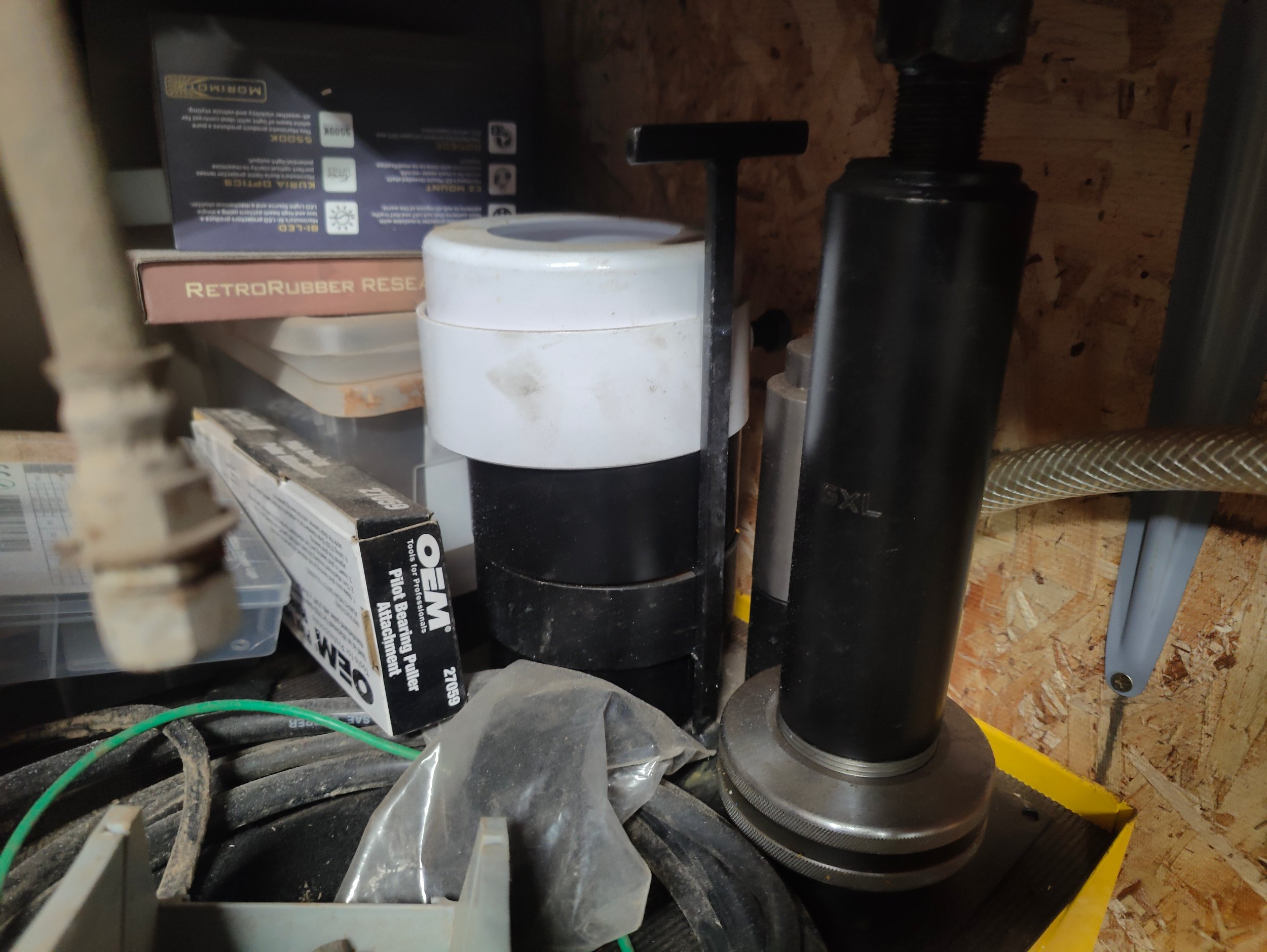

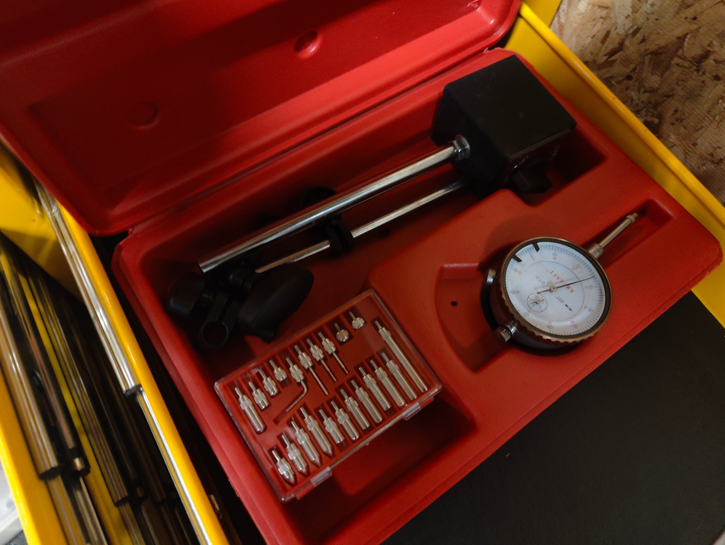

I know you do 95% of your own wrenching but do you know you to setup gears? Have the tools?
