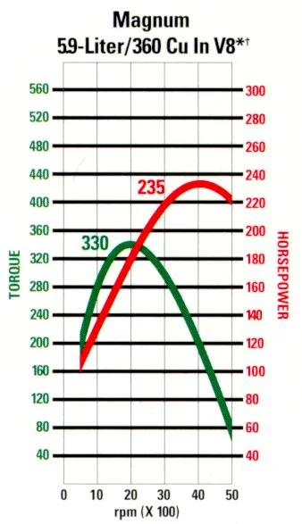

Dodge rated the stock 5.9 @
But most people reported closer to 400HP and 450TQ and it was easy to get more out of one too.....

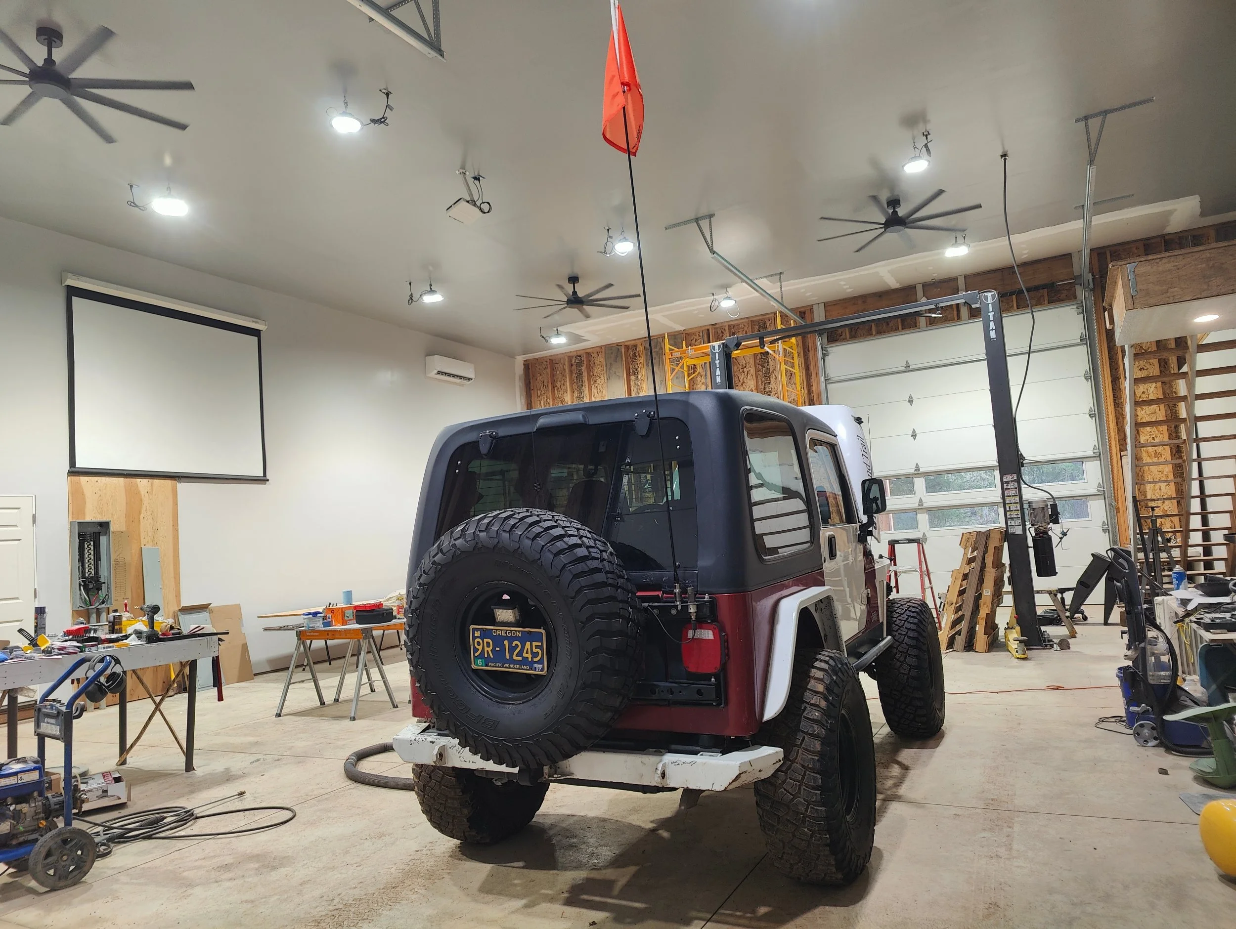

And as much as I love what @Woodrow is doing just south of me...I don't want my Jeep down for months on end. We use my Jeep to find trash in the woods...and I drive it to work every day. The Jeep gets .2 mpg better than my truck (and won't cost $80k plus to replace.)
Hence the spare engine. I can take my time and save up and do things right.
Meanwhile I've completed my preparation for Sand Hollow...
-Mac
-Mac
Looks like you have plenty of space for another jeep. Think of how much more trash you could haul in an LJ...
I see room for a golf simulator!
If he does get one he has to get the one that tilts with the lie and also has the arm that puts the balls on the tee.
I played Pebble Beach at one of our vendors offices in Korea that had one like that and it was really fun.
