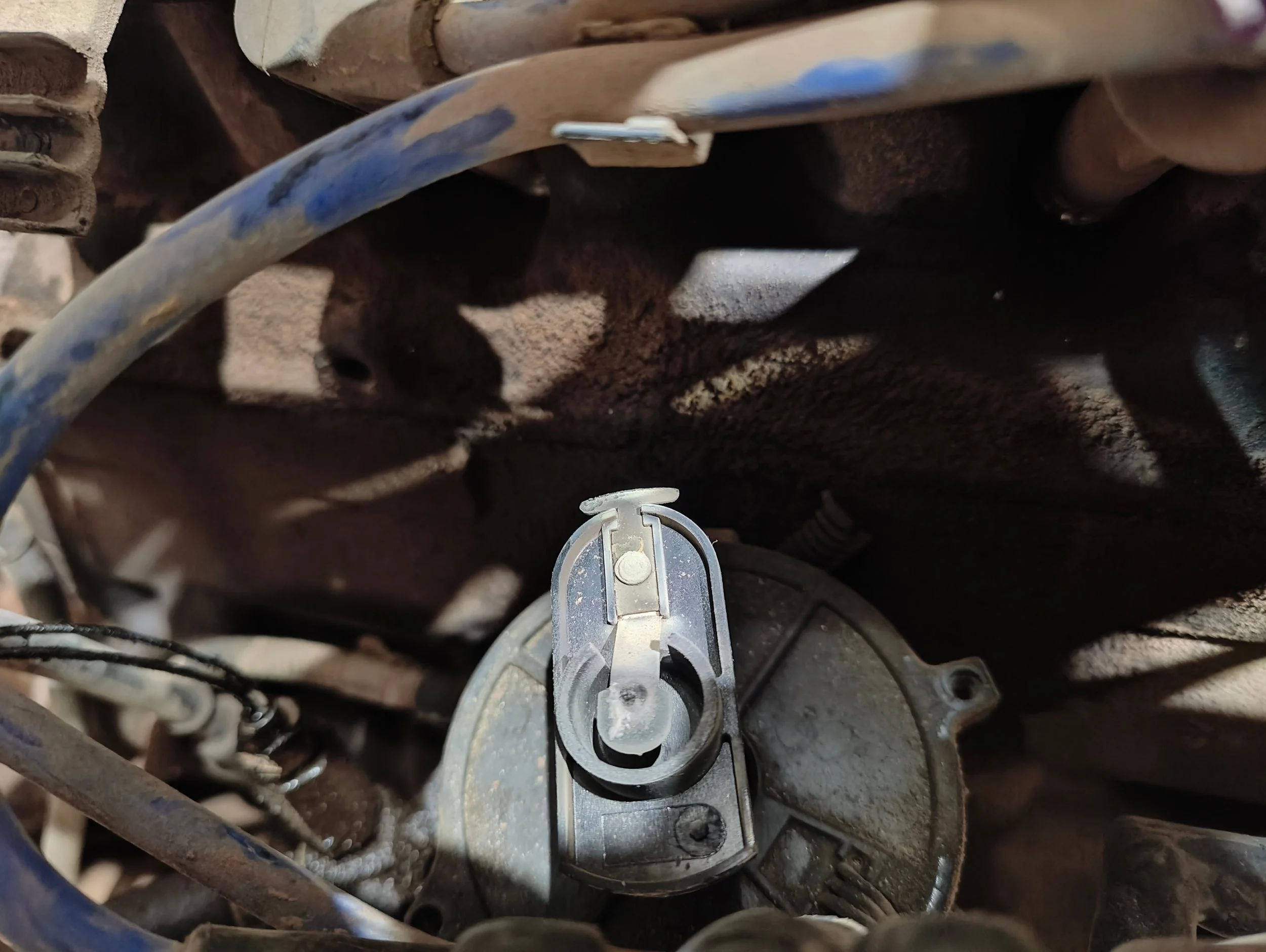

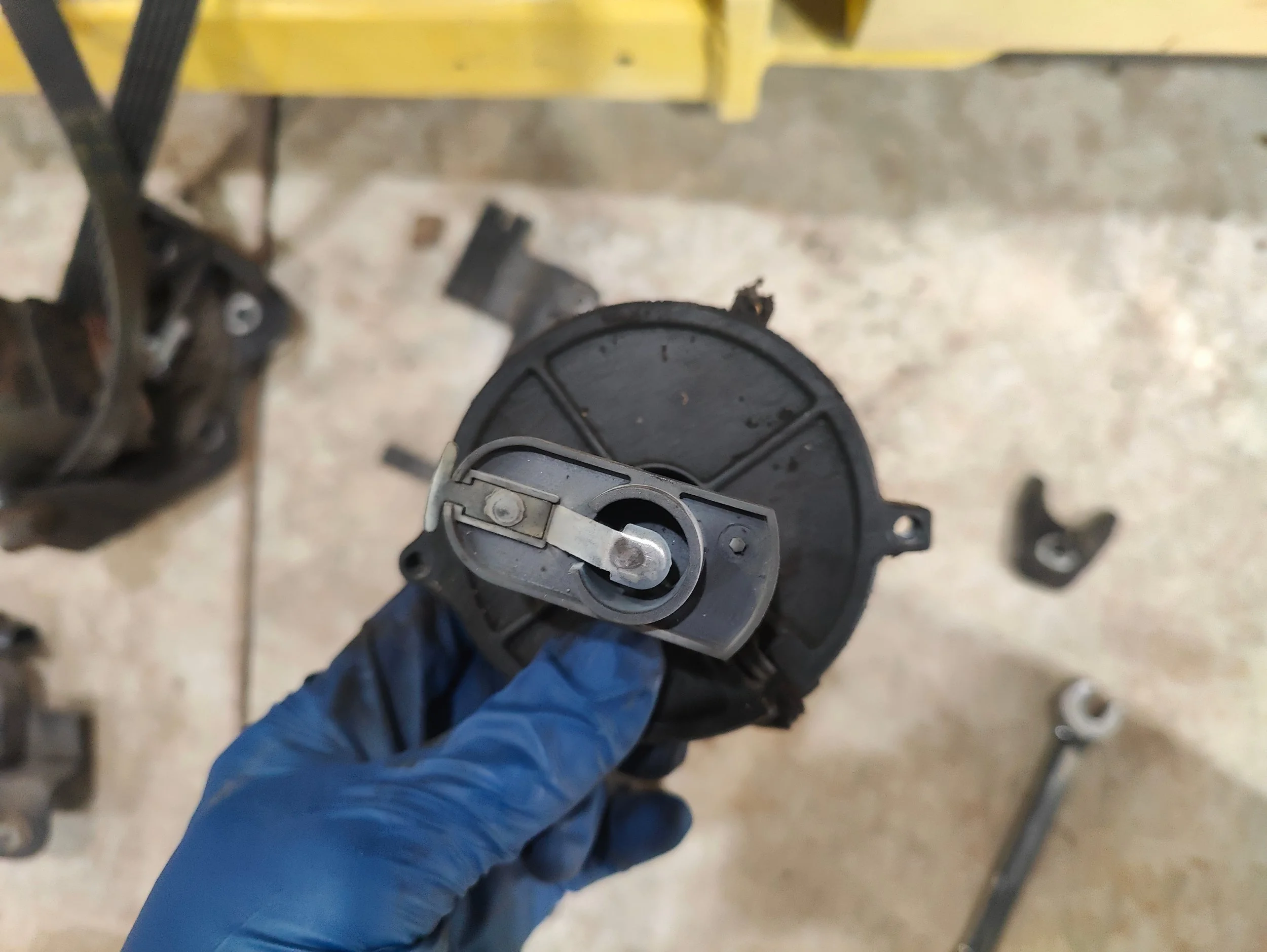

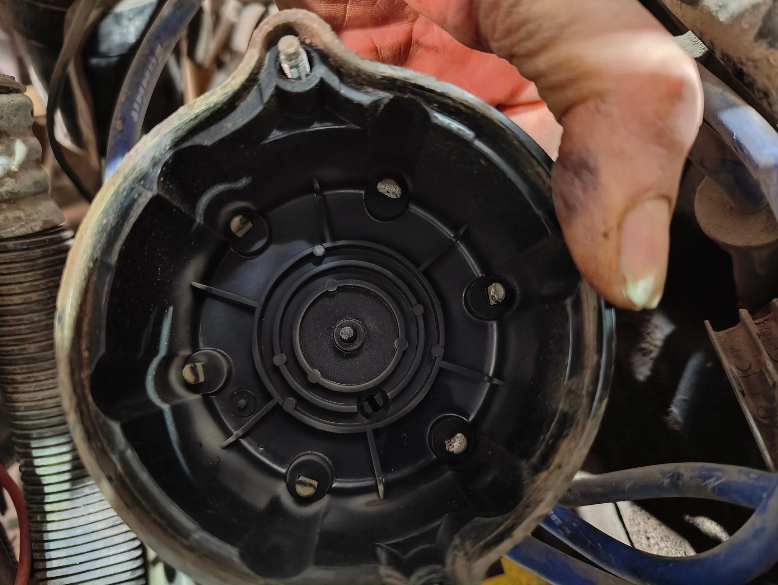

On a whim I decided to check the cap and rotor...
Hit them with some sandpaper and ordered another on Amazon. $70 for both. Went with Accel. Got five years out of the first one. Good enough for me.

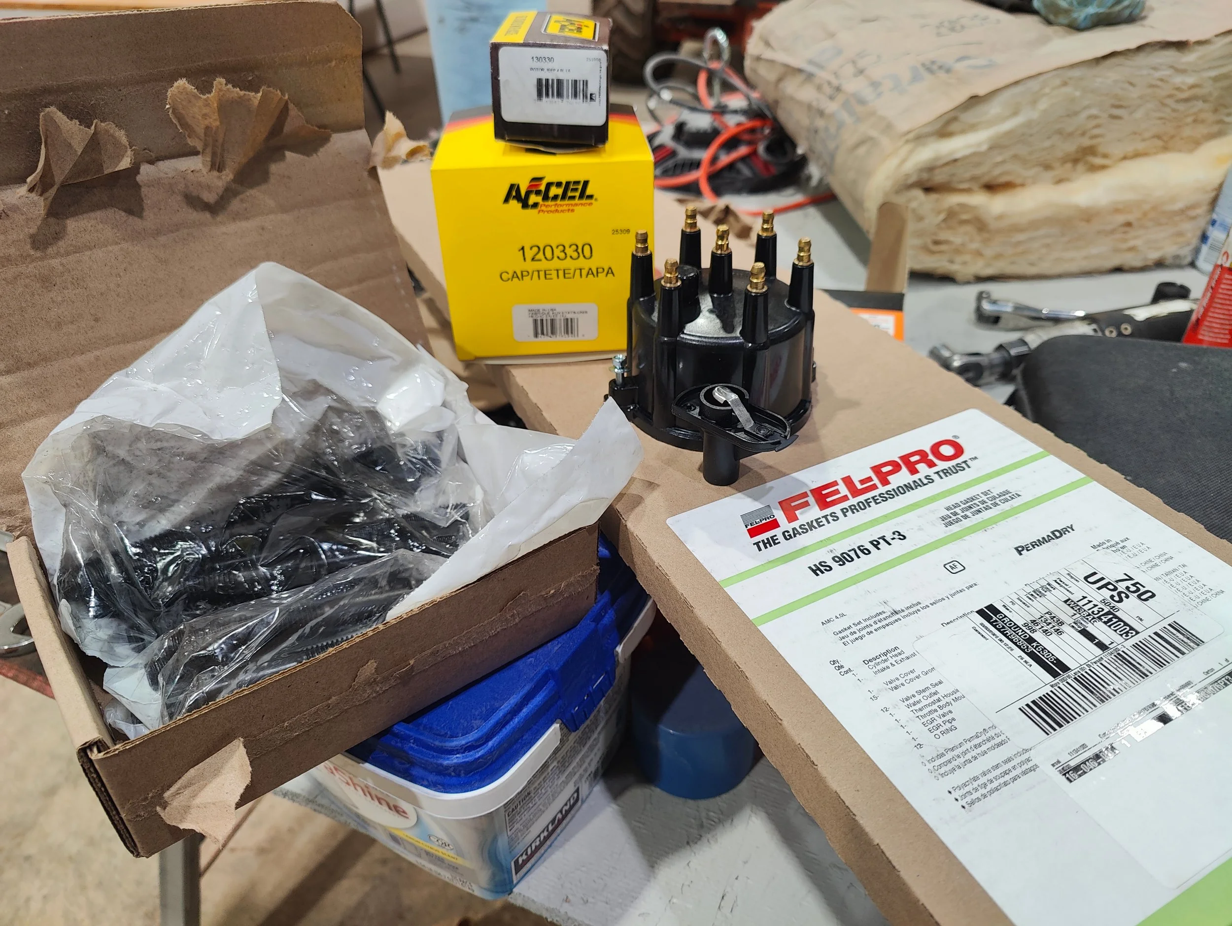

Replaced the cap and rotor. Also ordered a Felpro head gasket kit and studs/bolts since O'Reilly's gave me 15 percent off for spending more the $75 plus shipped home rather than spending an hour driving into town.
Also dropped off my new to me intake at a powder coating shop in town for high heat Cerekoting. Want to see if it drops my IATs.

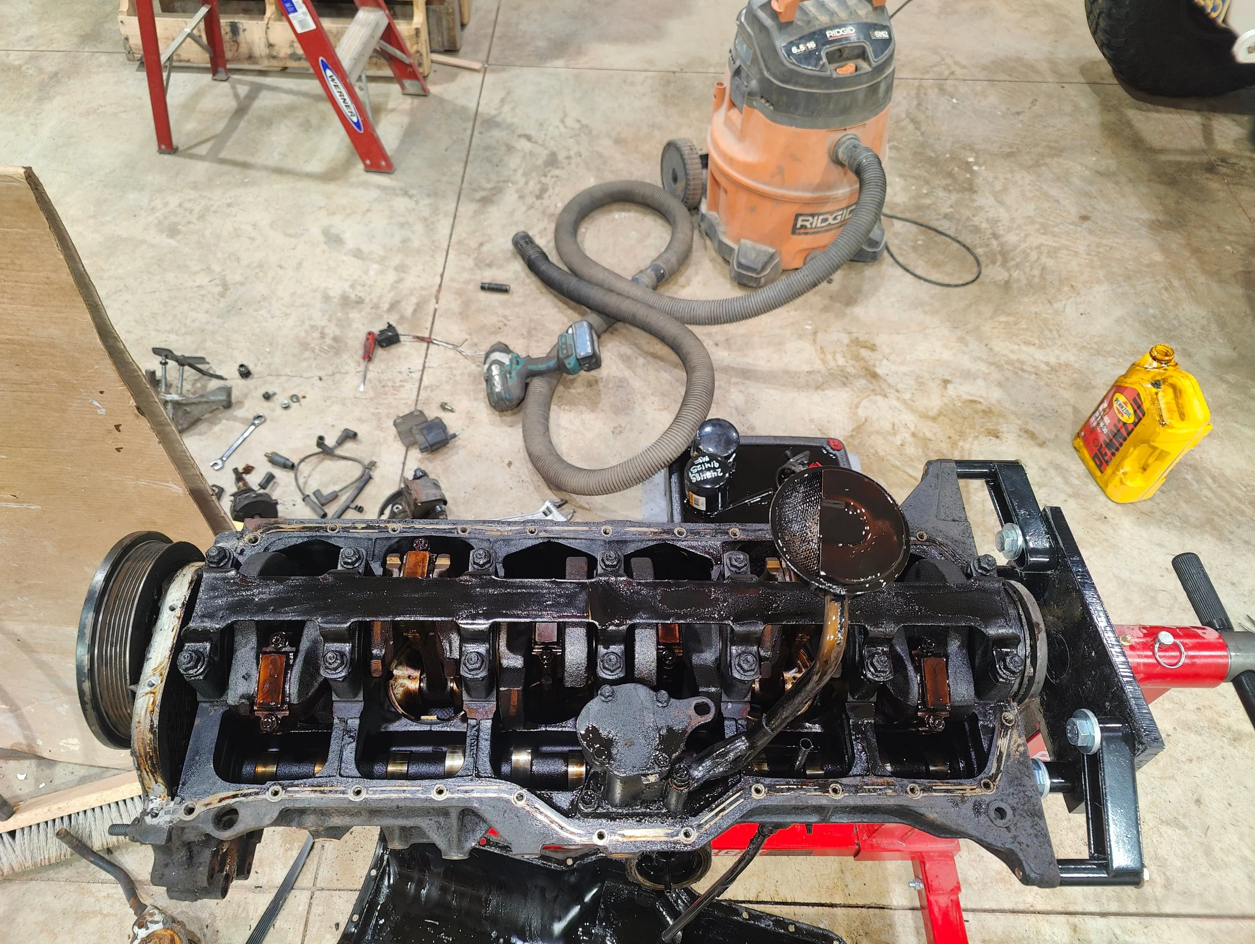

Dropped a quart of ATF down the yap and let the engine idle for 20 (and pressure washed off the mud), let it sit for an hour...ran it for another 20, then changed the oil. 3228 miles since the last oil change.

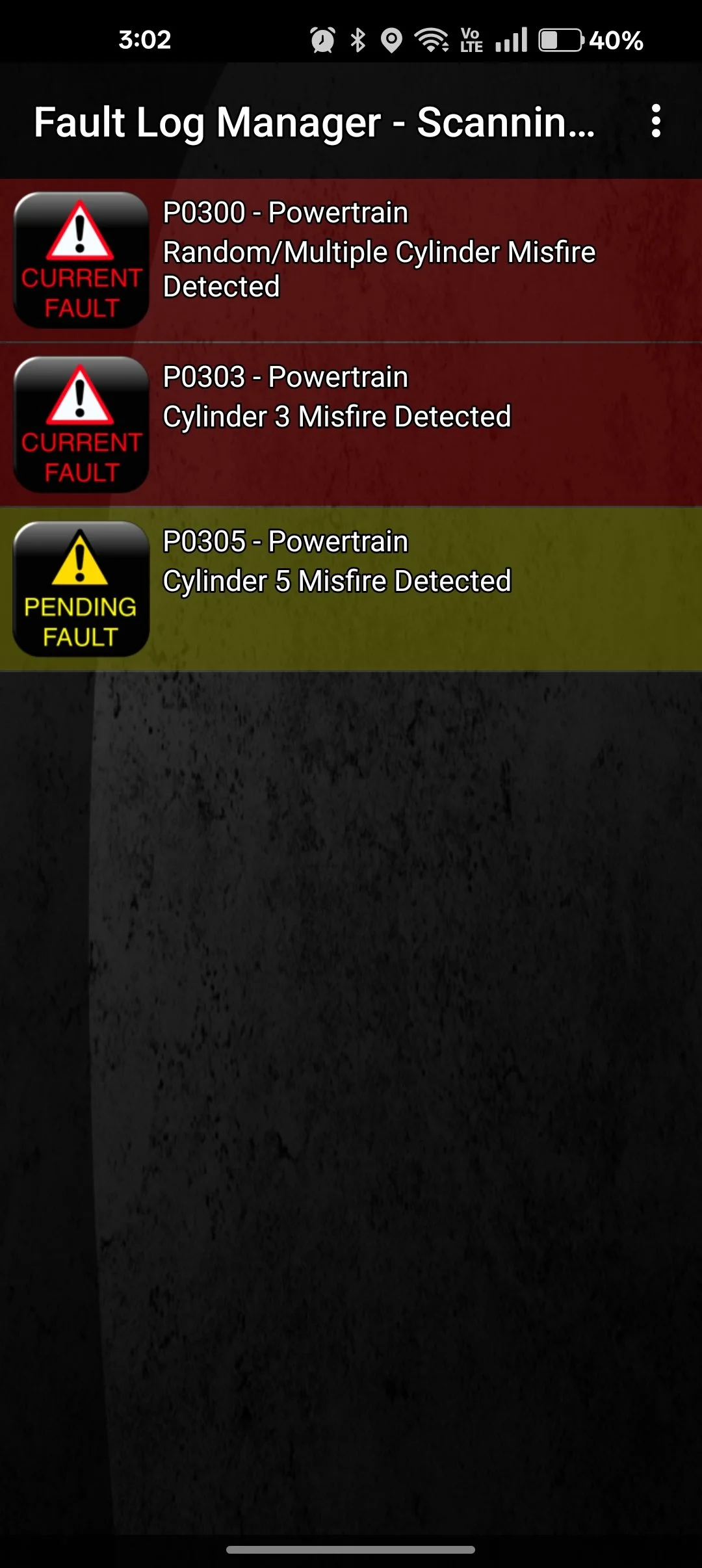

While idling the check engine light came on...so cap and rotor didn't solve the misfire.

Changed the oil. No change in engine behavior.

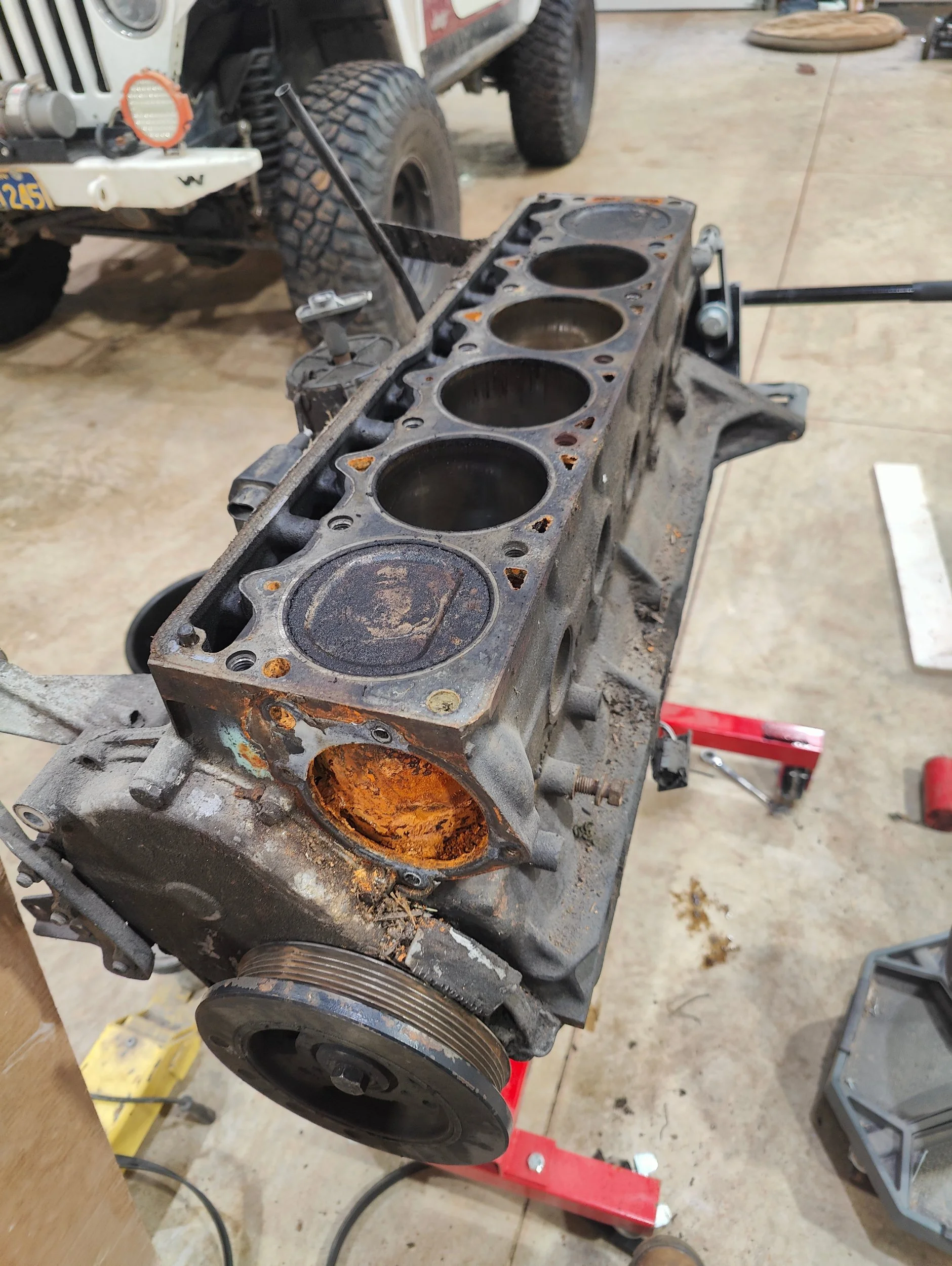

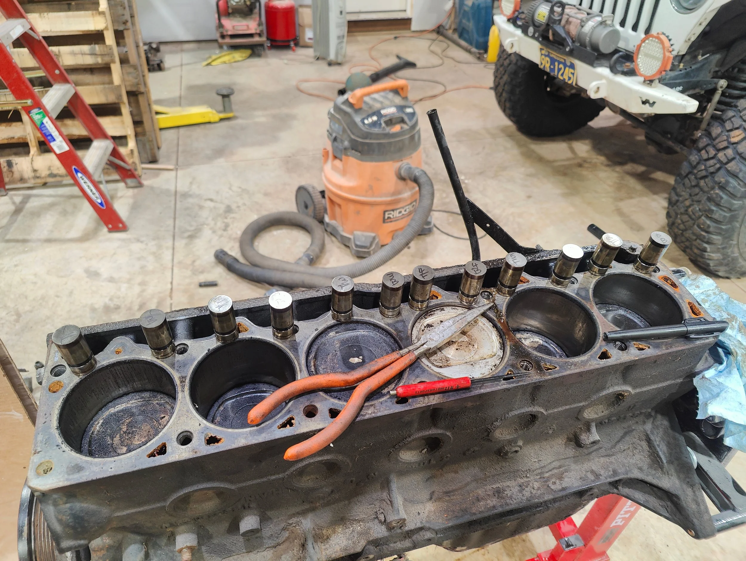

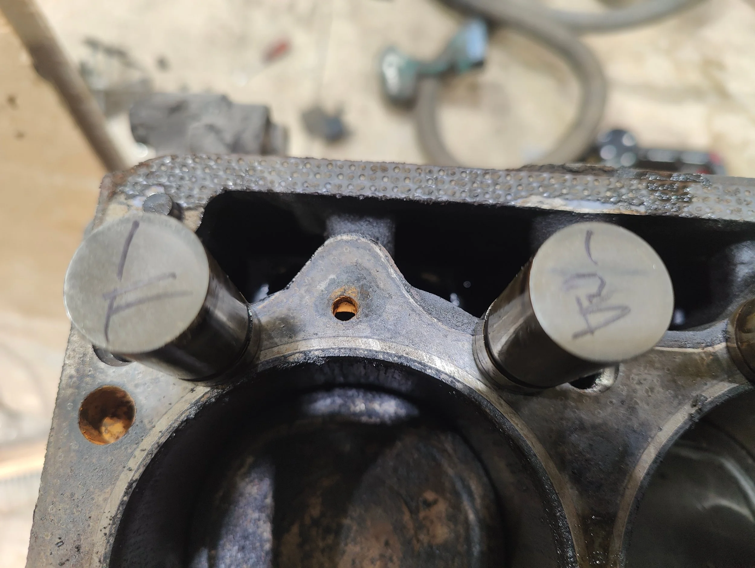

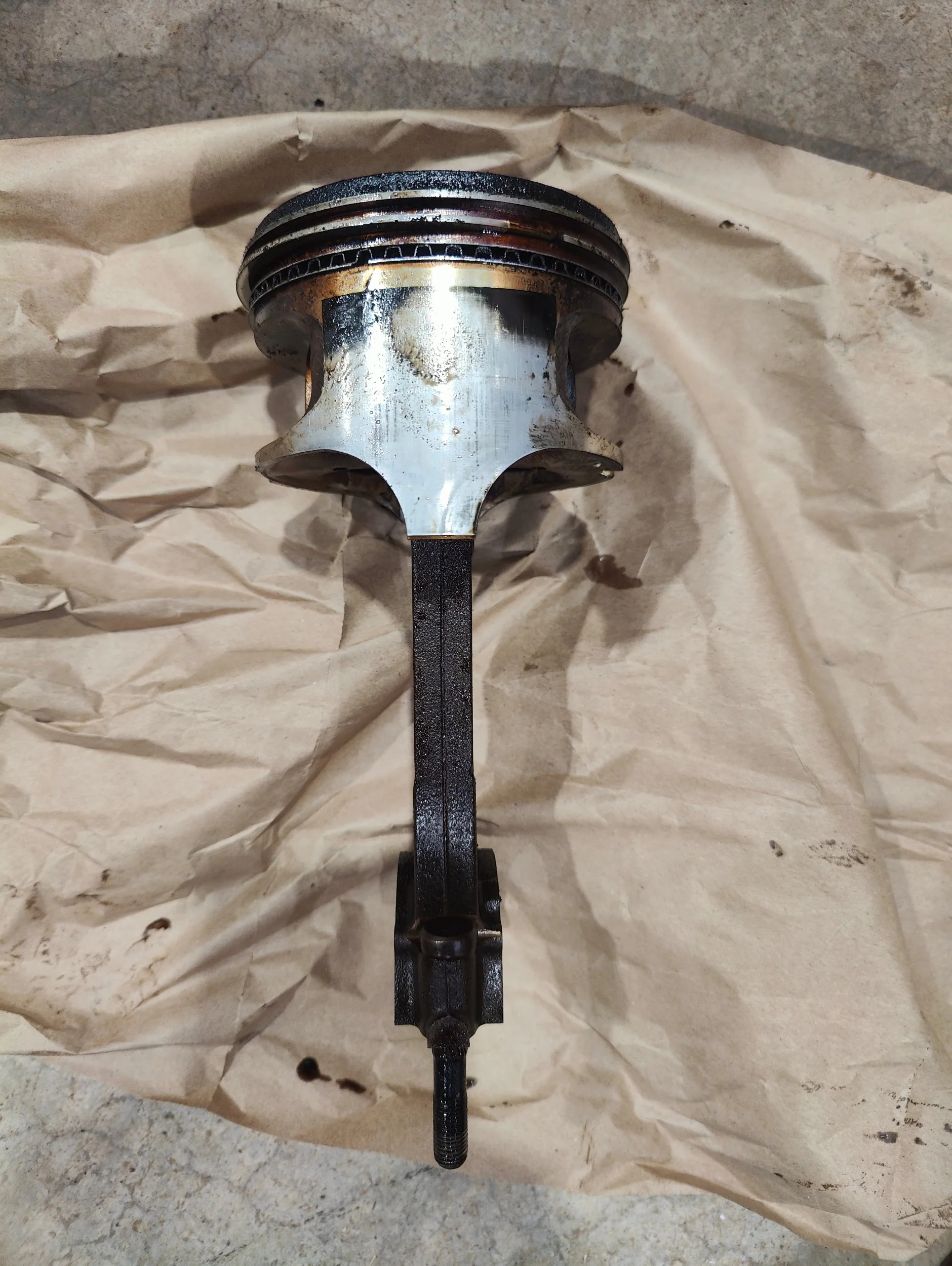

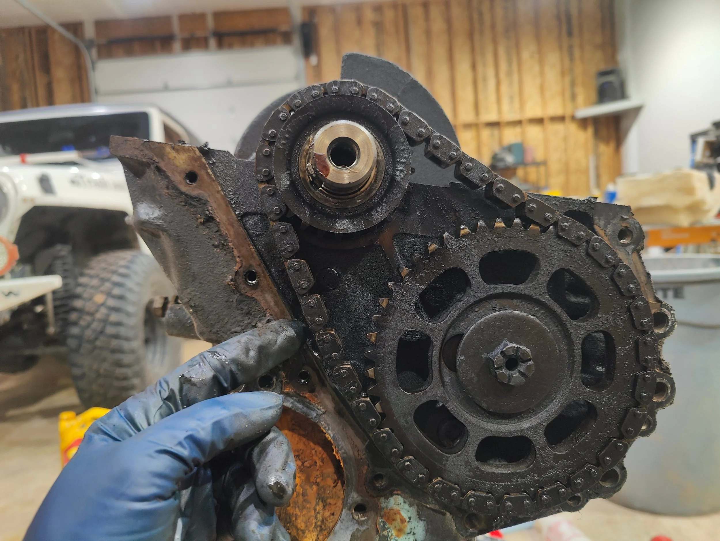

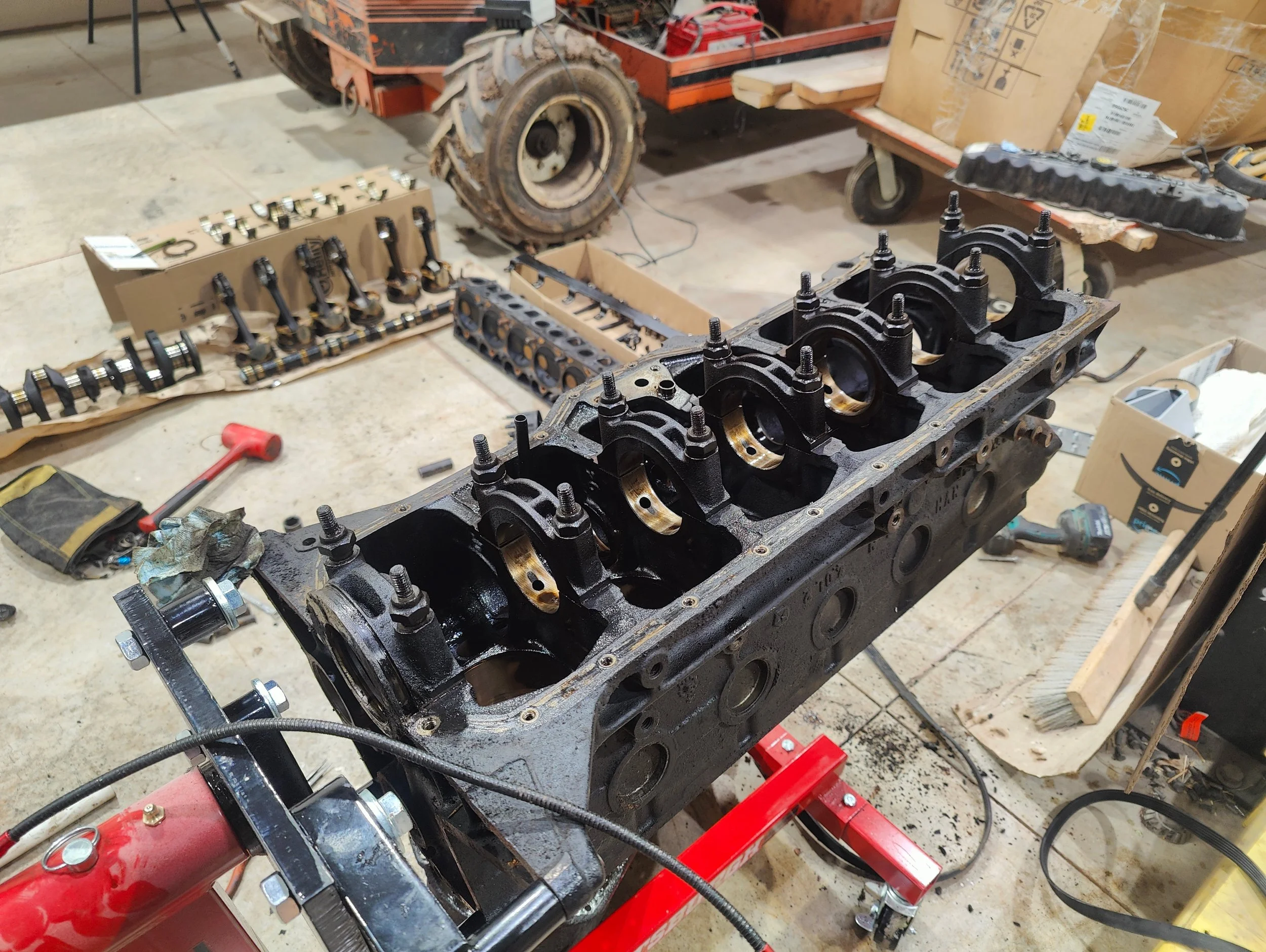

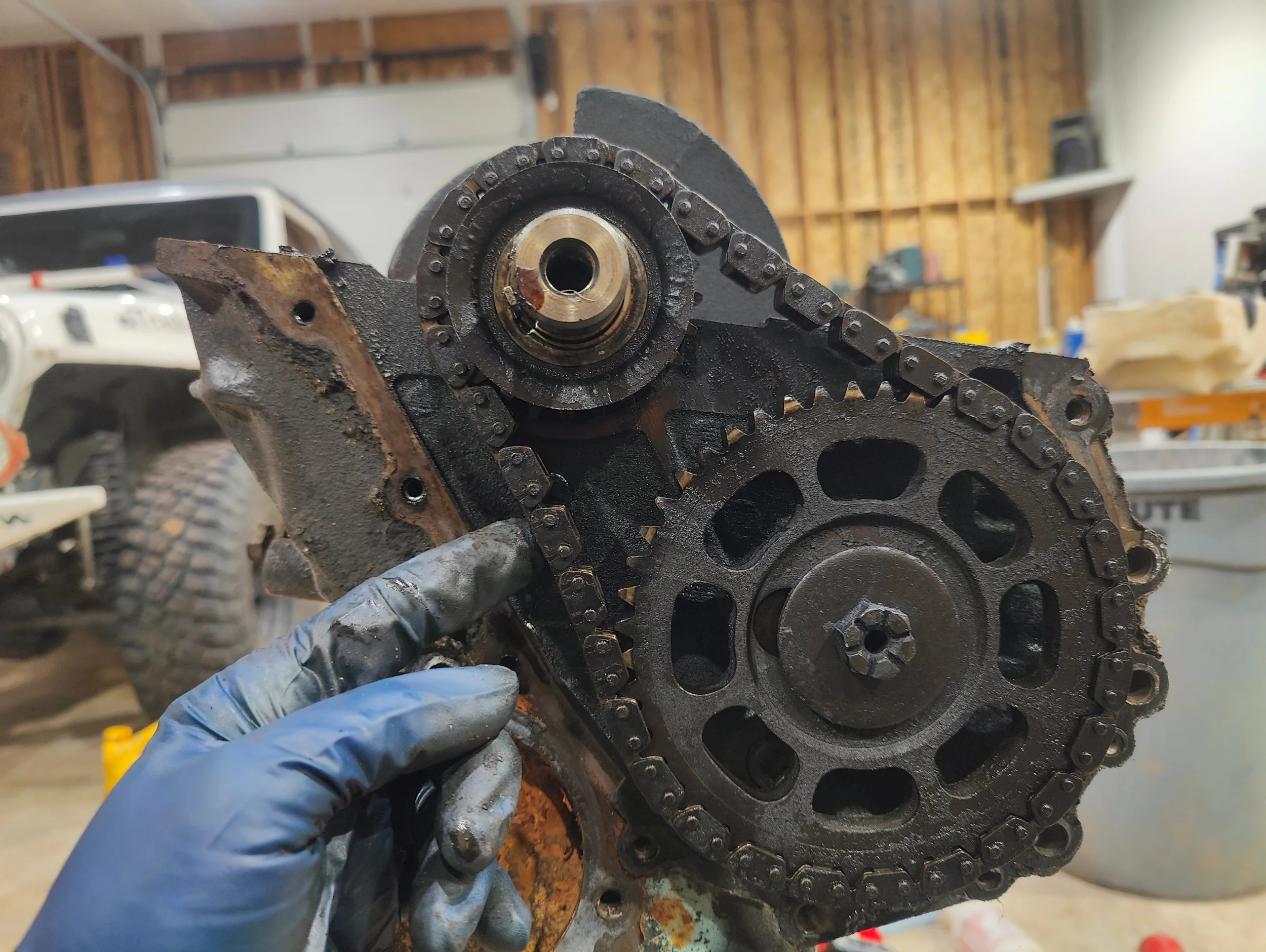

Block stripped. Going to the machine shop tomorrow.

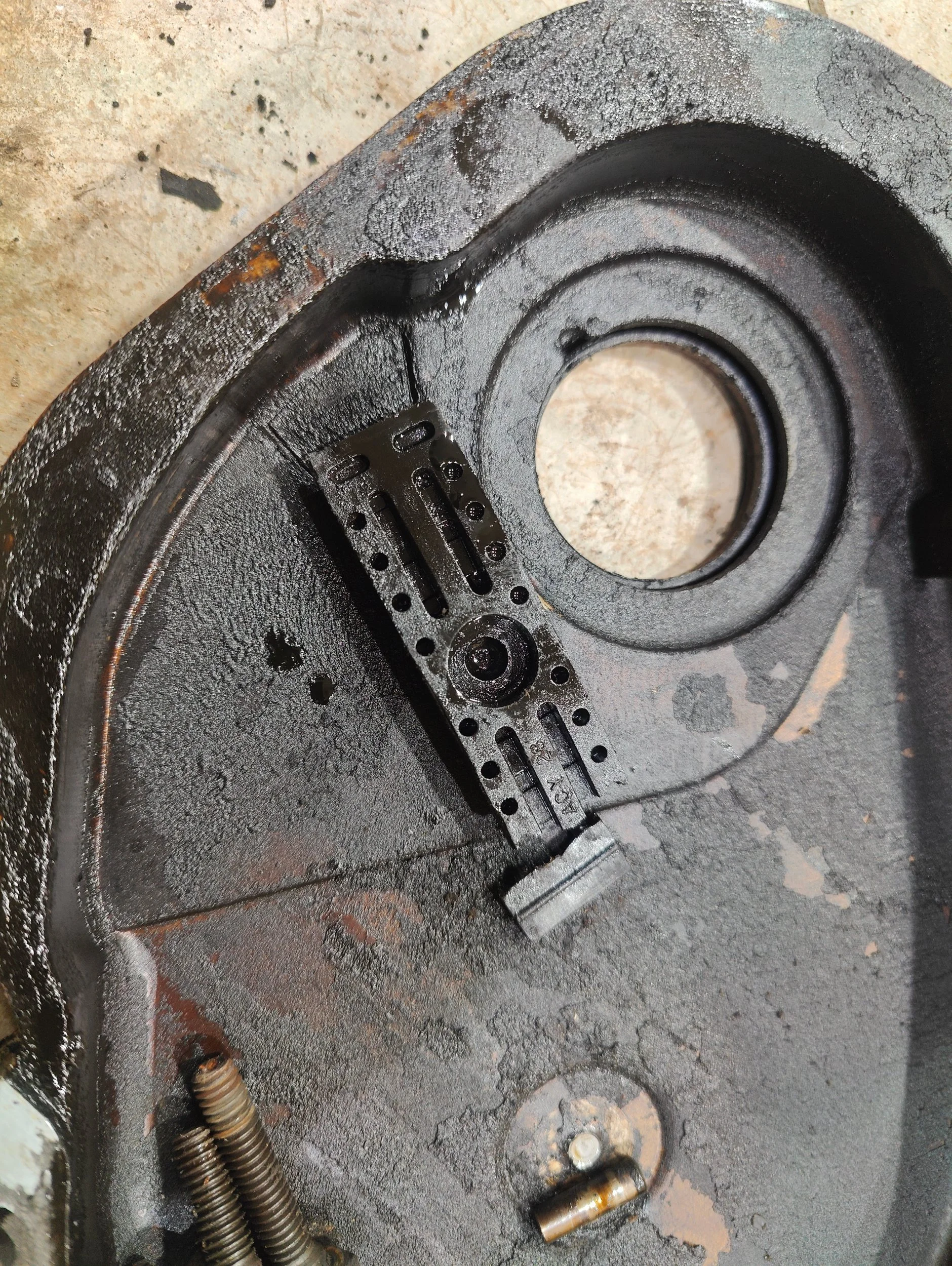

If you're going to be putting the engine together (bare block or long block) — don't forget this stupid part when you put on the timing cover.
I had to tear up a full timing cover gasket and then re-install with just a top-half timing cover gasket because the oil pan was already installed — when I realized this 'damper' (forget the official name) was still sitting on my workbench.
Sharing my misery in hopes you avoid it!
Pre-ordered a Stage 2 kit from Clegg after talking things through with their techs. They only have two cranks in stock and they're not expecting more for 4-6 weeks.
They recommended not cutting the block down .30 thou and just using the stage 2 pistons.
Added in bushed rods for easy assembly, moly rings, balancing, 24 lbs injectors.
Soon as the machine shop confirms my standard piston size in a few weeks I'll call Clegg and they'll ship my kit.
Machine shop is going to be around $700 and that includes cam bearings.
Intake should be done with powder coating in a week too.

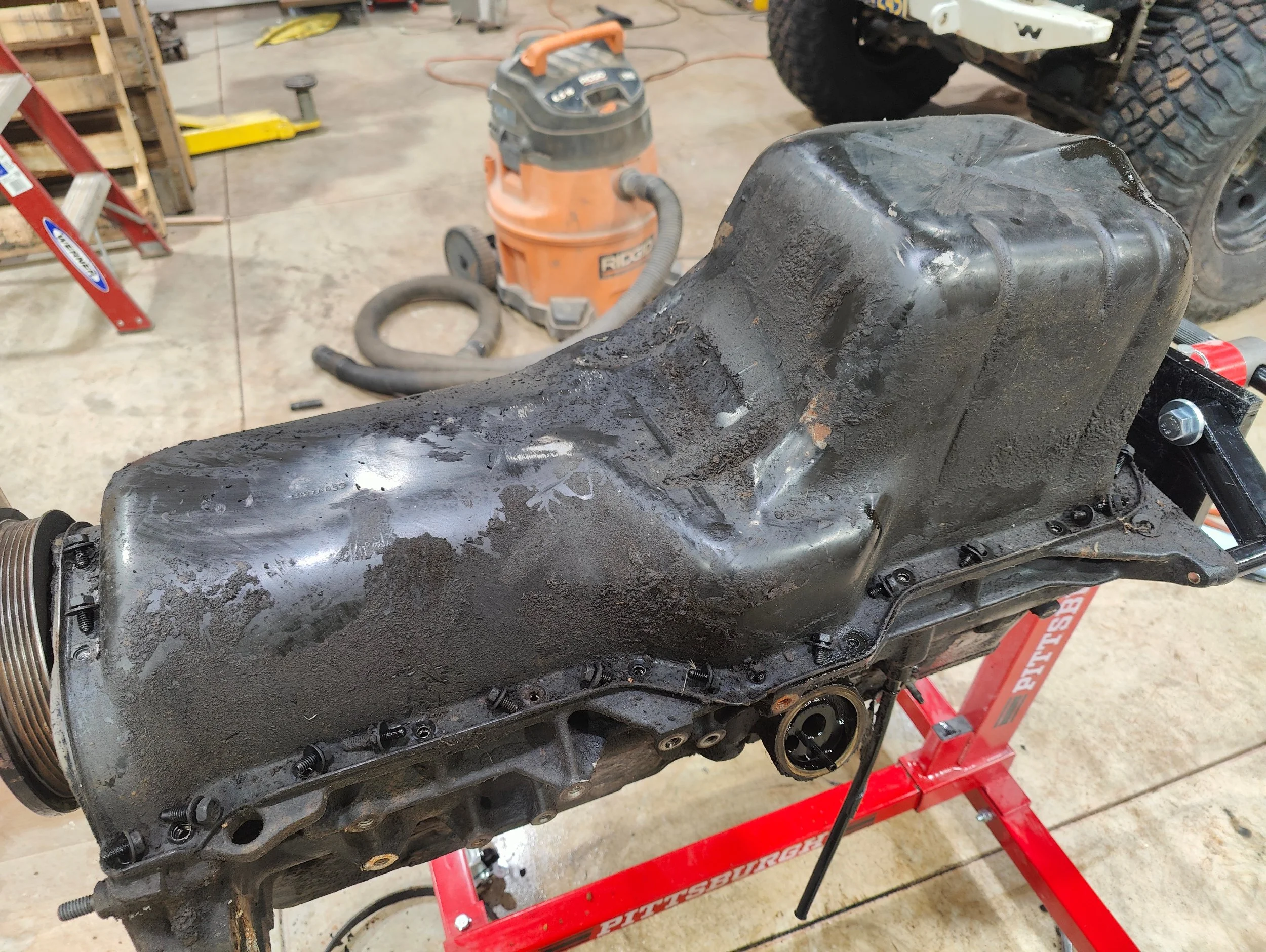

Meanwhile I'm throwing misfire codes constantly. Wish I had ordered a distributor... they're $70 with a cap and rotor. Mine has a lot more play than I think is socially acceptable. And I paid $60 for a cap and rotor. I did order a crank position sensor...so I'll try that and if it doesn't work at least I have a spare.

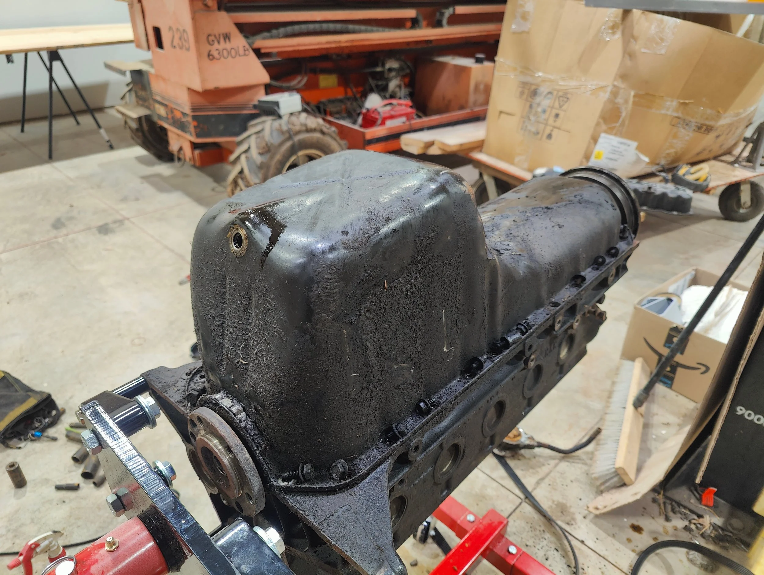

And I need to decide if I want to buy a Dorman oil pan for $70 or accept the slightly dented ones I have.

I'd probably trust the flange being shaped correctly on a stock pan,rather than dorman

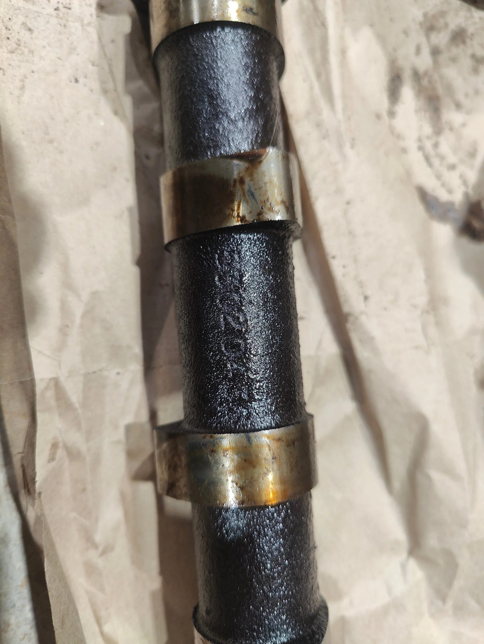

What are you doing for a cam? Ask golden gorrilla about the newcomer recommended cam bearing brand. Some can be very soft
