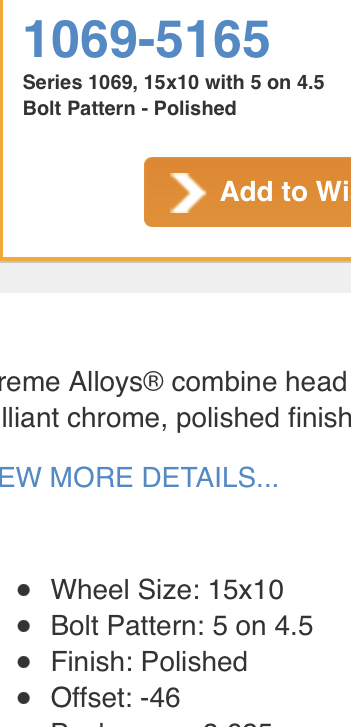

If buying new I would have gone with 15x8 but when you get chance to trade up to 35s that are better tire, more tread, and you like rims better don’t let 15x10 stop you. No issues with handling, turning, and they stuff fine with current setup.
You’re going to stick way out there on a 10 inch wide wheel.

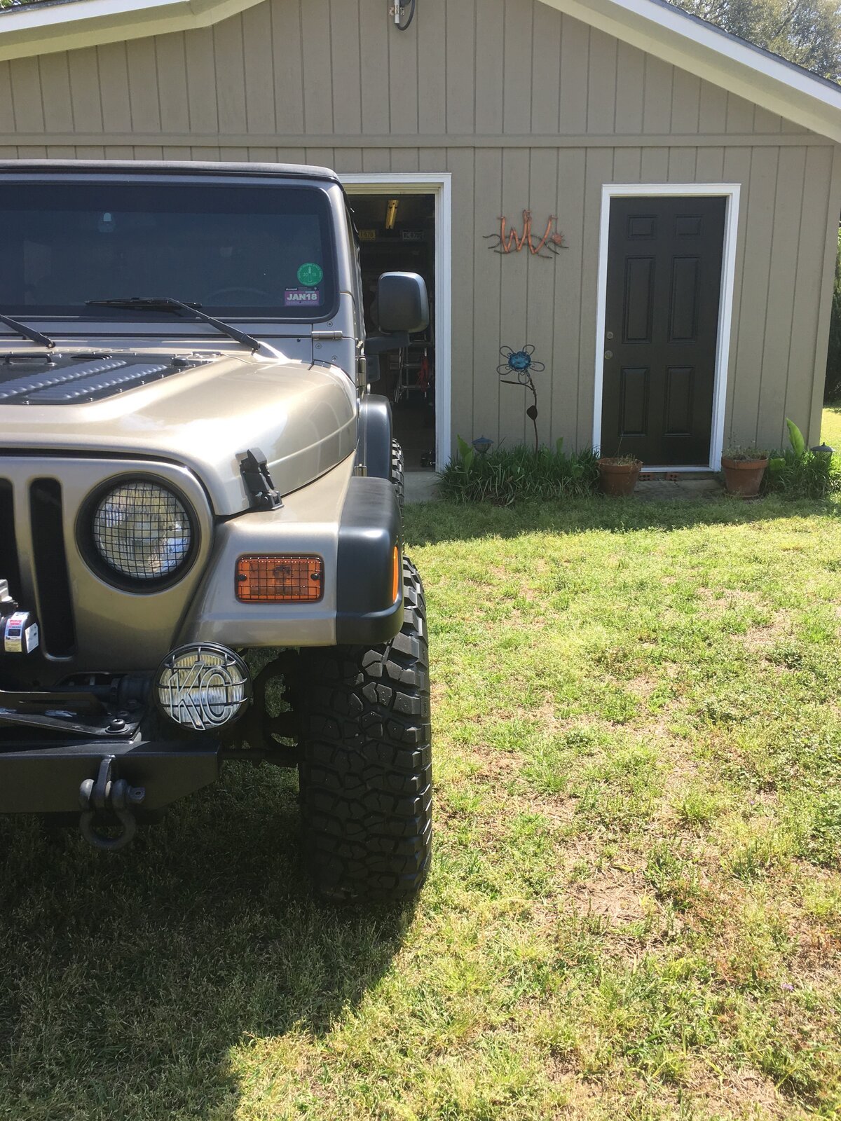

My first pic is a 31x10.50-15 on a 15x8 wheel with 3.75 backspacing and the regular width TJ fender flare.

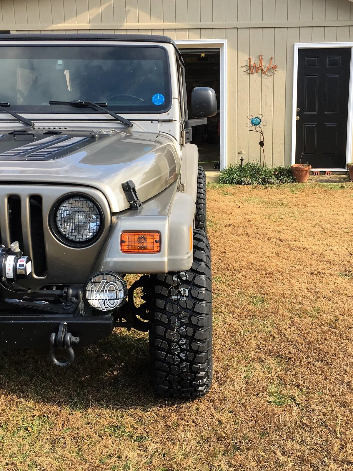

The second pic is with the exact same tire/wheel with the wider (4.5 inch, I think) Rubicon flares.
Thanks for posting these pics. I'm about to upgrade to the same setup (31x10.5R15's on a 3.75BS wheel), but I'm a bit nervous about handling/steering with the extra width. Questions:
1) Did you find the factory flairs to be just too little coverage with the 3.75BS and 10.5" combination?
2) Did you notice any steering/handling issues with the new wheels/tires sticking out that far?
Yes, I knew I wanted as much tire coverage as possible with out going to the 6 to 7 inch wide flares, which I feel would Have been too big in my situation.
I didn’t notice any handling difference.
