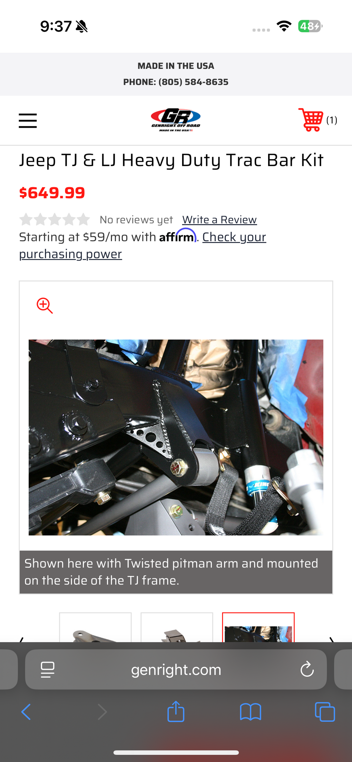

Anyone here running an OTA track bar setup with a weld on frame bracket? Thinking about running a Genright style track bar. I’m running a Dynatrac 60 up front and I have a Clayton double sheer setup and it’s way too tight. I need to move the track bar up on the frame. I’d also like to move the track bar bracket forward an inch.
If your drag link and trackbar are parallel now and you don't have bump steer you will also need to move the track bar up on the axle side. As long as they are parallel you can run it wherever is needed. Steering first track bar location second, ,its way easier to move the tack bar. Ask me how I know lol :rolleyes:
