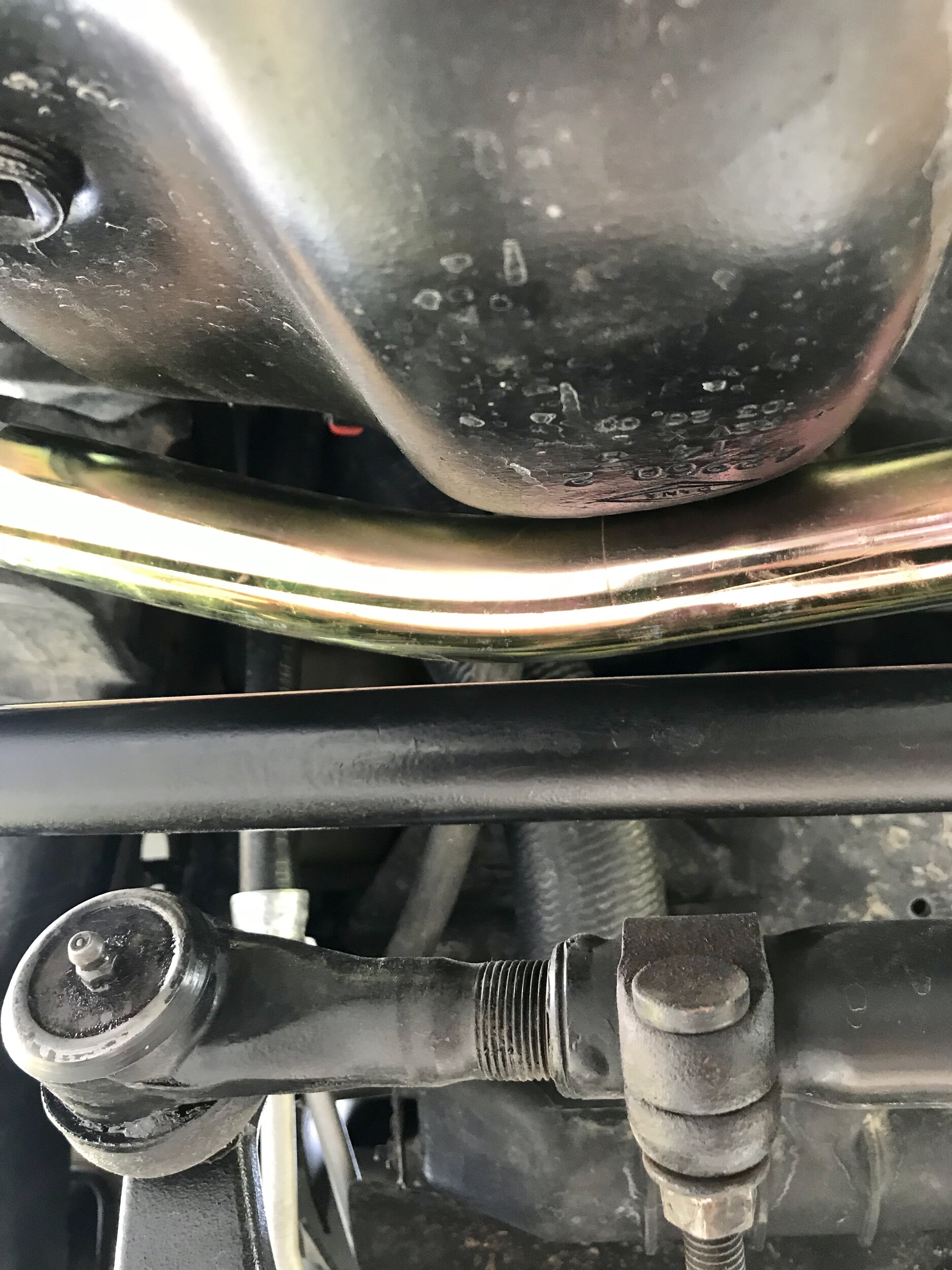

If you have a Dana 44 with only 2 inches of lift, hate to break it to you but the Currie Rockjock front track bar will also cause massive interference on the front diff. How much bumpstop are you currently running?

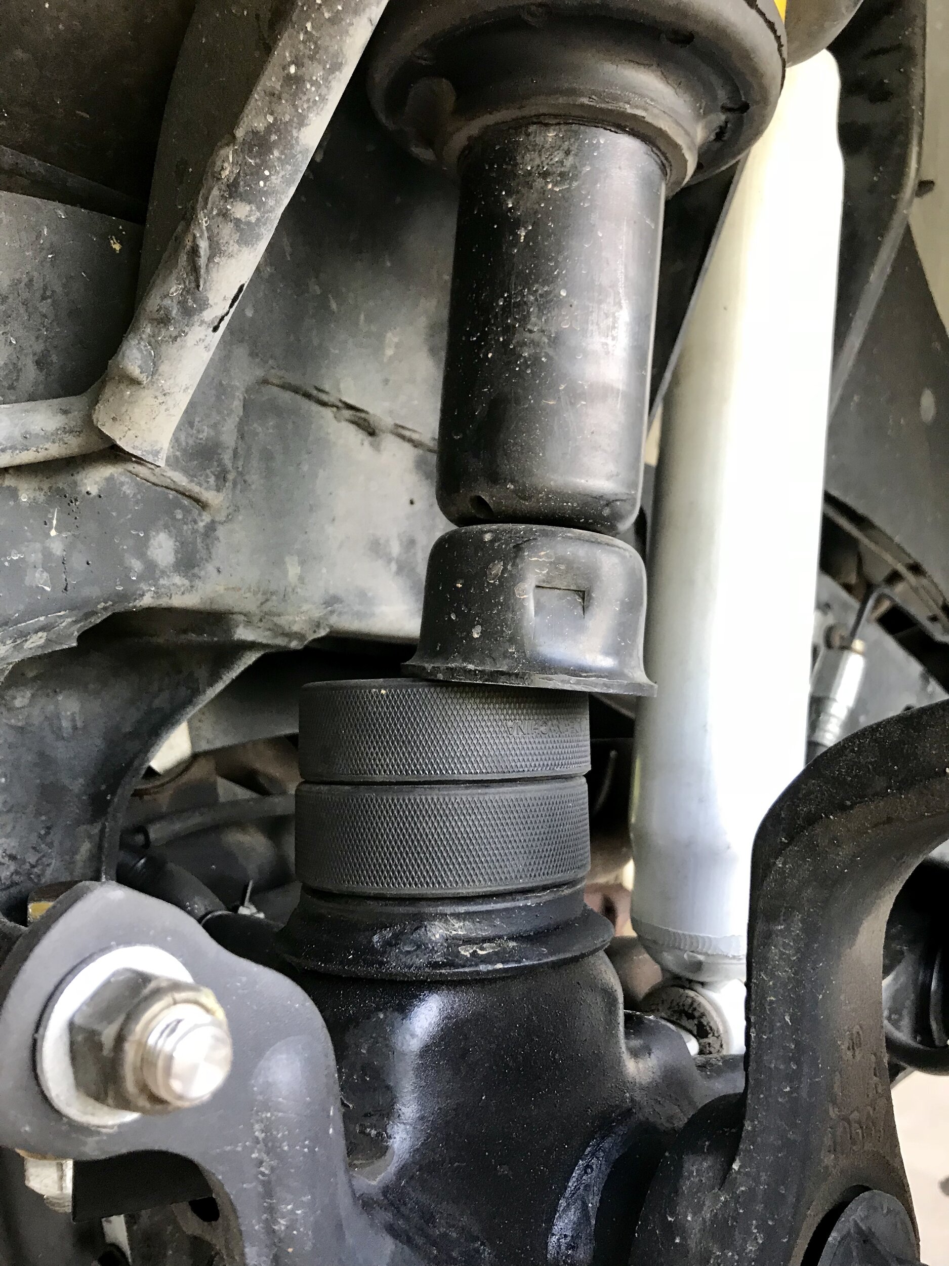

Sorry for the late reply. I added 2 inches of bump stop on top of the welded Rubicon bump stop pad. I had 1.25" previously. It kept my tires out of the fenders, but the stock diff cover would come in contact with the TB at full stuff.

In that case, you're not too far off from what may be needed for the Currie Track bar. Not sure which ranchos you're running, but I'm using the 55239 up front which have 9.5 inches of travel. In order to run the Currie Rockjock trackbar I had to have 2.5 inches of bumpstop, which in conjunction with the Rubicon welded bumpstop is a total of 2 and 7/8ths bumpstop. This resulted in me losing the 1.5 inches of travel, and being at the stock 8 inches of travel despite a 3.5 inch lift. It works but it wasn't ideal. I tried bending the track bar to get more clearance, it was a pain since it's chromoly. I also ended up cutting the gusset clean off along the way...
The best solution would have been if I kept the lift at 2 inches and used stock bar, or I went to a 4 inch lift/and or adjustable control arms. The taller lift would require me to run longer shocks which would fully compress before trackbar interference. The control arms would have allowed be to dial things in better and get the axle further back.

According to my results from cycling before drilling the mounts it seemed I needed a minimum of 2 inches of bumpstop. After bending the bar I was able to get it down to 1.75. Then after drilling the mounts I needed 2.5 (on top of the welded pad). The only thing I can think of is when I bent the bar it somehow made clearance worse. Either that or my front axle wasn't centered properly during cycling, but I tried almost every adjustment point within reason.

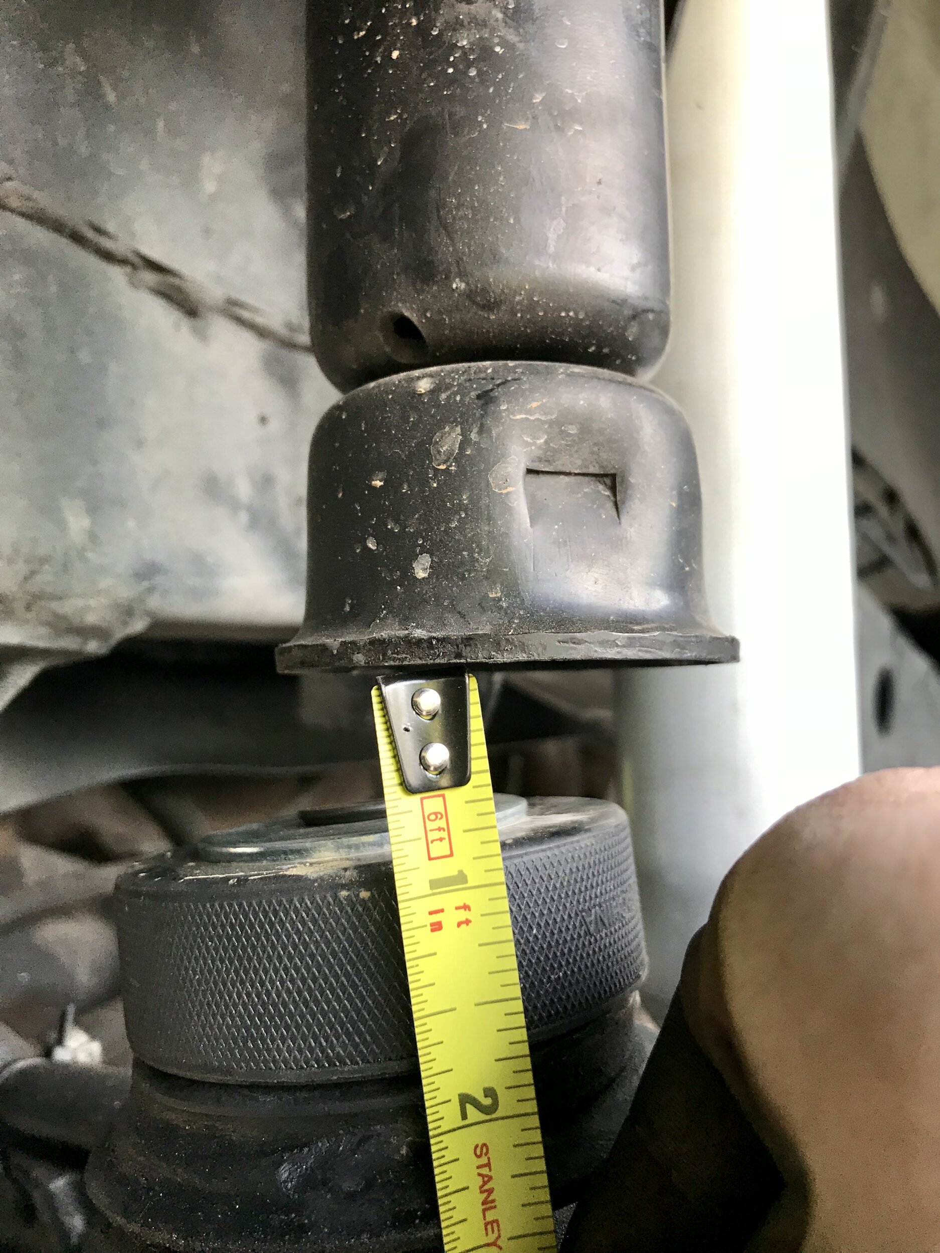

I got back under the jeep and remeasured. I might actually be at optimal bump stop for my setup. I have ~4" of-travel on the RS5000x and 4" of up-travel from the bump-stop to jounce cup.
Knowing that, I won't be able to chase more up-travel unless I run a longer travel shock. In the meantime, I'm planning to run some of the Metalcloak DuroSpring jounces to soften up the heavy hits. I also confirmed with MC they only compress to 3/4" rather than 0" like the factory jounce. Will need to remove some bumpstop to accommodate.

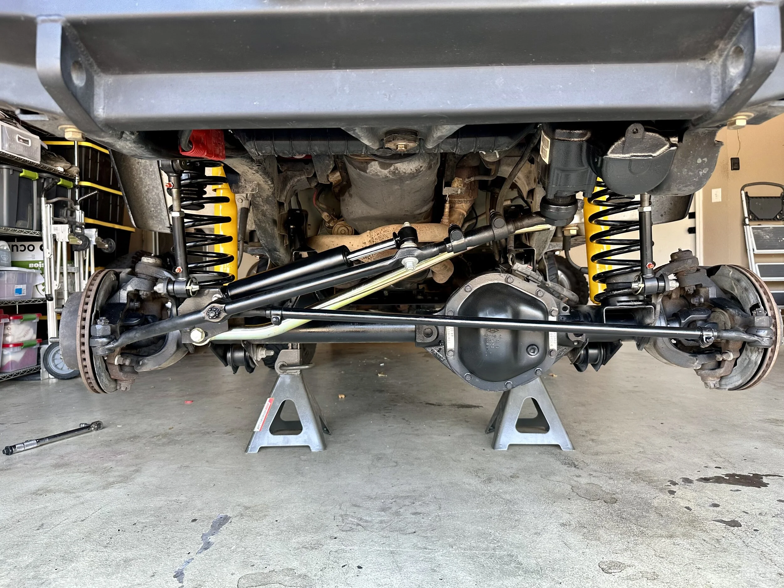

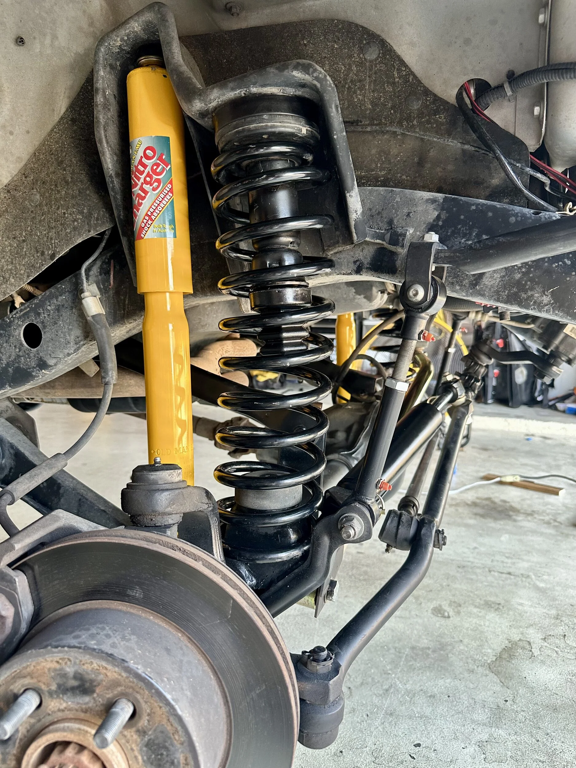

I installed the Metalcloak DuroSprings and a .75" leveling spacer today. The DuroSprings only compress to .75", so I decided to use this as an opportunity to reevaluate my bumps stops.
I pulled the coils and cycled the suspension again. I was able to cut another .25" out. The trackbar is still the limiting factor.
With the Nitrochargers, reduced bump stop, and a .75" leveling spacer, I gained another .5" of up travel. And in the occurrence of a bottom out, the DuroSprings will help soften the blow.
All in all, I'm happy now. I'm not gonna chase another .25"-.5" of up travel with a $500 trackbar or $800 control arms. I think I've reached the point of diminishing returns.
