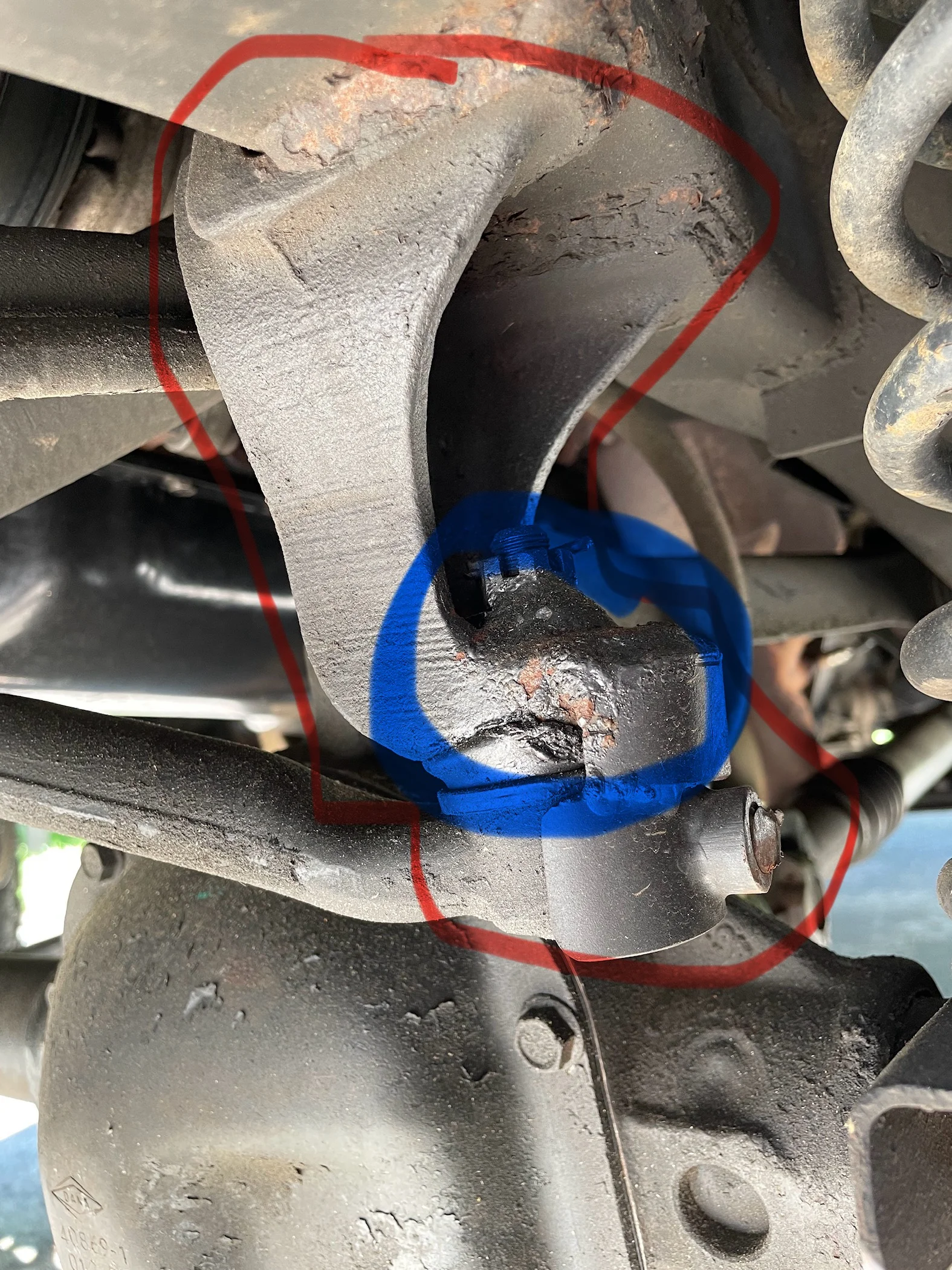

Hello - I have read a fewer threads on here about how bad a double shear track bar setup is. The track bar mount (frame side) on my 05 LJ is completely shot and was poorly welded by the last guy. Since double shear brackets seem to be available to replace the stock bracket but “we” don’t want double shear, does anyone have a quality single shear weld on bracket available to replace the stock one? Let me know who sells one that you have had luck with.
What does shot specifically mean? Is the mount cracked?
Yeah the weld they did has worn out and there is no good way to fix it. Added photo.

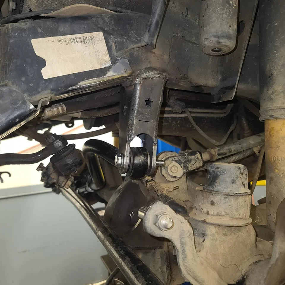

Double shear mounts are not necessarily bad they just have to be done correctly as not to mess up your track bar to drag link relationship.
Take a look at the Jeep West double shear bracket, along with the rough country forged track bar. That setup allows the use of 1" bump stop extensions, which no other aftermarket track bar allows. Plus it retains proper geometry.

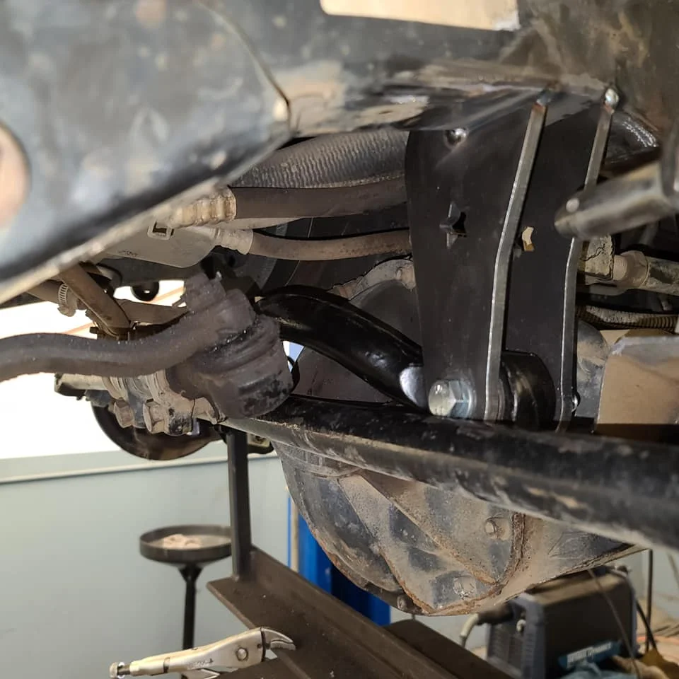

Photos taken from jeep west

Is it as simple as cutting the stock bracket off and welding the new double shear bracket on? I don’t currently have it lifted but it will be next year. I spoke with the people and Barnes and they have a bracket that is double shear and is good for stock height and lifted.
Essentially yes, but make sure to cycle the suspension to check for clearance. Barnes has a full set of instructions that show where to weld the bracket on. You might want to triple check the drop on that bracket as I believe it's less than stock, meaning that you will end up with bump steer. @David Kishpaugh would know better.
It looks like it just has some kind of shroud with a set bolt in it. Then the bolt head was cut off.
Can you tell if the mount itself is cracked? Maybe that shroud weirdness could just be removed.
I can't tell of that's just dirt or the nut is welded too.

Is it welded on the inboard side of the frame rail? Looks like there’s a gap.
It left the factory the way. There is a welded tab going up onto the vertical face of the frame.
