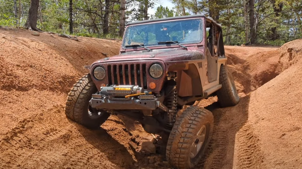

Rubi 44 front that I adjusted to 3" of bumpstop just for you. JJ front trackbar. This is maxed at full stuff with the axle centered.
Camera angle doesn't show the full number but it is 6 1/2" higher it is able to go, subtract 3" of bumpstop and you have another 3 1/2" of up left. If it isn't clear, I jacked it up to a hard full stuff, compressed the bumpstops down to 3", removed the trackbar, and then moved it up until it bound. You'll never get it that high, ever.

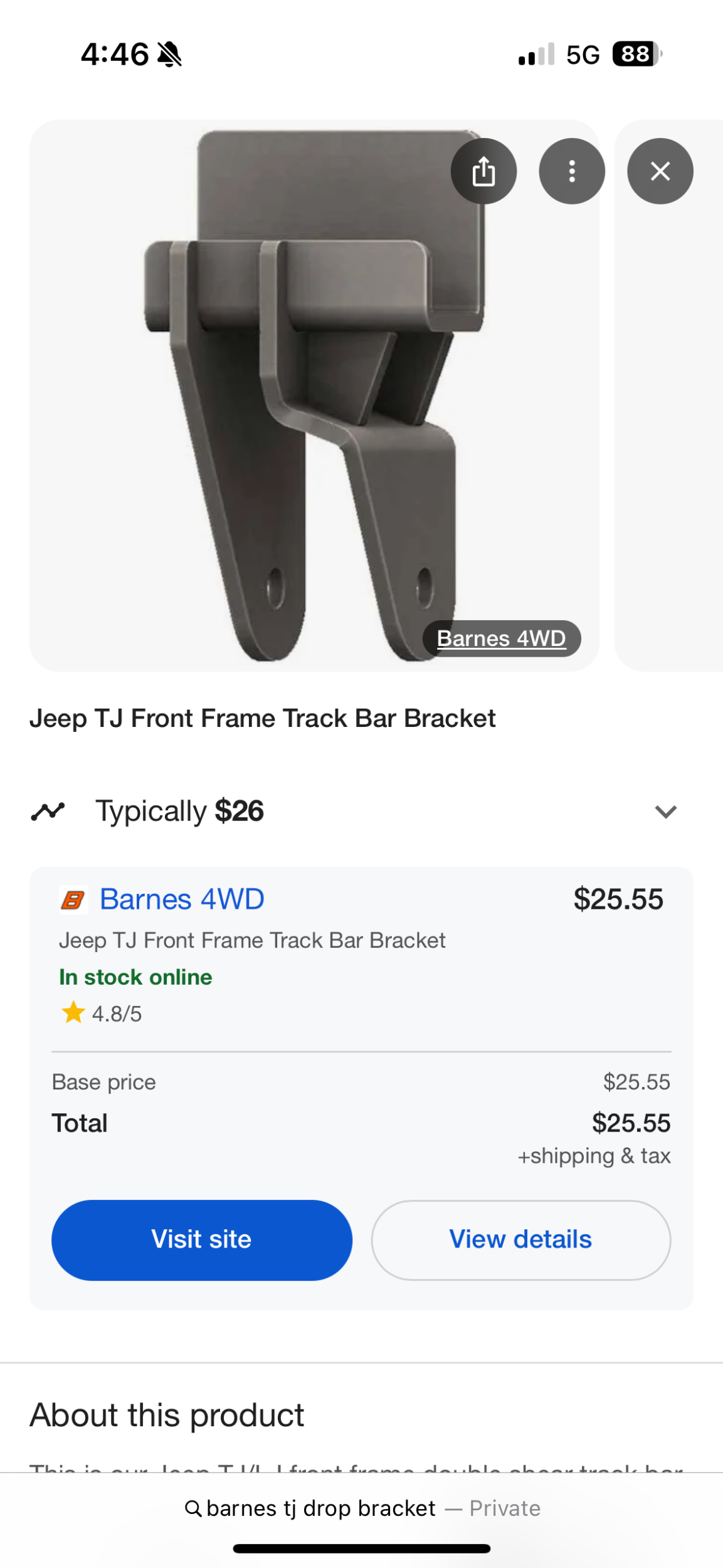

Yea the Barnes bracket is super easy to change and only costs 25$ that’s why I’m asking about it… just want to make sure it will work for what I need it to in the time being before I order
