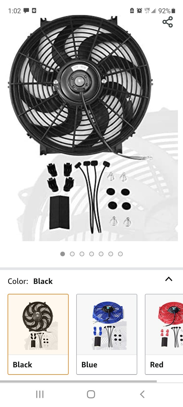

Fan looks just like this and it's all I received no shroud.

The fan is a high quality high output SPAL . the overheating is most likely coming from the tune being incorrect. If you are concerned about the fan, barnes makes a shroud for electrical fans that will help direct the air.

If it doesn't have a shroud I'd put one one it. It might not be the reason for your overheating issues but IMO you need to have some type of shroud..
agreed this was my biggest concern with a 8274 and the sc intercooler up front.. I was going to fabricate one but saw barnes had it. Saved in my cart just in case. The electrical fan gives a huge amount of space up front

The big problem with those electric fans is most people mount them directly to the radiator core. This means only the area where the fan is mounted gets cooling. Some of the designs are also restrictive when they are not running. All those support bars and blades slow down the airflow at speed. Some of the older designs used flaps that would open when driving on the highway.
Back in my younger days I remember fighting with a cooling issue on a CJ5 that I had a electric fan on. It wasn't until I finally put a shroud onto it that I fixed it. And yes I remember those older style fans that had the flaps would open up once up above a set speed.
