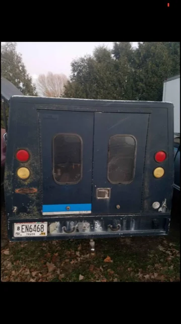

OK, I am probably like everyone out there in that I get my mind on something and I can't leave it alone. The past couple of years now, I have been set on building an overland type trailer. At first, I was going to build it from scratch. As time went by, I decided to use a utility box off of a truck. I have a couple but all were waay too big for my 05 TJ Rubicon. Like in the range of 7' wide by 9' long and too heavy to even lift one corner...
To start cutting and welding it in both directions just didn't work out to be the best option.

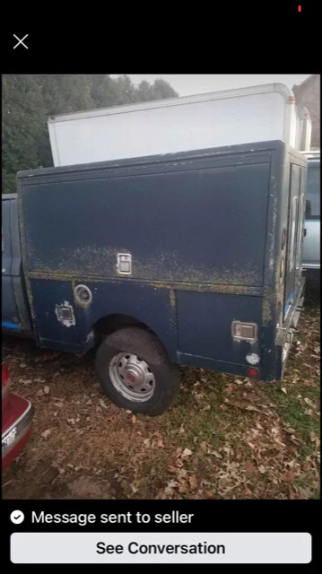

Then I found the one I hope will be ideal! It is an old service box off of a Ford Ranger. (I bought it off the truck)
My Jeep is Just over 72" wide with the 35 x 12.5 tires and the (all aluminum) box measures 65" wide x 75"long and 55" tall. I can lift one end over my waist fairly easily. I loaded it myself on my trailer (not so easy... lol)

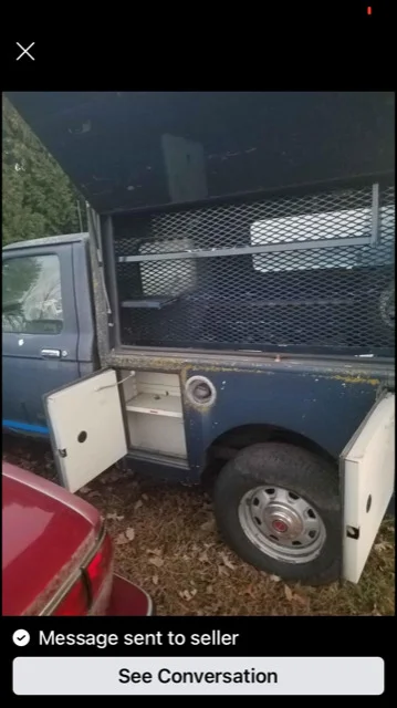

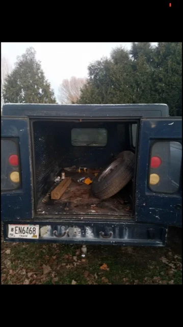

I know it looks rough, but I can't hep but ponder the possibilities. Though it lends itself to the possibility of a sleep in box, I think I am more interested in a RTT and having the kitchen or ? pull out of the back. After looking at it closer, It won't be as simple as it may seem. I will have to at least cut the back side doors and compartments down and weld them back together in order to fit the 35" tires I would like to run in order to match my Jeep.
I really like the large flip up doors for a mini awning to use on short stops and install lights on to carry across the cabinets and surrounding areas.
Mainly I am looking for thoughts and input/advice. Please don't be offended if I go an opposite direction on suggestions. I will read and take any input seriously. More ideas make more options to consider and hopefully result in less mistakes and regrets.
I'm new here, but I have loved Jeeps since before my first 80 CJ-5 and several since. Not against the new JK style but the TJ's are getting less and less available while the JK's are still all over and I do love the utilitarian feel and look. For this reason. I just had to go TJ again when My 03 Rubi got just too rough to be my main Jeep anymore. A sad day, but she still plows my snow!
Any help appreciated! Thanks everyone!!
