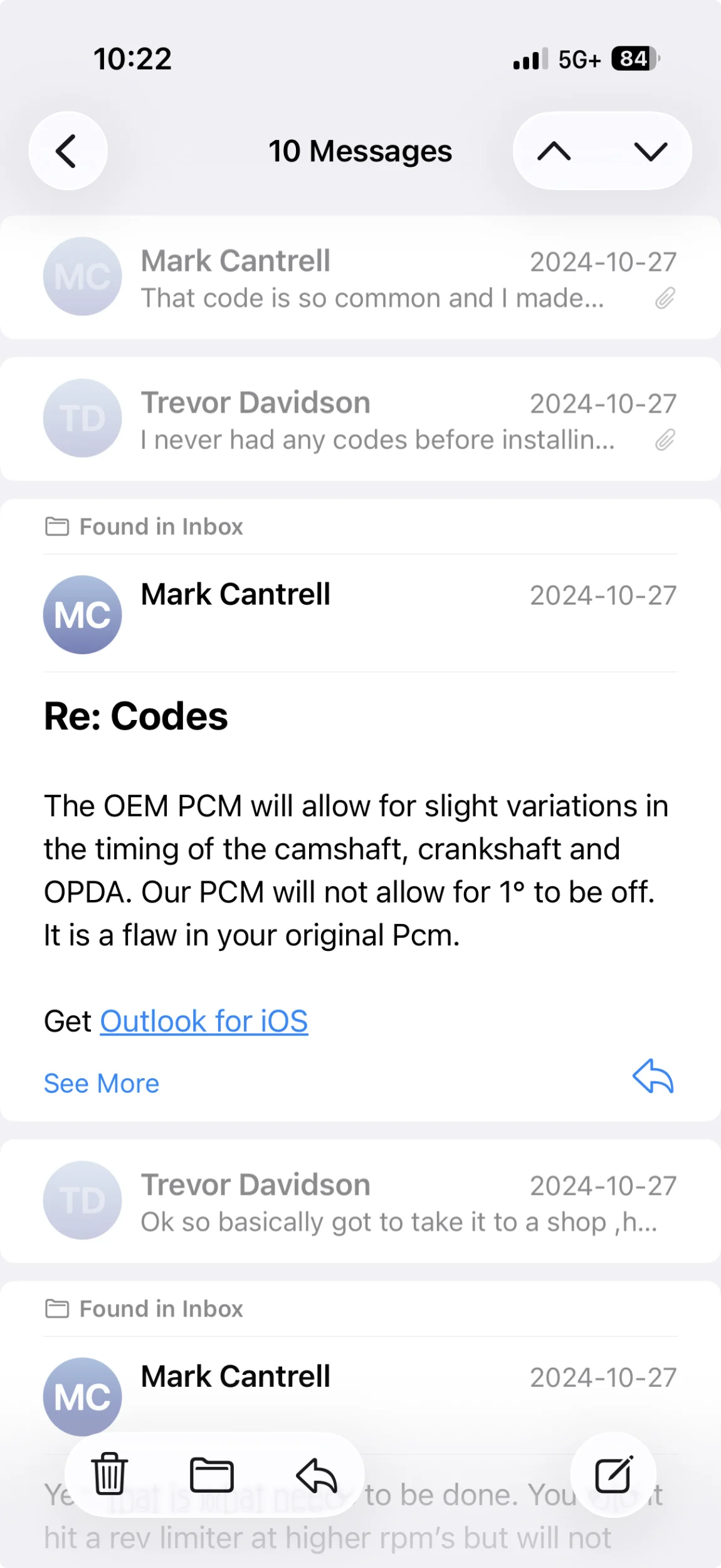

You need to calibrate OPDA /camcrank as close to zero as possible with a bidirectional scan tool .
if you have a wranglerfix PCM the tolerance is way less then stock PCM.
Then do a relearn with scanner
Reactions: Jay51may
"You need to calibrate OPDA /camcrank as close to zero as possible with a bidirectional scan tool .
Then do a relearn with scanner"
Can you elaborate on the WranglerFix PCM? You're saying that the tolerance is less than the stock PCM? How so? Wouldn't it be programmed, or the firmware, be the same as stock? Also to be clear, PCM is the same as ECU?
This straight from Mark from wranglerfix when I did mine and installed his PCM
