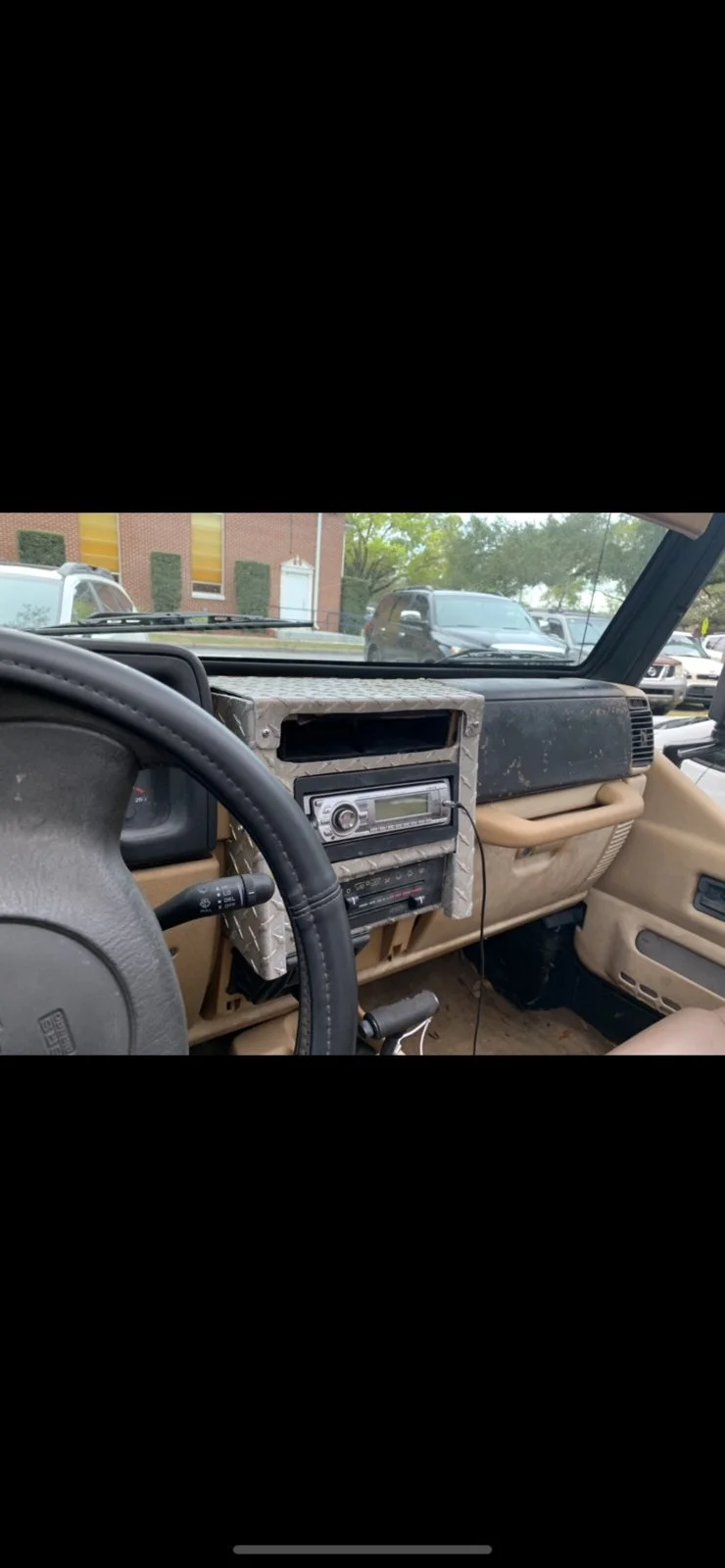

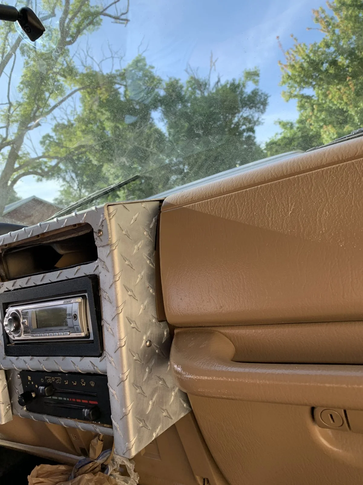

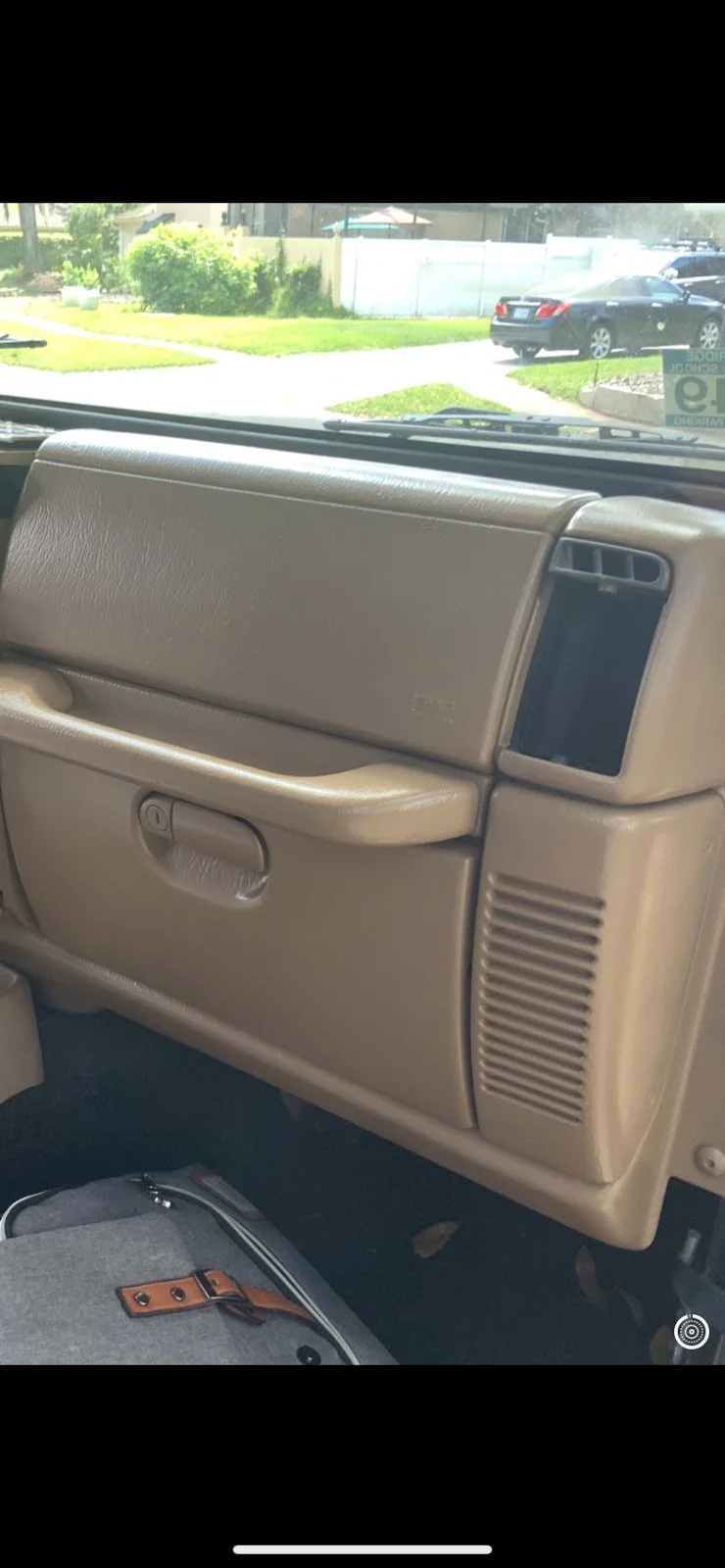

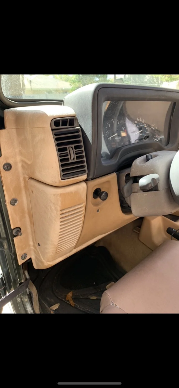

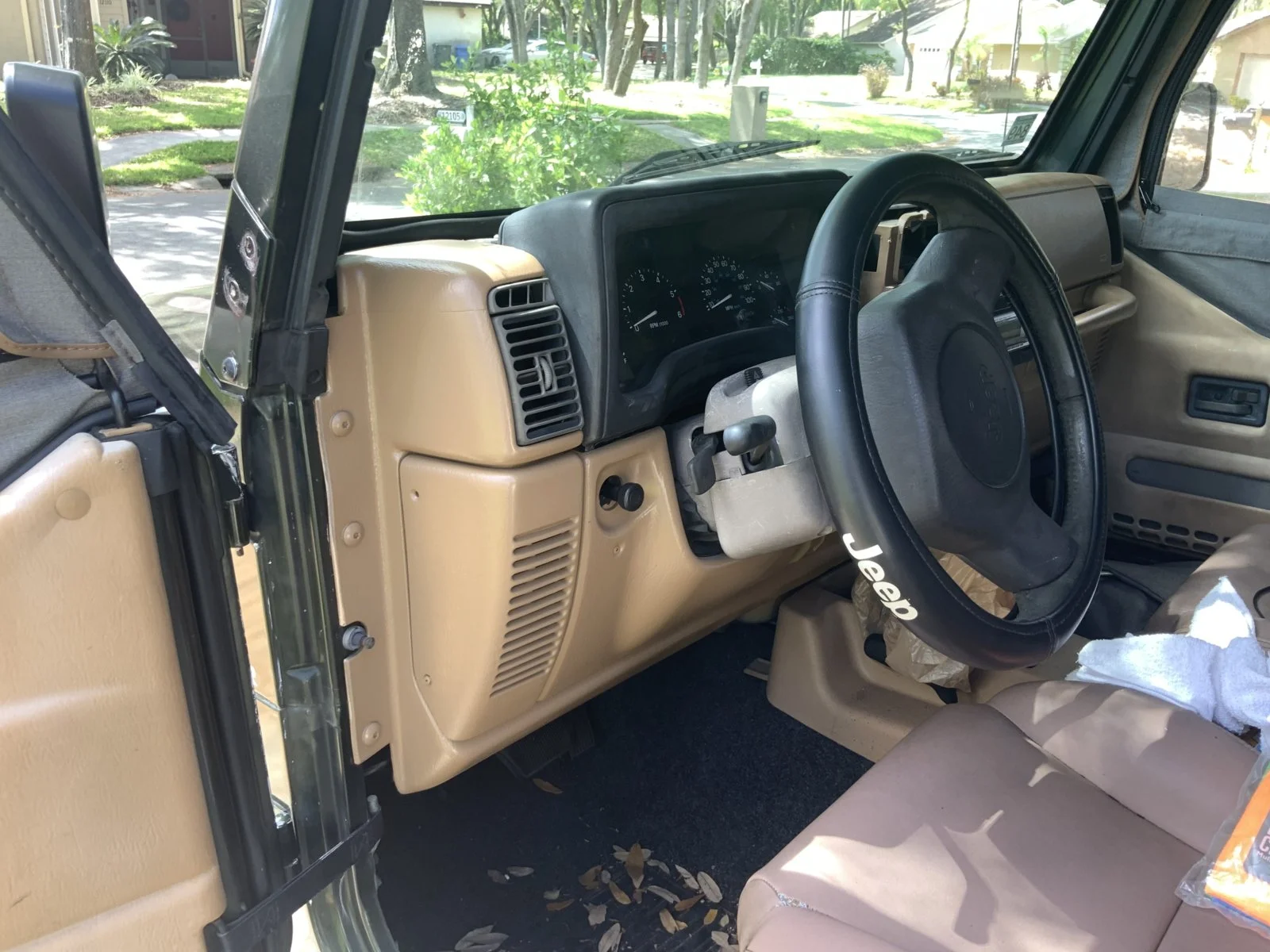

Lol I should update this thread because I painted them I’ll attach pictures during the process
Damn, that turned out exceptionally well! Can't even tell it's not factory.
What color did you use?

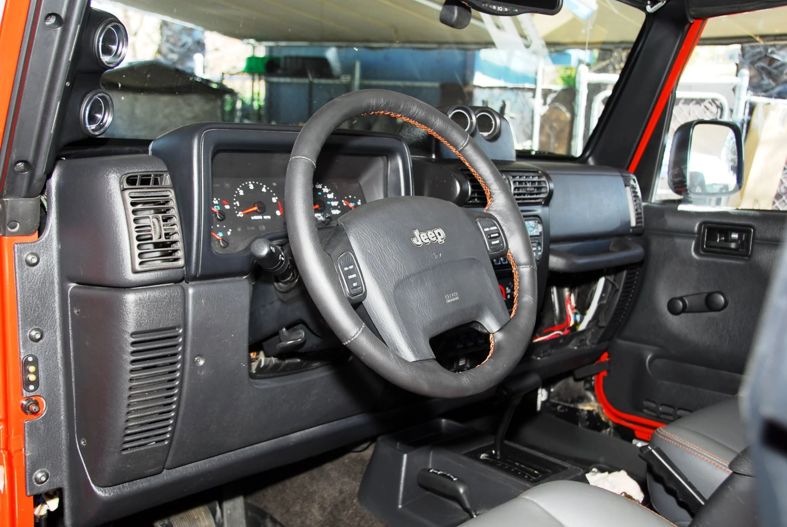

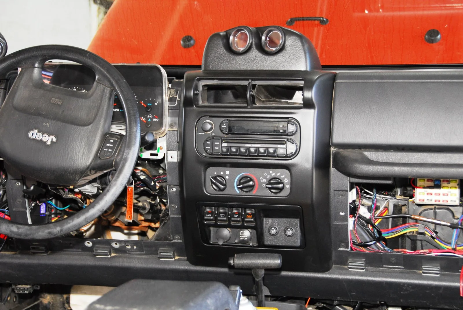

Here is a center bezel I did with the color coat and low luster clear next to the factory cluster bezel.
I used a satin nutmeg rustoleum from Home Depot, it looks great... I was hesitant with the satin but it gives it a nice professional look and it really does look factory I’m very pleased with it.
I've found the low luster clear over the top of the color coat is an identical match to the factory sheen. The color coat sheen out of the can is too shiny for those of us that are bothered by such things.
Here is a center bezel I did with the color coat and low luster clear next to the factory cluster bezel. View attachment 88234View attachment 88235
Wow that matches great! I didn’t have to worry about matching too much because I did the whole dash lol
Yep, that turned out great! I’m very impressed.
Thanks. The other thing that helped is if you look at the factory paint on the bezels (they are painted) it has a slight texture to it that isn't in the plastic. I put down a good couple of cover coats, then pulled back and misted a dry coat onto the cover coat so it wouldn't lay down and just give it a faint texture. It matched perfectly.
