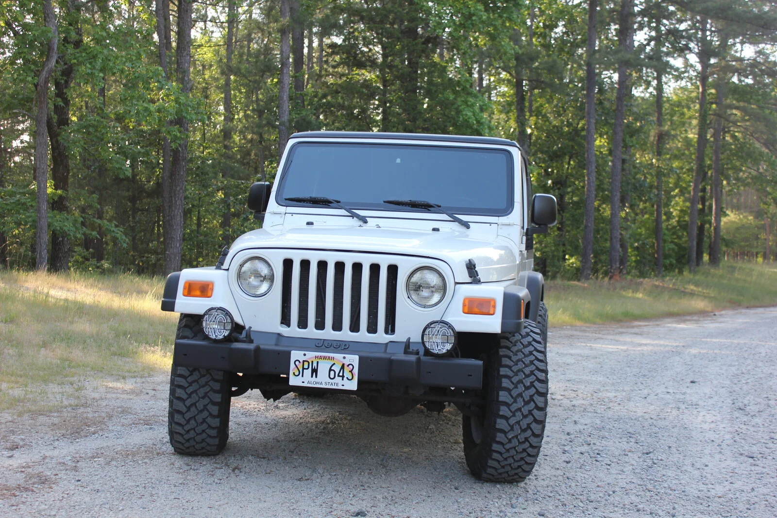

I'd like to see them body matched. I've been thinking about doing this on mine.

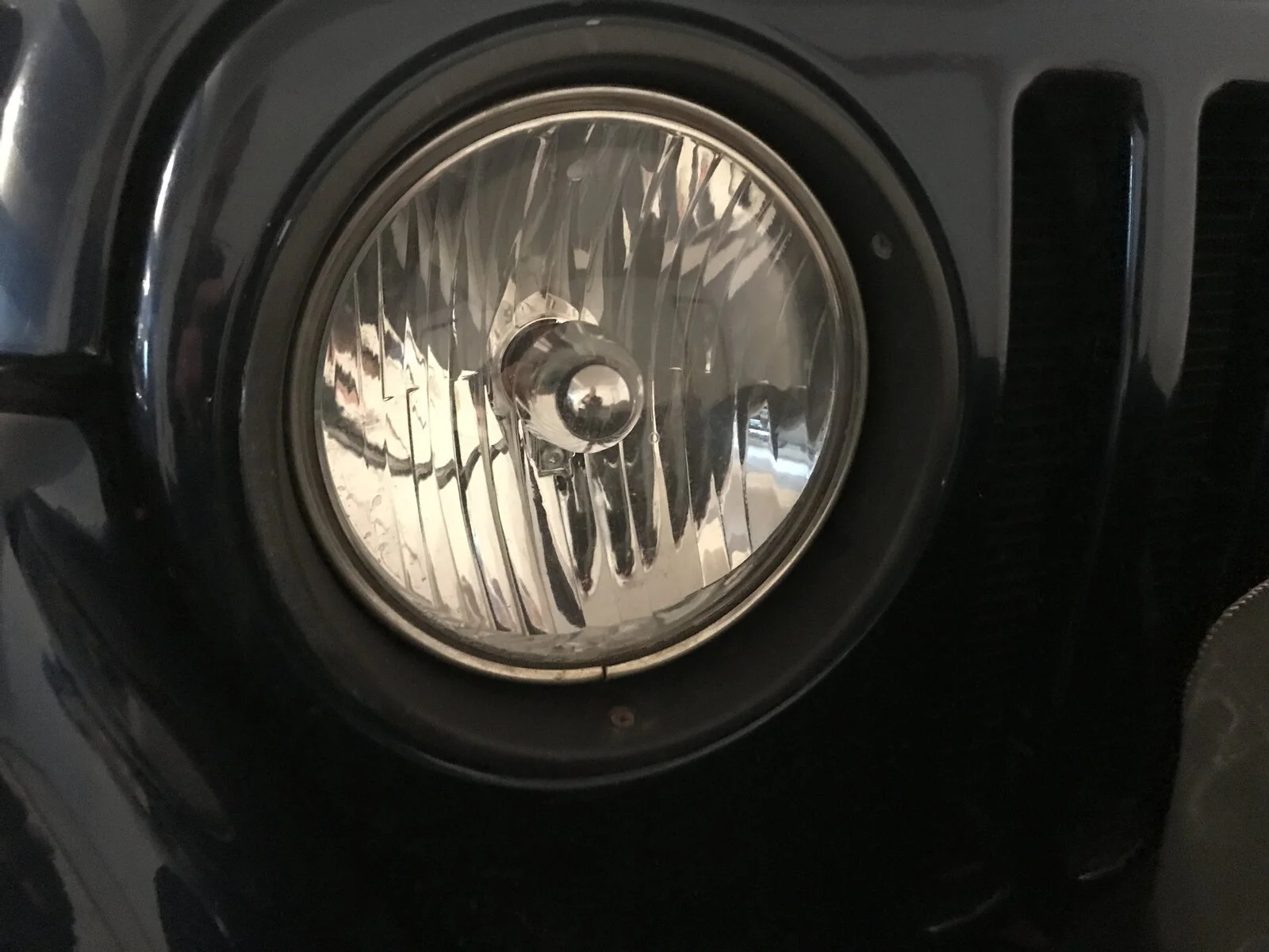

I'm not a fan of crome on a jeep, so are and some aren't. The only crome on my jeep is the headlight bezels and the trail rated badge. What's yalls recommendations on painting them a flat black or semi gloss? I know I'll have to scuff them up pretty good which is no problem. I'm not gonna use the cheapest rattle can I can buy.
Satin Black
Didn’t use any adhesion promoter for mine. Just prepped well and sprayed with some black rusteolum. It’s been holding for a year or so. Wouldn’t mind going back to chrome.
Matched Body color would look cool.

Just to throw some extra info out to any other readers looking into this: the chrome on the headlight bezels is not paint, it comes off in a crinkly vinyl-type material. I chose to completely remove this stuff before painting because it had started to peel in places. Utility knife blades work best for this, although it’s still a lot of tedious work to remove all the chrome material. Sandpaper does not work well at all. The bezels are light grey underneath. I got adhesion promoter, base and clear coats from automotivetouchup.com. So far so good.
This is interesting, mine sanded right off 🤔
