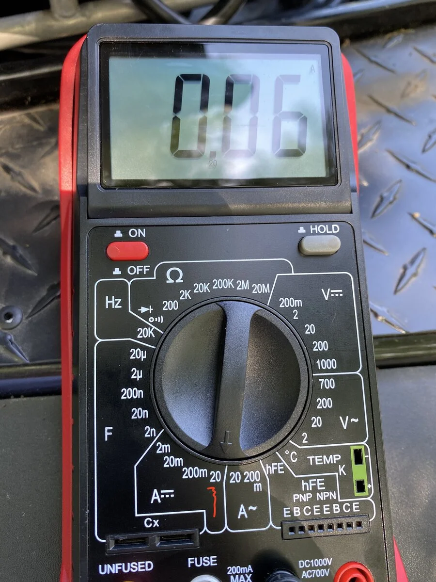

Went back out to investigate further. Here is a pic of the meter reading when set on 20 amps. When I initially touch the leads to the negative battery terminal and the ground wire for the battery, I get an initial reading of .30 which then settles down to .06 in a second or two. I was able to get the reading to 0.00 by pulling the # 26 - 10 amp fuse for Accessories. The only accessories that have been installed are a winch, which is currently disconnected pending the installation of a power interrupt solenoid and switch, and an aftermarket radio unit, but that has been installed for over a year and I don't recall using any power wire other than the stock radio. I will pull the radio fuse to see if the radio is connected to it.
I would try and find what is powered by that fuse, as it looks like 100% of the 60 milliamp draw goes through it.
I would get some gator clips on the ends of your leads and leave the meter hooked up for awhile. switch the meter to 200ma setting and look for a more precise reading over time.
Make sure it stays on the 20a setting when initially hooking it up like you have.

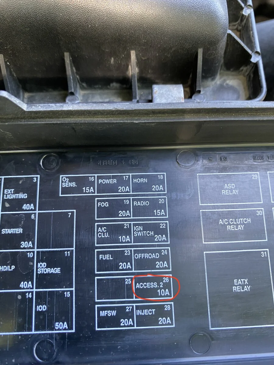

That fuse is the Accessories fuse, after pulling it just now and inspecting the Jeep when running, the radio still works, the fan still works, the headlights and taillights all work. The only things on that 10 amp fuse that didn't work are the two dome lights on the speaker bar and the courtesy lights on the passenger and drivers foot well. All lights go off when the doors shut or when I depress the door switch while checking. Here is what I'm finding in the Service Manual for Fuse # 26

I may be losing my mind. Tonight after dinner I went out the to TJ, disconnected the ground cable from the battery and connected my amp meter to both the battery terminal and the cable using alligator clips. Previously, I had just be touching the leads to the cable and the battery.
Previously, I had determined that when i pulled fuse # 26 for accessories (interior lights) that I could get the parasitic drain to go to zero. Before I turned on my meter, but after disconnecting the battery, I got in the Jeep and pulled the dome light bulbs (2 of them) out, shut the door and turned on my meter.
When I connected the first alligator clip to the meter lead, on the 20 amp setting, I got an initial reading of 0.3 and as I was watching it, it went to zero in about two seconds. Thinking it was a mistake or lose connection, I rechecked the alligator clips and cycled the meter on and off. When I reconnected the lead to the meter, the exact same thing happened, after two seconds the reading went to zero.
I then got in the Jeep and inserted one of the two dome lights, since the meter was on the 20 amp setting, I left it connected. When I inserted the one dome bulb the reading was 2.4 amps. As I closed the door and the lights slowly dimmed the reading went to zero. So I inserted the second dome bulb, after it was inserted the amp reading was something like 3.5 amps, but as I shut the door and the lights dimmed, the reading went to zero.

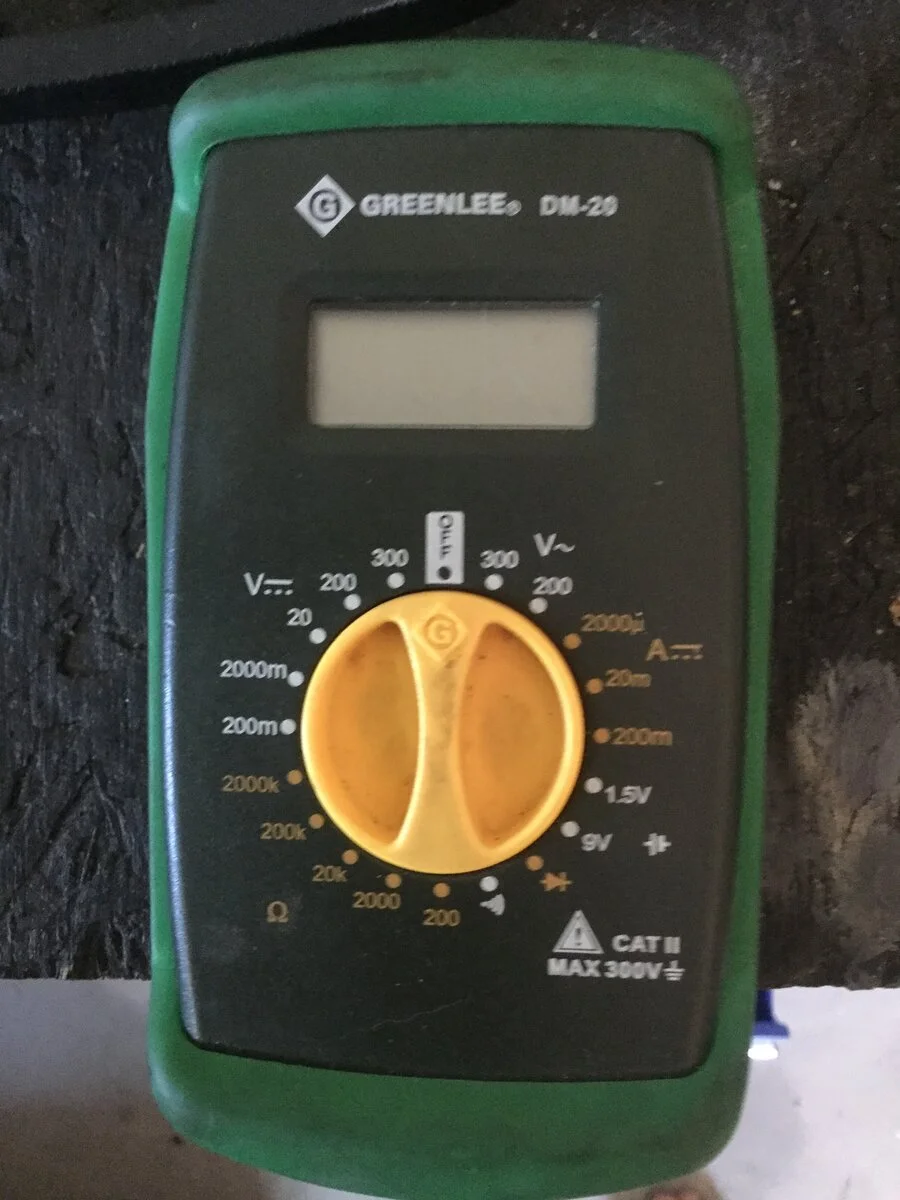

I am attempting to do this but it appears my DMM does not have the right scale on the amps side. Am I reading this correctly?
