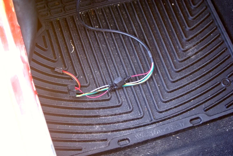

Zorba "The Veiled Male" Original poster Lifetime Supporting Member Joined Apr 2, 2020 Messages 23,881 Location Merritt Island, Fl May 12, 2020 #1 Found THIS while I was installing my voltage inverter under the driver's side dash: For factory cruise control, I assume?
Steel City 06 TJ Expert Supporting Member Joined Mar 12, 2019 Messages 5,145 Location Pittsburgh, PA May 12, 2020 #2 That looks aftermarket. It has a built in fuse. Perhaps a dinghy towing setup?
Apparition Sand Hollow '26 beginner trails in the books Supporting Member Ride of the Month Winner Joined Jan 17, 2020 Messages 119,417 Location Twin Cities, MN May 12, 2020 #3 Steel City 06 said: That looks aftermarket. It has a built in fuse. Perhaps a dinghy towing setup? Click to expand... Agree on the aftermarket, no idea on what it is for
Zorba "The Veiled Male" Original poster Lifetime Supporting Member Joined Apr 2, 2020 Messages 23,881 Location Merritt Island, Fl May 12, 2020 #4 Well ain't that just special. Guess I'll have to trace it out. Doesn't look like its ever been used.
dbbd1 go away... Supporting Member Joined Jan 4, 2019 Messages 2,196 Location Oregon May 12, 2020 #5 Yeah, follow it to the other end. The end in the pic looks like it might go to your radio and/or some type of iPod interface add-on for the stock radio.
Zorba "The Veiled Male" Original poster Lifetime Supporting Member Joined Apr 2, 2020 Messages 23,881 Location Merritt Island, Fl May 29, 2020 #6 Found it, simple enough. Its spliced into the wiring on the backside of the OBD II port. Must be for some kind of semi-permanent monitor or tuner. Reactions: Steel City 06 and Apparition
