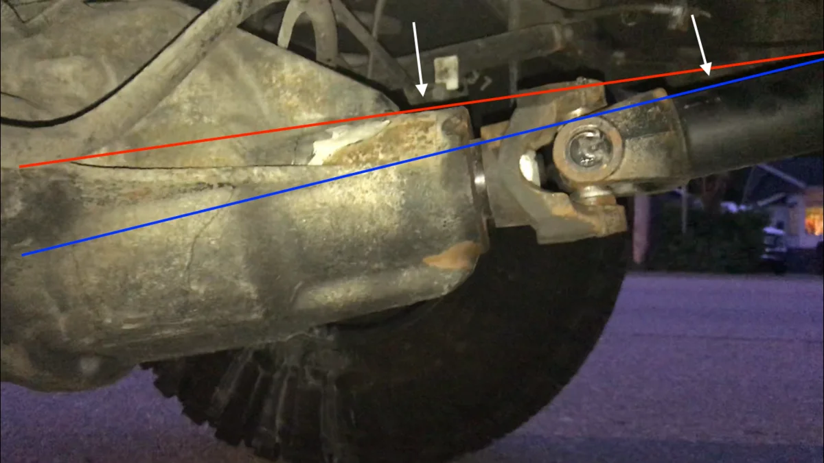

2. Are my lines correct in this picture? I saw that the angle finder should go where the two white arrows point to so I just put lines down on those surfaces and this is the result. I think the angle is a little harsher than illustrated simply because I couldn't get a picture of it nicely.

Yes, your lines are correct. The angle finder can go in both of those locations.
You want the pinion to be about 1-2 degrees lower than the driveshaft, as it will rise a bit upon acceleration.

1. You can adjust pinion angle with just adjusting the uppers. Make sure to cycle your axle to be sure nothing is contacting as the more you rotate back things can start to hit like diff on gas tank and track bar on gas tank etc. if this happens you need to shorten lowers and adjust again.
2. Place angle finder on one of the two flat spots to each side of the diff cover. You will get a number between 70 and 80 most likely. Subtract that number from 90. Ex: you get 75*. 90-75 = 15 so your pinion angle is 15. Make your pinion angle 1* lower than the angle of your driveshaft.

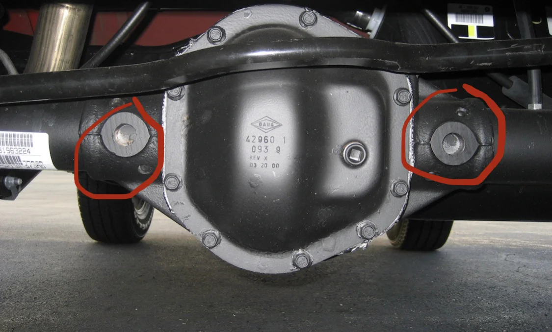

Nice socket works as well. Here is the spots I measure pinion angle. They are exactly 90 degrees to the pinion angle so again subtract the number you get from 90

Ok It looks like I had it all correct. As for where the angle finder goes, the spot on the diff I pointed to with the white arrow should be just as good as those two locations you circled on the back. Frankly I could do both and check. If they are the same then doesn't matter.
