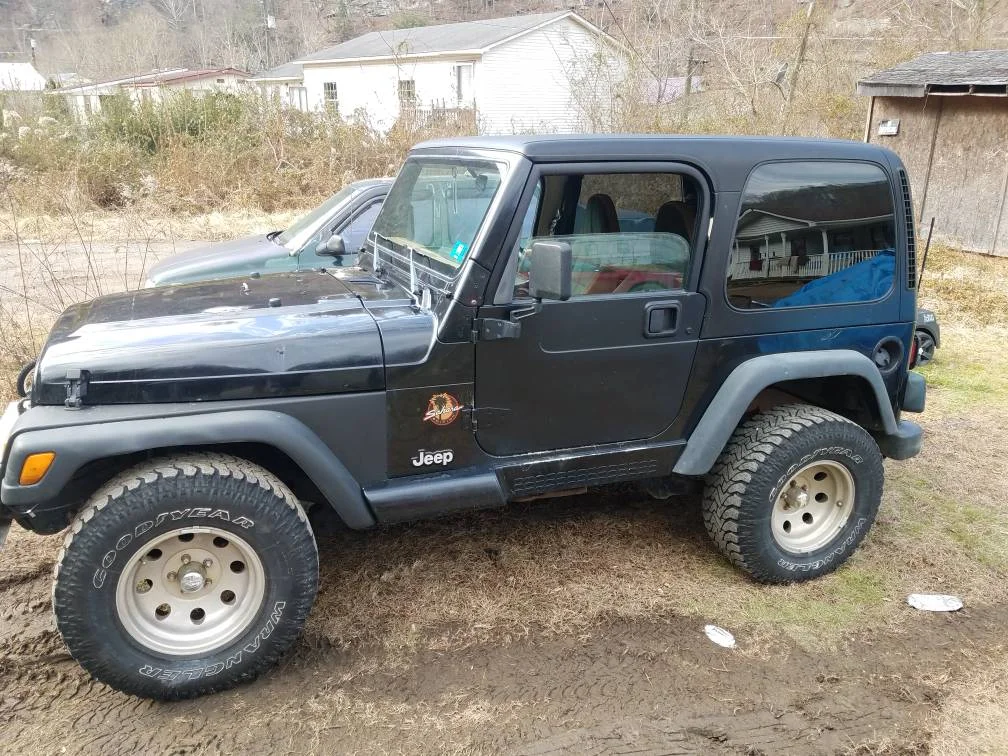

I'm going to plasti dip my wheels soon and was wondering if anyone has any tips to make them turn out nice

No, I've just heard it's the easiest to use. I'm just tired of the aluminum and trying to keep it clean and I've been wanting black wheels anyway

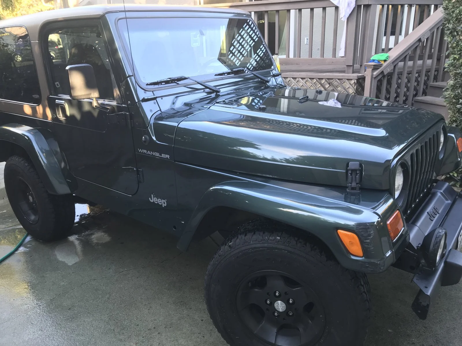

Oh, and the other guys are correct..."real" paint will work better, but this way you can "try it before you buy it." FWIW, this is Duplicolor's Wheel coating...three or four coats of paint, and three coats of clear.
WllDfochzLftd9QDqL-EEr5D58b9IW-BC3PBXmo6ILRnExJcFZ60tGCqRR1JNiRtpIsiVBVK2lNXmR_Etx=w1133-h638-no.jpg
