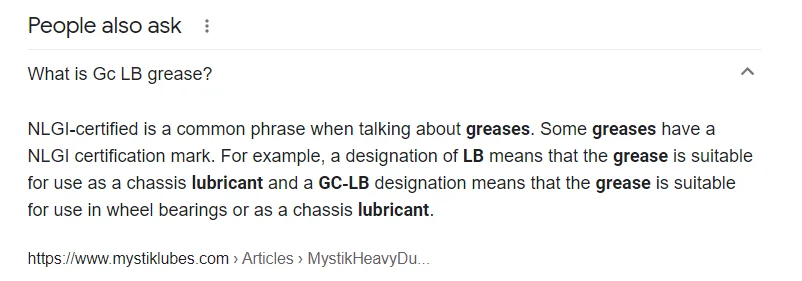

If I'm not mistaken it is recommended to use a NLGI #2, GC-LB grease.
Is the GC-LB part important? Because I can't find any in my local markets. I can find NLGI #2, but GC-LB is not mentioned.

Either of the two greases you point in posts 1 and 2 works fine on your TJ. Been in Europe is hard to find many lubricants specifications we use in the USA. The products are similar but MSDA and order regulation of use does not allow some stuff to be printed on the container.

So those I point as examples would be fine, while they are not mentioning the GC-LB?
