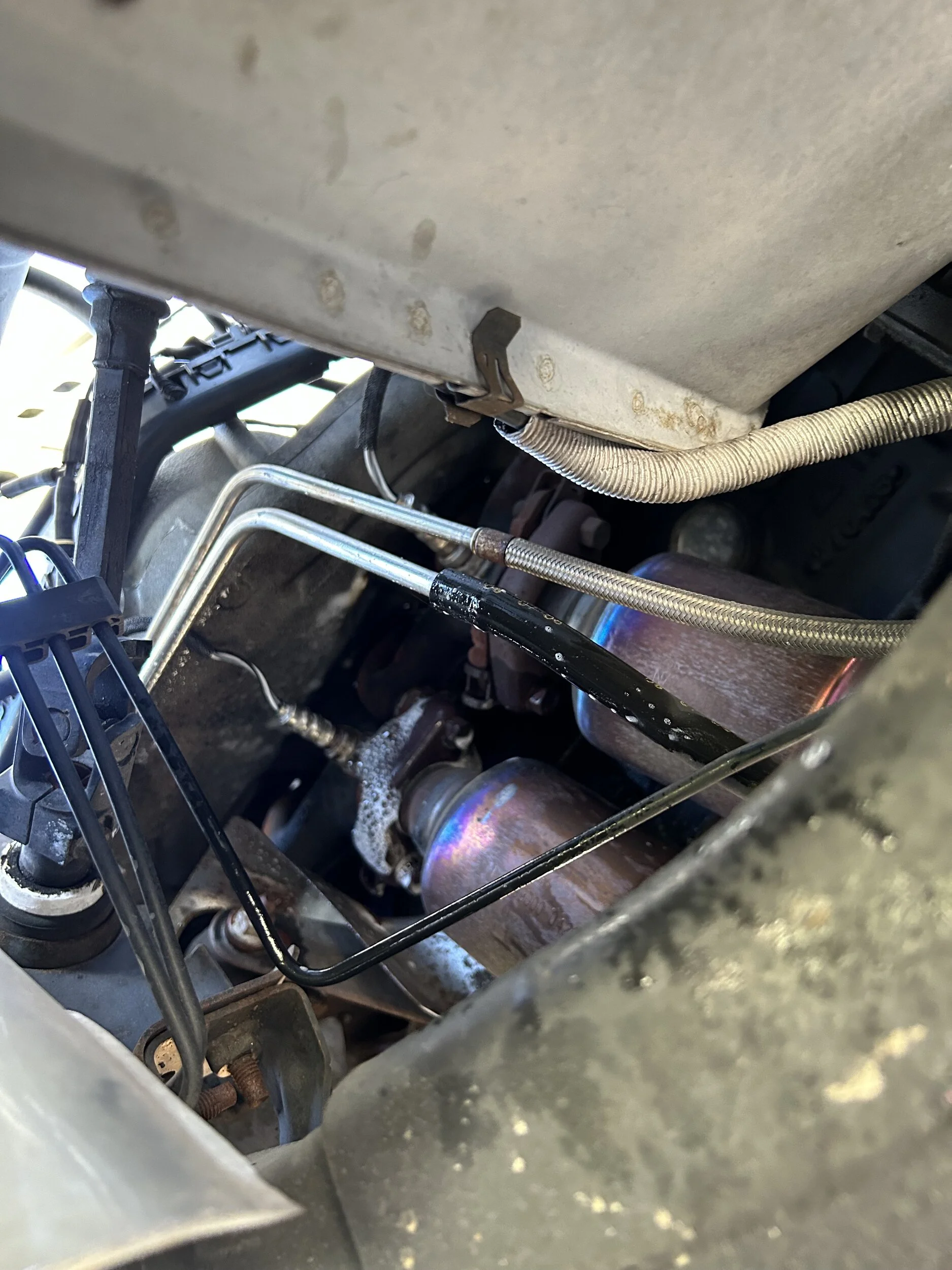

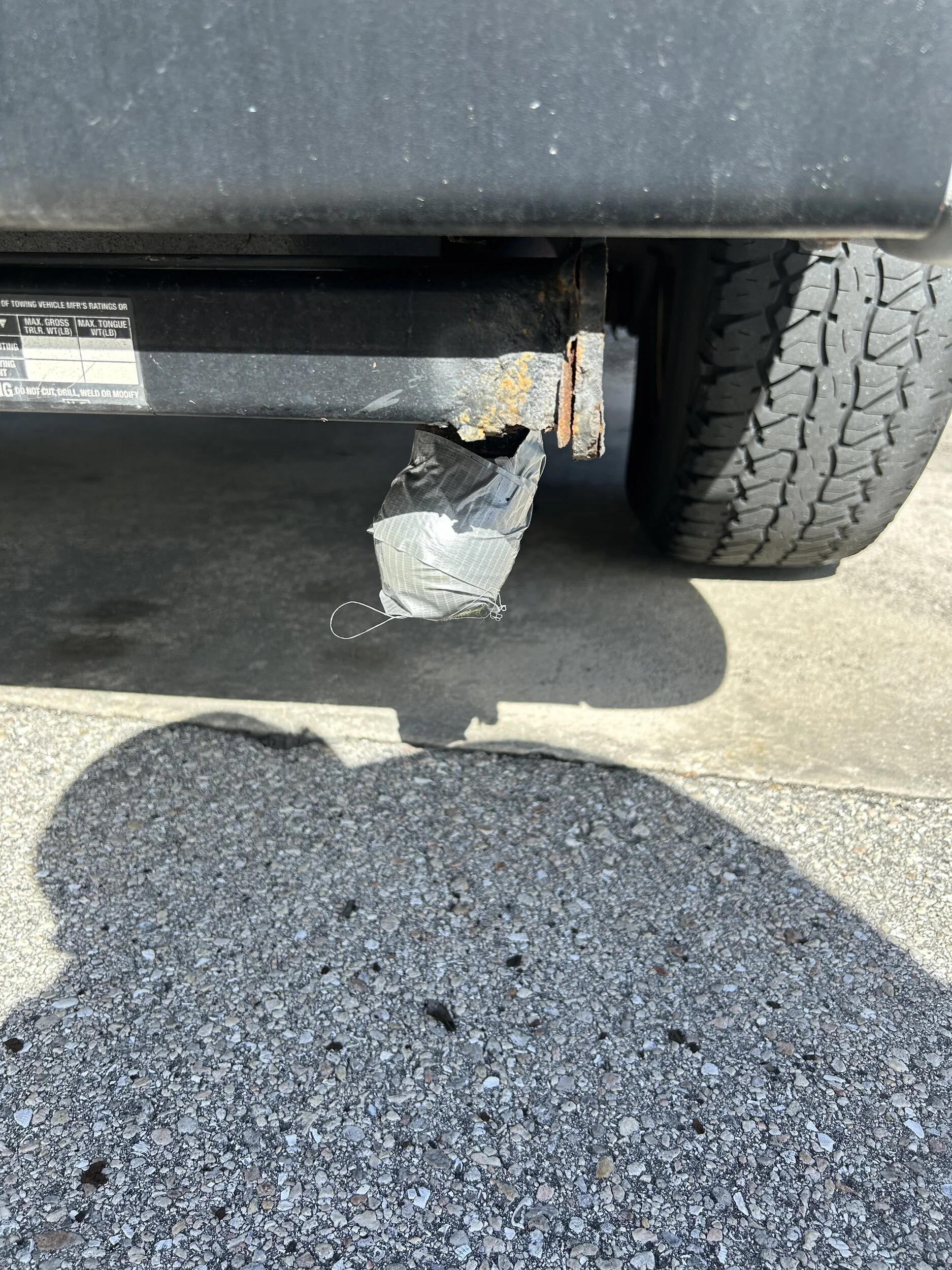

Found the root cause of the issue. Had a leak where cats attach to exhaust manifold. Taped a tennis ball to exhaust pipe to create back pressure and then sprayed soapy water while jeep was running.
