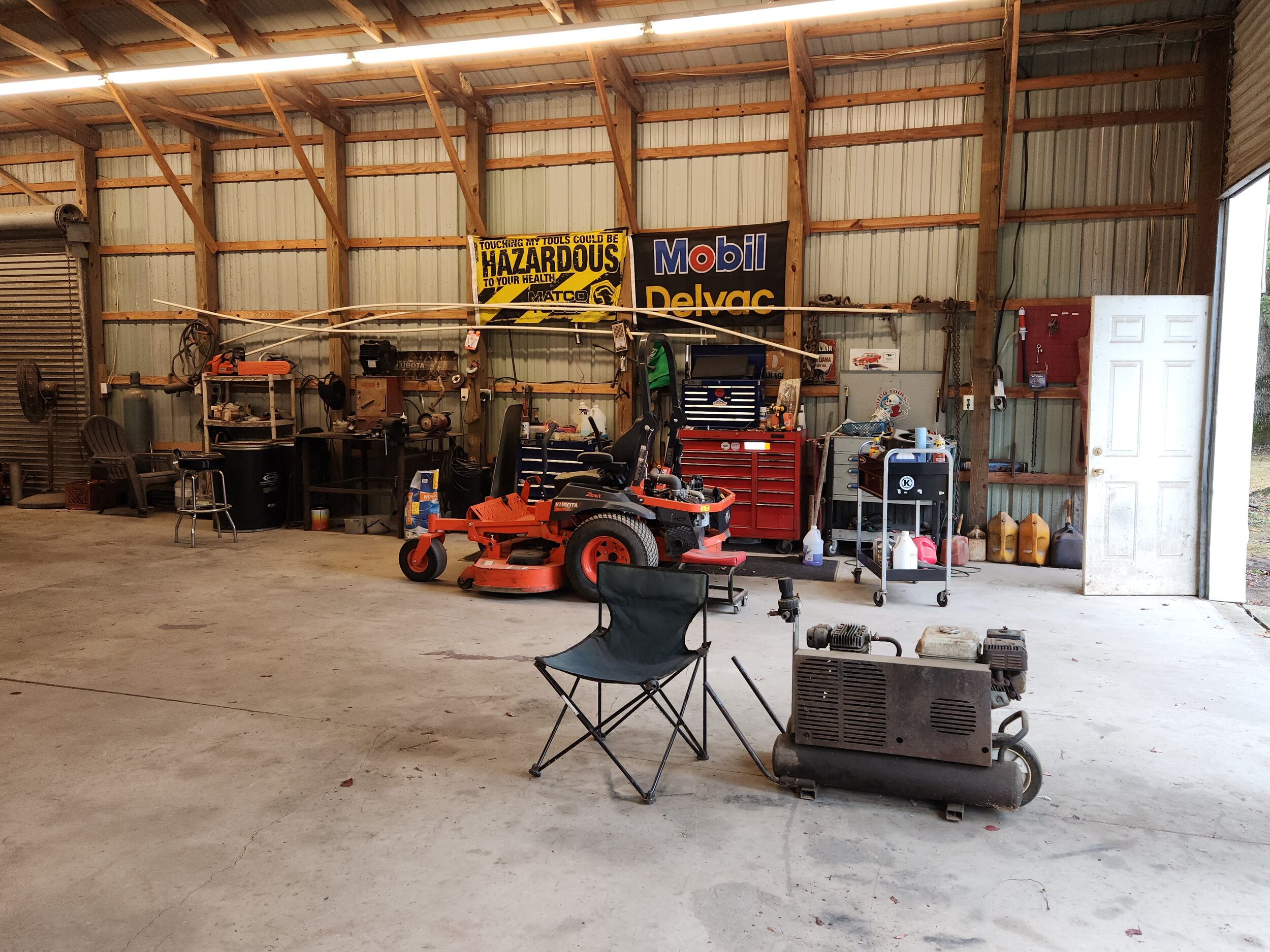

My shop was 24x40x8T with 2 doors on the eves side. So 2 bays for parking and a walled off 14x24 work room. I could just squeeze the truck in and close the door, but it was impossible to work on it in the Winter. I raised the roof on the original portion to 12ft and did an enclosed Lean-To addition to make it 36x40 with 2-10ft doors. The 14x24 work room is walled off and has a wood stove. It will get a window shaker or mini split at some point. The storage loft, you can walk around hunched over with a 12ft sidewall but 14ft would have been better.
Insulate if you can afford too when its built. So much easier. I retrofitted those wide RockWool Vinyl faced Blankets and hung them from the purlins with screws and fender washers. My trusses are on 10ft centers. Makes the most difference in the summer to not have that radiant heat coming off the metal. If your trusses are on 5ft centers or less then I would just staple up some plastic and line the ceiling with roof metal on the bottom chord. Then blow in cellulose.
100A service should be plenty with no electric HVAC, especially if you are usually working alone. I got by for years on 40A@240V and rarely tripped the main. Compressor and Plasma are my biggest loads now and thats maybe 60A.

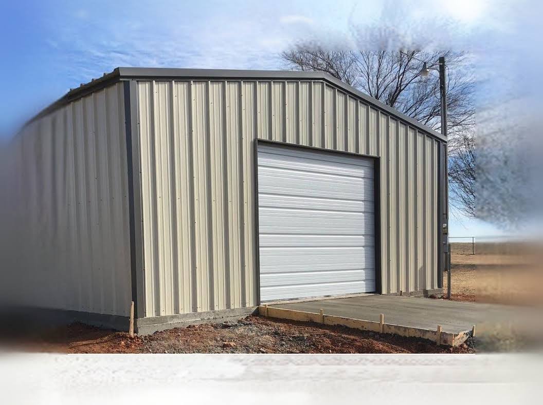

After work I will dig a little deeper but I also looking at style ideas- i dont want a plain box like this looking for ideas that dont blow budgets to a little more character/curb appeal.
Reactions: bbaldwin237
Monitor style is pretty budget friendly. Basically a tall barn in the center with side sheds.
Downside is posts in the middle of your space.
If you go with a 24' deep, 36' wide main structure...with two 12' side sheds...then theoretically you could take the back wall down, add more posts and girts and go bigger down the road.
