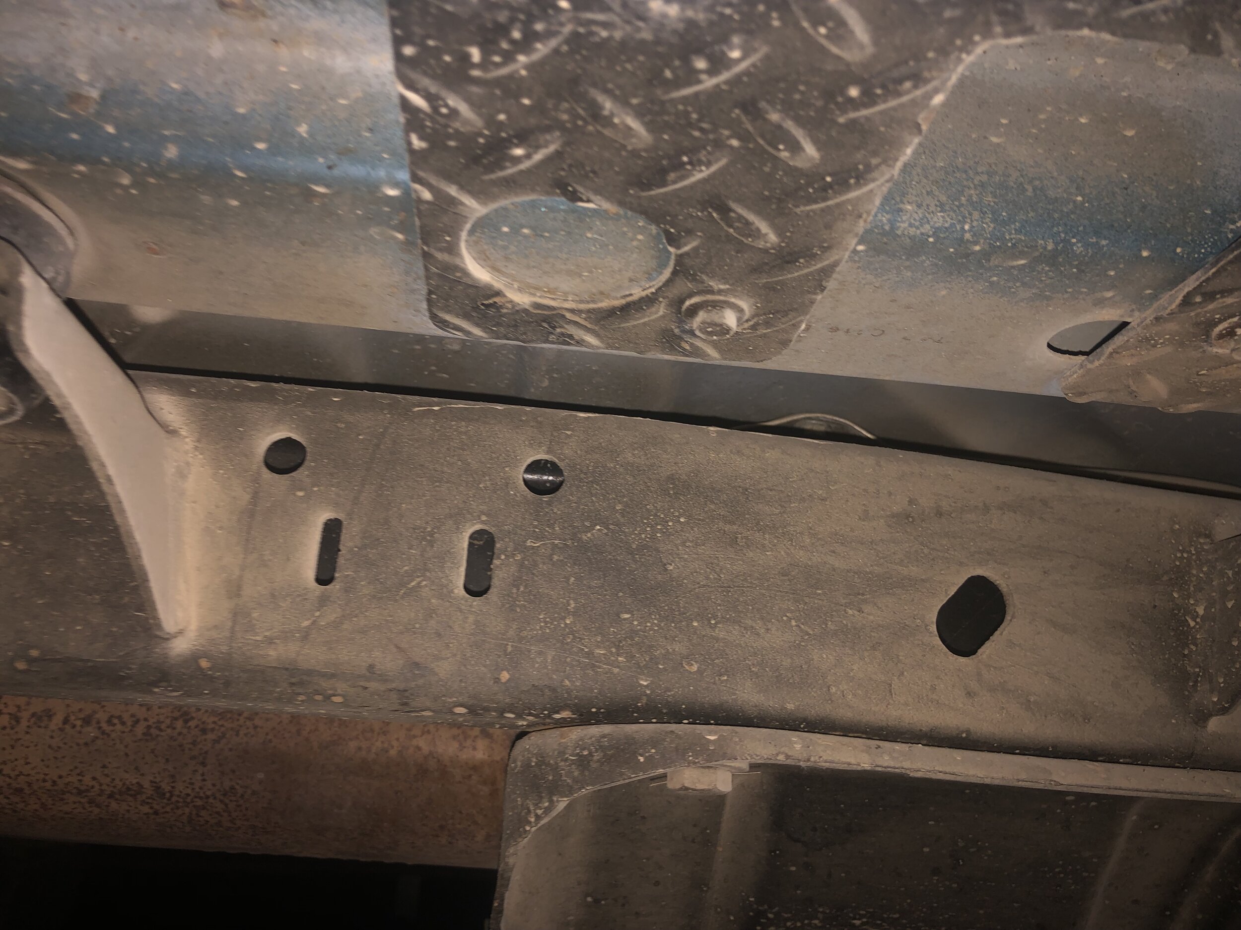

If it really doesn’t have a bolt on that one side, if you could find one bolt and get it to thread that would work till you could get it fixed. Problem is finding one of those bolts. Maybe order the kit linked to above and have it on hand.
I'm just wondering, how in the heck can that skid be held up...and holding up the driveline? There's not way all of that is held by 1 bolt, if I'm seeing that all correctly. If it is...I wouldn't drive it anywhere until that's corrected for sure.
I’m wondering if the two are just seized together and the pure power of rust is holding up half of the entire drivetrain 😂. Mother nature’s weld.
My thought too: rust weld holding that together, which in this case is a good thing. 😆

that or they held it up there until that frame coating dried and it's just glued together, TEMPORARILY ! Maybe they mixed in a little JB Weld and duck tape too :ROFLMAO: . Sorry OP but when I see stuff covered up like this it makes me go :unsure::unsure::unsure::unsure::unsure: I just hope you don't wind up having to do a a frame swap in the near future.
Moab a couple years ago, we had a fellow member who only had a bolt or two holding on his trans/tcase skid and it was noticed on one of the trails.

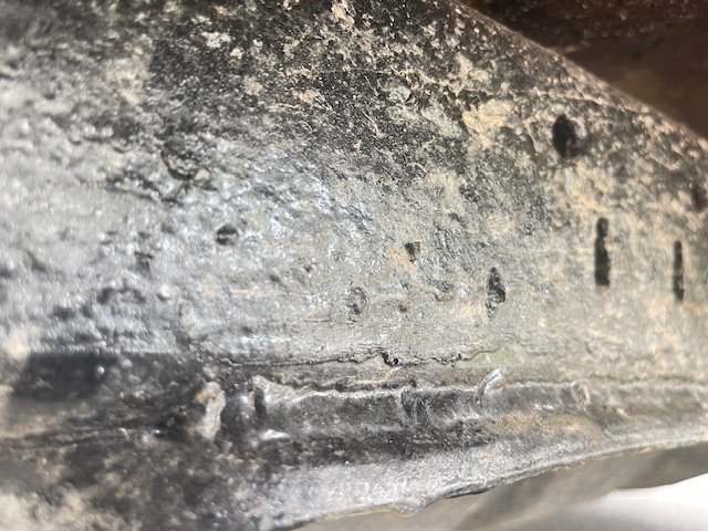

Between all but 1 of the skid plate bolts missing and this weld, I'd say your in for one heck of a rusty surprise. Skid looks like it could be welded to the frame.

The dirt on this frame makes it very hard for me to see clearly but it is possible that frame was completely rusted and painted over.
All of them have corrosion between the skid and frame. My Florida TJ had it, my TX LJ had it but it wasn't bad.
Yeah I agree, my LJR is from Wyoming and has some as well, but it's minimal like yours pictured. Too me that spot i circle appears to have a weld that's been coated with undercoating. and this would make sense with it missing almost all of the tcase skid bolts.

This looks like it had rust, someone put POR15 or something on it to stop it. Might be great for that region. I've seen them look much, much worse on this forum.

I followed up on the plate. It's welded on both sides the length of it. Not sure why, as I really got into the frame this morning. Scrapped away where there was some flaking, and It's really not bad. Probed and fingered all the holes :oops: not bad, jus say'n.
Why would the skid plate be welded on? I'm thinking they welded to brace the frame. It does have a class two tow hitch, the spare was removed, and it looks like all hardware and plates are brand new for it, so I'll reinstall.

My guess is that at some point, the bolts or receiving nuts that hold the skid to the frame either broke or failed, and someone just welded the sucker up instead of fixing the problem. We don’t see it a ton, but we do see it.

Sounds like you've got a mechanic / shop to help, personally, I'd get the 6 Nutserts from Black Magic, and bolts to match, and the tool to install those. I'd Pull it apart to see, and get that back to where it should. But, with what you are looking to do, that may be farther down the line. You might just have that on the "list" for later, if you're wanting to do other things.

I will eventually cut it free as I will want access. I’ll look a little deeper into it, but when it goes on the lift at my buddies we’ll really start getting into it. I’ve definitely driven some beaters in my day. Still here and I think this is a decent base to play with… time will tell. Until then… I’ll share what I do, and see what happens over time.
