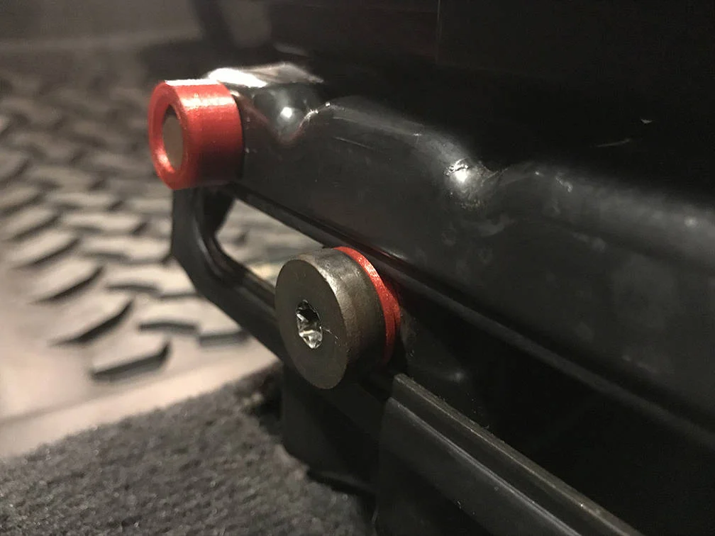

The front seats in my TJ rock back and forth about a 1/4 of an inch. This amount seems small but by the time the small movement makes it way up through the seat, the movement is very noticeable. My movement got to the point that it would rock backwards on acceleration and rock forwards on deceleration.

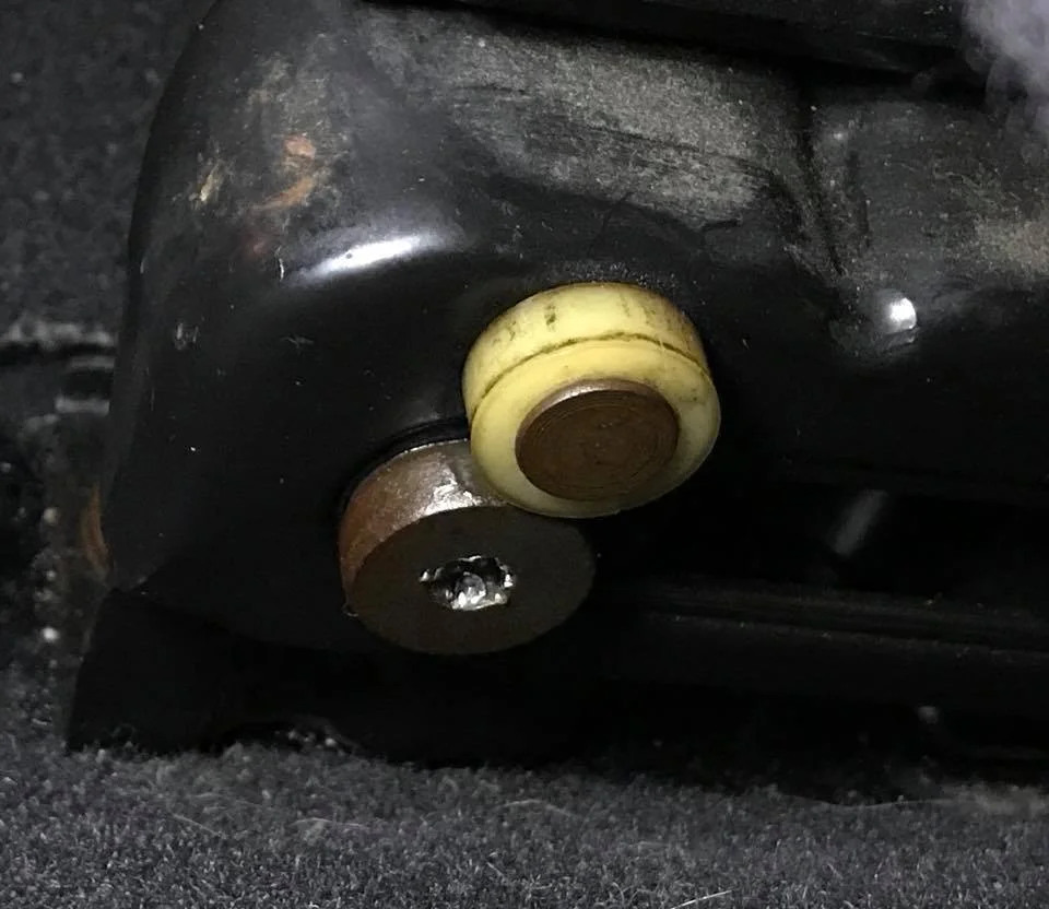

The problem is that the hard plastic spacers on the seat rails would break away in pieces.

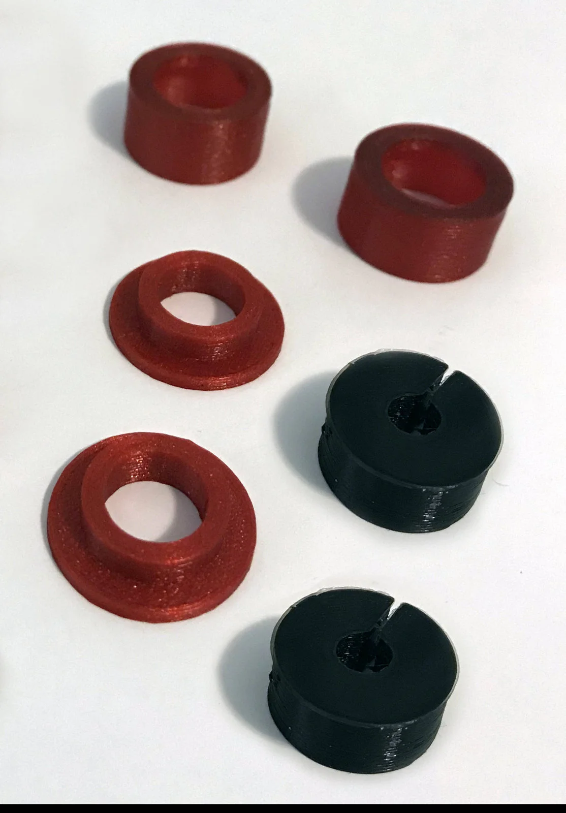

The Stable Seat replaces replaces these pieces with an aftermarket product.
The kit costs about $22.00 and takes about 10 minutes to replace the OEM pieces. The seats do NOT have to be removed. You will need a 40 Torx wrench to remove two bolts on each seat.
You can see the products on two different websites as indicated below:
https://www.facebook.com/stableseat/
https://www.etsystudio.com/shop/StableSeat/
There is a video showing the installation is very simple and very exact.

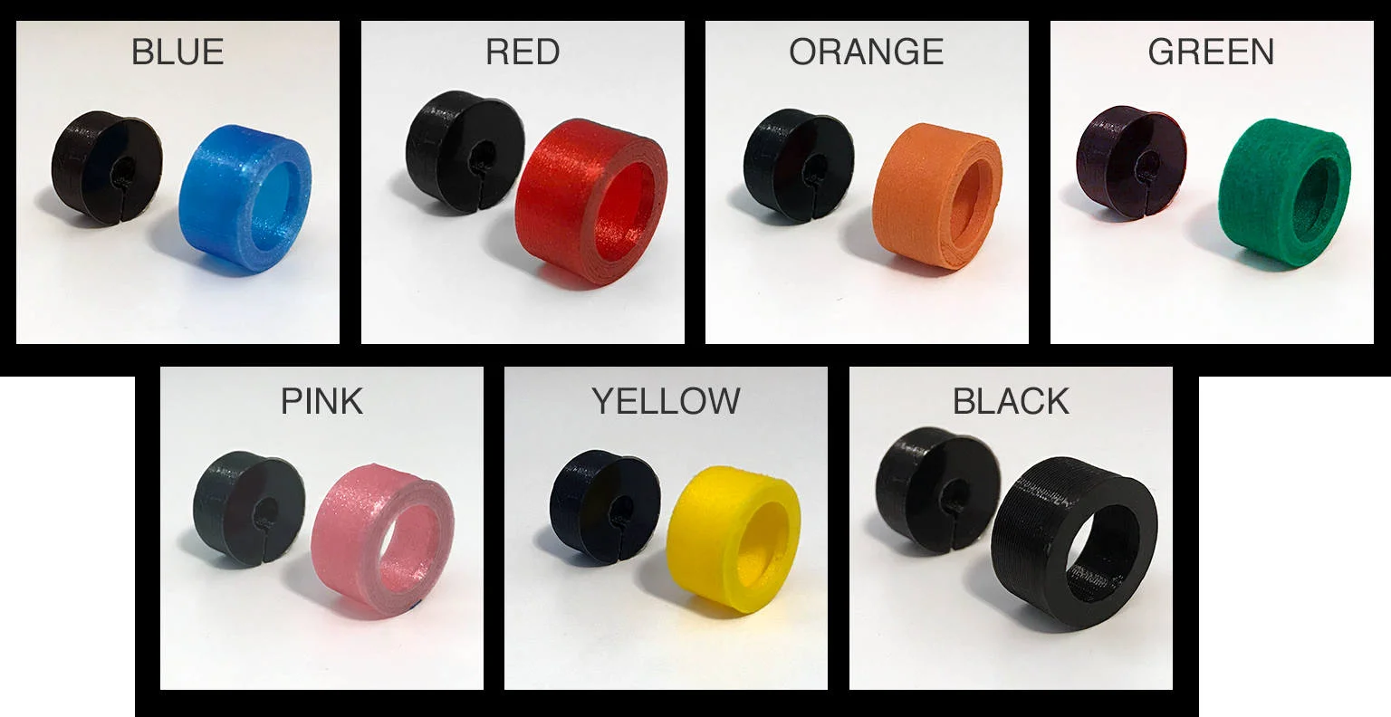

You can pick from several different colors of the plastic pieces including black, blue, green, orange, red or yellow.
In summary, the kit is very well made and really works to stop the seat from rocking back and forth.
I would highly recommend this product. Well worth the money spent.
Here are some pictures:
View attachment 42532 View attachment 42534 View attachment 42535 View attachment 42536
