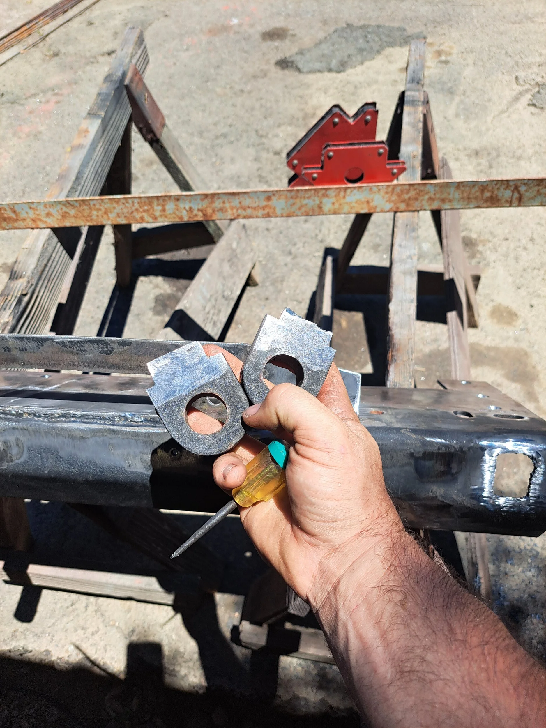

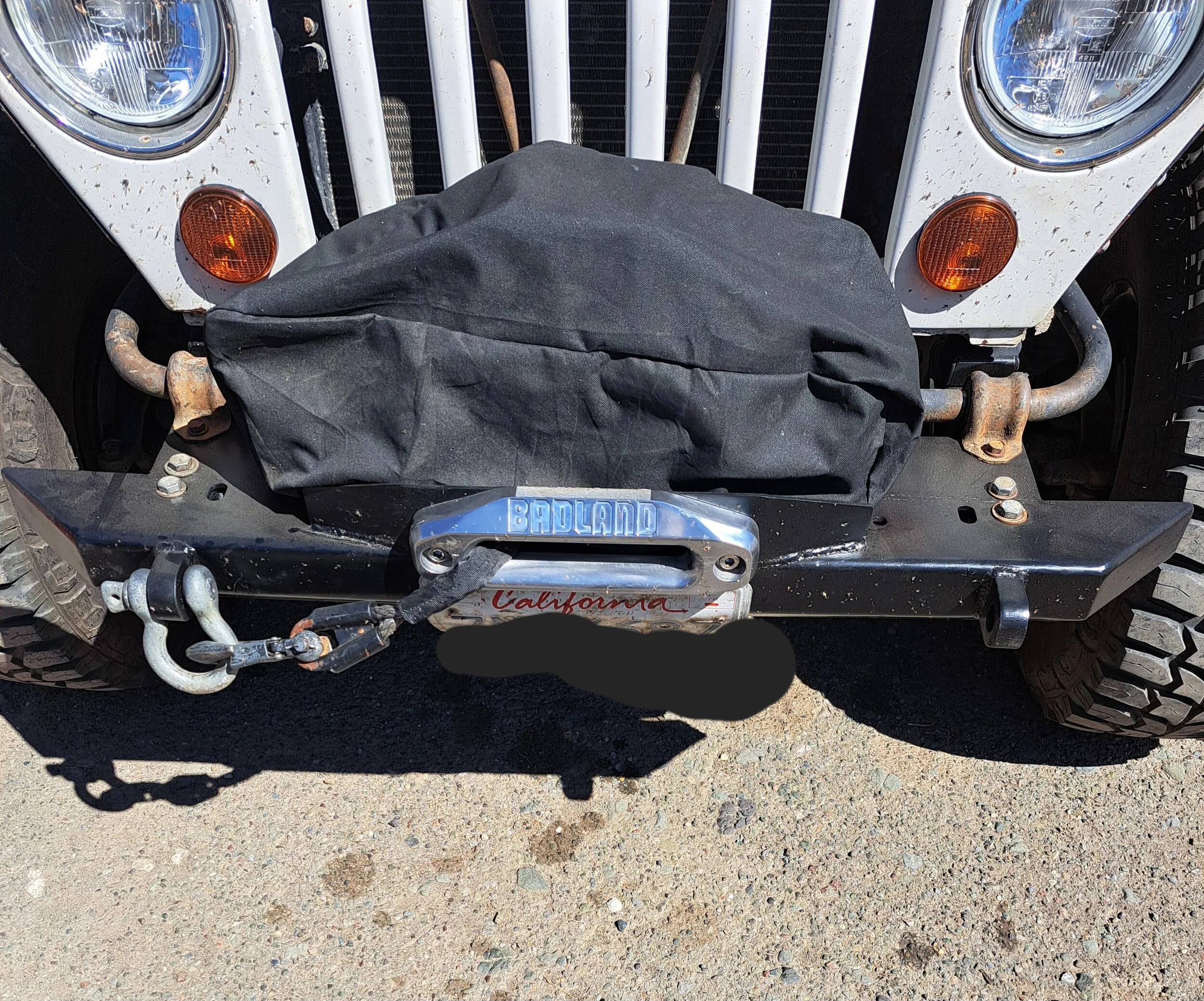

I finally finished a bumper project thats been waiting a while to happen.

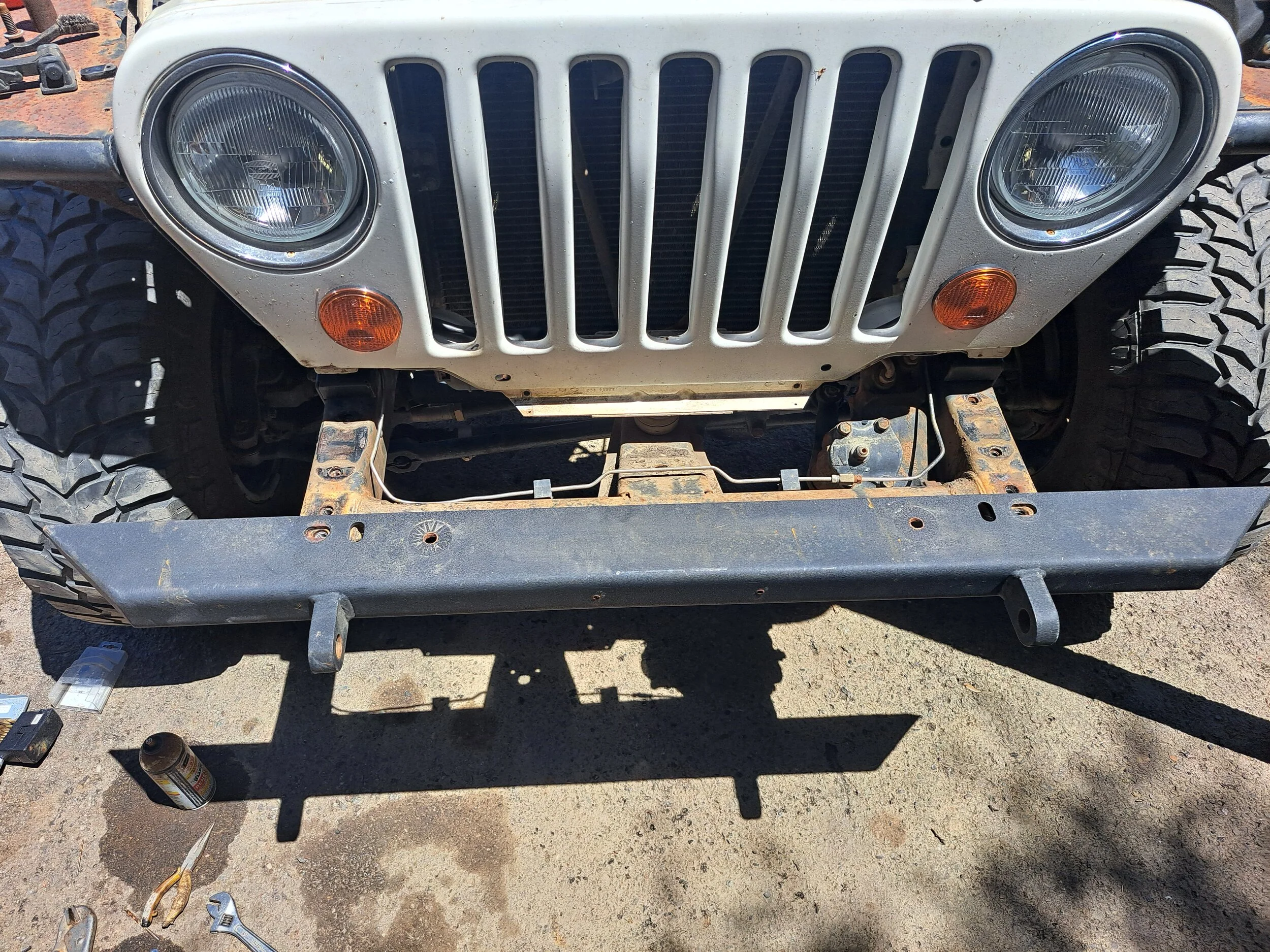

Got this cheap 3/16" bumper for 100$ and shortened both ends by 5"
It bugged me how far the shackle points stuck out so i torched them off and rewelded them in from both sides of the bumper.
They aren't trimmed up equally yet in the pic. I added 4" shear stock to the back of the bumper as a winch mount and a couple ears so the swaybar would be level.also welded 1" angle stock to the underneath to combat the winch deck warping i had before.No pics of that

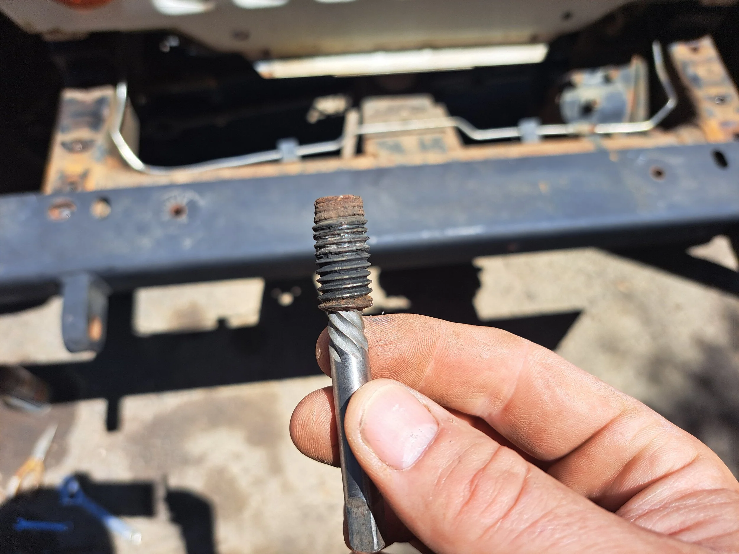

And because nothing gets to go smoothly i got to lay on my back with hot metal shavings burning me while i got this snapped bumper bolt out of the bottom of the frame. One of the last gifts from the previous owner. Including a metric bolt in the bumper that thankfully didn't mess up the nutsert enough to be unuseable.

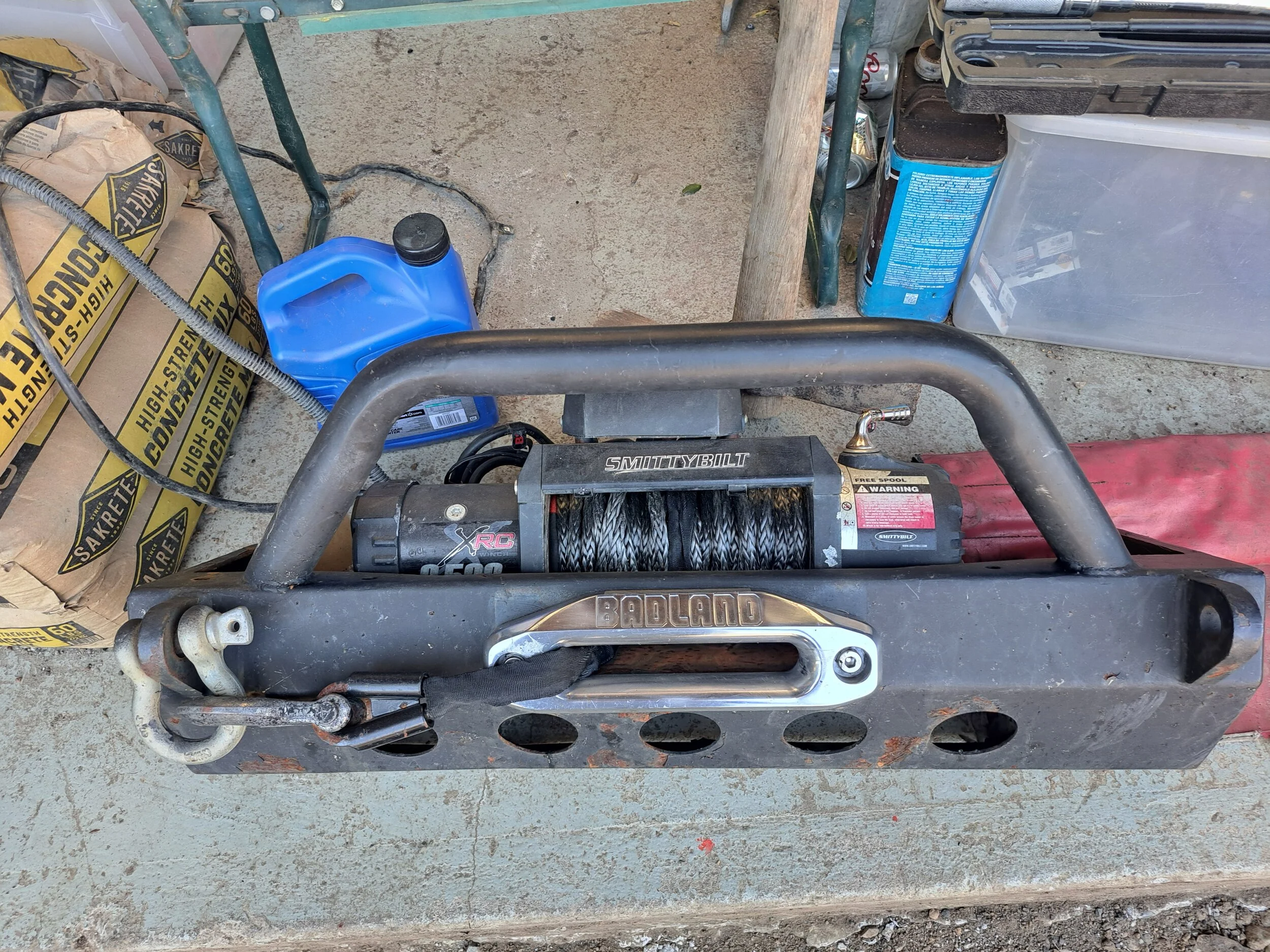

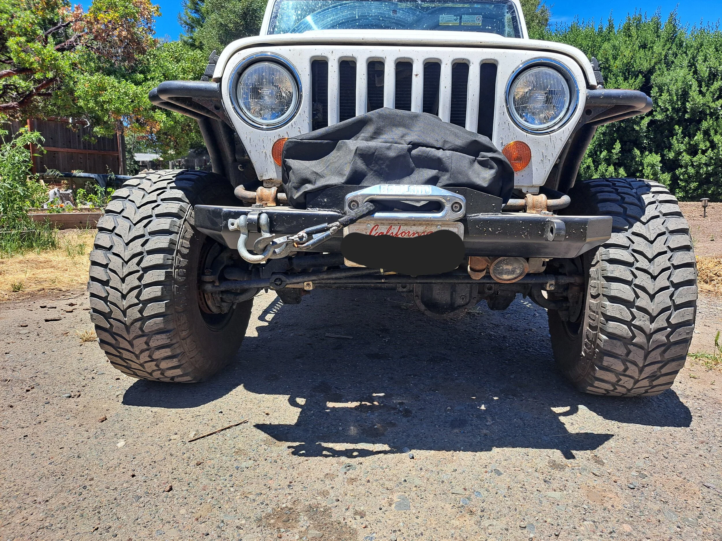

Here's the old 1/8" bumper that kept warping when I'd make heavy pulls
And the new bumper that matches my smittybilt style rear bumper

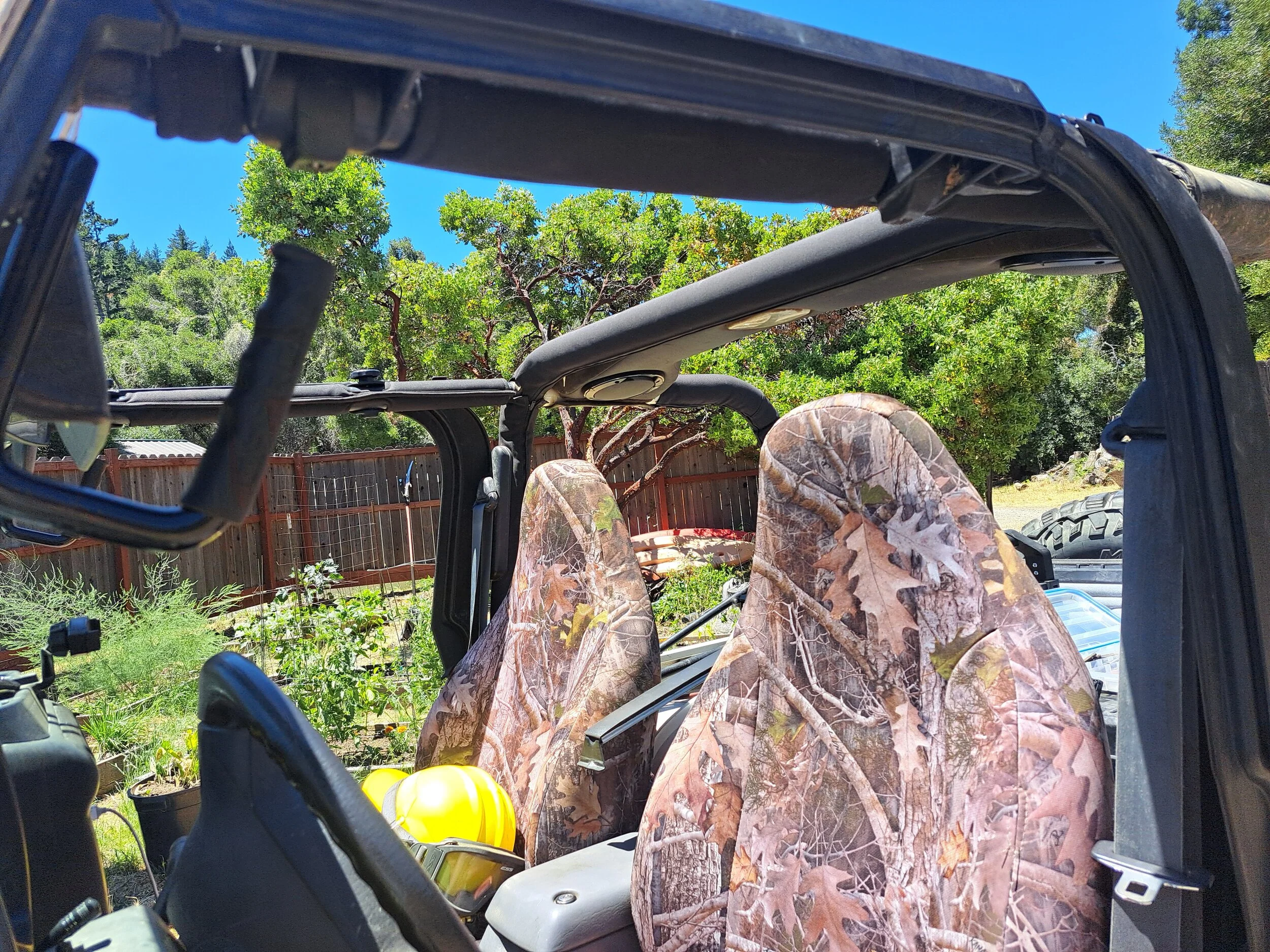

But what the heck I'm bored too so i might as well install a really nice quality roll bar padding set i got from @mjtjnj. Should save some bumped noggins and makes the interior look finished in my opinion

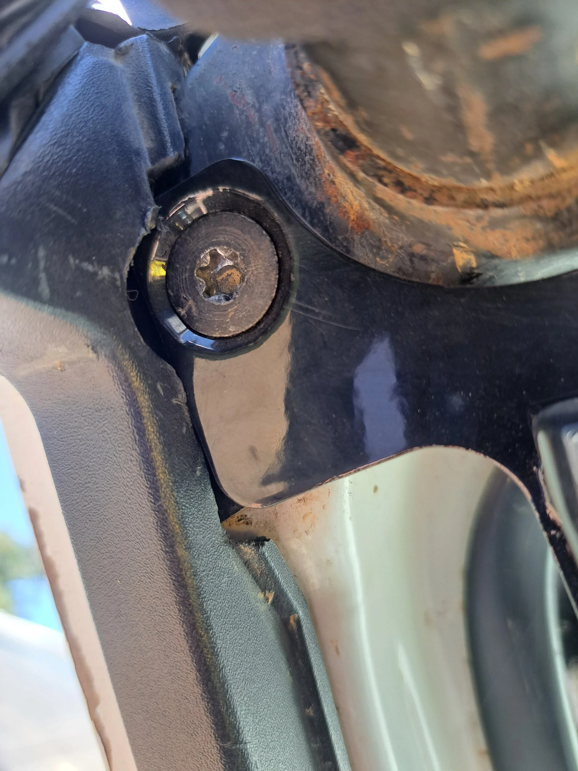

Also got my knock off grab bars in. I had to trim the a pillar plastic to fit them as shown

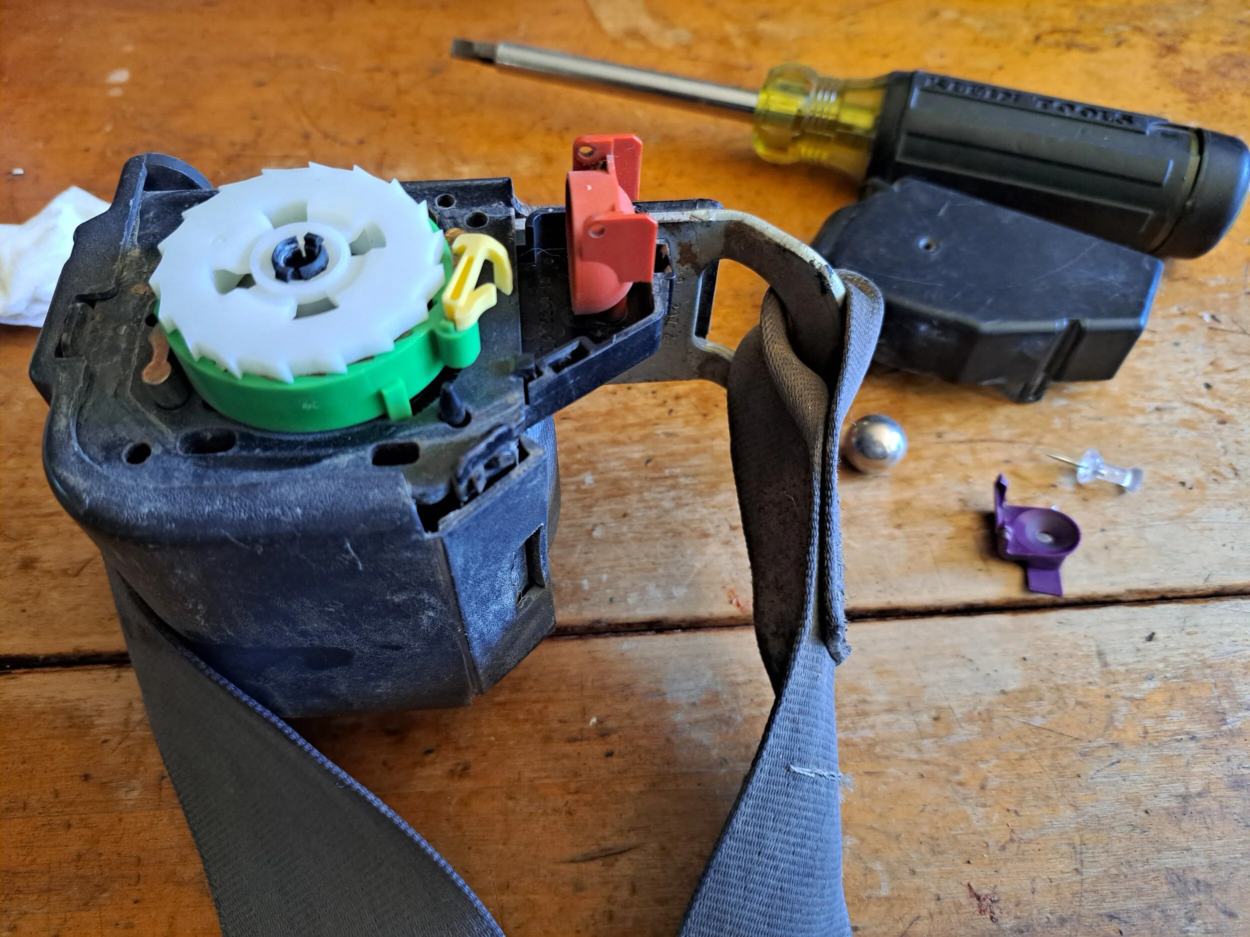

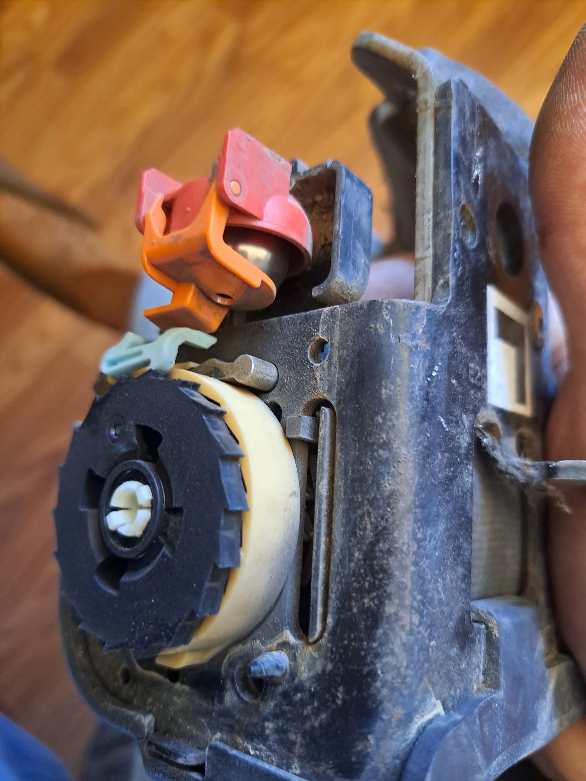

While i had the seatbelts off to install the padding i went ahead and took the black covers off the side and gently removed the ball bearing and retainer to clean the mud out. Worked the mechanisms at different angles while tapping to get dirt and debris out. A little compressed air helped too.
The seat belt locking mechanisms had a hair trigger resulting in needing to pull multiple times to get enough length to latch them.and occasionally they would tighten on us while offroading or just going down the highway. Fixed for now!
