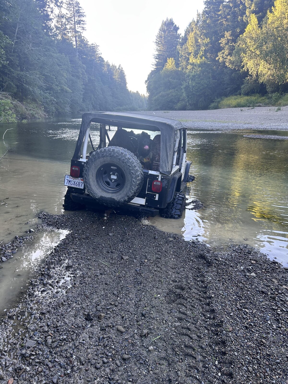

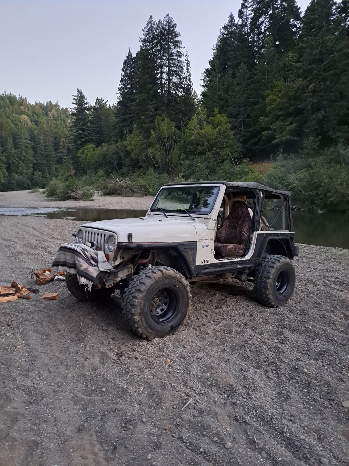

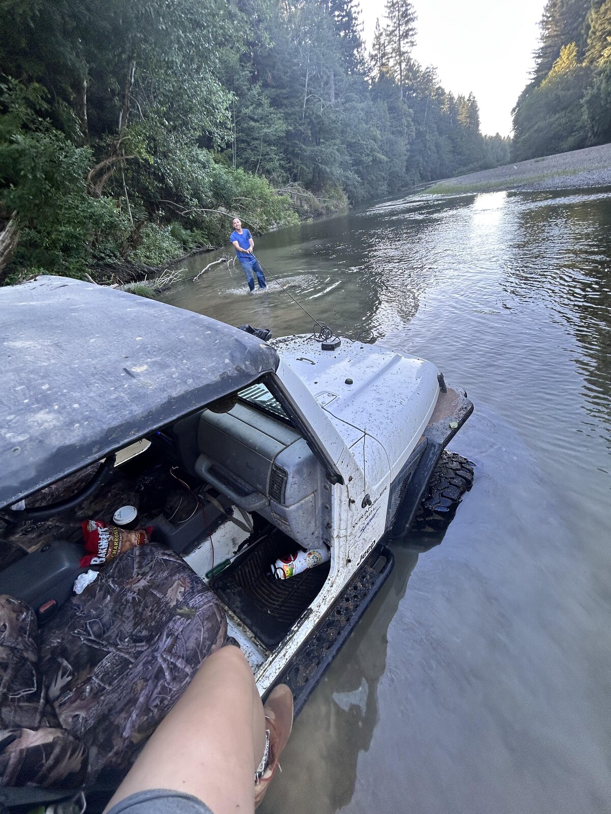

Did a little camping and river running on the coast this weekend to escape the heat.
Got a reminder that swampers aren't very good sand and gravel tires,lol
Had to winch over to a shallower section of river. Damn discs were getting jammed with rocks! I had to use low range to free them up

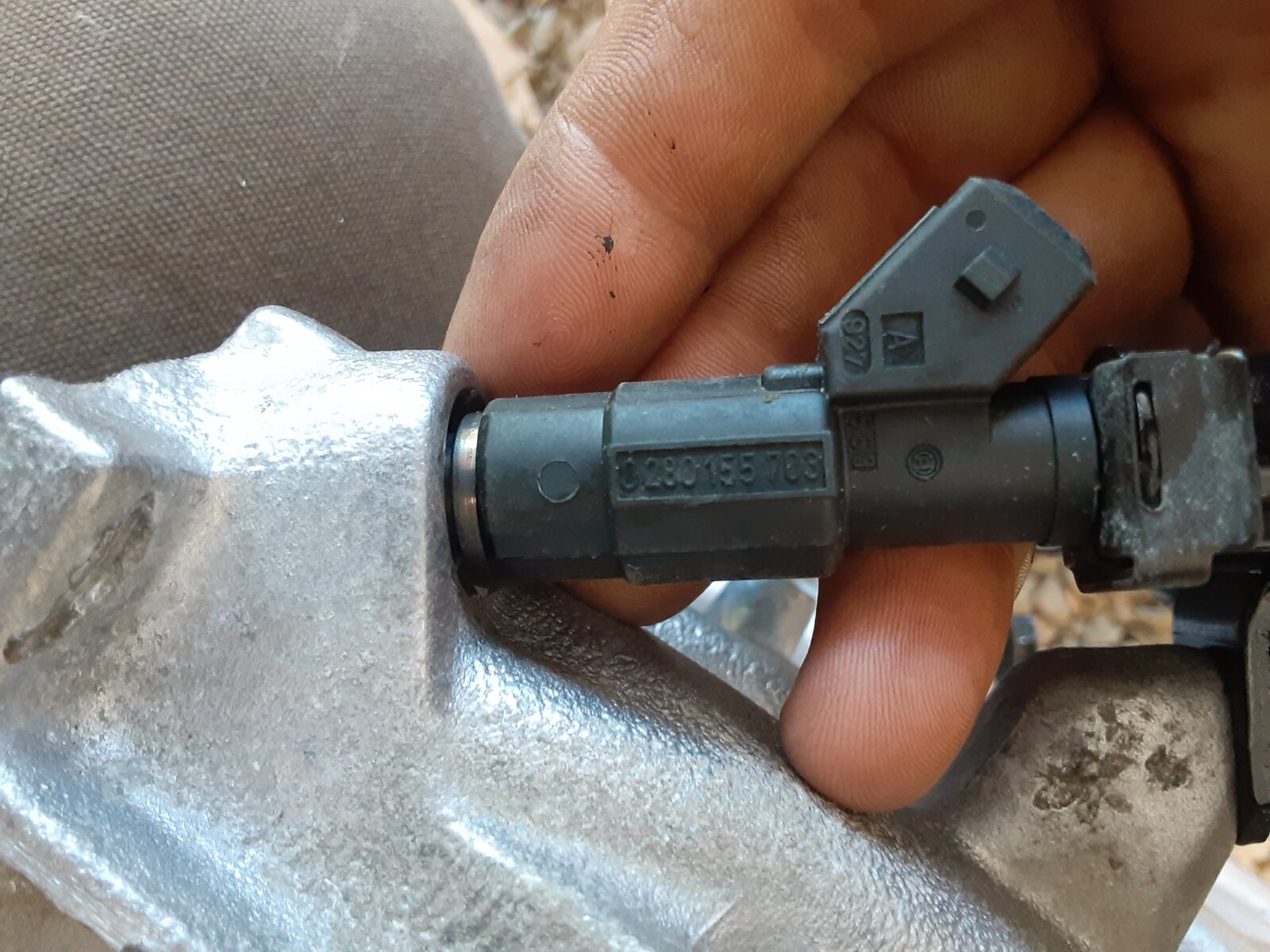

Used these 280155703 bosch 24lb dodge neon injectors. Motor runs good on stock injection with no tuning. Hp tuners compatible Wideband and some flyin ryan tuning would probably help unlock mo powa.

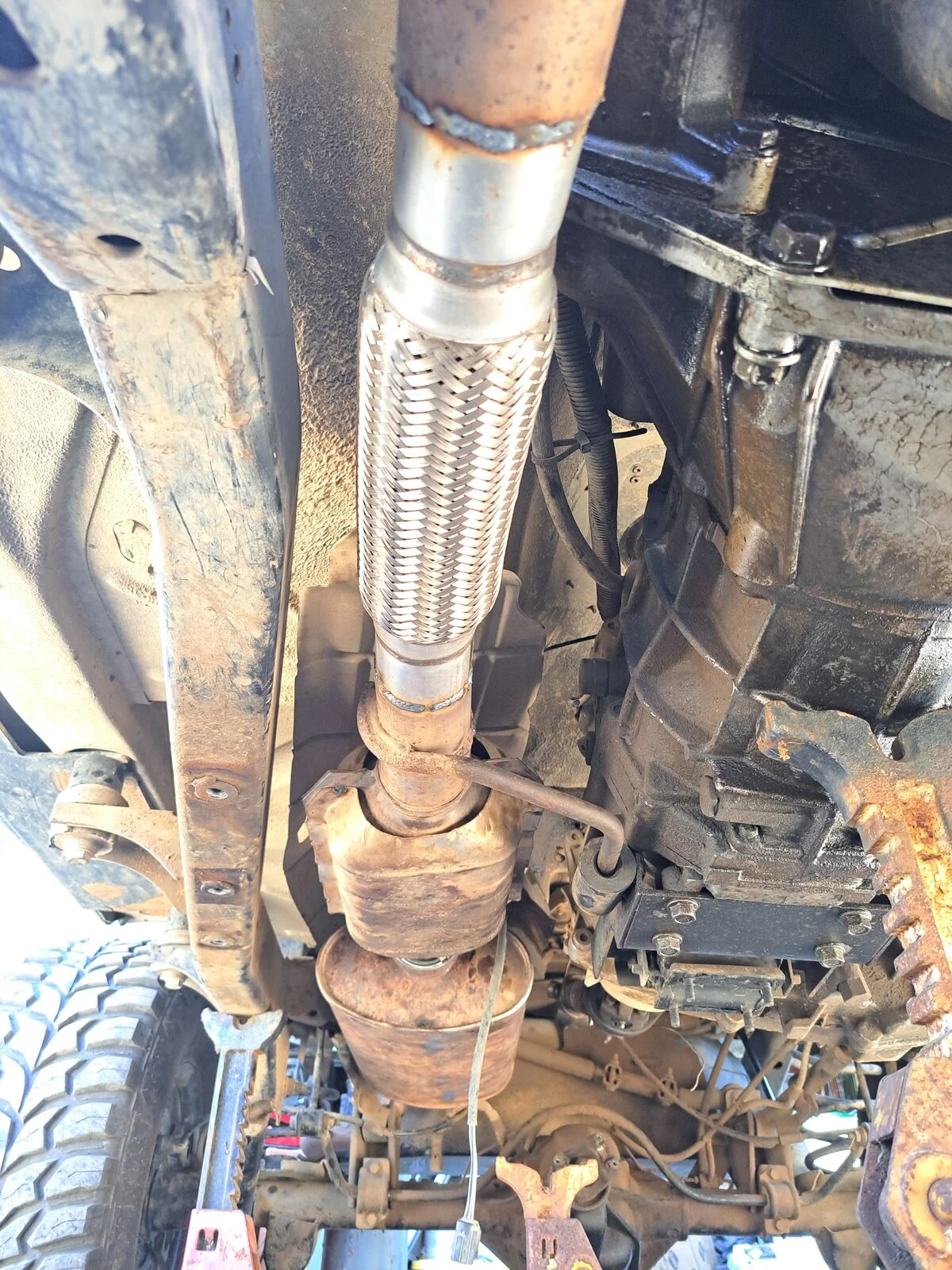

I finally got around to installing a flex joint in my exhaust that will supposedly help my header stay crack free. Yes thats a bad valve cover leak i need to deal with,lol

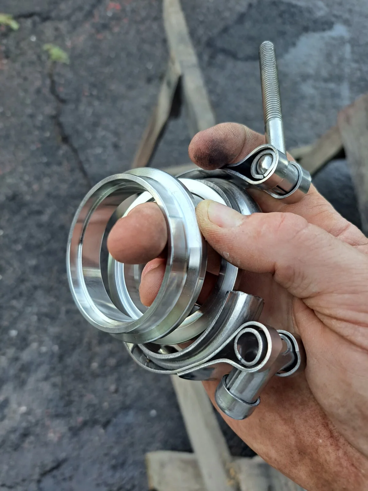

Also ditched the rattling napa muffler in favor of a nice condition 2005 rubicon oem muffler and tailpipe.the driveshaft and rear shock needed to be moved so i could snake the muffler/tailpipe combo in.i cut the factory ball socket off the muffler and used one of these cheap v-band couplers
No complaints on the test drive other than some smoke from the little bit of detritus left in the muffler by mice. I got some alarmed looks and comments from passersby😆.
The oem muffler isn't any quieter than the napa muffler. But at least it doesn't have baffles rattling.

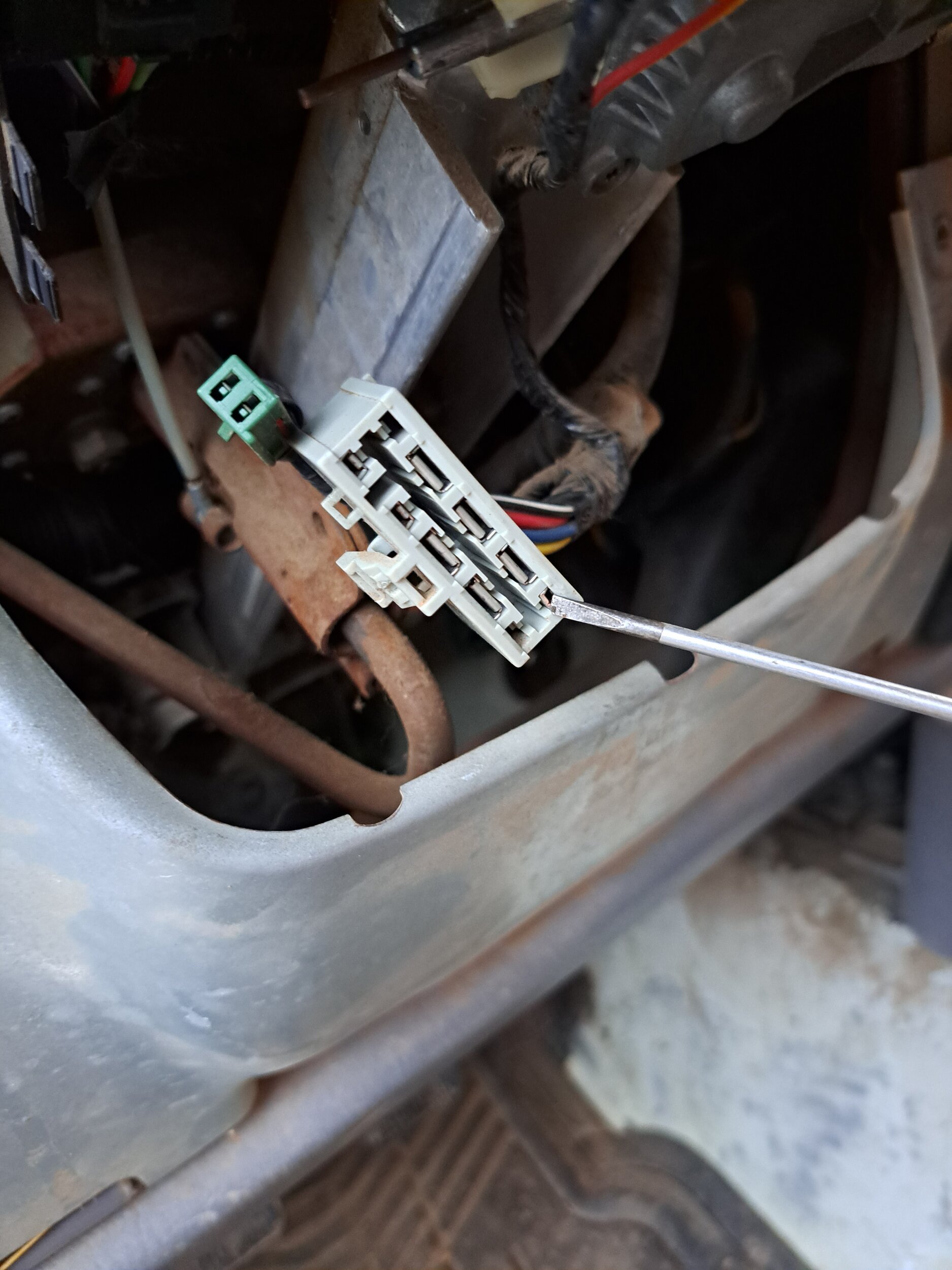

I started the troubleshooting when i got home and verified that i could crank it by putting power to the yellow wire coming off the ignition switch. Its the one I'm pointing to on the connector.incedentally that pin was a loose fit with a bad connection also.finding and fixing that added some time and frustration to the diagnosis.
Took apart the ignition electrical switch,cleaned up the contacts and reassembled with fresh dielectric grease but still no dice. It would start with a screwdriver in the switch but not installed on the column using the key,hmmm.i had previously taken the lock cylinder apart to rekey all 6 locks on the jeep the same and wondered if something was fubared there.
So i googled a few terms until it brought me back here to this site(no surprise there 🇺🇸) with a discussion that solved my issue!
My ignition actuator pin assembly had started to crack and wasn't letting the electrical switch rotate enough to crank. No pics as i did it in the rain with a bad mood,lol

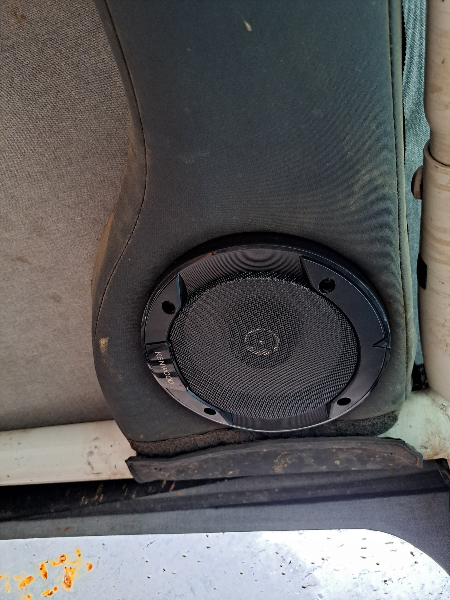

My soundbar has been dead for a month or so,and I've been procrastinating on diagnosing the problem. I was in my shop today and noticed i had some 6.5" kenwoods left over from another project and figured what the hay, I'll swap out one of the 5.25" polks to see if thats the problem. Easier than opening up the dash and troubleshooting the little kenwood amp and stereo right?well success! The kenwoods screwed right in place and i have loud(ish) music again! Its easy to forget just how little music the dash speakers(5.25" polks) provide until its all you have.
