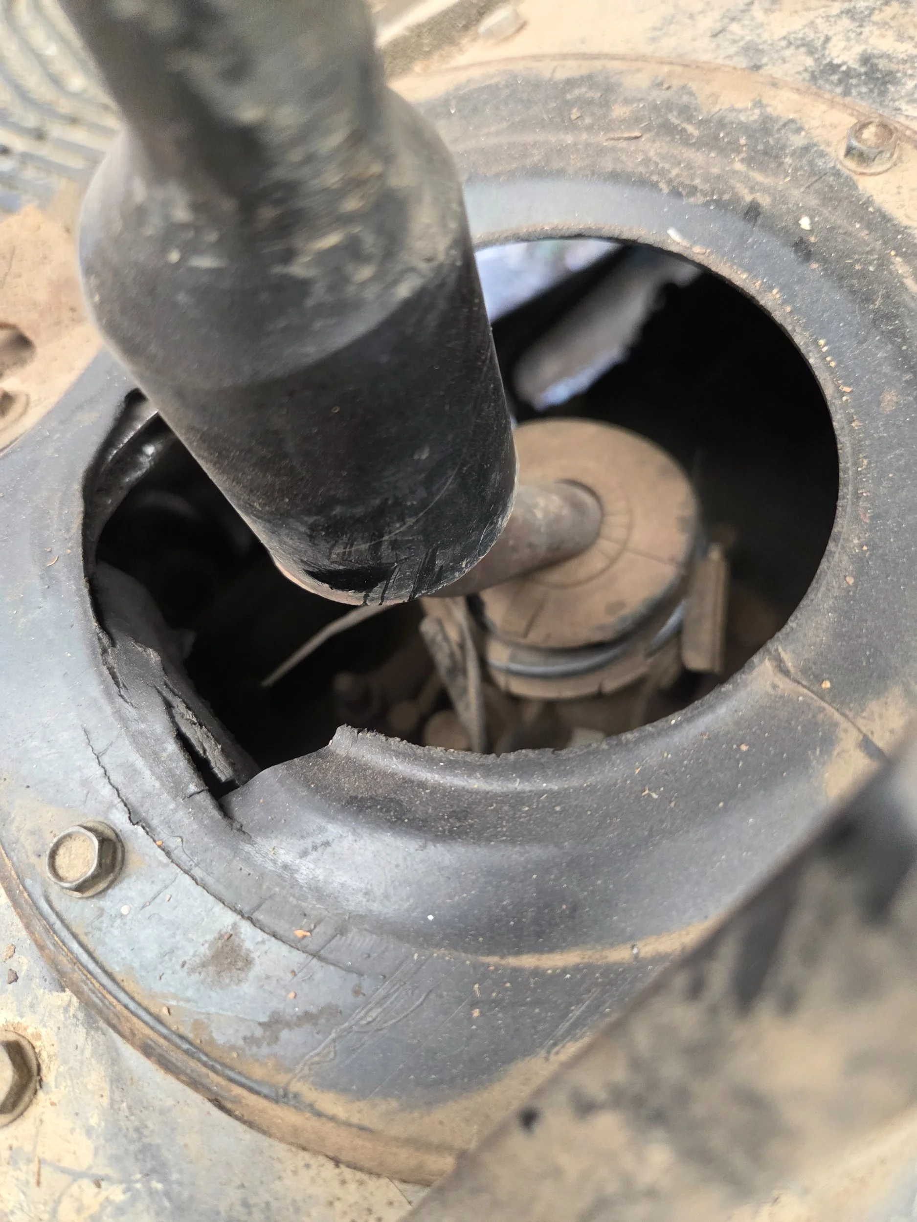

View attachment 635940there's cheaper ones but this is one of the examples of the stupid high price...
Mustang shift boot and some self tappers
