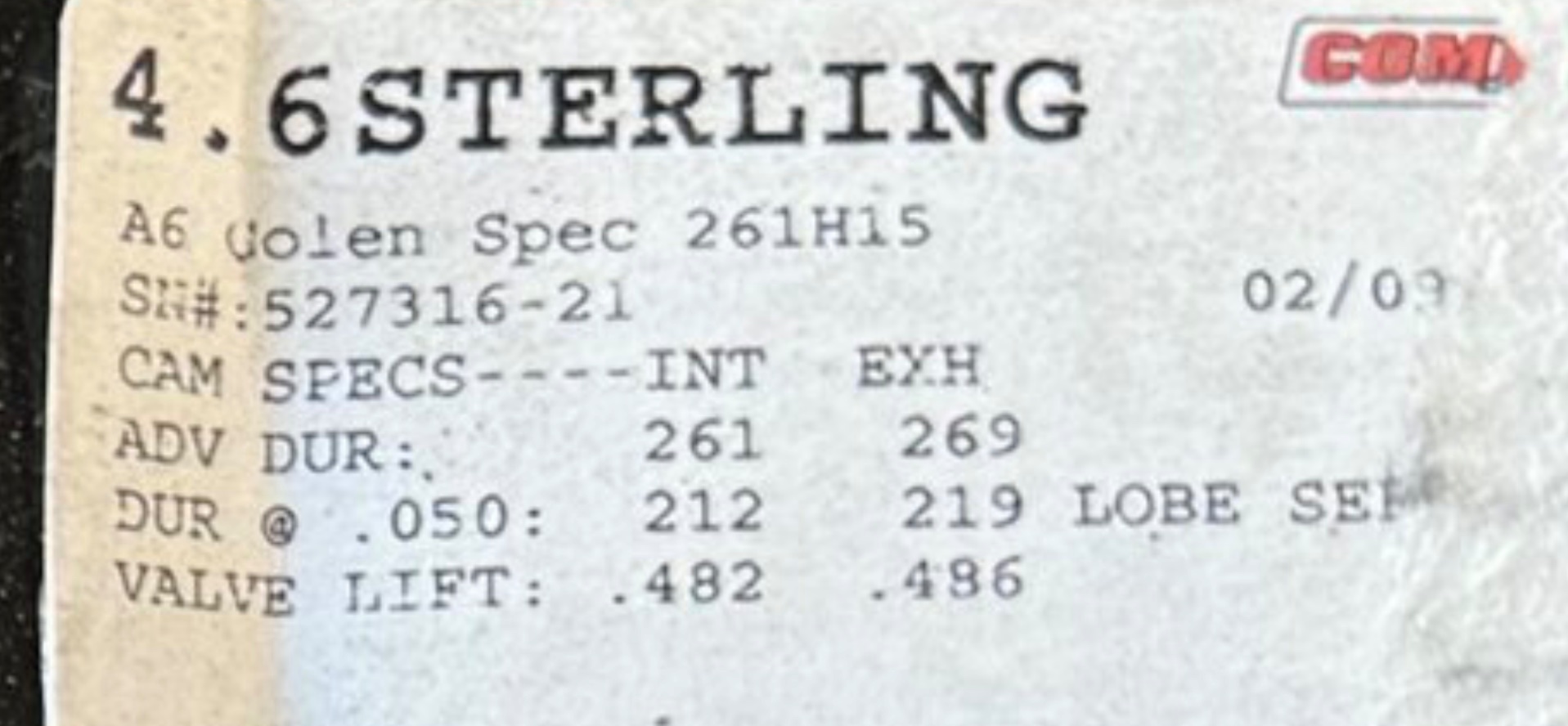

Here’s my cam card:
Its only a little less mild than yours.
My head is a 7120 and my block is a ‘92 which is pre-NVH. Whatever the reason, my valve train (or something) is definitely noisier than stock. I’ve done a couple of oil analyses with Blackstone. The first was a little concerning. Fuel dilution and multiple metal particulates were higher than spec. However, that all settled down 5 or 6K later.
With regard to yours, the Eddy head is aluminum, correct? I’m not sure if that effects things but it might transmit more sound? Is your block stock or pre-NVH?
Yes,aluminum head and a 96 nvh block.

Here’s my cam card:

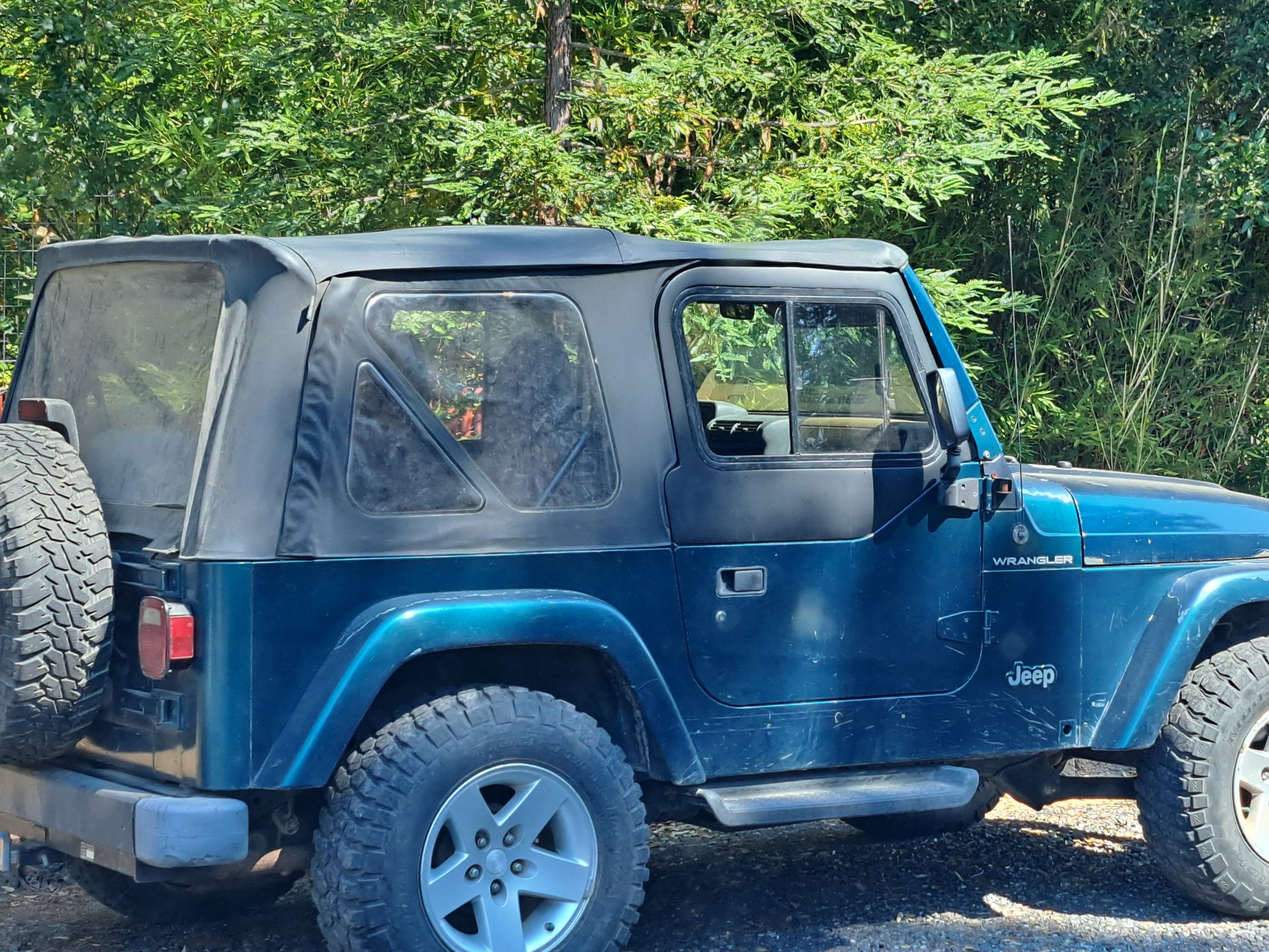

Also,I finally took a pic of how well the flat black slider uppers match my dads soft top. Not too bad.the shadows make it a little hard to see,but I'm happy with the rustoleum flat black

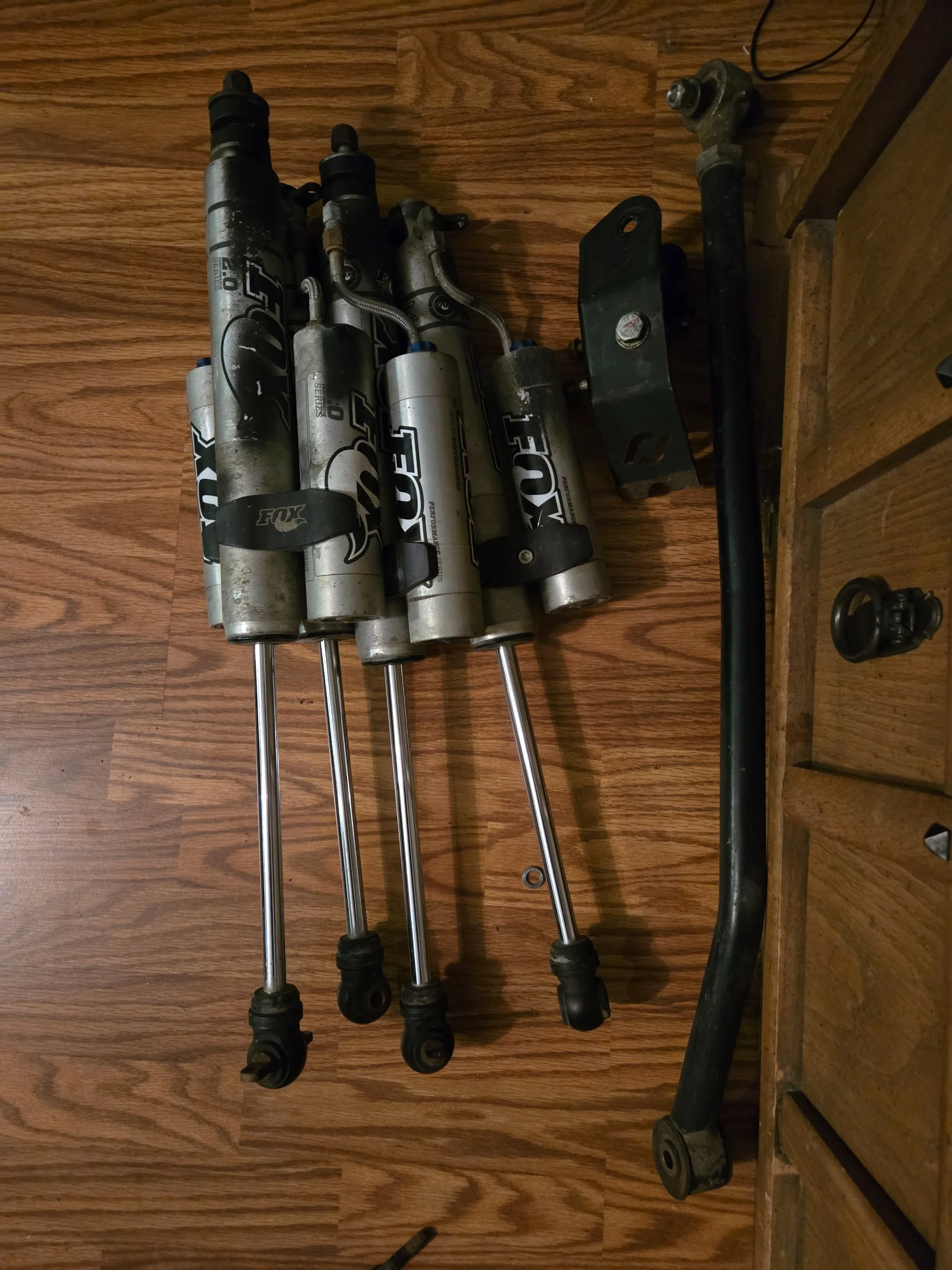

Thanks to @ChadH for the great deal on a rear currie trackbar and some fox shocks! Honest guy and packed everything very well. Everyone who got parts from his back to stock project is lucky. I'm grateful to be part of a community like this one.

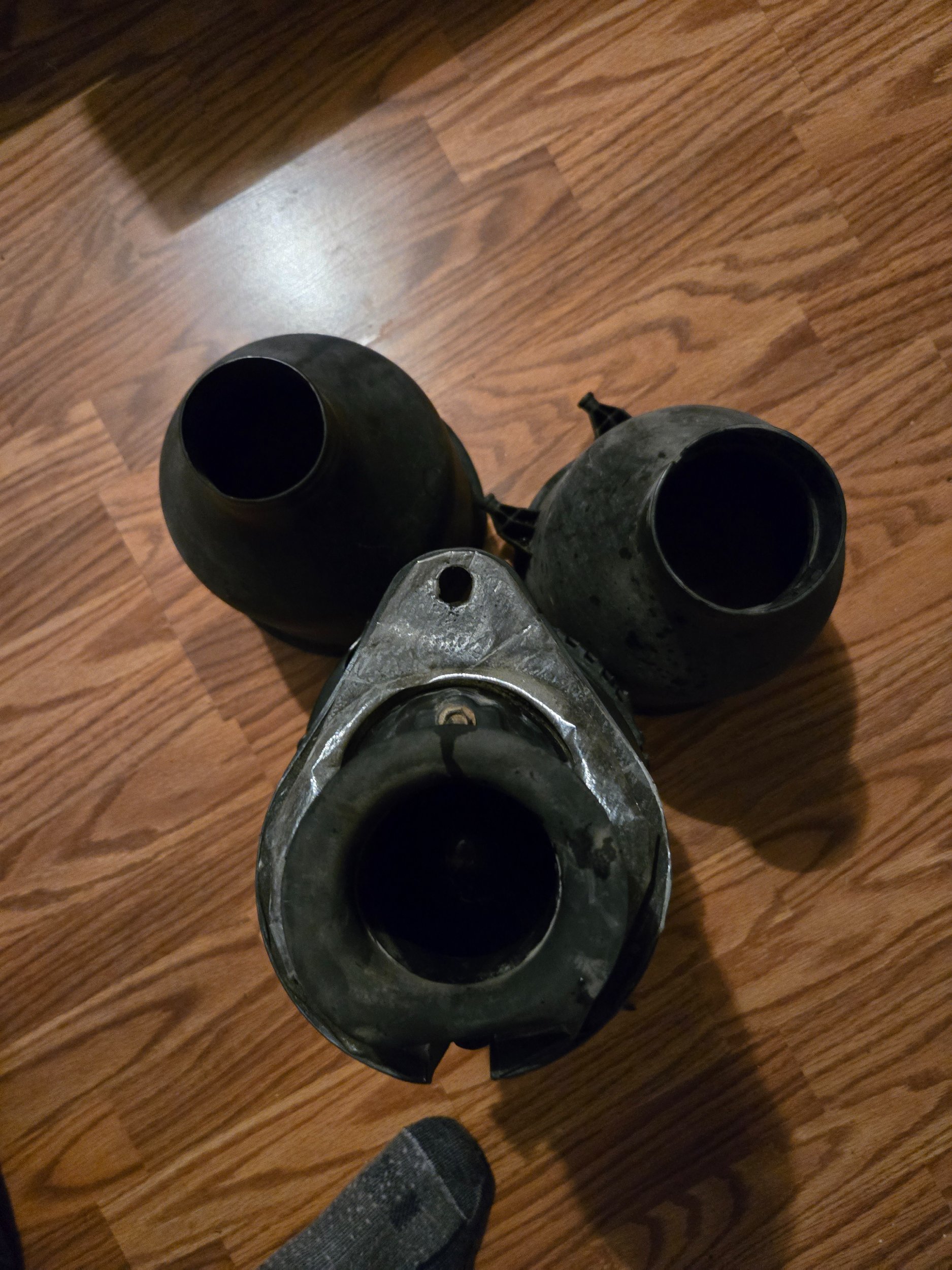

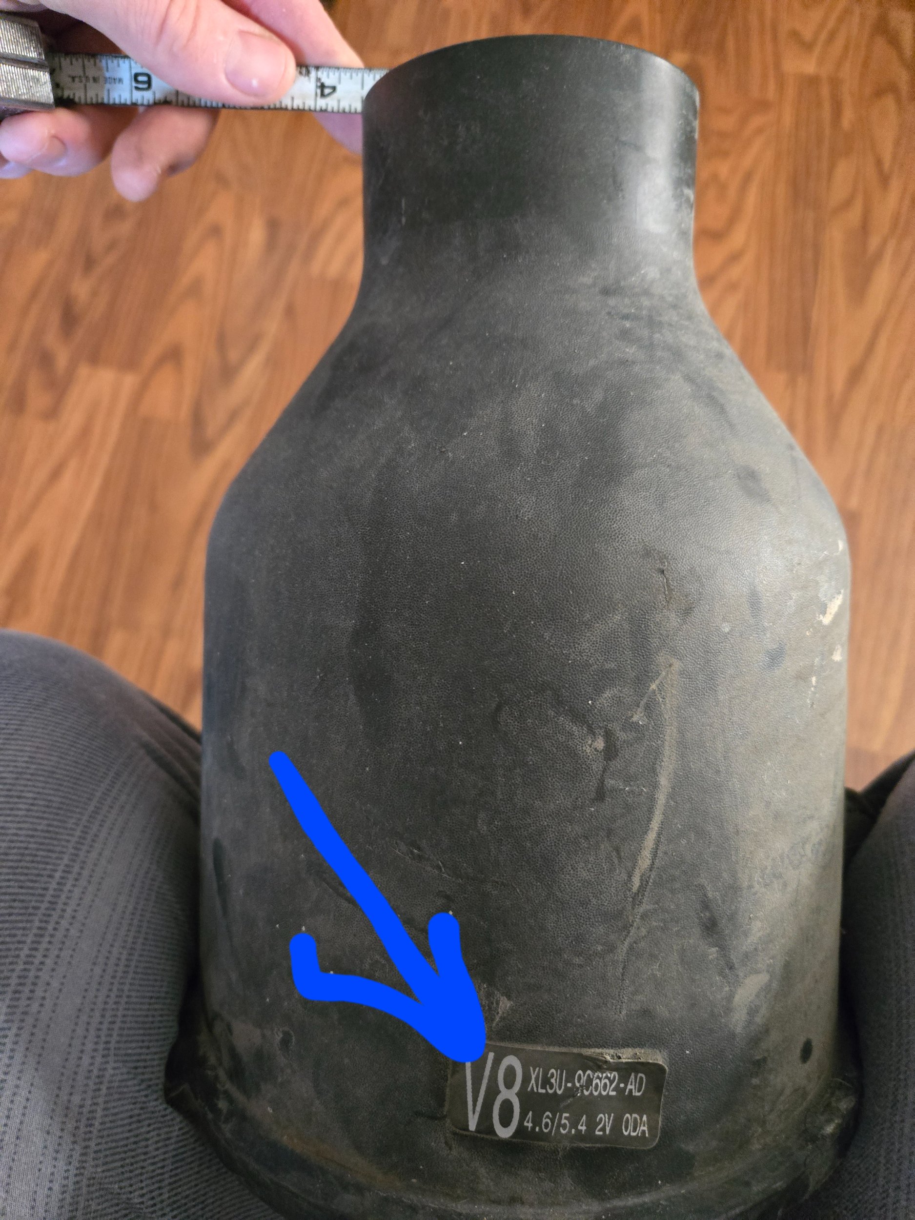

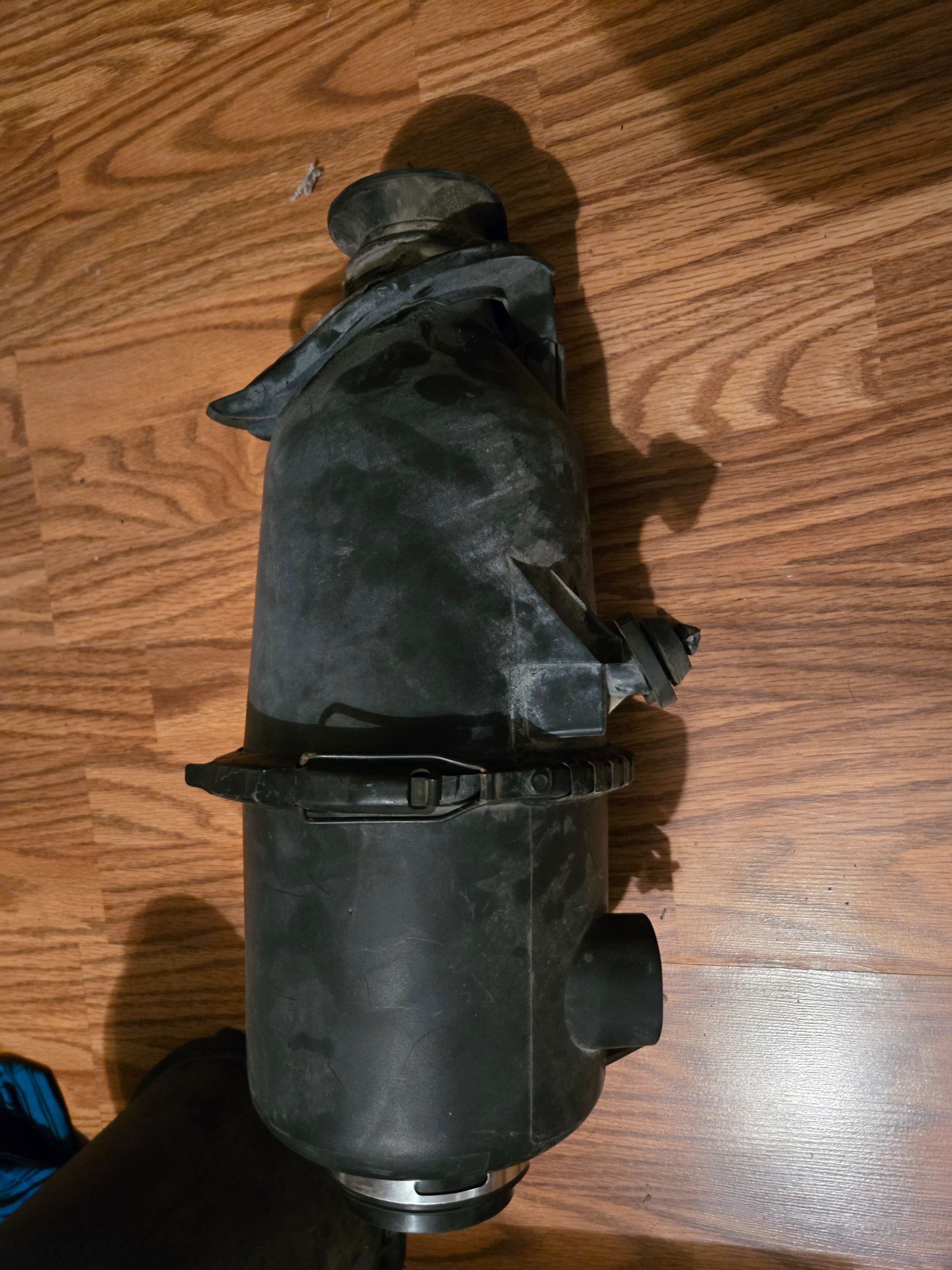

Also got a windstar style intake from a 97 ranger with a 3.0l. It uses the same filter as the windstar and is almost identical. Something different i did notice was the housing outlet is 3.5" O.D. unlike the 4" I'm seeing for other guys using the windstar. I grabbed the housing and a couple different full size ford intake halves for 40$ at a pic n pull recently. I have a ducting parts list queued on amazon.it should be a fun weekend project
Gotta give it to currie for quality. The joints in the track bar are still tight after 9 years. Some grease and it'll replace the RC bar in my jeep.
It's a great feeling every time a currie product replaces another piece of rough country junk!

The shocks will be a bit of a project. None of them are blown and seem to have uniform resistance but 2 of the shafts have nicks and rust at the end by the eyelet. Not a big deal,new shafts are 35$ each. I love how serviceable and easy to modify these shocks are.the plan is to rebuild them and convert the odd needle fill on the reservoirs to schrader valves.
Once that and any other advisable upgrades are done I'll get both ends of my jeep weighed and have them tuned.
Reactions: ChadH and FarFire70
To integrate the 10" front and 9.6" rear fox shocks into my build, I plan on leaving my bumps where they are and raising the upper mounts as needed to match where the current worn out rancho 5000x's compression limits are.less than 2" in both cases.
at my 2.5" front lift, the 239 ranchos 9" travel is close to being centered at ride height. My plan is to bump the lift to 3" with different springs so the 10" travel shock is also near its center of travel.
My rear 241 5000x's have an uptravel bias at the current 1.75" lift. 4.75" uptravel out of their 8" total. The fox will add 1.6 to that and get a similar height bump to the front with spacers.
more flex,height,and tuned,rebuildable shocks here we come!
The low-power 3.5” inlet version was designed for the LS…
The part with the 3.5" inlet is definitely for a low power motor😉
