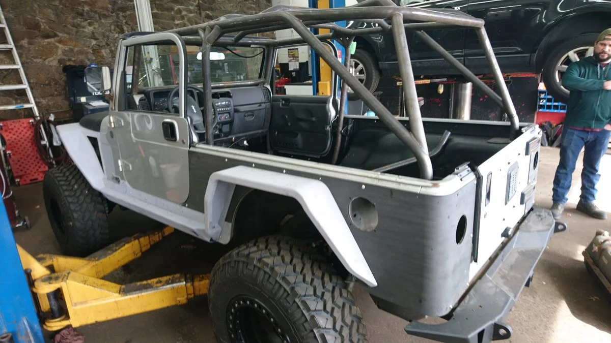

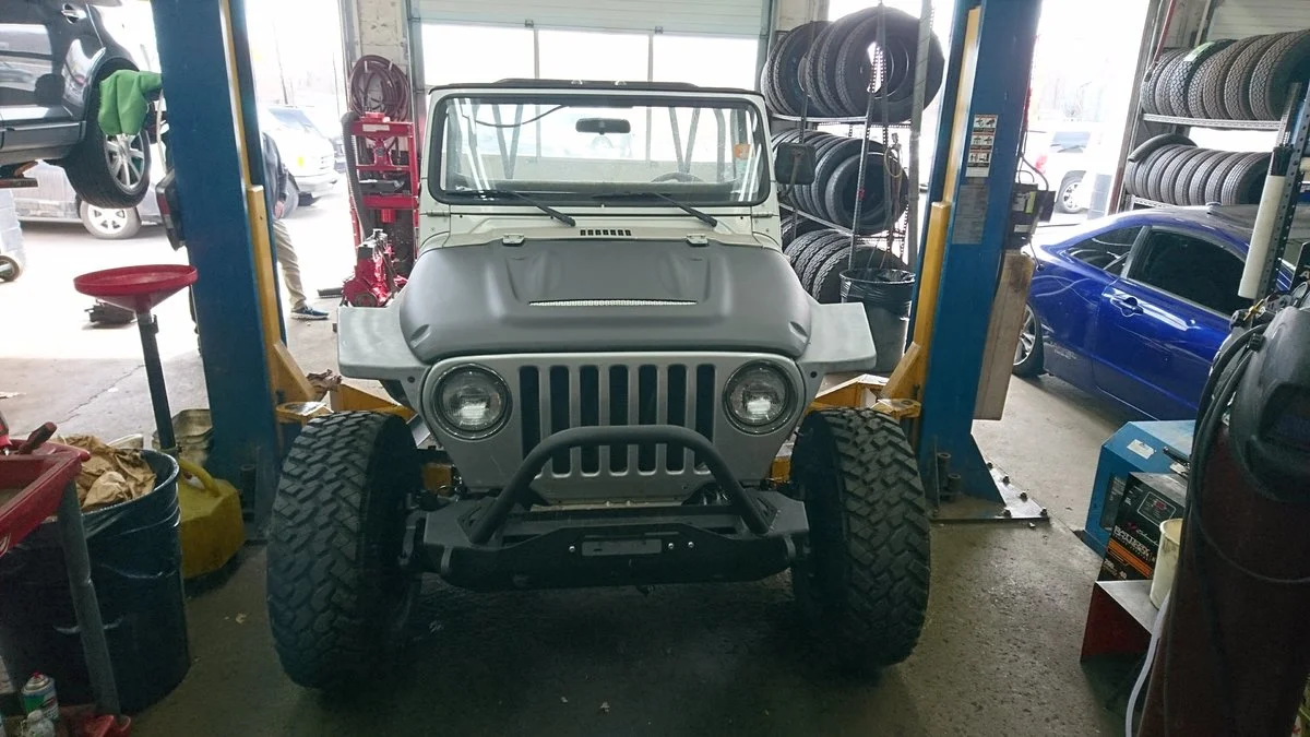

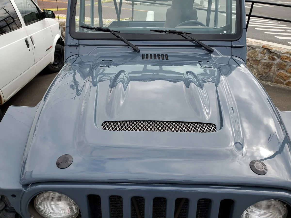

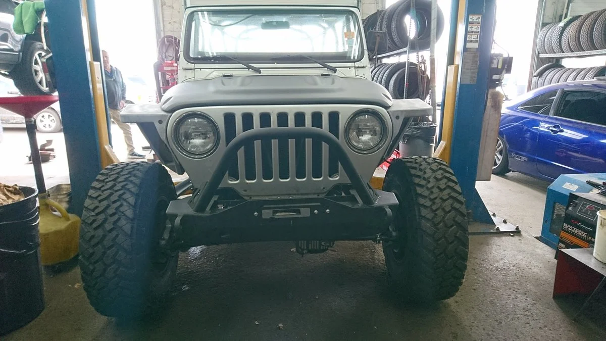

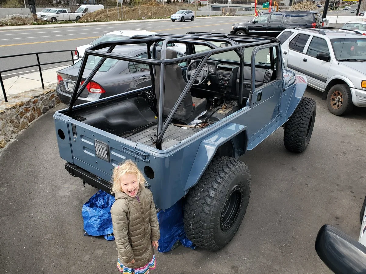

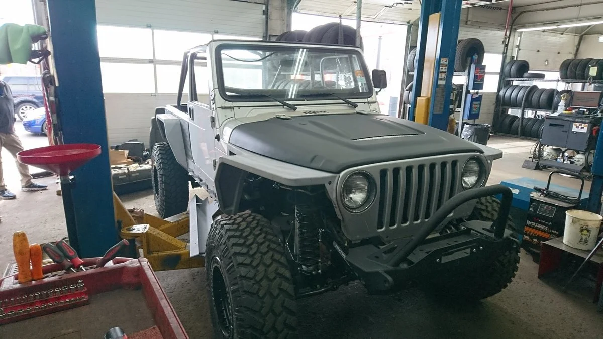

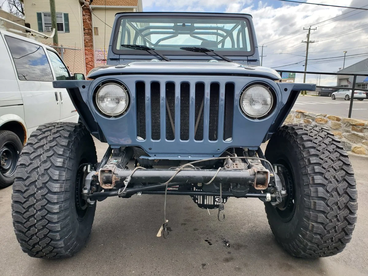

Got the Poison Spyder cage in and we're test fitting the hood today. The Duraflex high-line hood is not a perfect fit but its better than monkeying around with cutting the factory hood.
Also got the shoes put back on. So much clearance! I'm kicking myself for not going with 37's.

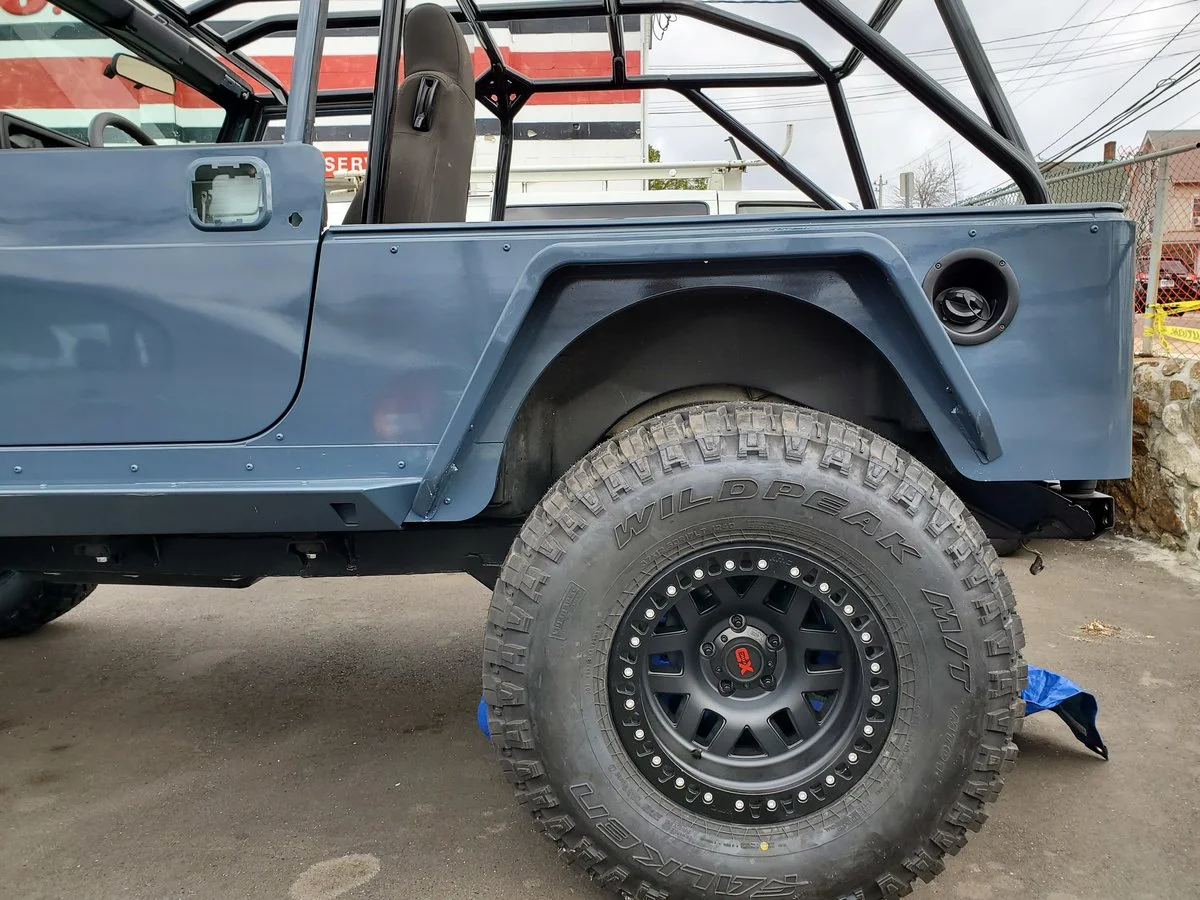

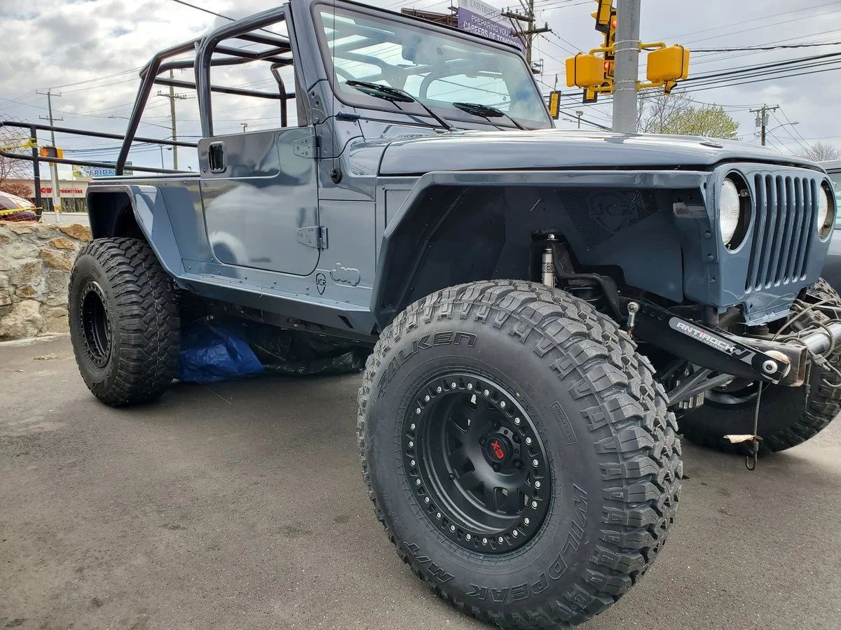

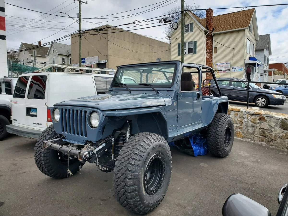

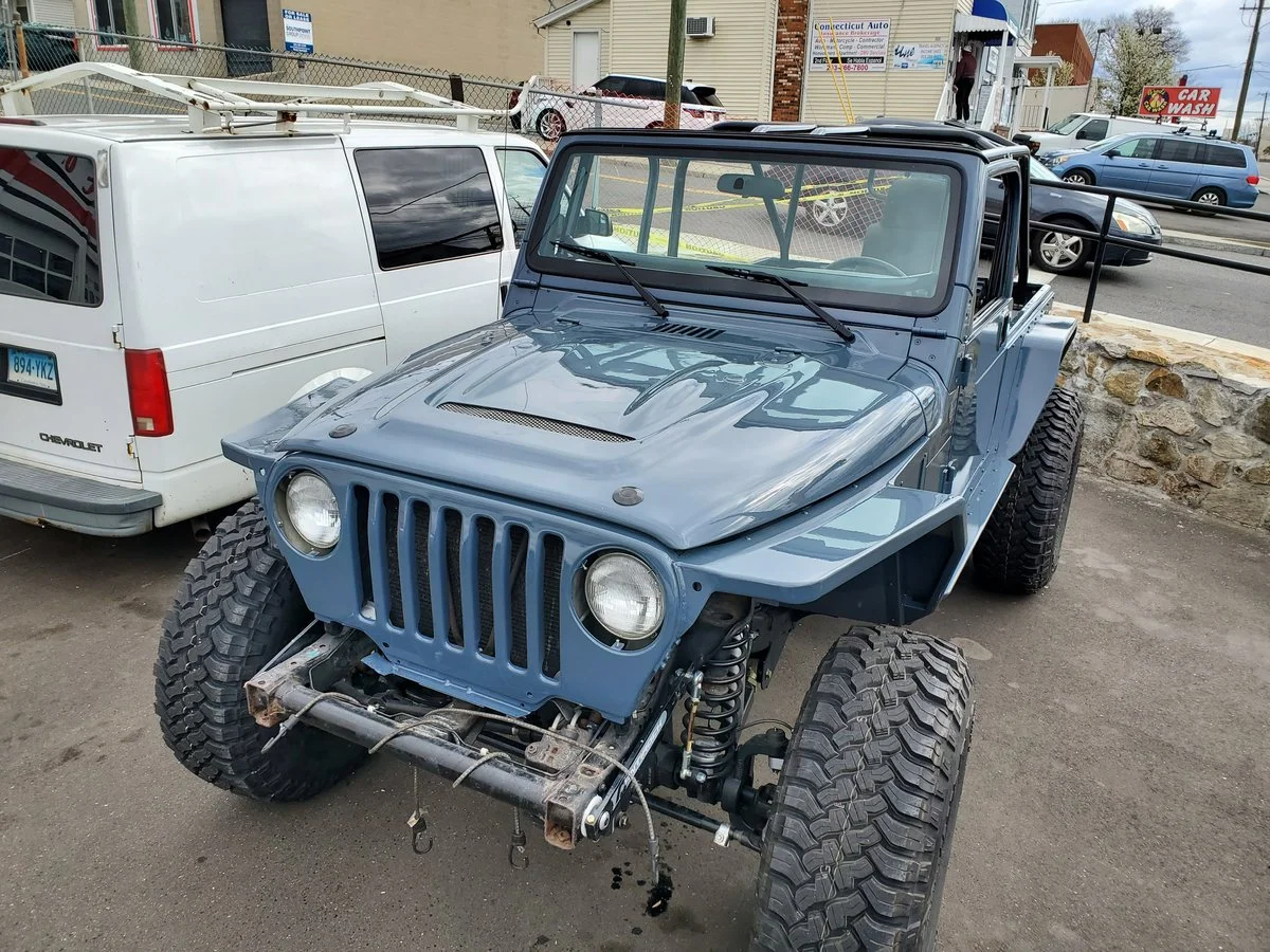

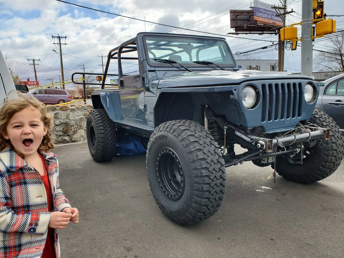

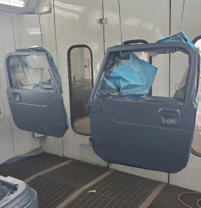

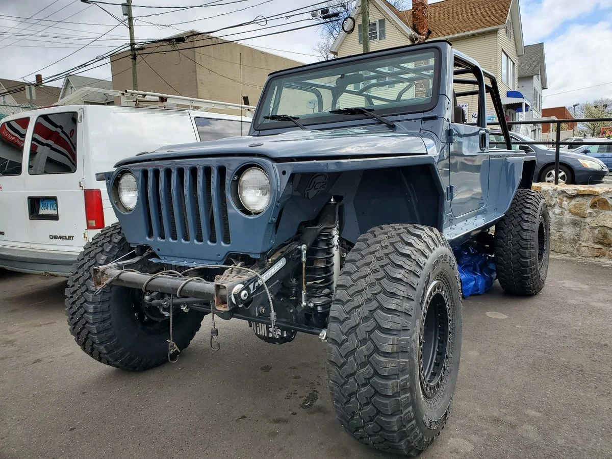

We are officially mobile! Got the Adam's Drive Shafts in and finished the 160 amp Durango alternator conversion today. Off to paint tomorrow. Just look at all that clearance under the belly! Went from 8.5" (stock) to about 19" thanks to a tummy tuck and bigger tires. Can't wait to get this guy on the trail.
Are you going to trim the excess metal from under the rear fender? I know JCR did that on their red LJ build.
Without having the lj with me at home, I can't say for sure. Have you done it before? Is it an easy or hard mod? Do you end up removing any spot welds?
