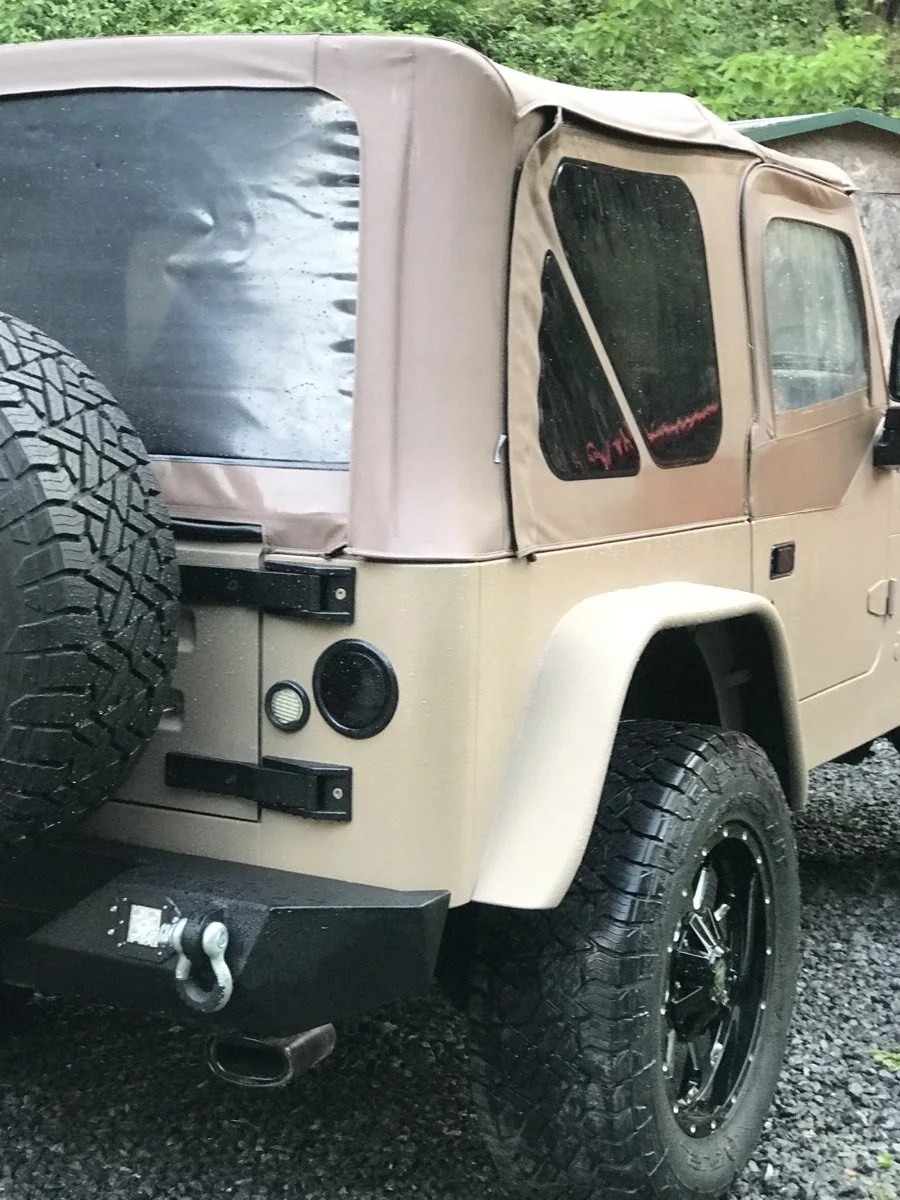

-3 gallons of tintable raptor liner ordered (painting entire exterior gold raptor liner)
-Bushwacker flat flares ordered

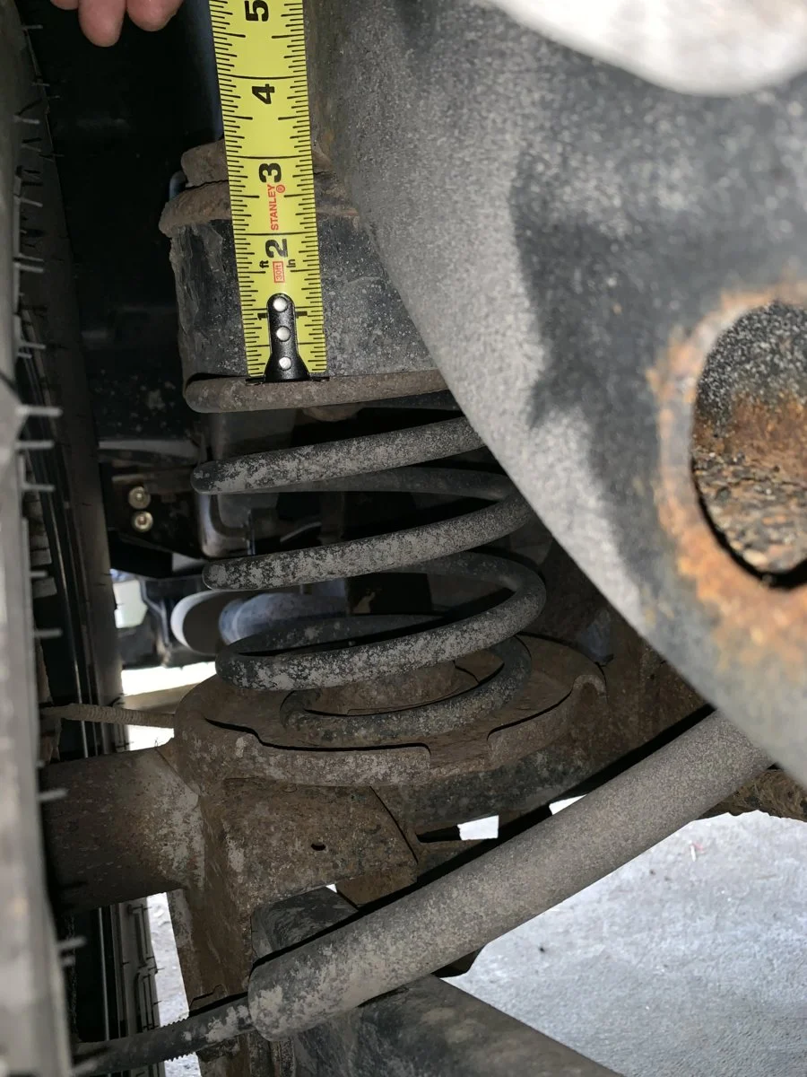

Ran out and did some quick measurements on the suspension today and my suspicions were correct. The 20 year old factory springs are really struggling to hold the weight I’ve been throwing at them. Even with a 3”bb in the front and 2.5” bb in the rear it’s sitting almost at factory height again (correct me if I’m wrong but the front should be 12” loaded and rear should be 8” loaded.) the front measured at 10” with a 3” puck and the rear measured at 6” with a 2” puck.
As soon as the paint arrives and it comes out of the shop I’ll be swapping the puck lift for springs and body lift.

Unfortunately the raptorliner won’t be done by me. I have a friend that owns a paint shop and had done several raptor liner jobs. He offered to do it for me (along with repair all the little dents and dings that it’s aquired over the years for $300 and I couldn’t turn down that price. If you have any questions feel free to ask though. I’m sure I could relay the message

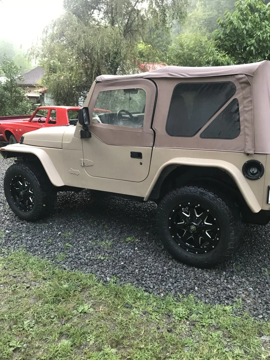

Looks great. I actually like the slight contrast between the tub and the top. Is the interior painted as well?
No. I’m opting to keep the interior carpeted. I had a yj that I had bed lined the interior on and wasn’t a fan of how loud it made the cab (that carpet adds a lot of sound Deadening and temperature control) I also plan on adding a layer of sound deadener under the carpet later.
