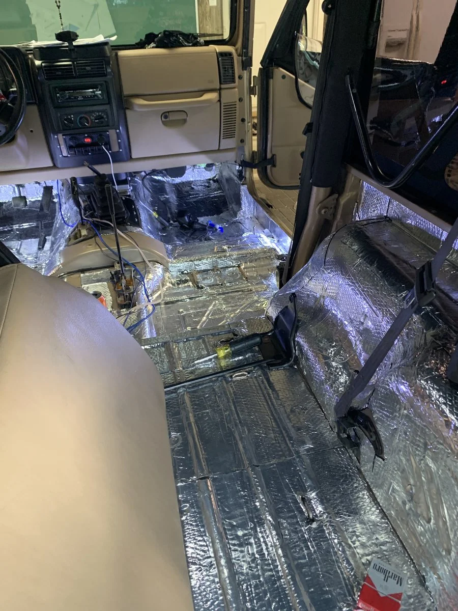

60sq ft of sound Deadening. Doing the entire tub and possibly half doors if I have enough. Ordered noico based on another thread on the forum. Started soaking the front seat bolts in pb blast today and will add a little daily.

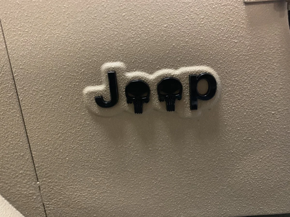

And these just for fun because the stamped Jeep spot was driving me crazy

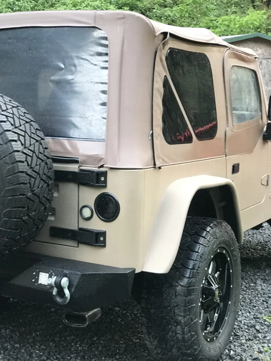

Tip for all you Jeepers with wives. Take them riding. Let them take pictures with the Jeep and boom one day when you get home from work they’ll have a new lift ordered for you.
I got home yesterday evening and she had the zone 4.25 lift and jks front track bar that I had in my amazon cart ordered for me.
Began sound Deadening this morning. Pulled everything out and so far got about 3/4 of the back done. Word from the wise... this is a lot of work so hopefully it makes a big enough difference to make it worth it.

Looks good, I like the raptoliner. I would lose the angry bird grill cover, IMHO they look ridiculous, but to each his own. My inner boot cover was shot also and it is incredible the difference that thing makes!!!! Are there any concerns with moisture absorption into the sound deadening material? That is my concern, I want to do some on mine for heat control......
There’s actually a write up on the forum somewhere. Noico is pretty good for water and doesn’t absorb or get ruined by water

Deadening in and emblems on. Had the old carpets soaking in due the past 3 days. Just washed them off, shampooed and now hitting them with doplicolor fabric and vinyl to get them perfect

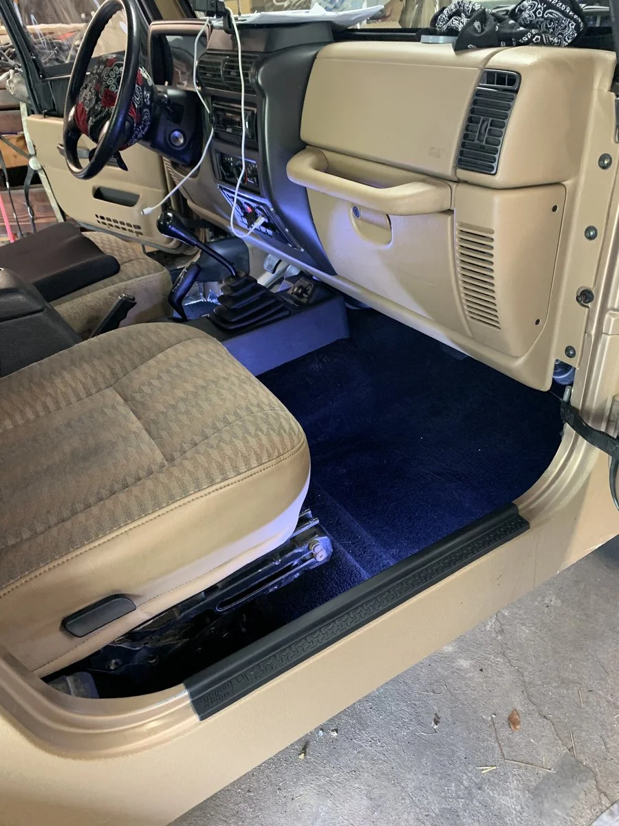

Carpet and entry guards installed. No bleeding or rub off. I was scared it would be stiff but took a medium bristle brush to it after each coat of duplicolor. We’ll see how it holds up. If it doesn’t then it’s an excuse to get some Essex carpet 👍🏾
Looks great. What's the verdict on the sound deadening? Was it worth it?
Definitely a huge difference especially for someone with full doors and a hard top. I can’t hear any engine noise through the firewall nor rear tire hum out of the back wheel wells. I didn’t have enough to do the half doors and will probably order more for that just because it really is enjoyable to actually be able to talk to my fiancé at 65 or 70 without yelling like I had to before this and the sailcloth top
