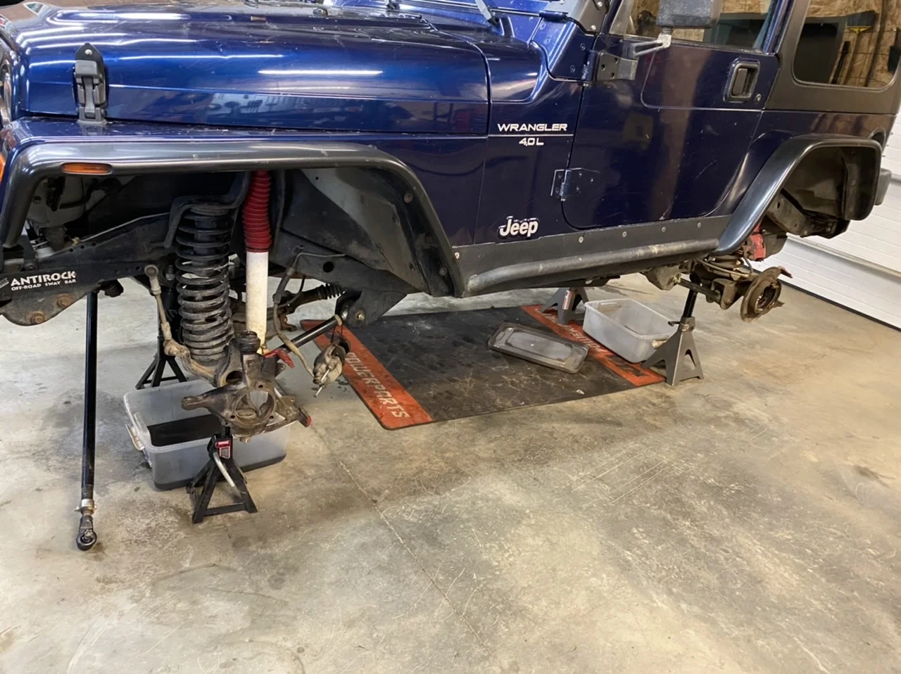

So I have a question I was not sure about from your original post did you leave the antirock sway bar kit on the front and if so how did you feel about the loss of stiffness on road
Reactions: 01TJ-Blues
I can tell you from having gone to a stock sway bar to an Antirock, it's not that big of a difference on-road. There's a bit more body roll, but it's nothing crazy.
My front links broke and it will cost me 1/4 of the price of going to an antirock setup so I am thinking of just going for it but some people say it's the best upgrade they have done and others warn of on road stability I don't off road much yet but plan on doing some upgrades to be able to do so in the next year so this would be my first upgrade choice
Search around the forum. You'll find 9 out of 10 people love the Antirock and will say it's one of the best things they have done (including myself). You'll find 1 out of every 10 says they couldn't handle the increased body roll. I think those numbers speak volumes :)
I have been looking on here and on some facebook groups trying to do my research just wanted to hear from someone that has one to confirm that is the right choice I have also been told to look at the terrafelx set up as well but haven't seen as much about it as the antirock
I've gone from the stock sway bar and disconnects on BOTH of my TJs to the Antirock, and would do it all over again in a heartbeat. No regrets whatsoever.

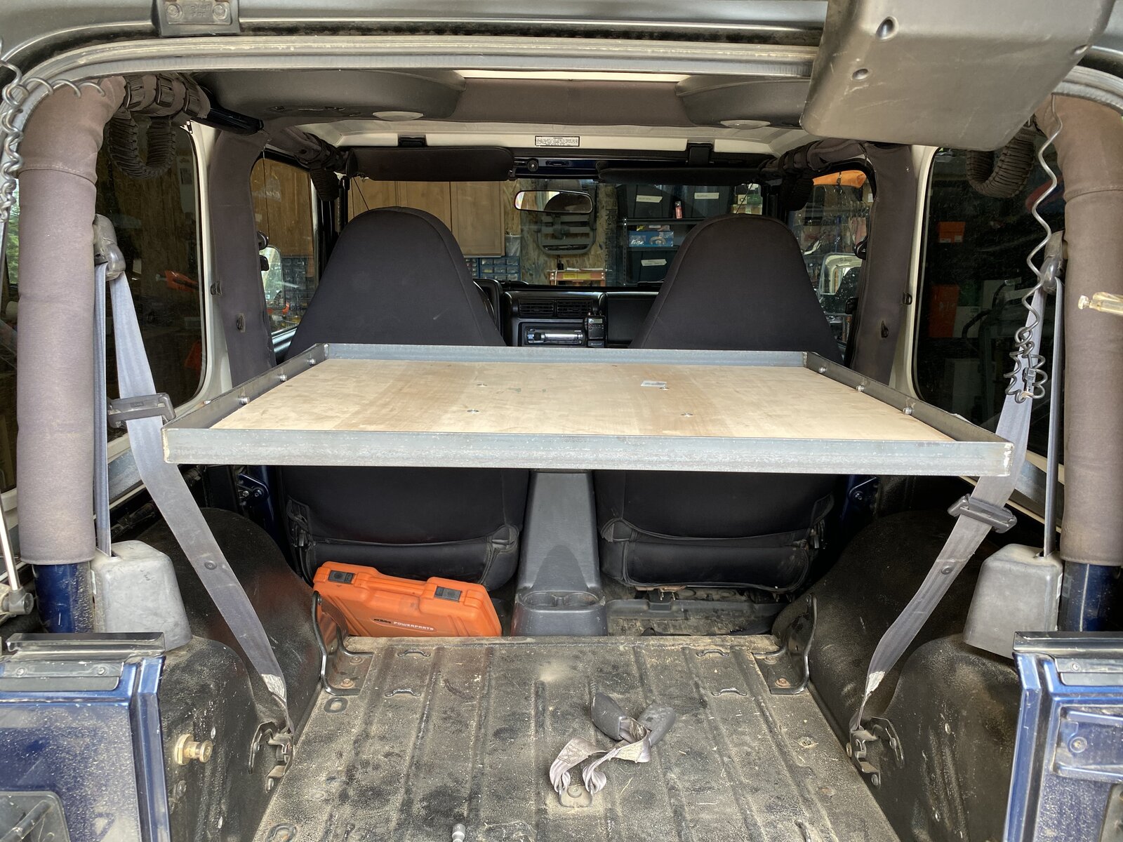

Built a heavily plagiarized idea of a rack for the cargo area. Thanks Fabtech.

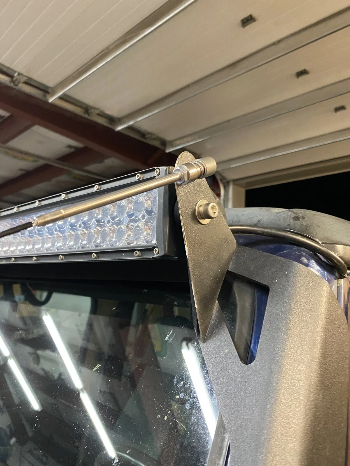

Built some limb risers, simple brackets and modified Yamaha watercraft steering cables for the actual lifters.
Sorry for the delay on this one. Didn’t even notice and must have missed the notification. The AntiRock can be adjusted if you want it stuffer or softer so that’s super nice. Mine is on the soft side but I’m fine with it and it doesn’t bother me at higher speeds.

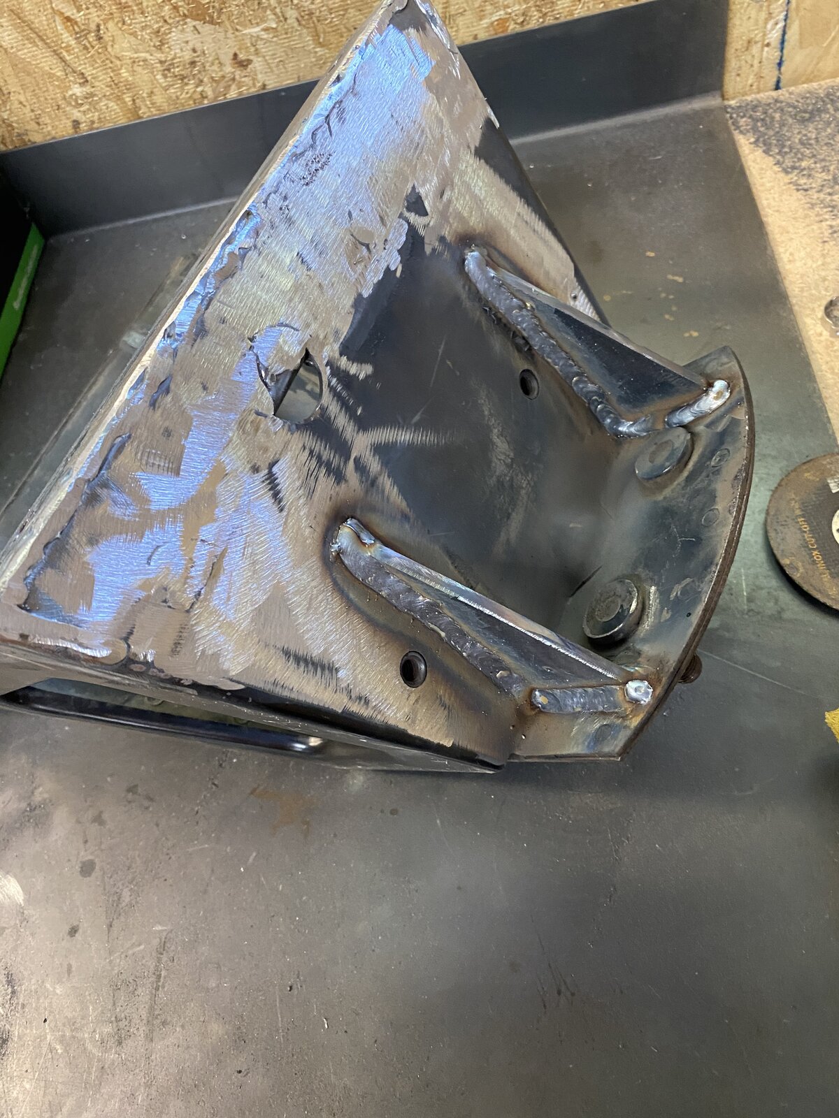

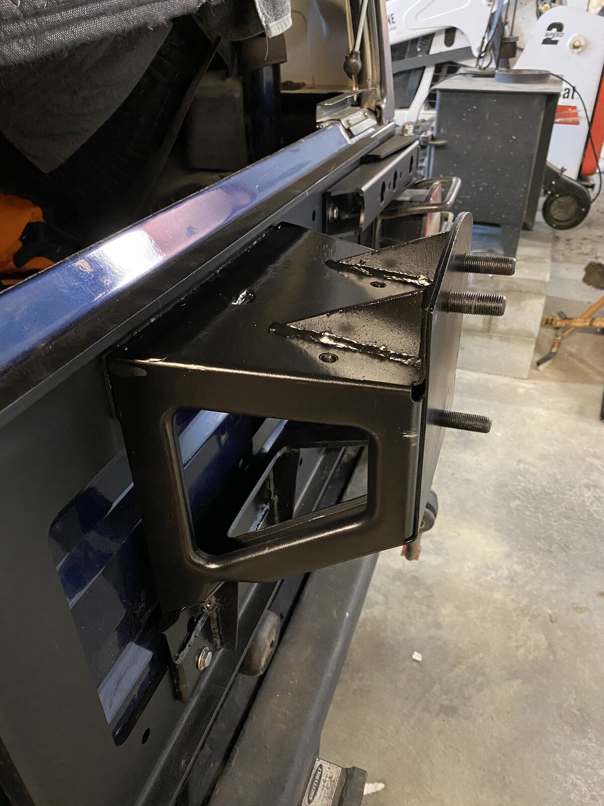

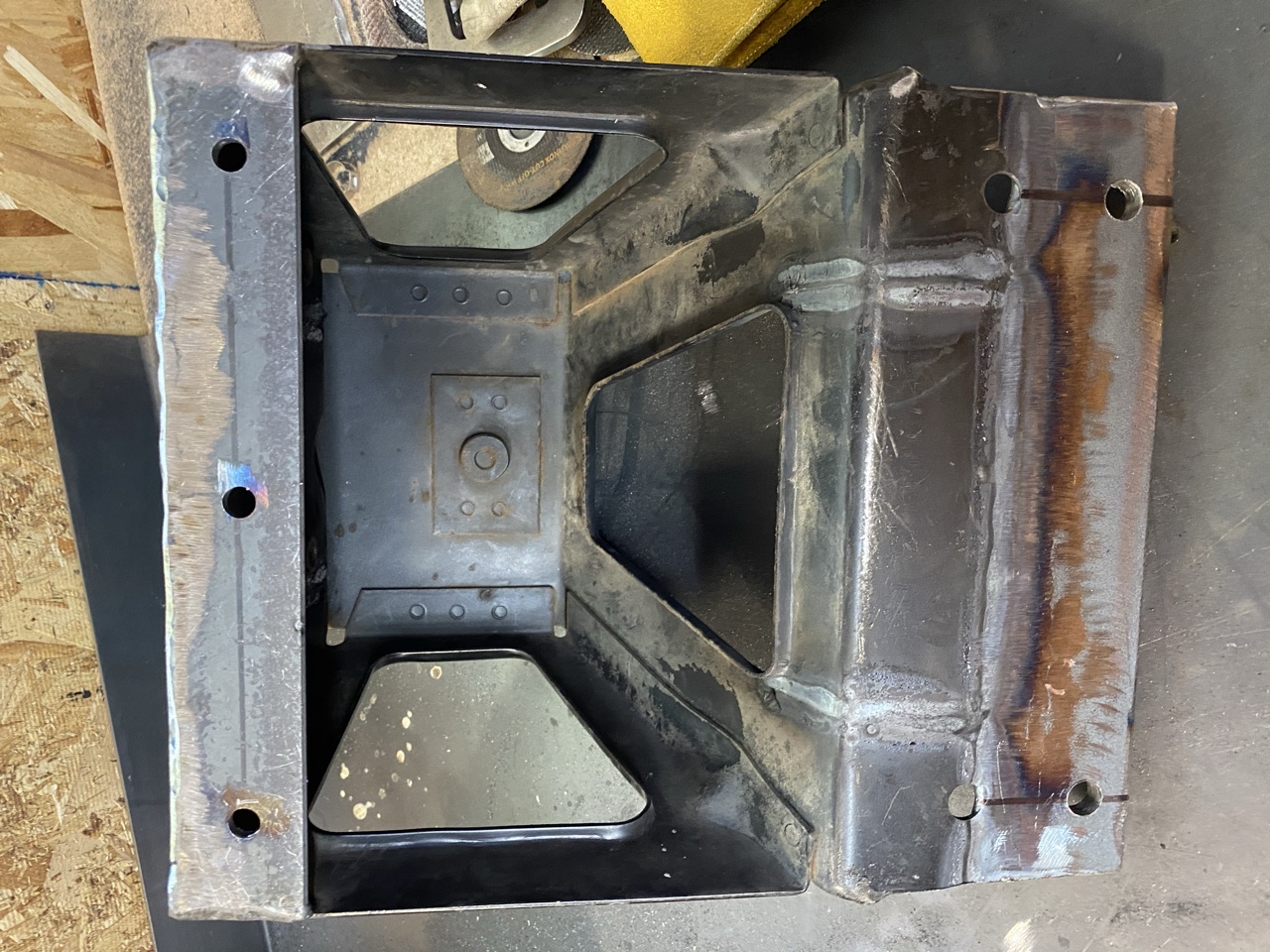

Decided to test the Morryde after being severely annoyed at the constant clunking of my modified Smittybilt bumper-swing out tore carrier. Just pulled the swing out portion off with my fancy rack and installed the Morryde. WAY BETTER. Super nice to open the back gate without fighting the swing out and it’s quiet. Now to replace the rear bumper or cut off the post and latch parr’s from the Smittybilt. Took some notes from @jjvw and his mods to the stock tire carrier, scored one from @Wildman for my install (much appreciated) and modded it. Keeping the spare as close to the body as possible and then was able to use minimal spacers for the spares bump stops. Worth it. Next, I’m going to build a quick release lightweight rack system for it so I can carry my chainsaw, axe and shovel. Debating where to mount the Rotopax now that my original rack is gone. Here is the modified tire carrier if anyone wants to see how to do it to raise the spare if you are using a 35” or larger tire.

Decided to test the Morryde after being severely annoyed at the constant clunking of my modified Smittybilt bumper-swing out tore carrier. Just pulled the swing out portion off with my fancy rack and installed the Morryde. WAY BETTER. Super nice to open the back gate without fighting the swing out and it’s quiet. Now to replace the rear bumper or cut off the post and latch parr’s from the Smittybilt. Took some notes from @jjvw and his mods to the stock tire carrier, scored one from @Wildman for my install (much appreciated) and modded it. Keeping the spare as close to the body as possible and then was able to use minimal spacers for the spares bump stops. Worth it. Next, I’m going to build a quick release lightweight rack system for it so I can carry my chainsaw, axe and shovel. Debating where to mount the Rotopax now that my original rack is gone. Here is the modified tire carrier if anyone wants to see how to do it to raise the spare if you are using a 35” or larger tire. View attachment 210673
This is what I should have done when I still had my MORryde tire carrier.

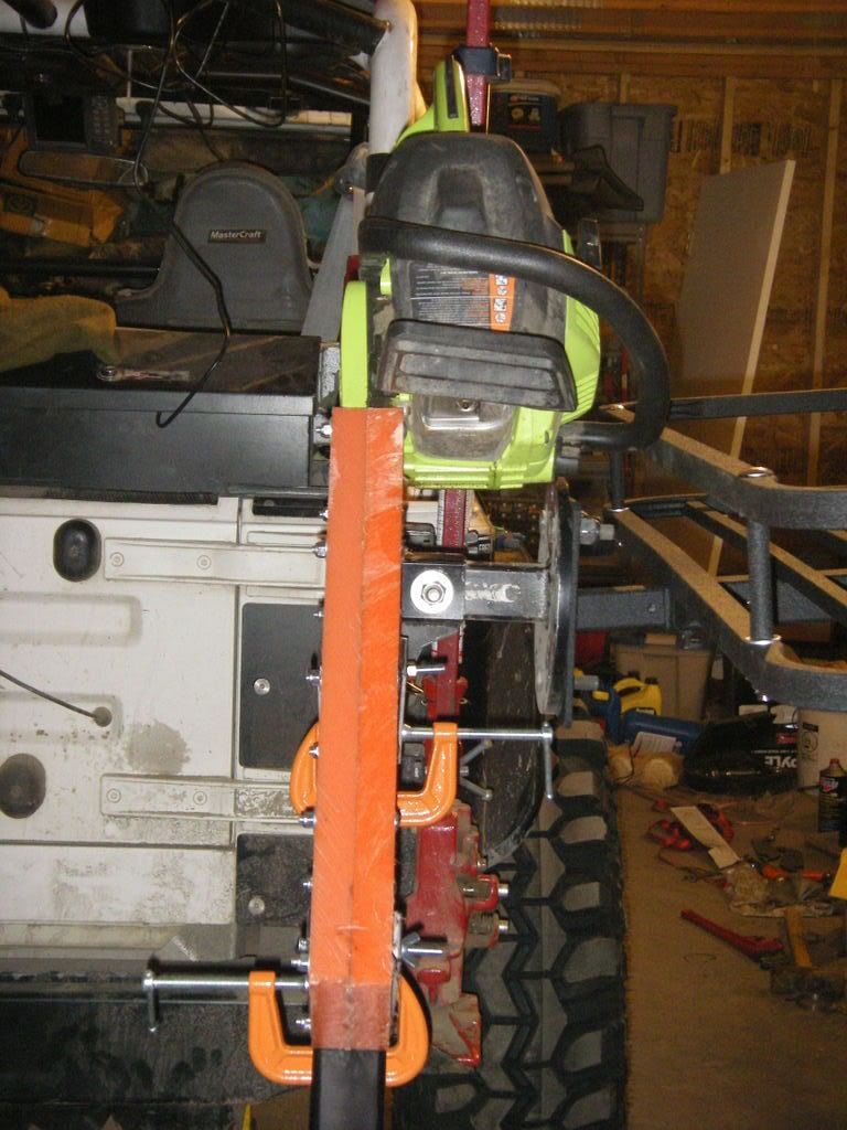

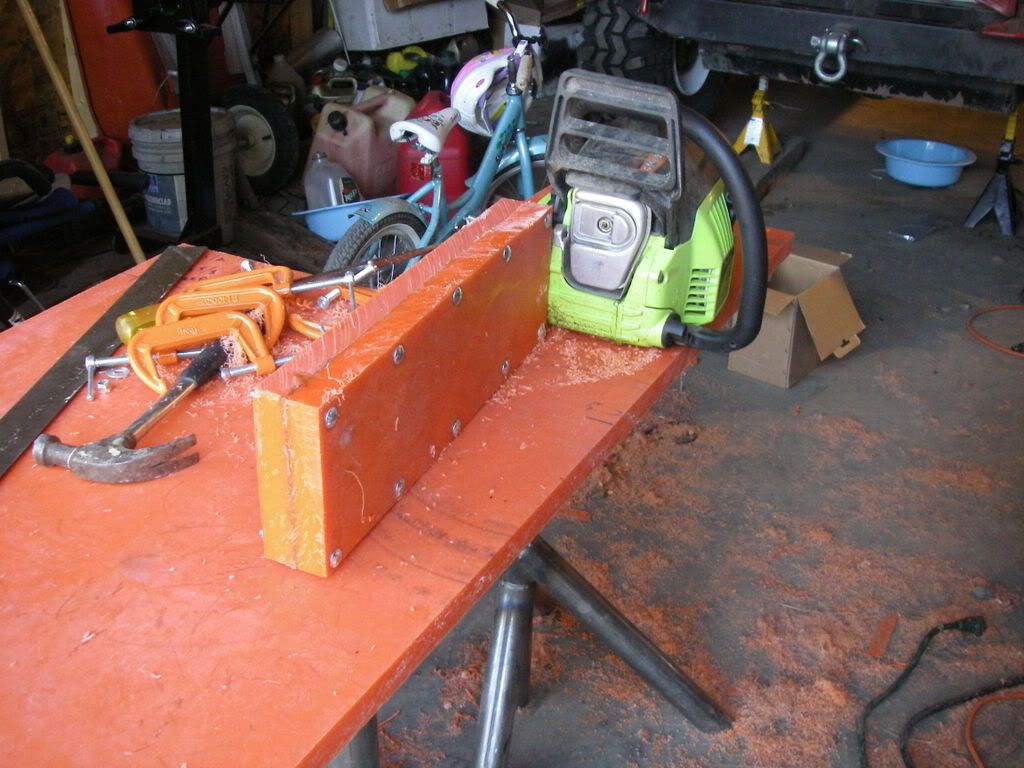

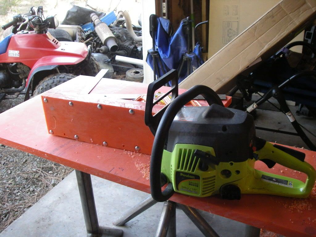

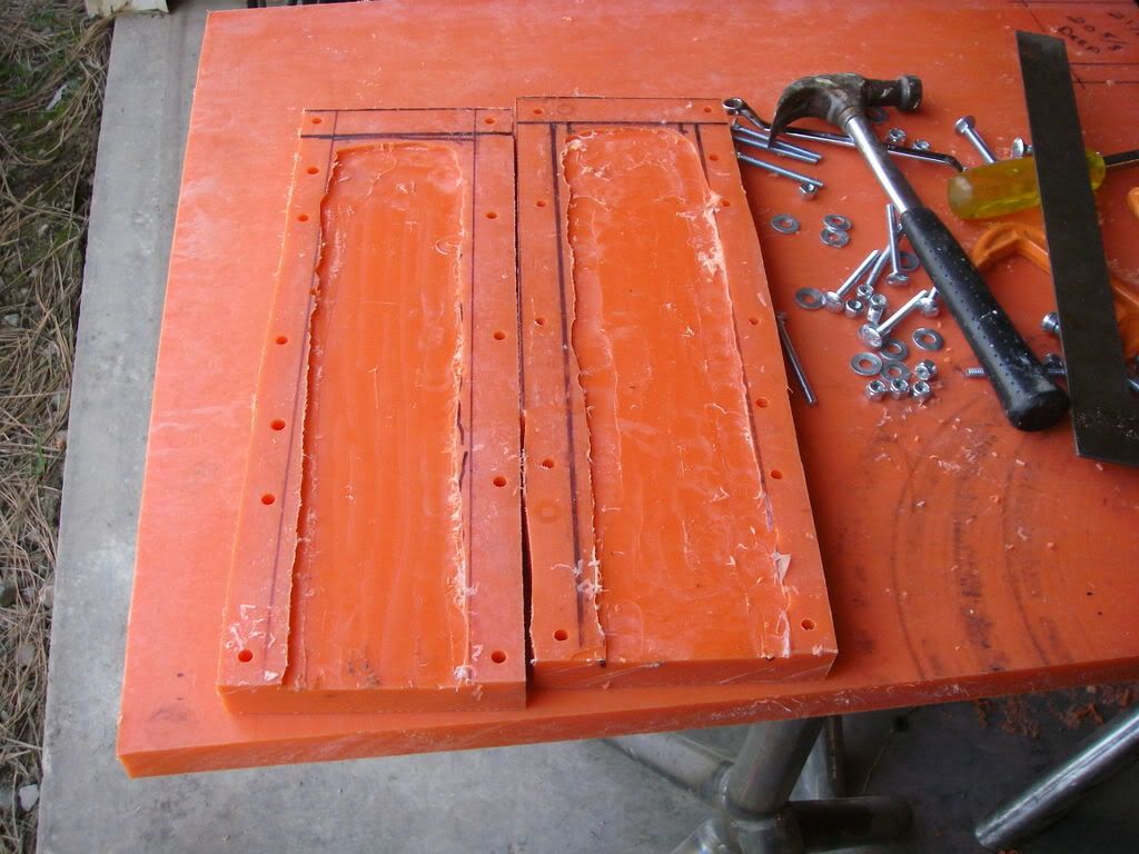

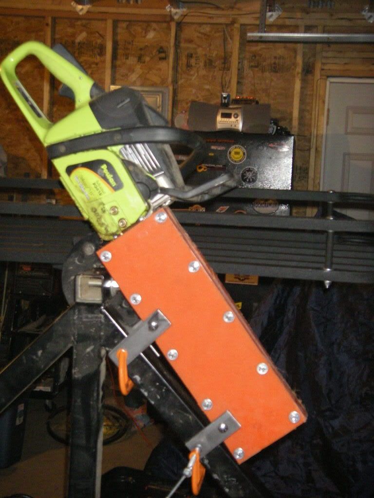

Glad I could help out and that carrier looks great. Did you see my chainsaw carrier? I'm sure there might be a way to adapt it to work for you. And here in the PNW it's pretty much a required item to carry. I got rid of my swingout tire carrier also so I've got to come up with a new system.
I'm sure there is a way to use this type of mount adapt it to a rack or some where else.
Nice! As soon as I have the prototype rack done I think you’ll dig it. It has a similar idea for the chainsaw carrier but integrated in the the quick remove rack.
