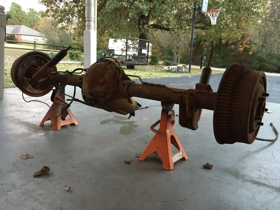

I'm left asking why the XJ Dana 44 vs the TJ Dana 44?
Availability mostly. Easier to clean up for new brackets. If I remember correctly (it's been a while) the tubes are stronger, if only slightly. Weighing in was also the fact that I can sell my matched set with Dana 44 and 3.73s.

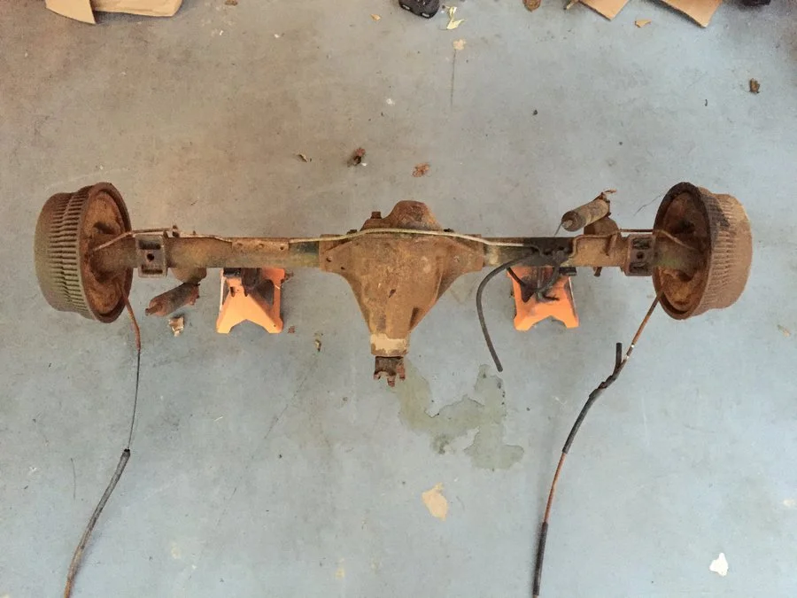

After contemplating several rear axle plans, I finally settled. My three most viable plans included;
• Keep my factory Dana 44
• Build the tried and true Ford 8.8
• Build a XJ Dana 44
I chose the XJ 44!

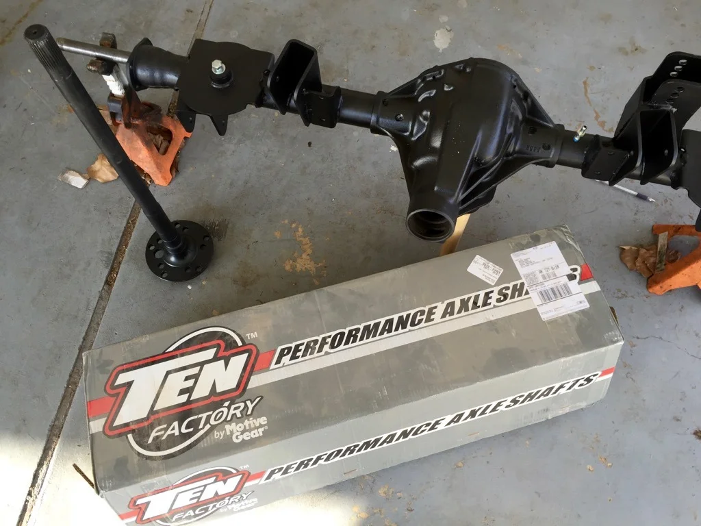

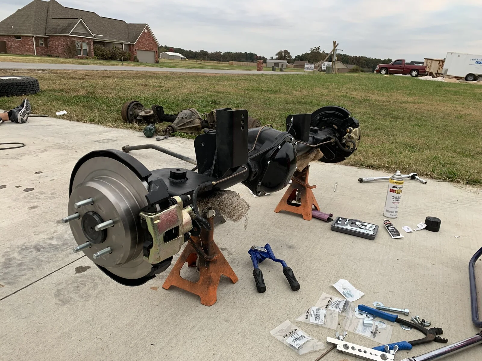

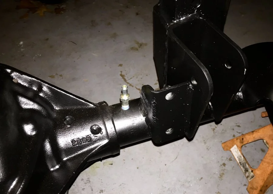

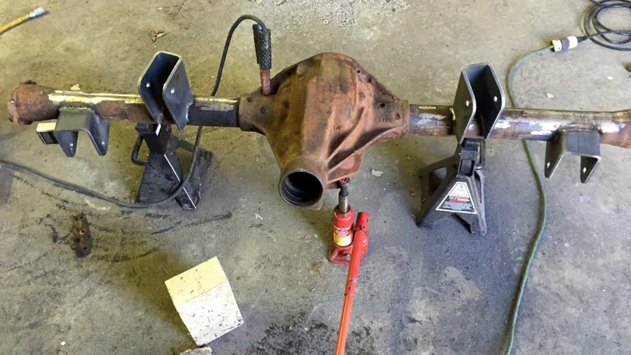

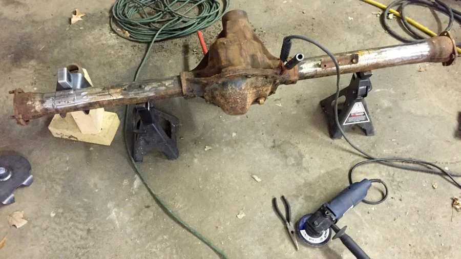

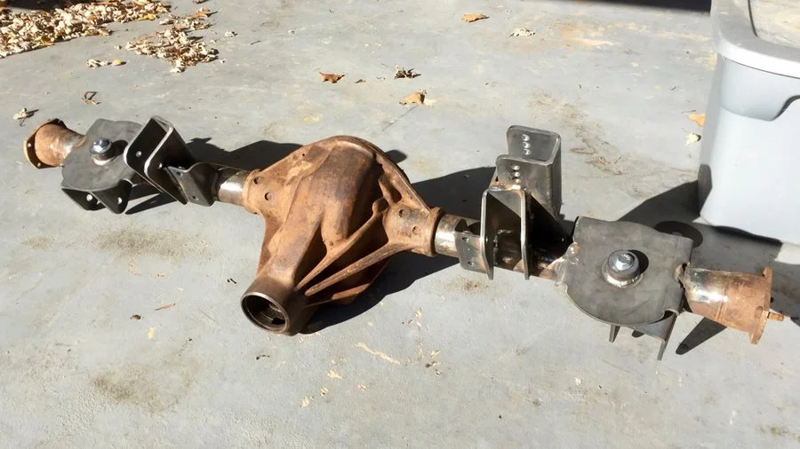

I installed my ECGS Brackets on my XJ Dana 44. The bracket kit is really beefy, but it did not include installation instructions. I was successfully able to adapt the instructions for a similar bracket kit designed for the Ford 8.8, and the installation was relatively easy. My welds aren't beautiful, but I think they will do the trick. Everything is set up for a pinion angle of 17°. I know it's not ideal, but I went ahead and stuck the shock mounts on. The mounts in the ECGS kit were nice but the mounts from my TNT Customs Rear Shock Mounts were a bit wider, so I can add misalignment spacers if my shocks are narrower. Next steps; sandblast, prime and paint.
I rattle canned my axle black and I drilled and tapped the axle for the axle vent.

On October 27 way back in 2019, I finally completed my axle swaps. Reverse cut Dana 30 up front with an XJ Dana 44 out back. Both have Eaton E-lockers and 4.88 gears. I have the OG Black Magic Big Brake Kit and Explorer rear brakes inspired by this thread... https://naxja.org/forum/showthread.php?t=967146

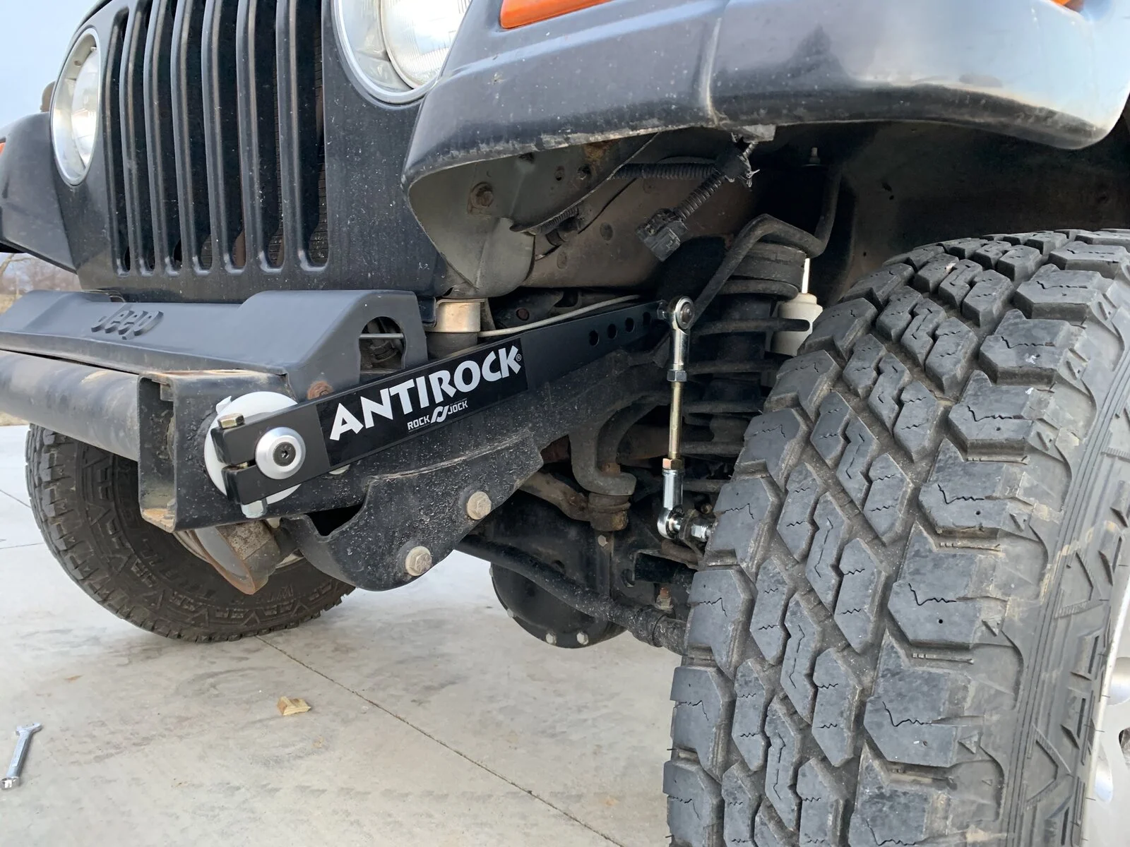

After a few years of running without a sway bar at all, in January of 2020, I installed the Antirock.

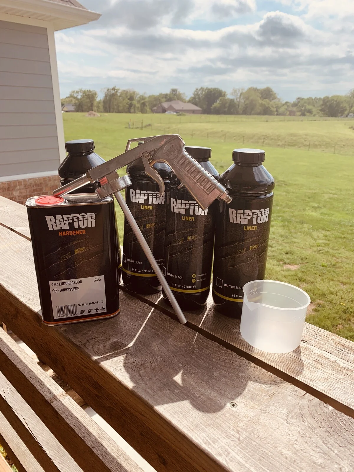

Making incremental progress, In April 2020 I invested in the U-POL Raptor Liner Kit. It was a fun and relatively easy project. It's been 3 years now, and it's holding up perfectly! I highly recommend the product, if you're up for a DIY. Unfortunately, I did not get a good picture of the finished product.

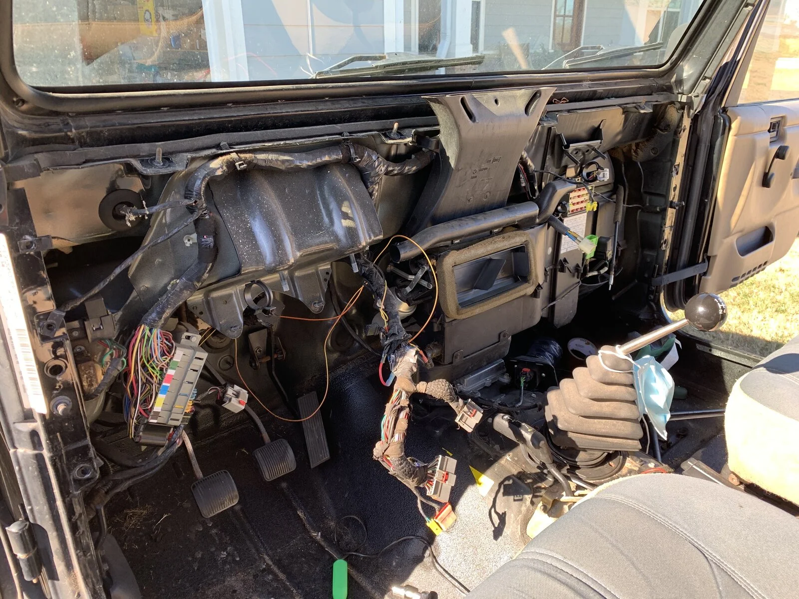

Hey folks! It’s been a minute—okay, more than a minute—since my last post. Life has a funny way of getting in the way of Jeep projects, doesn’t it? But fear not, because I’m back, and I’ve got a lot to catch you up on. Last time we left off, it was with the interior cleanup. But in February 2021, I decided it was time to make some serious investments in the ol' TJ.

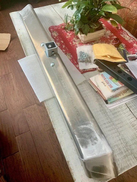

First up: the rear bumper. After much deliberation (and some not-so-gentle nudging from my better half about the Jeep’s appearance), I finally pulled the trigger on a new rear bumper. The old one just wasn't consistent with the look l was after, and it was time for an upgrade.
I opted for a Savvy aluminum bumper. This thing is built like a tank, and I couldn’t wait to get it installed. For now, here’s a sneak peek at the bumper, fresh out of the box.

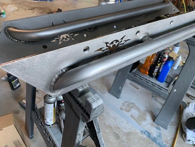

Next on the list was the rocker armor. I knew I needed something robust to protect my rocker panels. I went with a set of Poison Spyder Rocker Knockers with their sliders.
Here’s a shot of them before meeting the TJ.

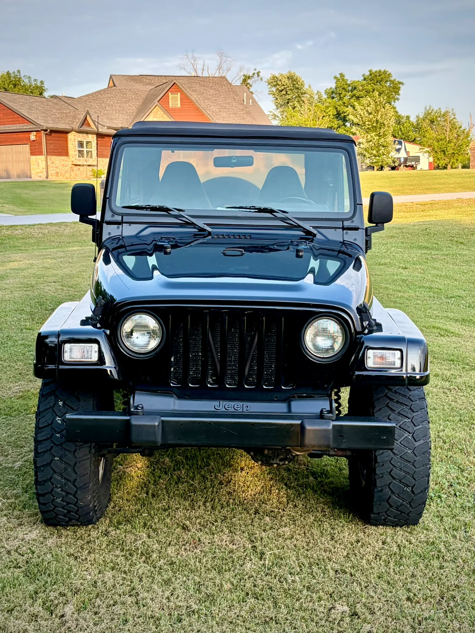

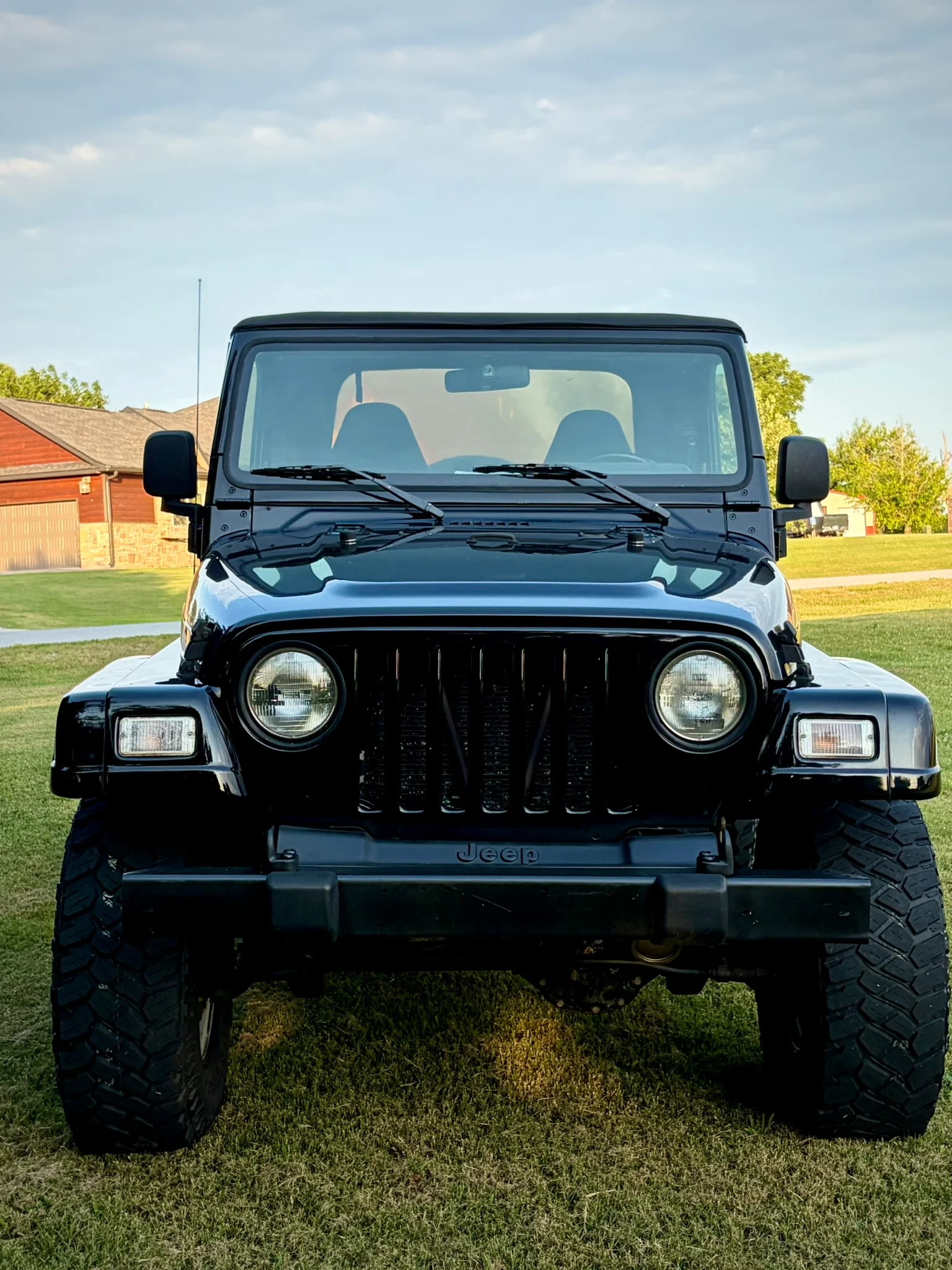

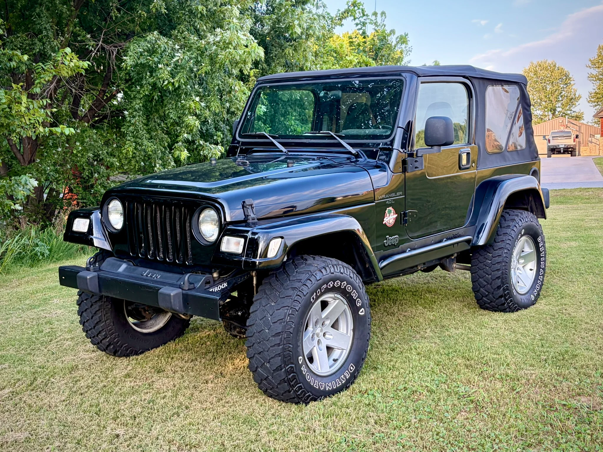

Well, as much as I struggled documenting my project, I thought I'd post one final post to my build thread. I have it currently posted on Autotrader and here on this forum. As such, I thought I'd finish with were she sits today. She's still an amazing Jeep, and I still drive her daily. Just falling out of love, I think.
