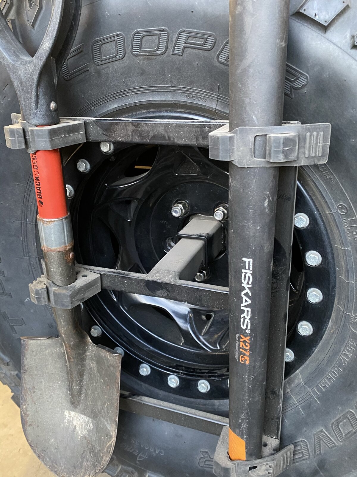

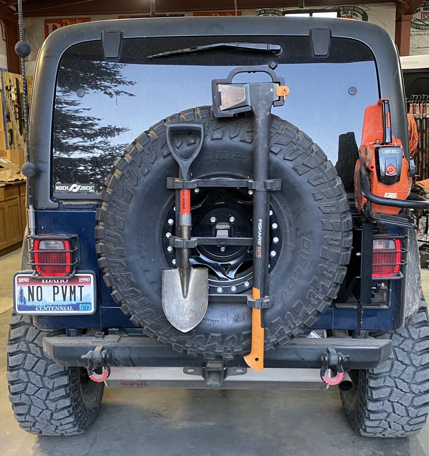

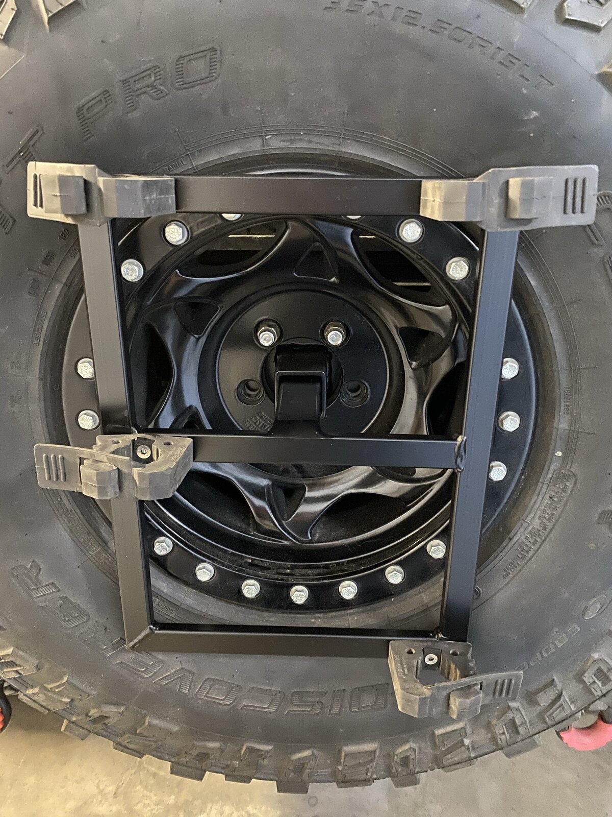

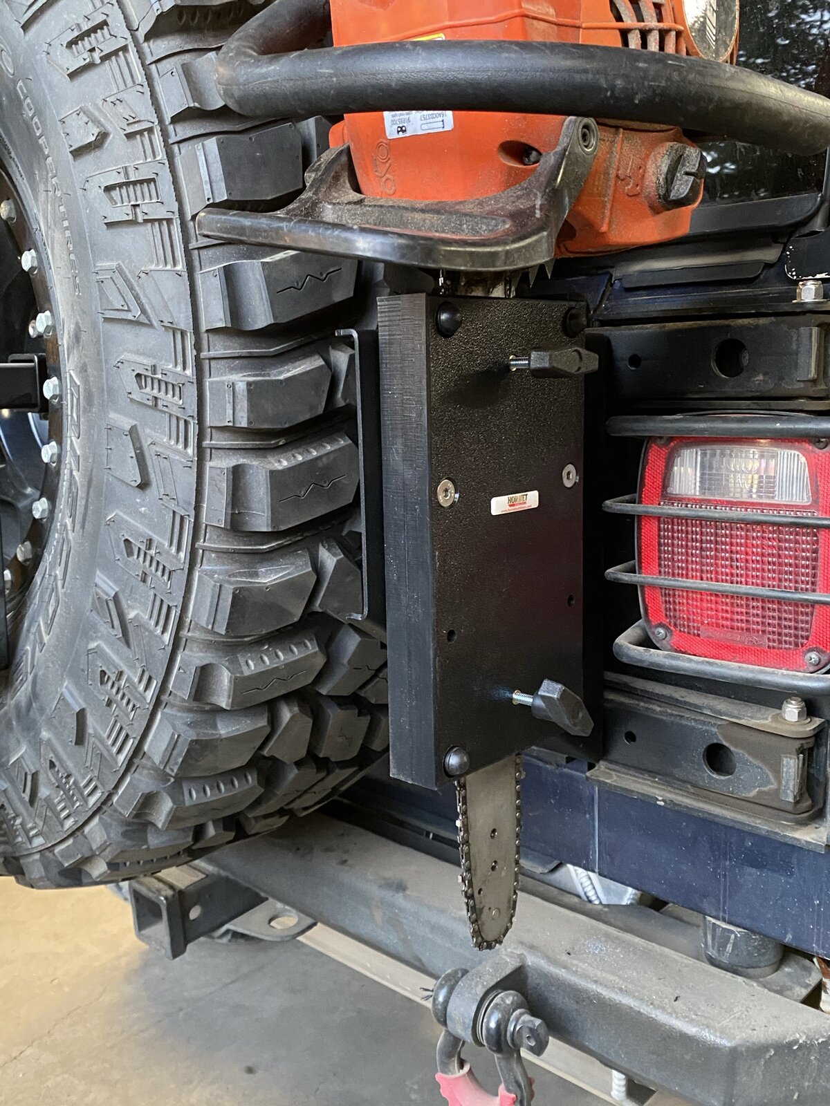

Abandoned the rack idea for now and came up with this for the shovel, axe and chainsaw. The “tool holder” has a 1/2” bolt that holds it on the receiver. Thus far it’s been really handy and easy to use.
I like this a lot. Got a link to where you got it? Or is it home built?

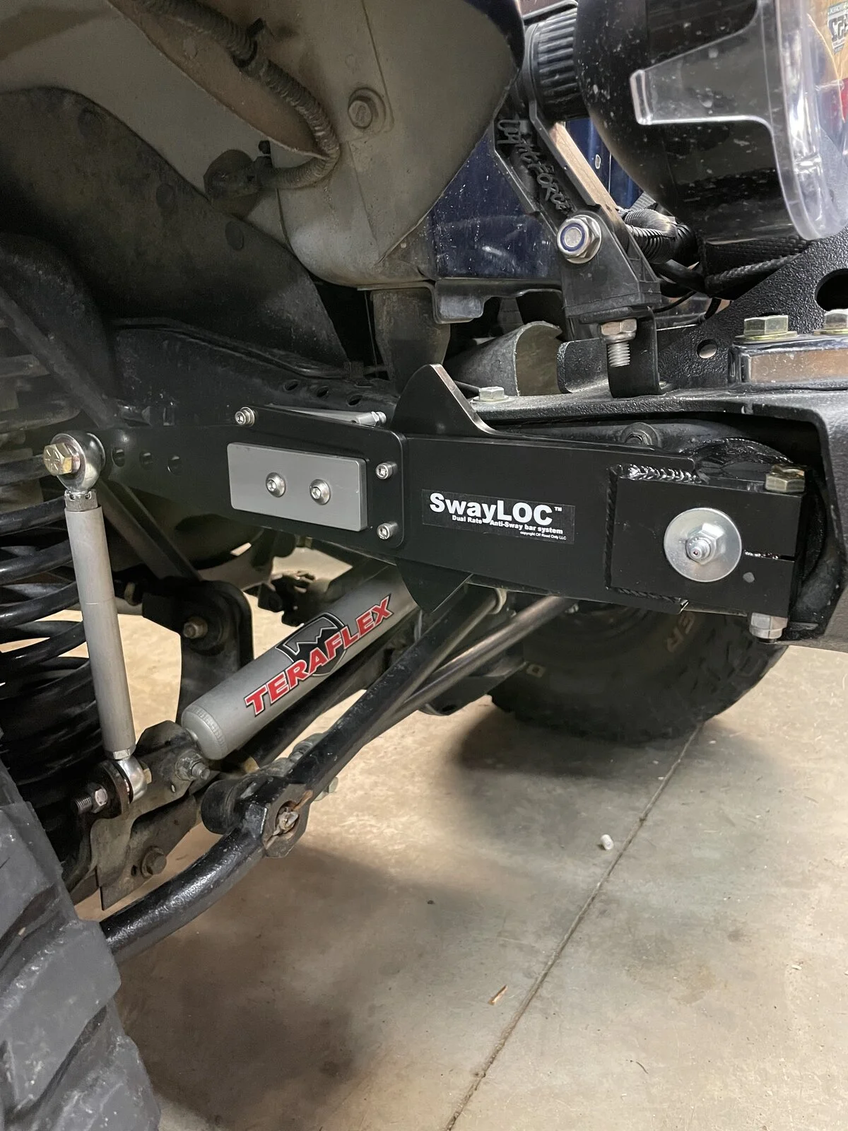

Antirock sold and SwayLOC installed…and a pain in the ass it was but it shouldn’t have been.
For anyone putting a SwayLOC on here is a tip. The bushings that go into the frame are a much softer version than the Antirock style. And when you get one side in the instructions tell you to then put the outer torsion bar/tube through and then install the other side bushing. Here is where the pain in the ass starts. The softer bushings make it hard for the torsion bar/tube to slide into it, however the softer bushings make it easier for the bushings to push OUT of the frame.
Do yourself a favor and pick up a couple of 38” furniture clamps and after you knock in bushing 1, clamp it THEN knock in bushing 2 with the outer torsion bar/tube. After that the job was simple and it’s a done deal.

Very nice, I'm looking into installing a swayloc myself. I have the anti rock, but it is honestly a bit to squirrelly on the road at times. I'll remember these tips. 🍻

Well, I’m going to echo the many others with the “I should have done this sooner” on the SwayLOC. Absolutely amazing how it transformed road driving for me, much much much more controlled. Very happy with this addition.
