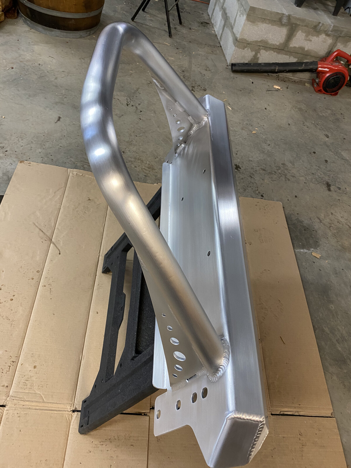

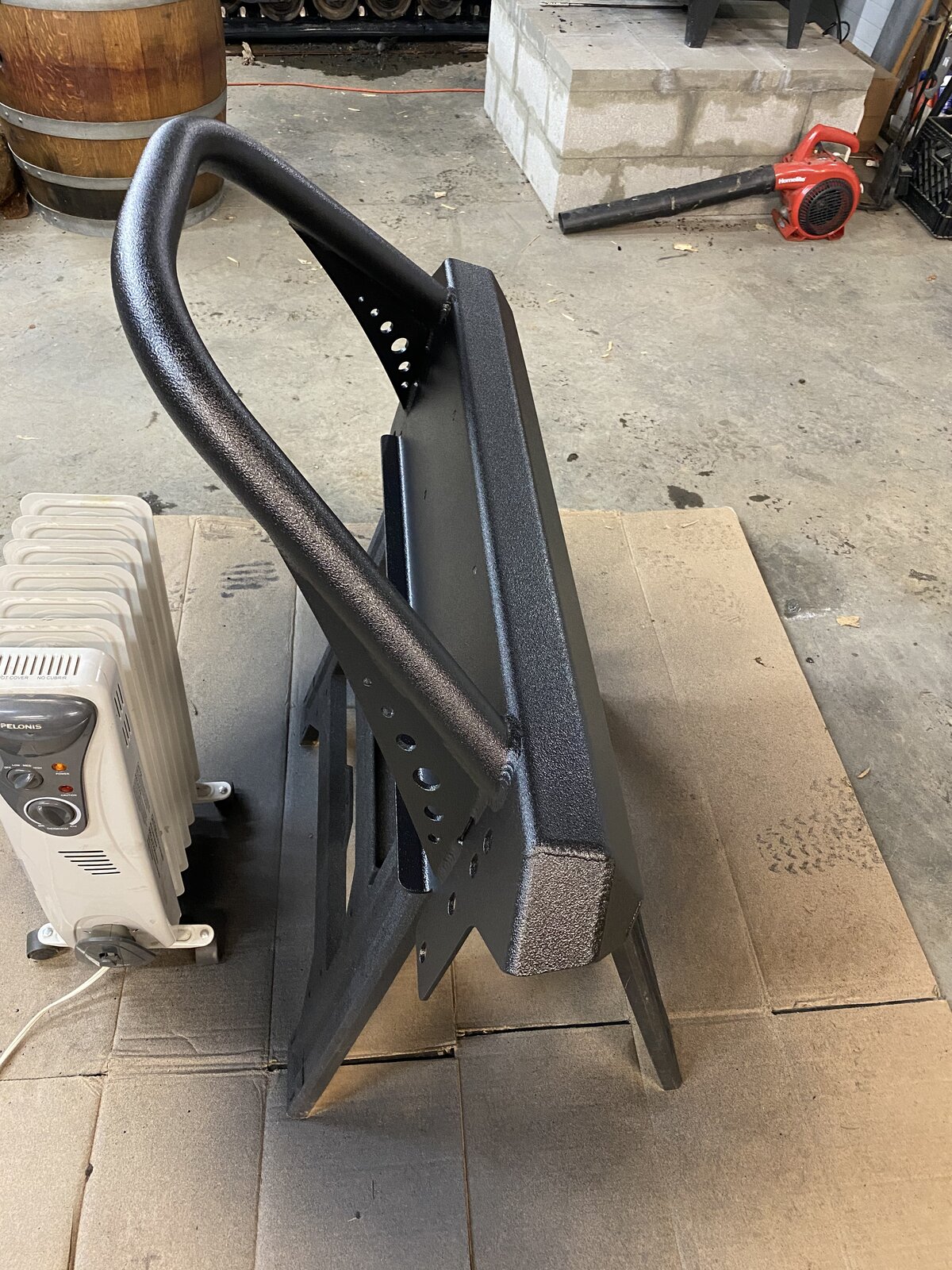

Part 1 of lightening up has arrived. Waiting for some more aluminum goodness then some upgrades.
Wow, that's a beauty! Who makes it?
GenRight. Tried for Savvy but after 6 weeks of waiting and another 2 week to “possibly” ship them I went with GenRight. They have excellent customer service and were awesome to work with. Did a little Raptor Coat action and she’s ready to install now.

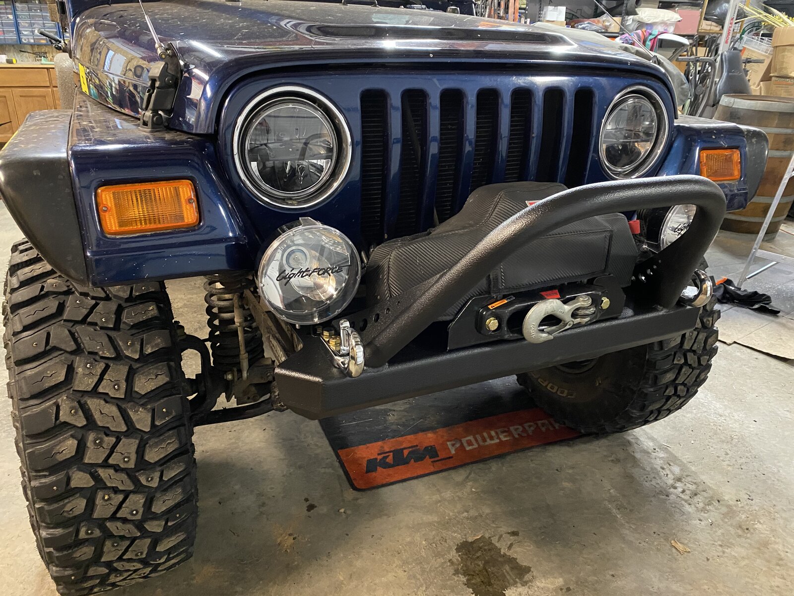

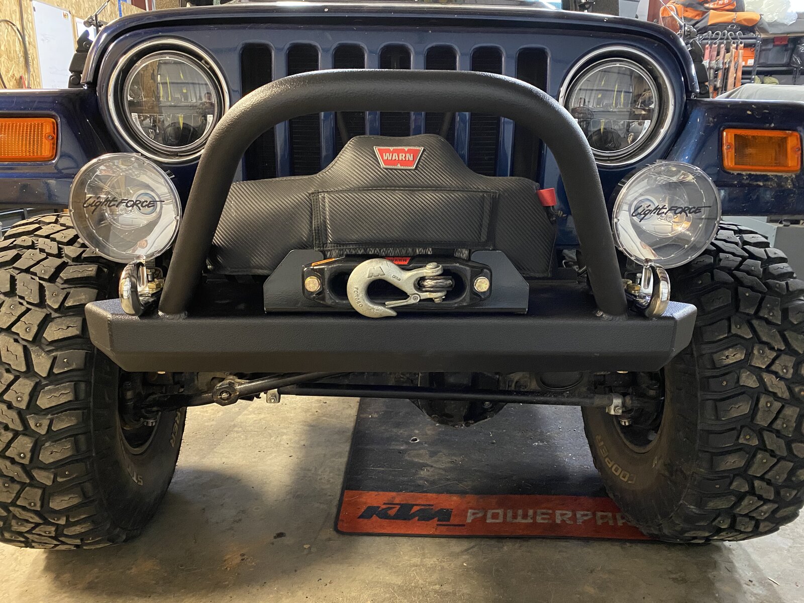

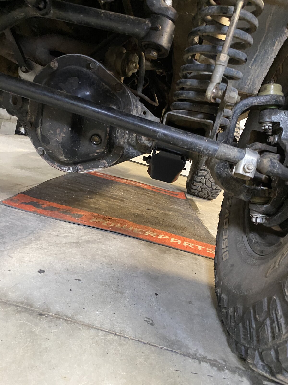

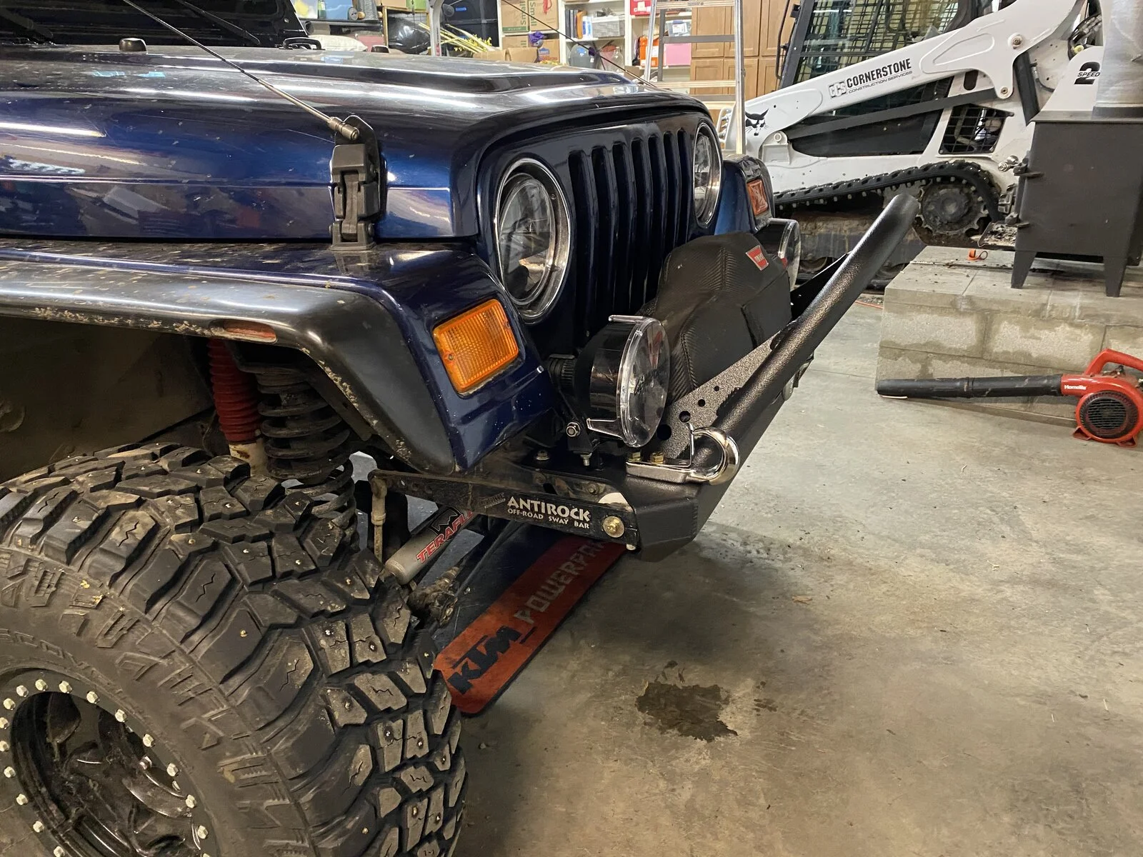

Well that was silly. Had to re-wire my Lightforce lights because the leads weren’t long enough, the nuts for the back of the fairlead were too thick so I have to machine those down, winch bolts that were supplied with hex nuts wouldn’t form into the Warn as they use square nuts so I made some of those. Regardless, it’s in and I shaved 40 pounds off the front of this thing by getting rid of the Smittybilt which also yielded 7/8” increase in ground clearance on the front.
this pic makes the winch guard bar look funny because it sticks out past the front, it really doesn’t look that weird in person.

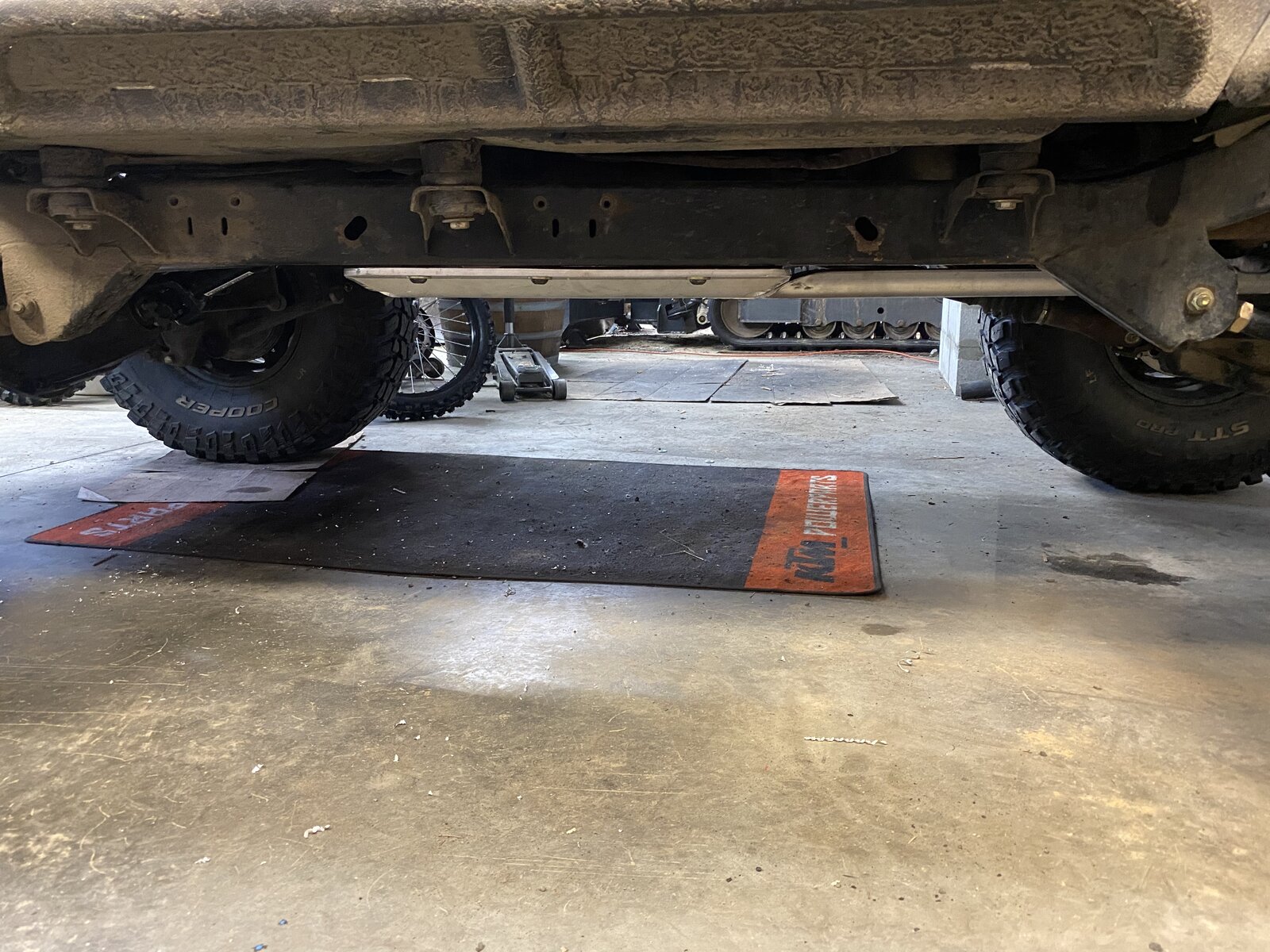

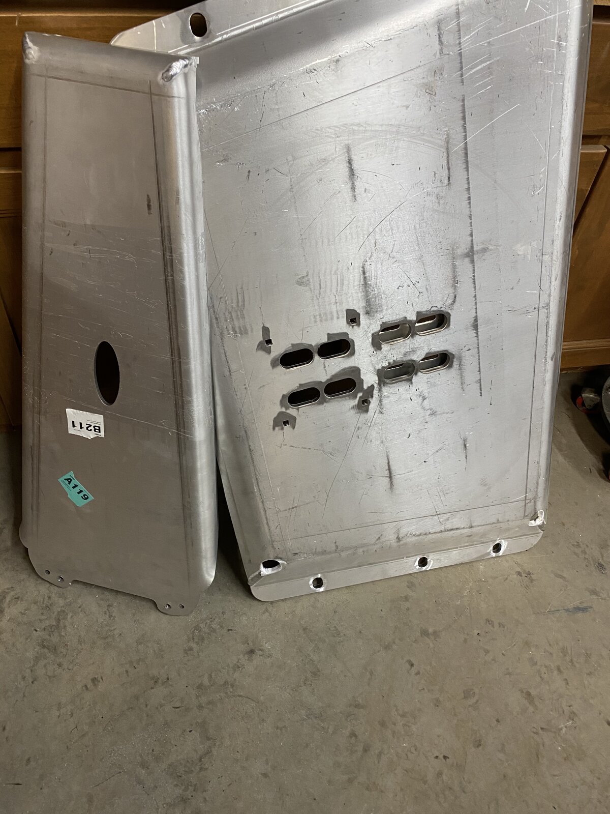

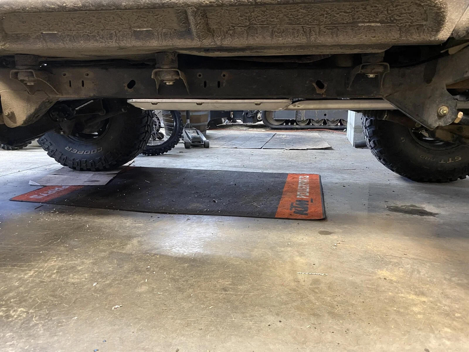

Well, was seriously considering building my own cross member and high clearance skid but nobody locally had any 6061 and to buy a full sheet was cost prohibitive.
That said I ultimately decided to go with the 3/8” UCF ultra high clearance aluminum skid and motor-trans skid. Pulled the ridiculously heavy Teraflex skids off and between those, the front bumper and swapping to the Morryde from a swing out as approximately 140 pounds lighter with extra ground clearance and travel.
Now the not fun part. Had to extend the rear DS (it was too short before so now definitely too short) and we have vibrations to deal with. Not sure if the vibes are from the new DS or the additionally raised skid. The front DS has now been removed and I still have vibes and have tested within 1* of angle from the pinion to DS up to 3*. I’ve now pulled the UCF skid and have the Teraflex back on with original geometry that was vibe free and will be testing to see if it could possibly be a bad balance in the DS.

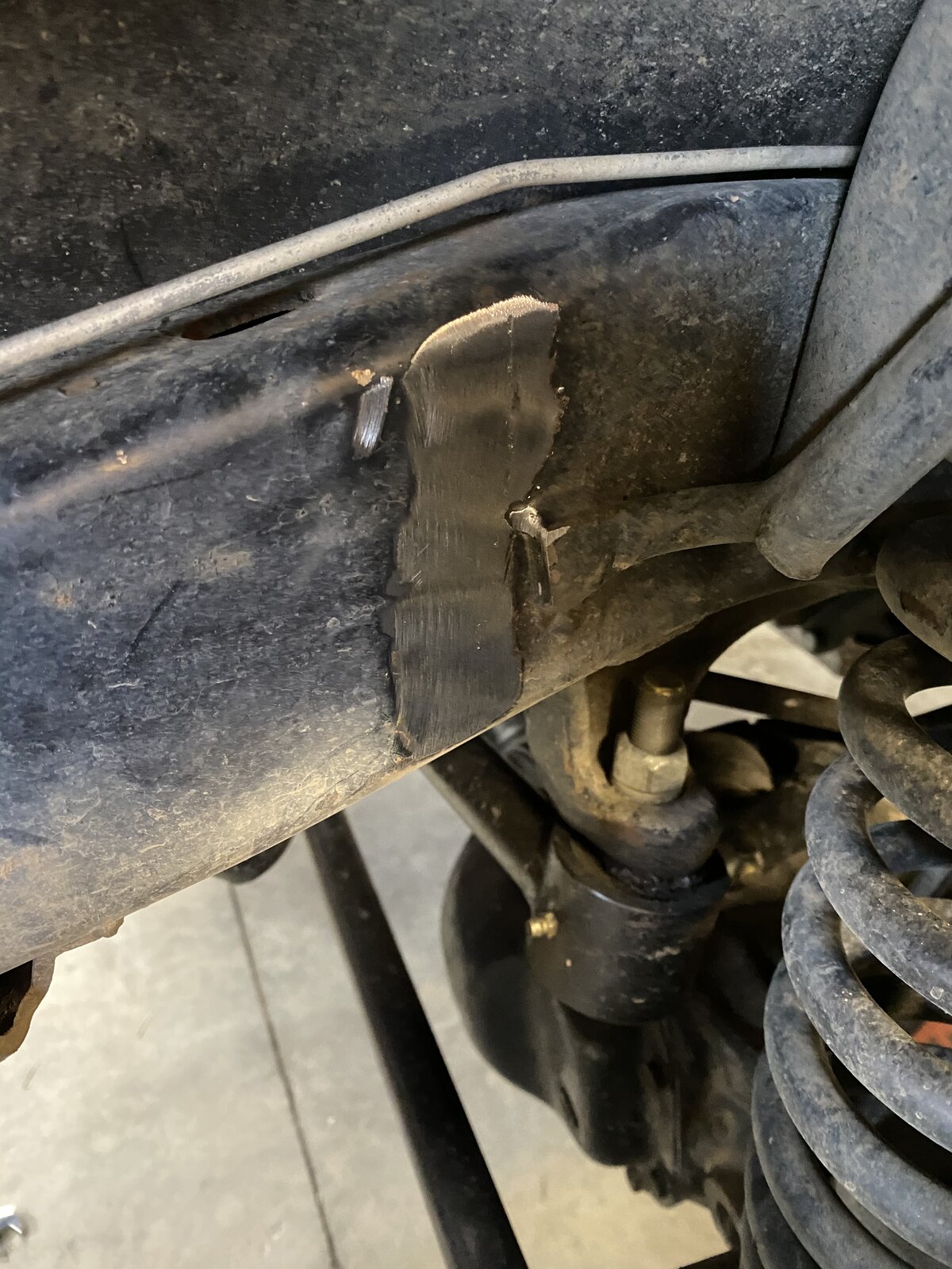

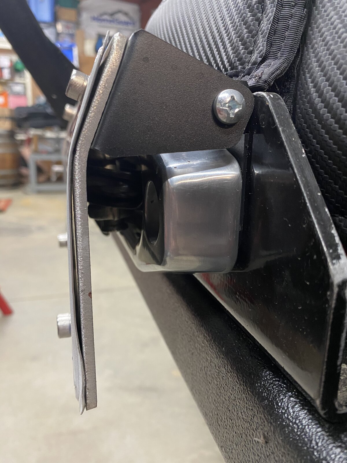

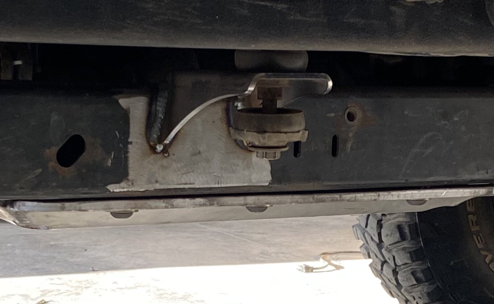

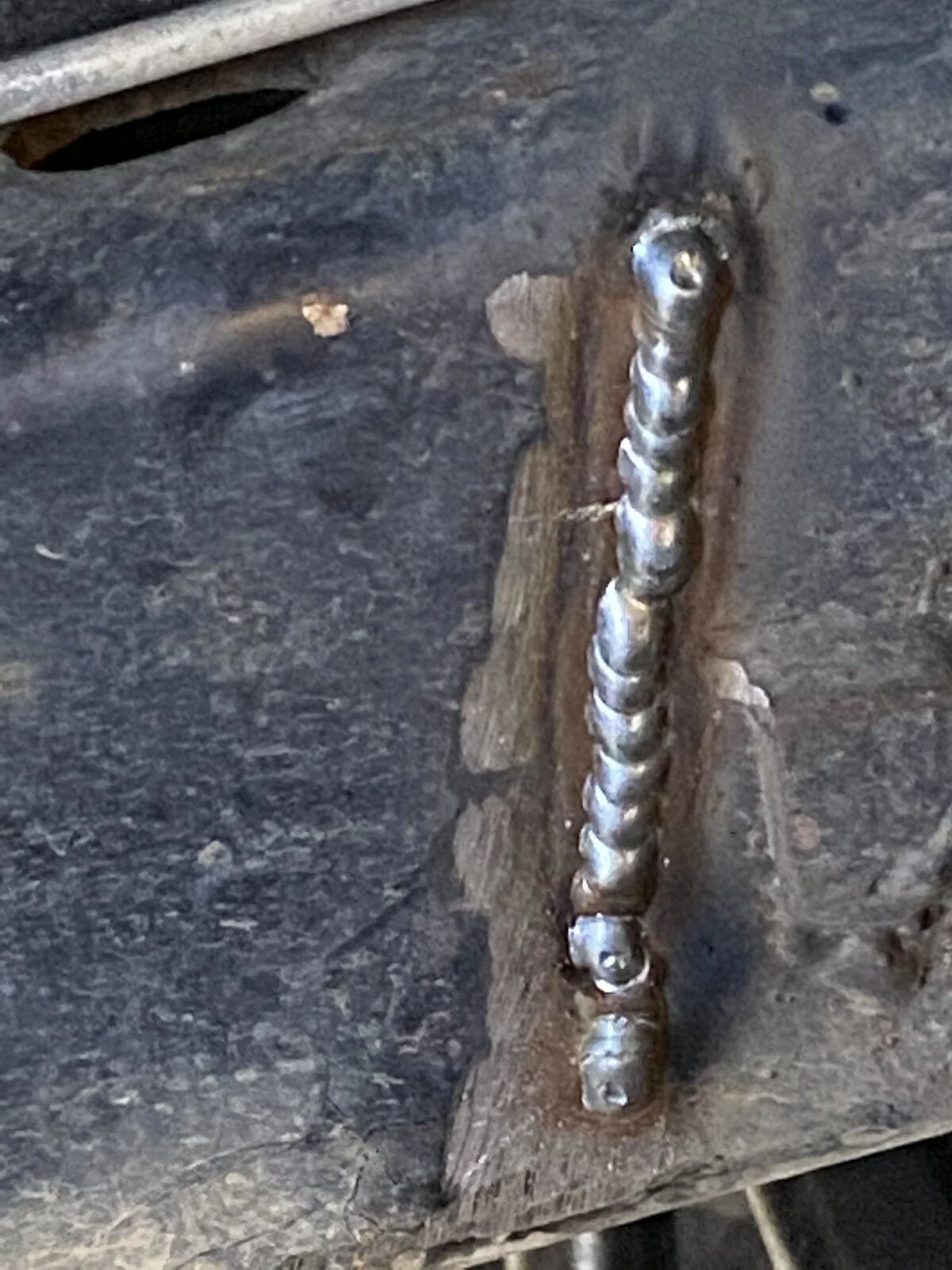

Finally got around to fixing the gouges in the frame from the stock sway bar the PO left for me. The welder was right there so why not weld on the Currie mini skids, that check off my list and because license plates are required here I got the Tuffy Hawse flip up on and modified so the hook doesn’t push it out. Added a piece of aluminum behind it for support, looks ok but hate the front plate. Then built a new dirt bike.

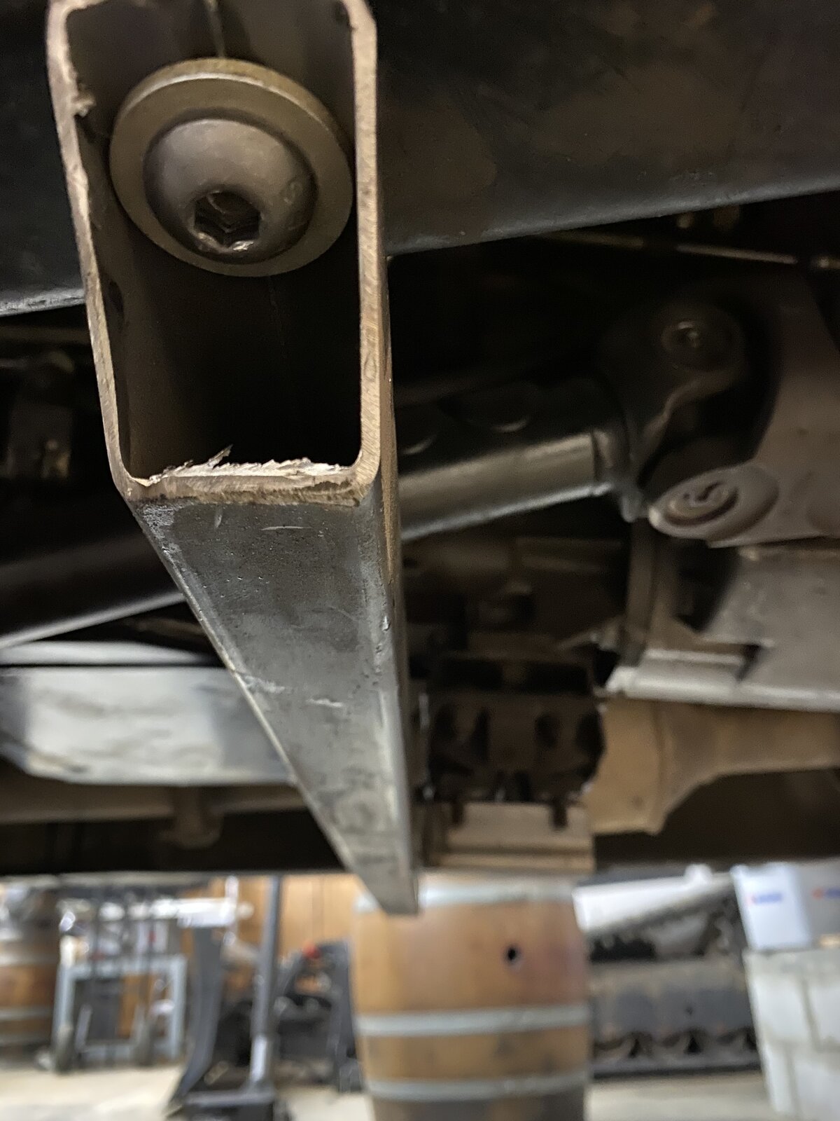

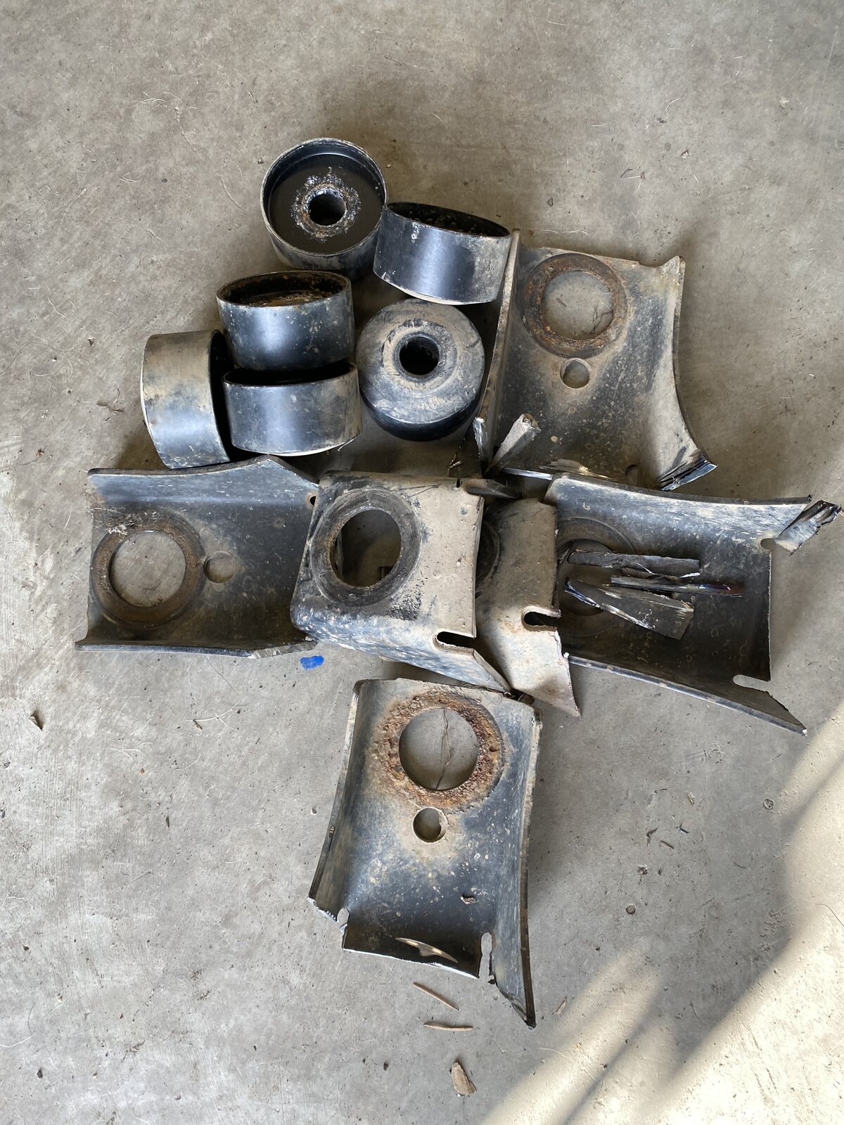

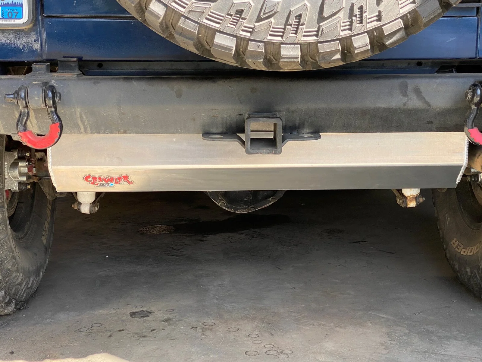

Buzzed off the stocker body mounts and zapped on the GenRights. Next is to tuck the rear bumper then do some stripping and painting of the frame. Ordered new shorter bolts today so ignore the long hanger downers.
Slight change of plan. After installing the new GenRight Enduro tank I felt the gain from tucking the rear bumper would be minimal as far down as this tank sits. I'd rather have the extra fuel capacity than ground clearance so no tuck of the rear bumper...for now. I also scrubbed and painted all the under frame area while the tank was out.
