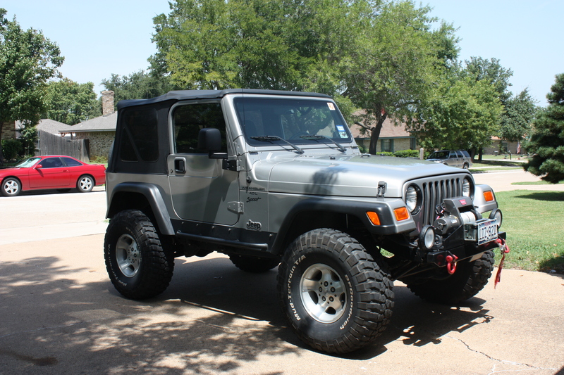

You'll be fine. I had a 4" lift with 35s and bounced my Jeep around for 6 hours in 3' of snow with zero issues.
