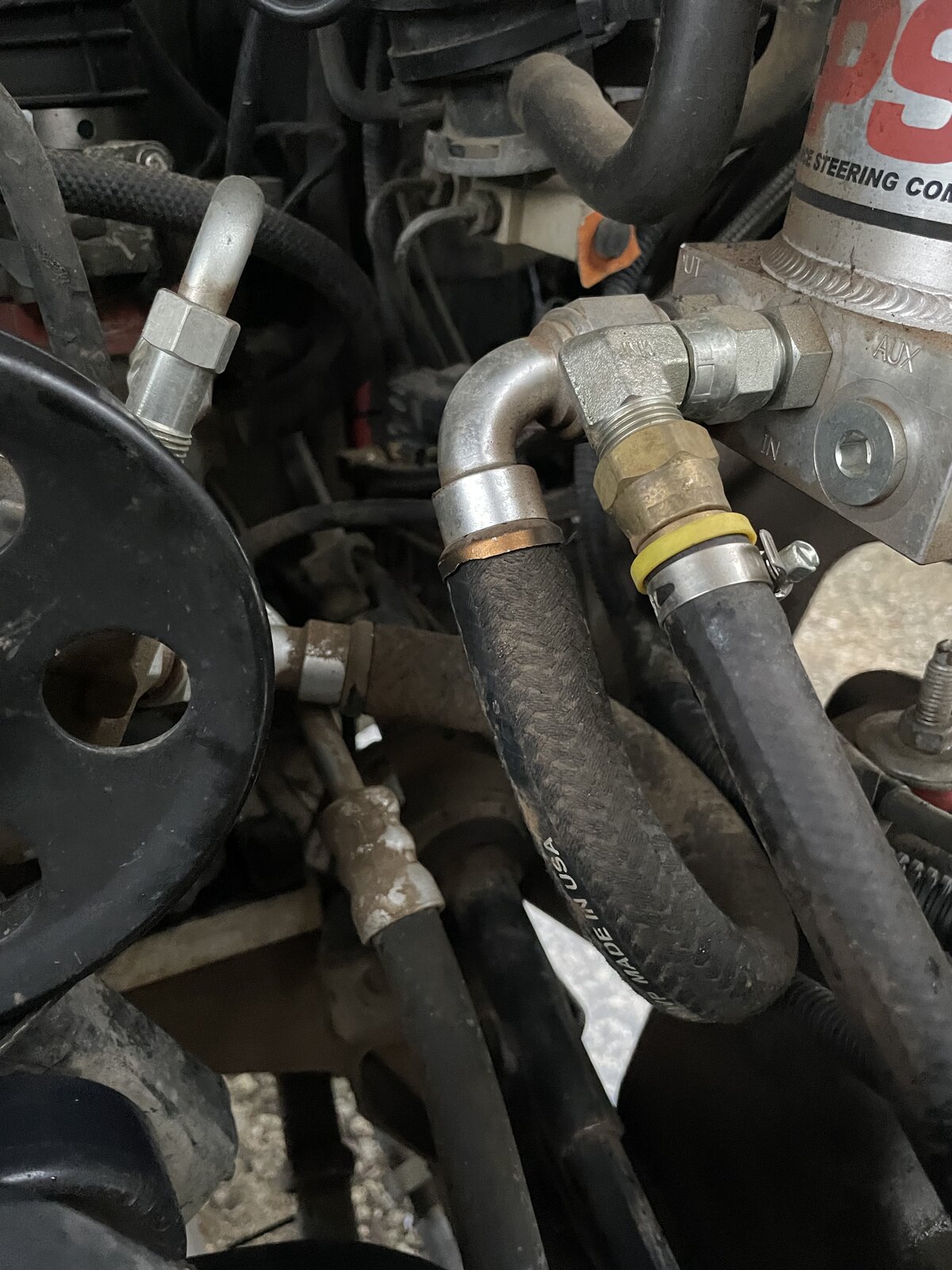

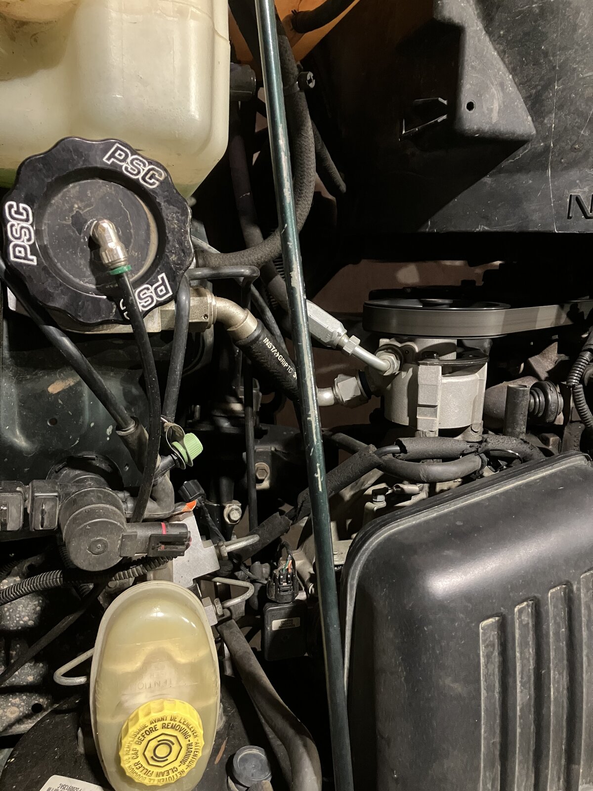

Feed line is 3/4” 8an connections with push locks. Return lines are all 3/8” 6an push locks as well. Sorry for the less than ideal pictures. Just took them in the parking lot at work under a light pole. It’s currently 37* here and was upper 40s most of the day. It started just fine without screaming but increasing rpm gave me a little screech while pulling up to the light pole.
I don’t really have noise after running for 10 or so min but always in the cold on startup and increasing rpm’s.
I agree with mrblaine on those fittings, those are definitely not helping with flow.
Also I’m an idiot, I didn't move the reservoir closer to the firewall. Looks like it’s in a similar location as yours.
I will play with the feed line a bit. I dont think it is starving the pump though. I will install the aluminum sweep push locks on my cooler and at the resi in the return line. Not sure where to go from here if it goes again. Was hoping the pulley would be the answer, but doesn’t sound promising. Thanks for the photos.

Bent tube fittings throughout, no extra length on lines, get rid of the feed loop. It isn't a magic bullet solution, it is following sound principles and making it all work well so when there is a problem with something like a pump, you don't have to go through and try to figure out if the other things are contributing to the problem. You already know they aren't.
I will replace all the hydraulic fittings with the bent tube. I will see what I can do with the feed line. I thought a straight line there might be too “rigid” for engine movement. Just trying to ensure I have done everything to prevent this issue in the future.
Of course extreme care when bleeding the system as well.
It is and engine movement will break or ruin the hose and or fittings. You would ideally like the reservoir forward or rearward of the pump inlet so the hose runs fore and aft a bit so it can flex that way. Even if you have to rotate the reservoir some, that works better than the loop.
