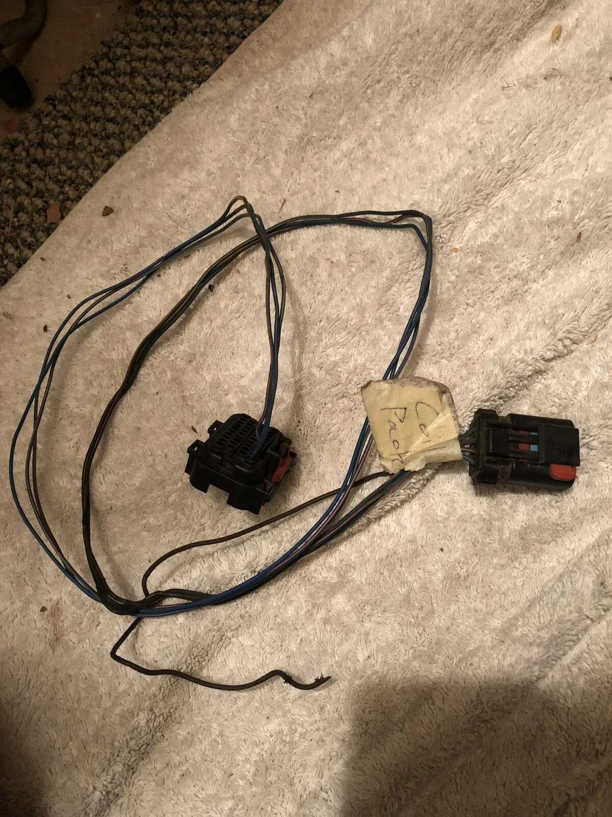

@primetime4 , I did a manual to auto swap a couple months back and took all of the engine wiring out of the donor harness. I have the coil pack plug and plenty of wiring connected to it. You can have it for the cost of shipping.
*edit*
The wires have some grime on them, but other than that the connector and wires are useable.
